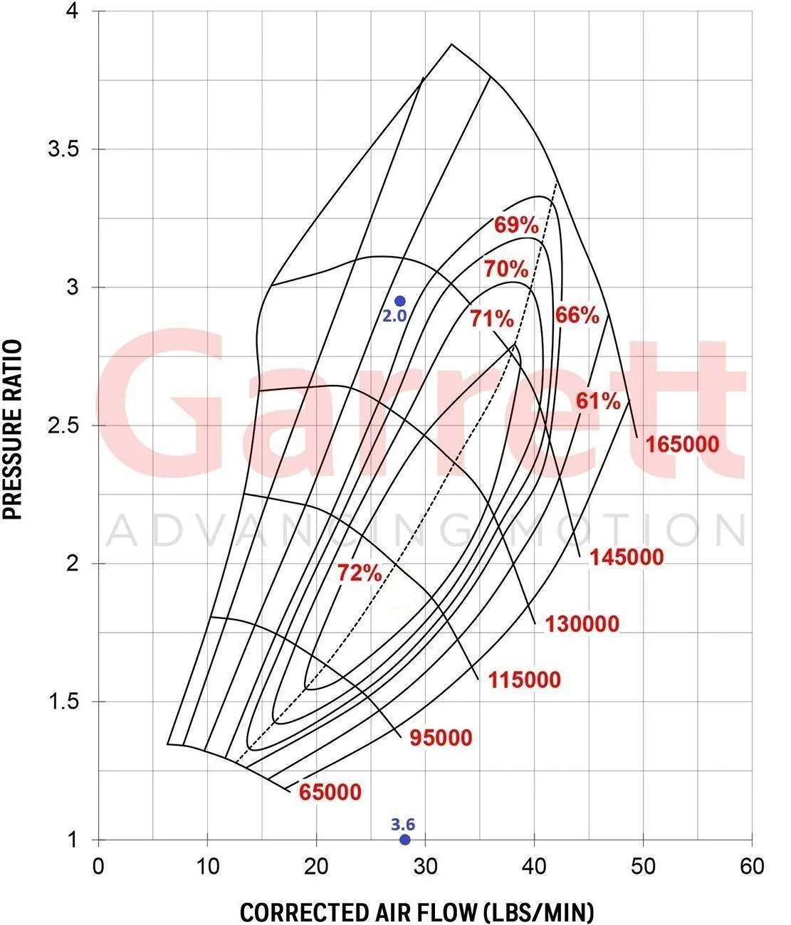

The dot on your compressor map is for a PR of 1.95 perhaps which would be around 14 psi gauge boost - did you use gauge rather than absolute boost?
I think with 22-23 lbs boost (255 kPa absolute) the PR would be in the 2.7-2.8 ball park. There's usually far more pressure loss on the suction side than people realize - about 0.1 bar drop to the compressor. There's also around 0.1 bar drop across the intercooler too but it's on the high side of the equation.
And I'd use 9 hp/lb/min so the dot would be at the end of the first r of garret.
I used numbers I found online for max boost (28 psi IIRC), but this was on an Alfa (different turbo). It was a measured number, not what the ECU reports... but I don't know where the probe was located.
If I understand everything correctly, pressure ratio is basically number of atmospheres, with everything below 1 being a vacuum (where N/A motors live). Converting the absolute pressure number includes everything from complete vacuum instead of how many times the compressor increases the pressure.
Think of this like an air compressor for tires: you don't care about pressure below 1 atmosphere. As far as I know turbo compressor maps work the same way.
Pressure ratio is the ratio of absolute pressures each side of the compressor. So at 1 atm with some intake drop there is around 0.9 bar on the suction side. Then at 2.6 bar intake manifold pressure (23 lbs) the pressure ratio is around 2.9.
It is very common for people to incorrectly convert 23 lbs boost to 1.56 bar whereas it is actually 2.56 bar absolute. And so the PR would be 1 point too low.
Corrected:
Jeep Wrangler JL 2.0 Torque Curves 1633456365688-png-jpg
