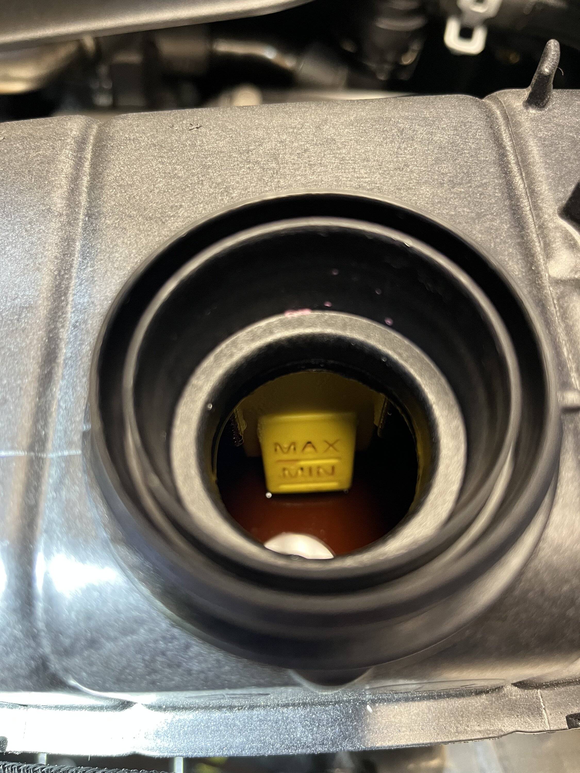

4 weeks ago I was ‘mid’ coolant on the dipstick normal range.
2 weeks ago I was on the lower dot in the normal range.
Just checked this morning before starting… I’m below the fill line and on the lower of the two low dots!:mad: Time to add coolant! 2045 miles on the Odo. WTH!?!?
Looked all around and climbed underneath with my light. No signs of leaks.

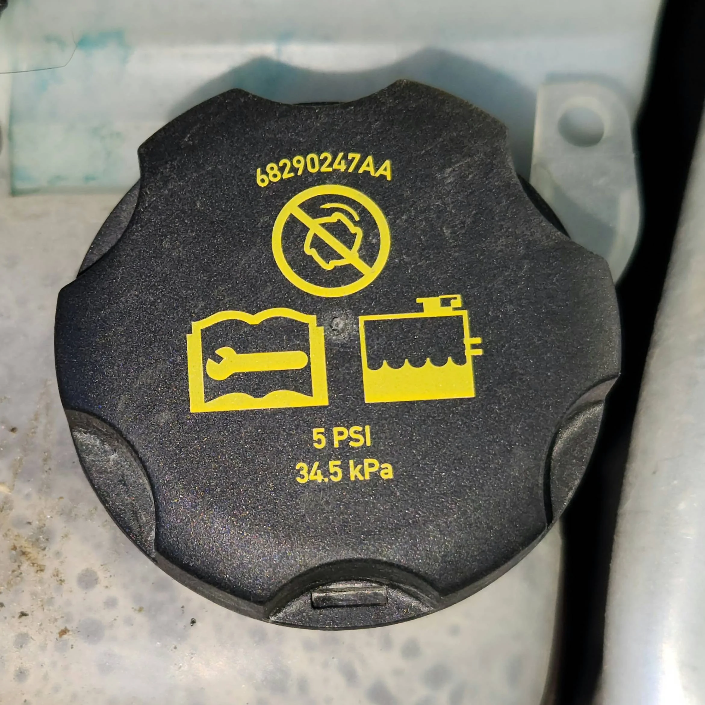

My Turbo coolant tank level doesn't change. Seems to require a tool to open it anyway.
The level in that tank is stable for me too. It’s the other one that’s the problem.
btw if you ever do need to open that tank you don’t need a particularly special tool. Spin the top until the hole you see at the bottom of your photo lines up with a hole on the plate underneath. Stick a zip tie or small screwdriver in the lined up holes and you will be able to unscrew the lid easily.

Interesting. My turbo tank cap is different. Twists right off too. No tool required.
Another member posted on mine you have to line up two slots and put something in them to turn it. Not sure why yours is different or why mine us the way it is.

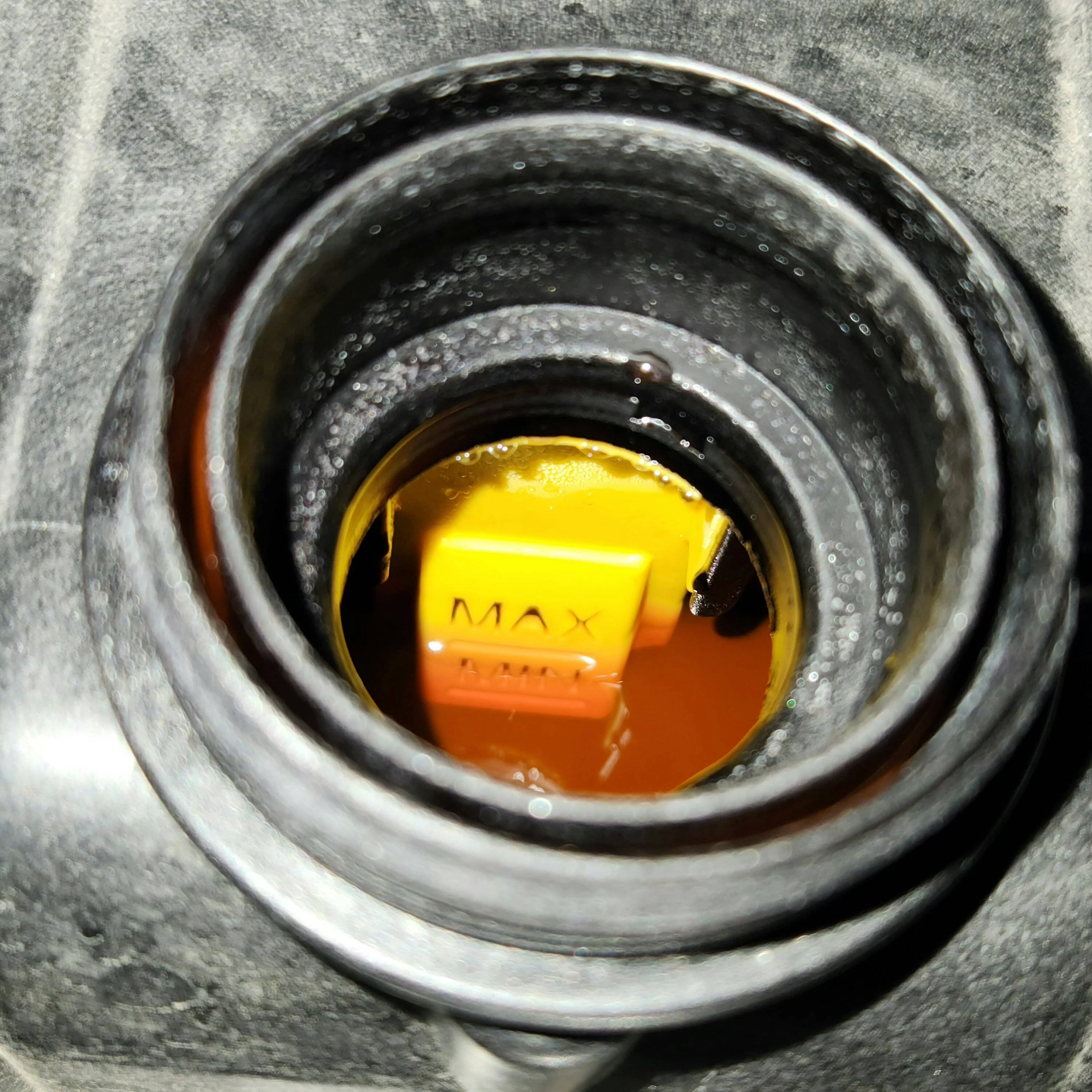

Just added 11 oz (1/3 qt) to the main (black) reservoir. 2000 miles on the odo. :facepalm:
Here’s a ‘before’ pic .
Thanks for the info. That's why I'm trying to let people know to check theirs. I believe it's a factory fill issue along with some sort of ongoing coolant loss besides the loose bolts.
