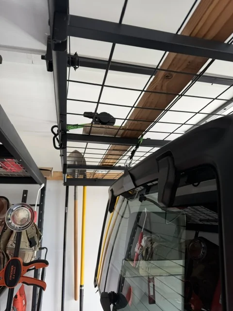

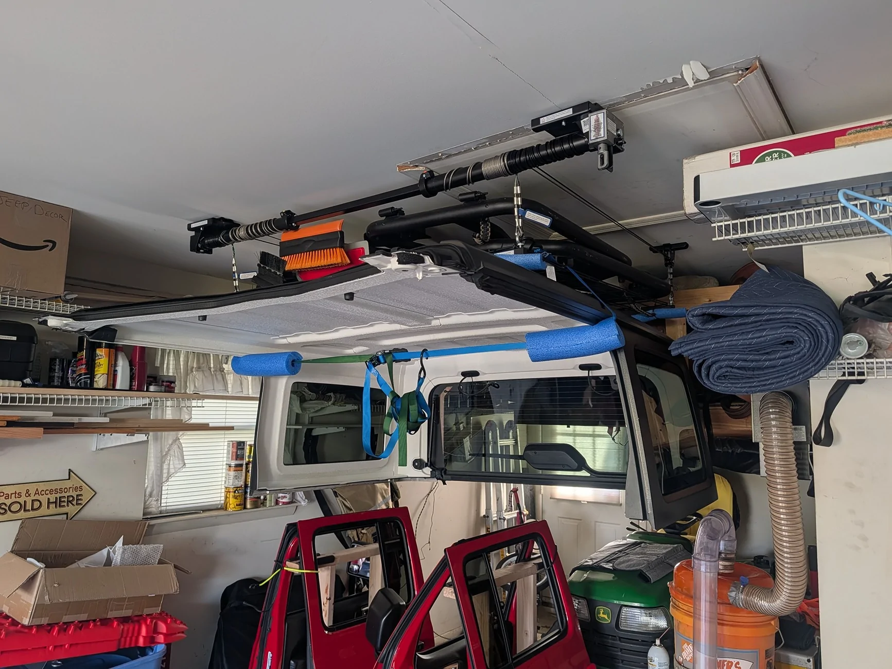

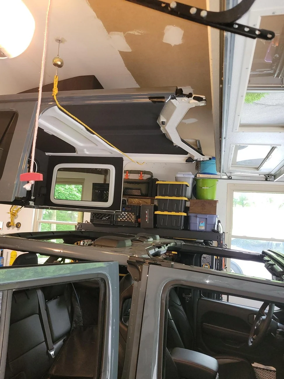

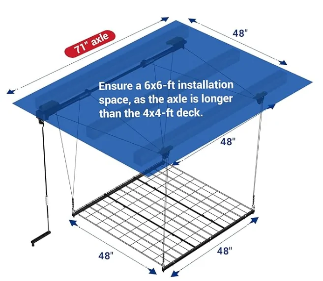

I needed a ceiling-mount hard top lift for my garage as I don't have the available space to have it on a cart. I looked at the available options that are made for Jeep tops and wasn't pleased with them as they were either very expensive, powered (don't need powered in my opinion for the few times I use it), or have a pulley system that seemed like the lowering would be controlled enough (I need to be able to do this myself). Another requirement I had was the need to store the top with the glass closed, which ruled out the other top lifts.
My solution: I liked the crank system of this storage system that I found on Amazon (Link) as it is self-holding, and after measuring the top, it would fit nicely in the spot I have. In conjunction with the Topsy mounts (link), this solution has come together nicely. The rack allows me to attach anywhere along it's width to make sure I'm lifting straight up on the rear of the top, and a set of ratchet straps from the rack, around the bottom of the front of the top, allows me to lift this pretty well.
The crank requires about 4-6 twists per inch of lift, so I can lift and lower pretty carefully, stop to readjust, and keep going, all by myself. I've added a few pieces of pool noodles to prevent scratching, and so far I'm pretty happy with the results for under $230. In addition, I can throw the freedom tops on top of the rack and have everything stored while still being able to drive my tractor underneath to get out.
To lift the top off, I back under the rack, lower the rack until it's resting on the top (pool noodles preventing scratching), attach short straps from the rack to the topsy mounts in the rear, ratchet strap from the rack around the front of the top, take off all the top mounting bolts/wires, and crank the top up.
Jeep Wrangler JL Ceiling Mount Top Lift - DIY-ish for ~$230 1779896881069-cc

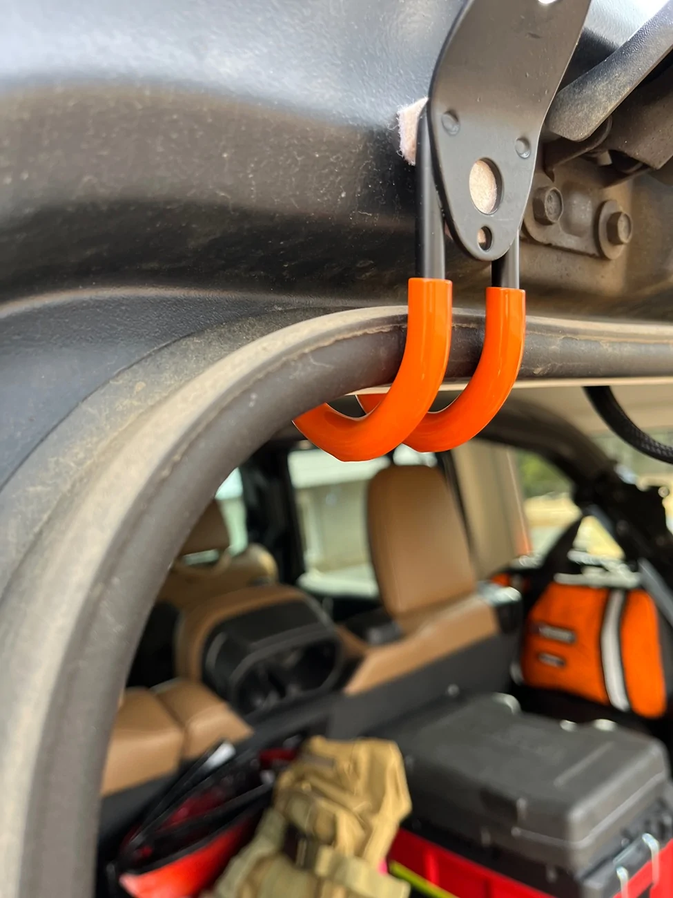

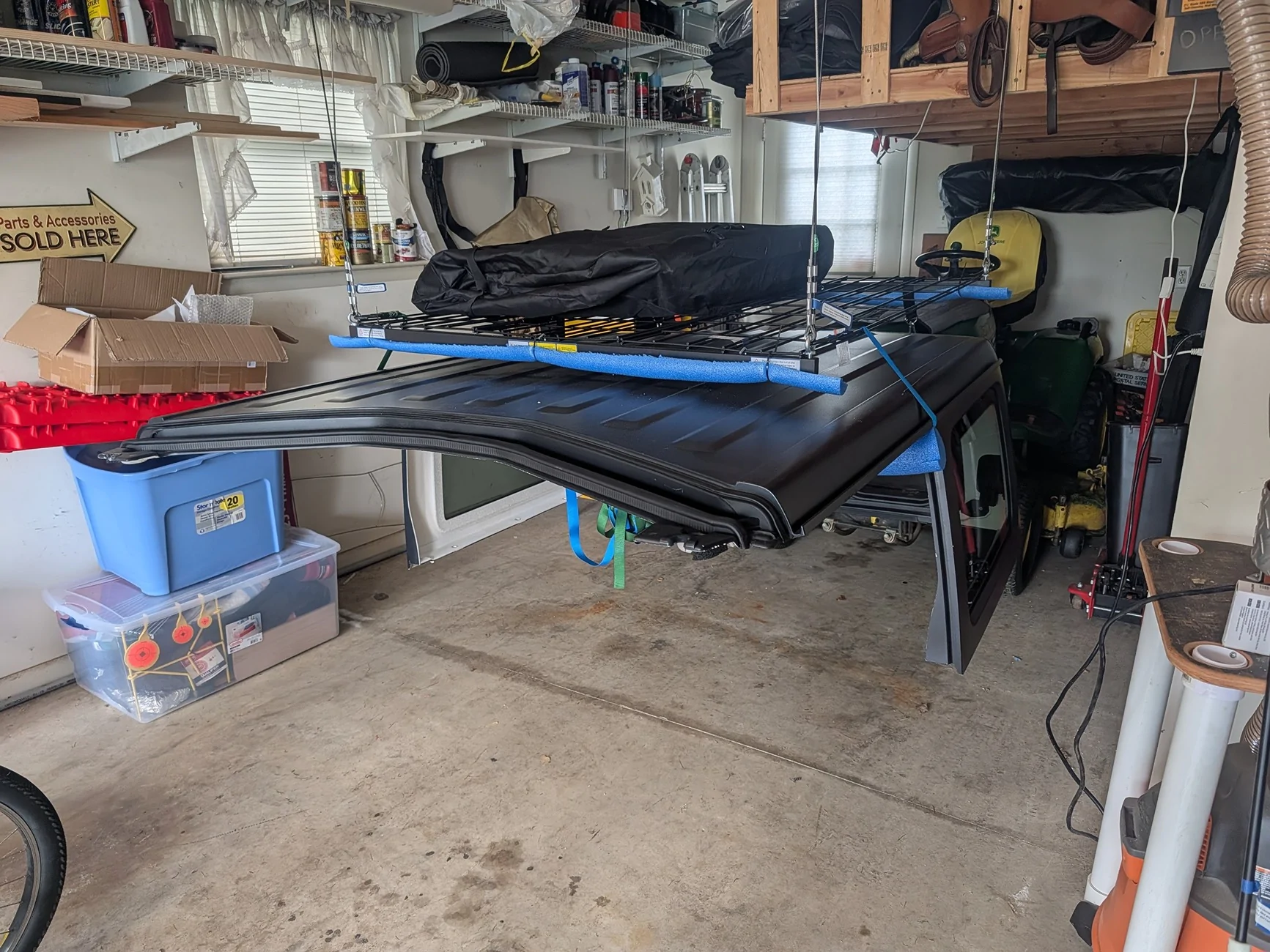

Topsy Mounts installed:
Jeep Wrangler JL Ceiling Mount Top Lift - DIY-ish for ~$230 PXL_20260320_000440712

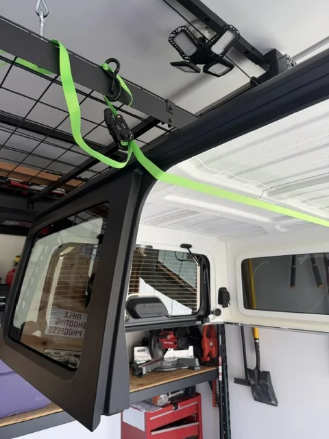

Top in lifted position:
Jeep Wrangler JL Ceiling Mount Top Lift - DIY-ish for ~$230 PXL_20260502_133211099

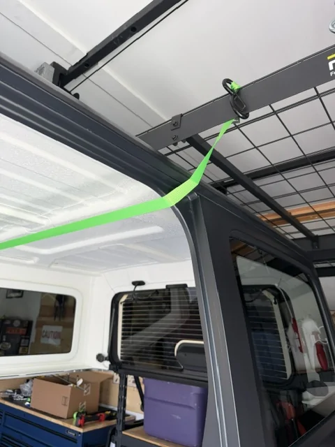

Top lowered:
Jeep Wrangler JL Ceiling Mount Top Lift - DIY-ish for ~$230 PXL_20260502_163458994

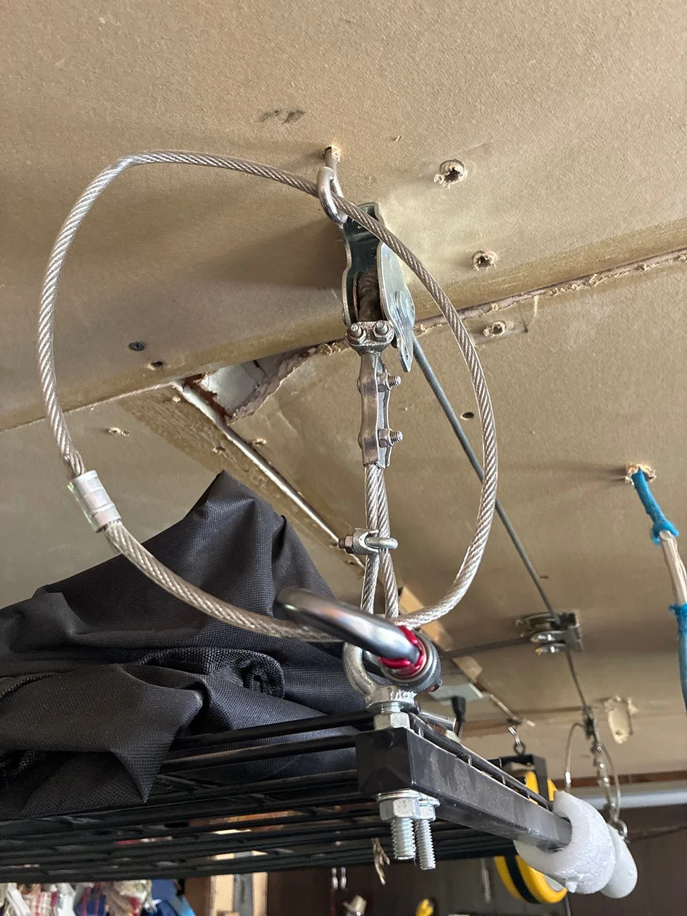

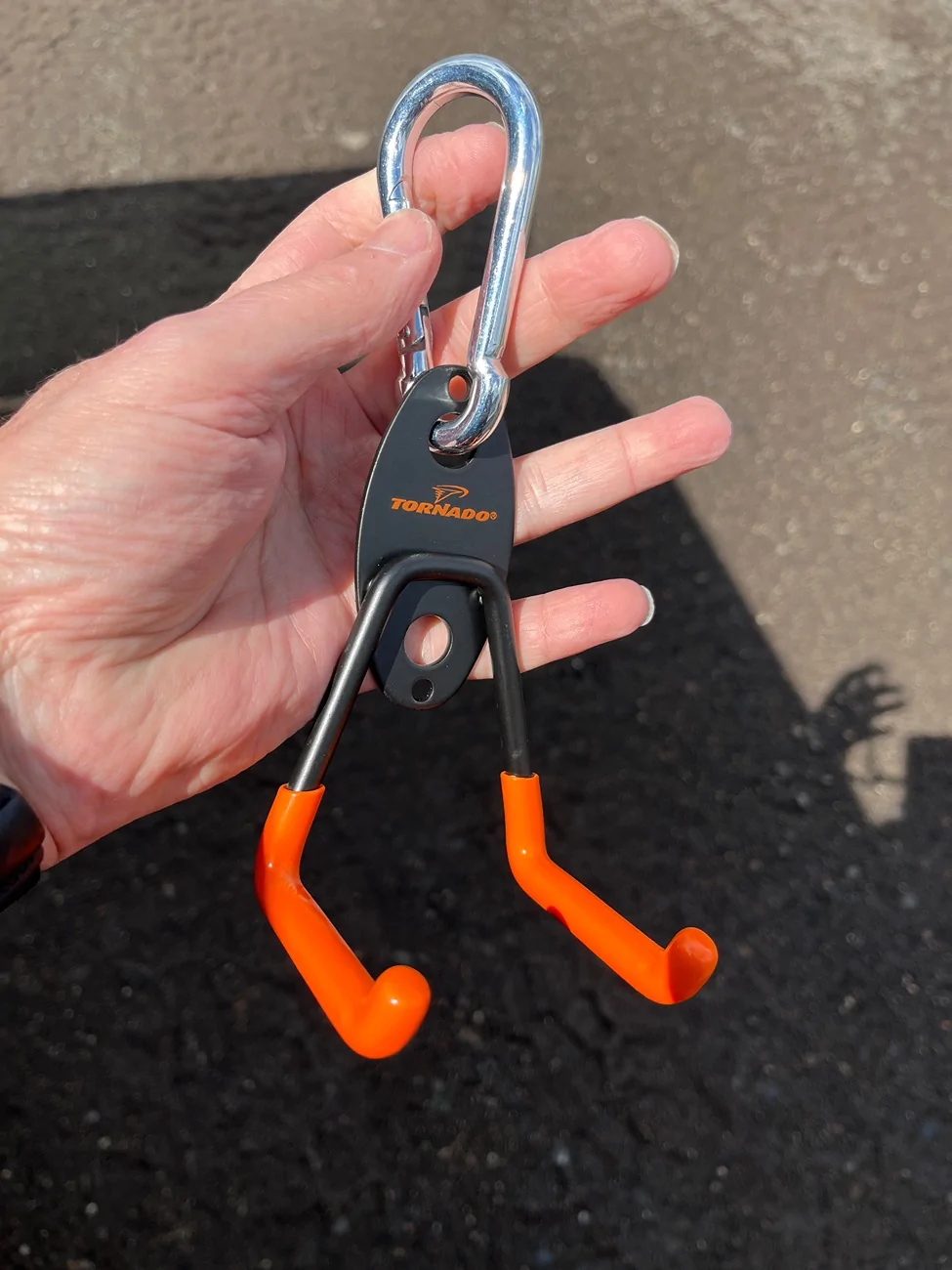

I accidentally ripped mine out of the ceiling and when I redid it I used the same frame but pulley’s and cables so as a safety back stop I installed a cable on a carabiner to catch it if my rack fails

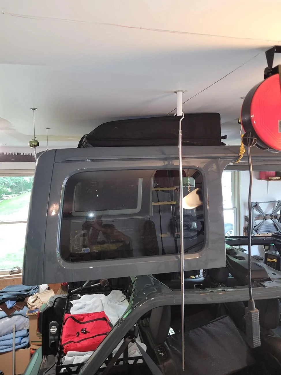

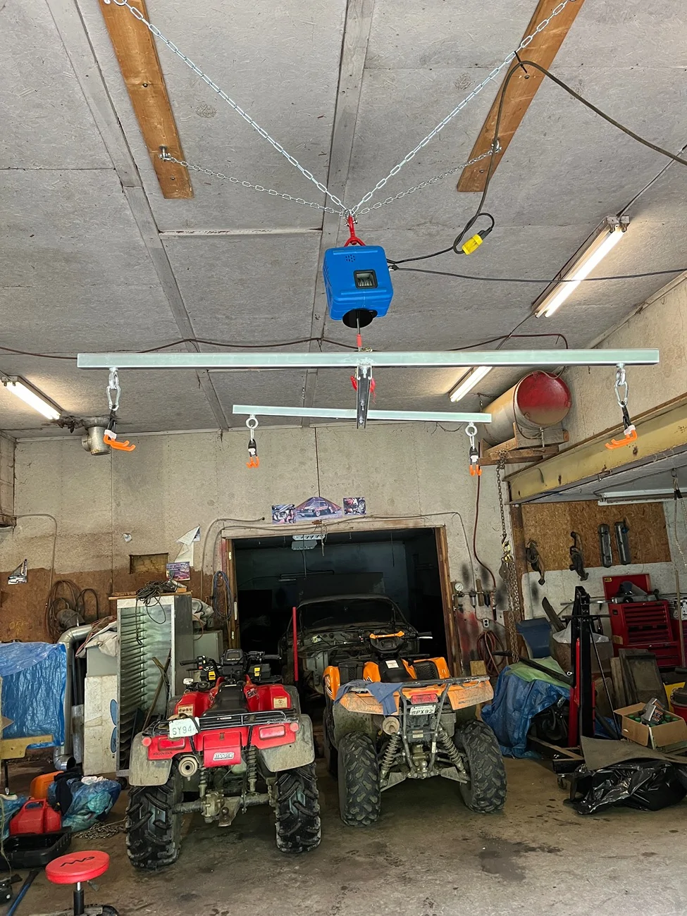

Here is what I did.
- A couple lengths of conduit rack
- 4 wall hanger hooks
- 4 eye bolts
- 4 snap rings
- 1 small electric hoist from Amazon

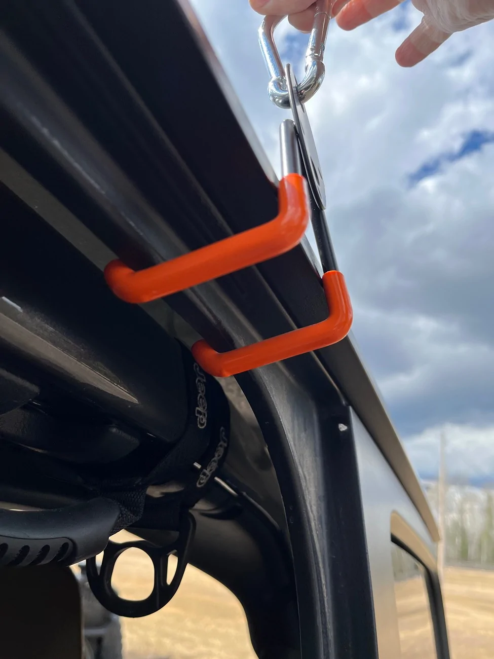

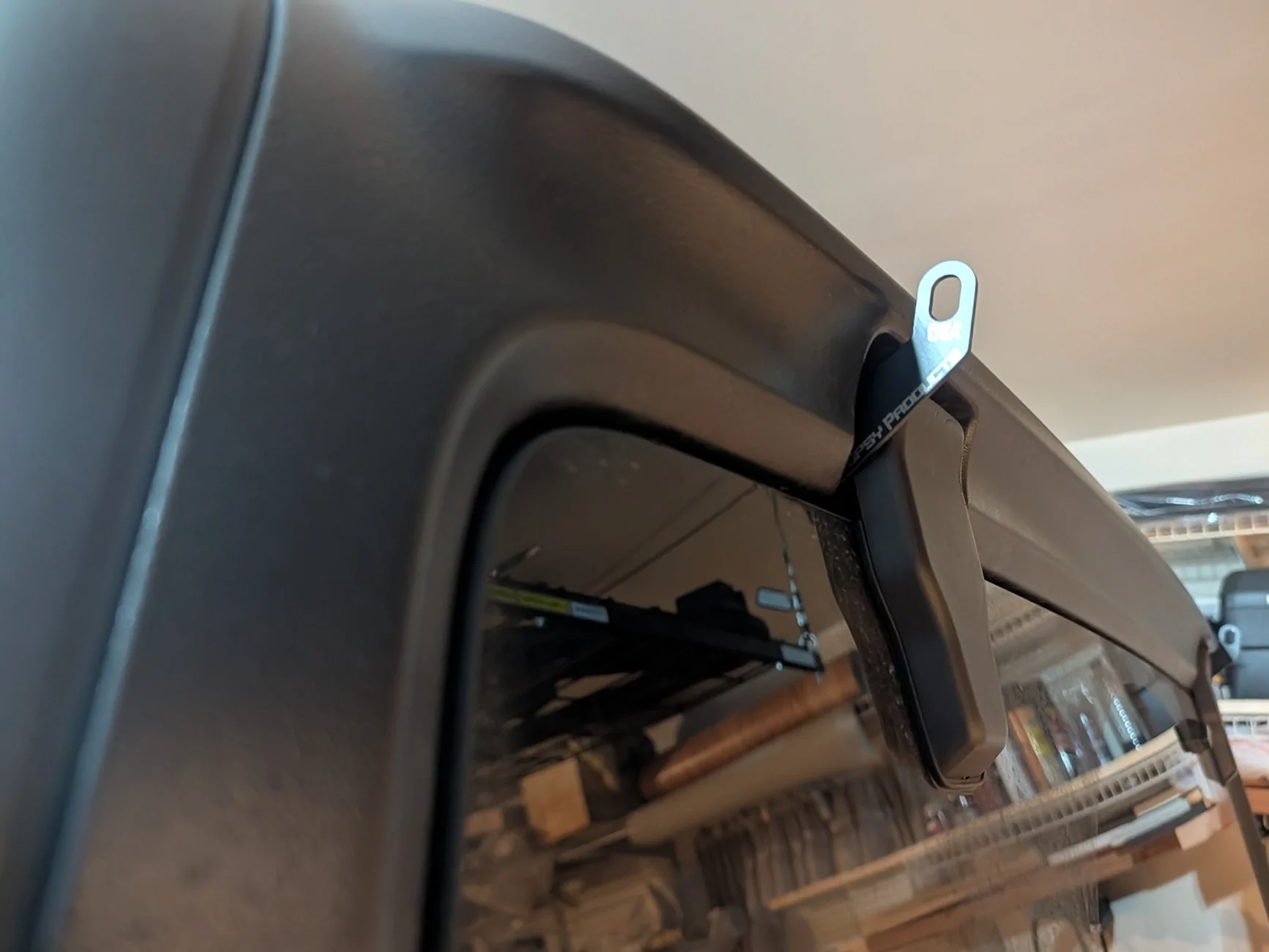

I did one similar. Picked it up on Amazon for about $300 but went with a different 4x8 design for storage. It has a heavy-duty load limit of 650 lbs(if I remember right) and it raises and lowers with a regular drill. I picked up a bracket from Lang for the rear window since I had to mount it close to my storage rack and I won't be able to open the window while in use. I used regular ratchet straps to attach it to the lift. It works great and I can use it by myself. It really helps when backing under to put the top back on, you can push it in any direction for the final fit without damaging the top. Plus, when I'm not using it as a lift, I store all of my extra parts and junk on the rack and keep it out of the way.

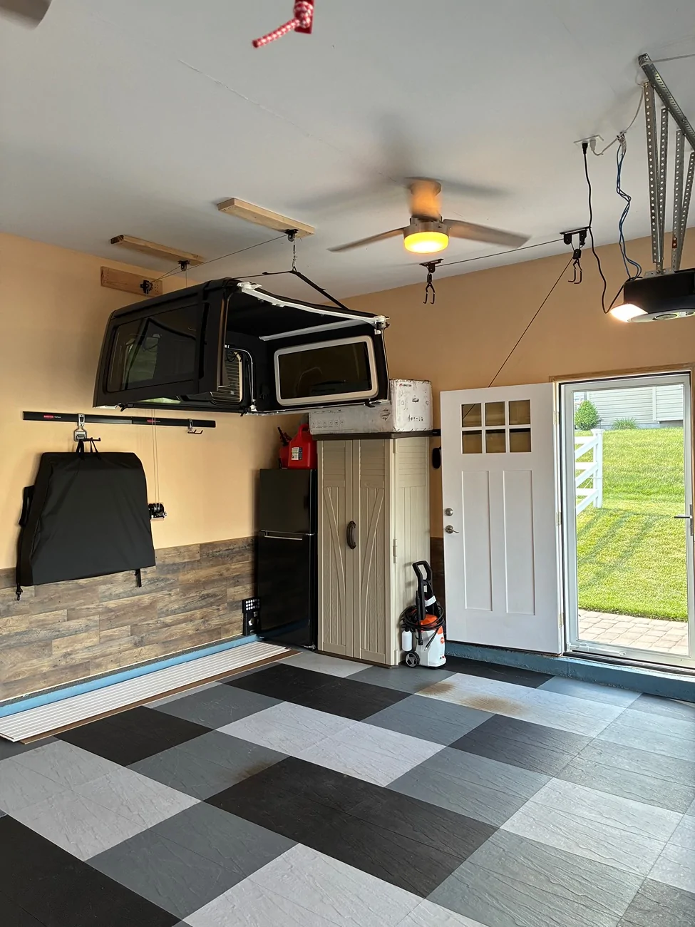

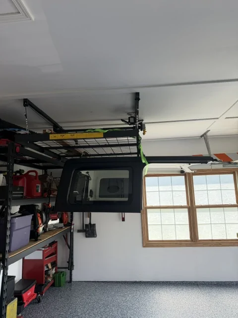

Love everyon's ingenuity. Picked this up from @Quadratec, Lange Hoist-a-Top for $150 and used a wall mount for the FT's. I can leave it suspended, glass closed, no issues….

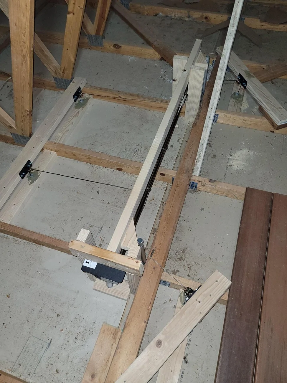

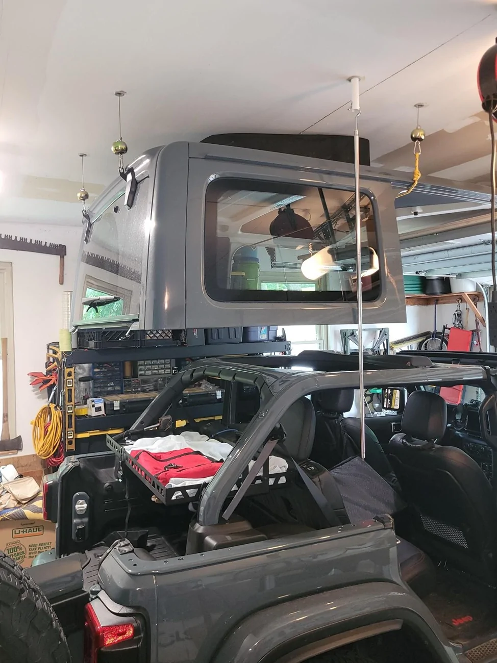

I used a similar kit from Amazon. Except I used the one that just had the 4 down cables. I took it a step further and put all the guts of the kit in the attic and just have the hooks hanging down in sight, along with the crank pole. My ceiling is not very tall and I wanted the top as close to the ceiling as I could get it.
I made an extension for the crank out of some scrap pipe I had laying around. I used ball joint rebuilt joints I found at a farm store for weights to hold the cable down and keep them from recoiling up to the ceiling when nothing is connected to the hook. Used electrical bushings to line the holes so it wouldn't rip the drywall.
Took a lot of time to measure everything out, but supper happy how it turned out.

Great ideas! Do you have enough cable to drop the top to the floor if you want?
gotbru
Nathan
Dec 19, 2017
53
STL
2024 JLU Rubicon X
Design Engineer
Yes, plenty. There is about 4-5 wraps of cable around the bar still when the hooks hit the ground. Actually made it a PITA to keep tension on the cables to even them up.
