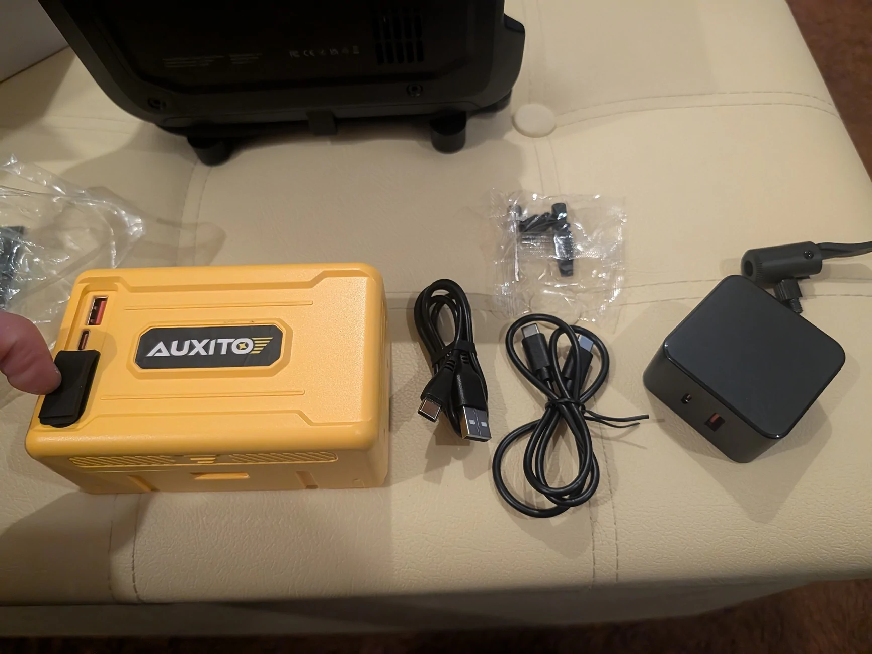

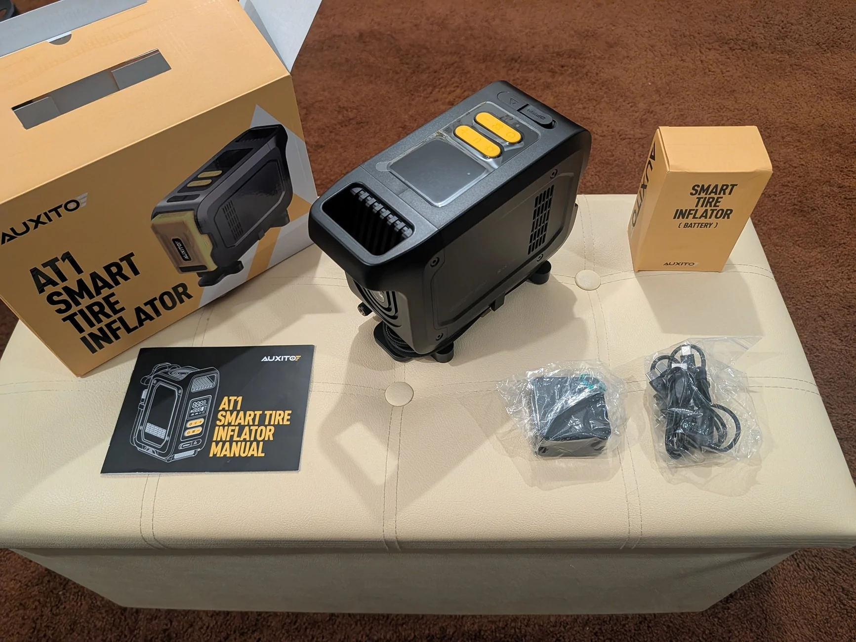

  • What's in the box:
    • Jeep Wrangler JL Auxito AT1 Inflator & Charger - Review PXL_20260405_131304550
      Jeep Wrangler JL Auxito AT1 Inflator & Charger - Review PXL_20260405_131524685

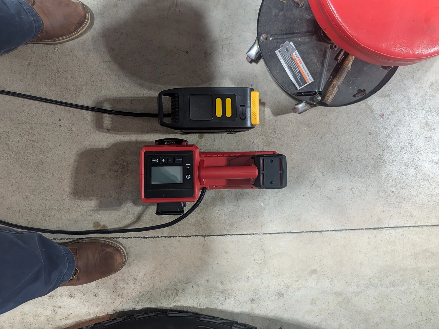

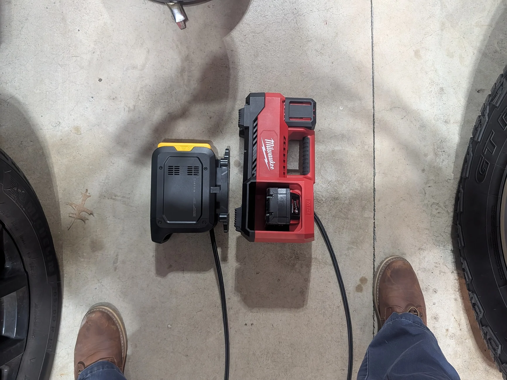

  • Overall, this unit is smaller than the Milwaukee inflator I'm comparing to, and dimensions on the website are accurate: 7" x 4" x 9.5". That said, the unit does fit inside the under-floor cubby in a Wrangler JL.

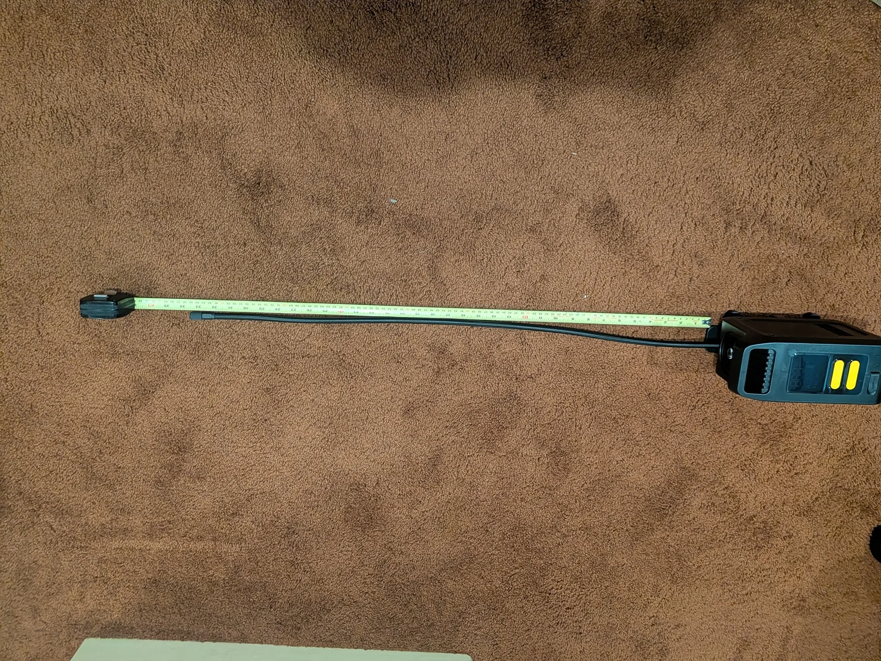

  • The hose length is 33.5" - a bit shorter than Milwaukee but workable. The hose stores by wrapping around the bottom of the unit and stows nicely.

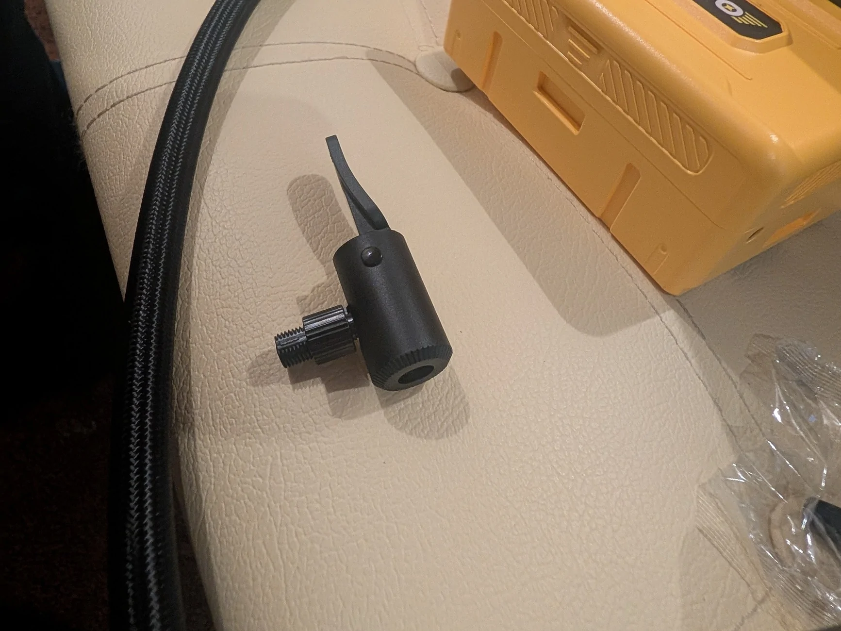

  • The manufacturer claims the chuck is brass. From what I see, the inside of the chuck is brass, and all the other components are plastic. The hose end is a screw-on type, though the kit includes a quick connector. The quick connector is plastic as confirmed with a knife scoring the surface.

  • It comes with one battery that is rechargeable via USB-C and a provided USB C wall wart. The wall wart charges the battery at 60.8W, not 65W as listed. The battery fully removes from the unit so you could charge it outside of the inflator or use it as a separate power bank. The chargability of this battery with a USB-C is a bit more easy than a Milwaukee battery as you don't need a proprietary charger. That said, the Auxito battery is completely proprietary so even though it is removable, you can't swap in a new battery for additional pumping. I am not sure if you can get more batteries from Auxito.

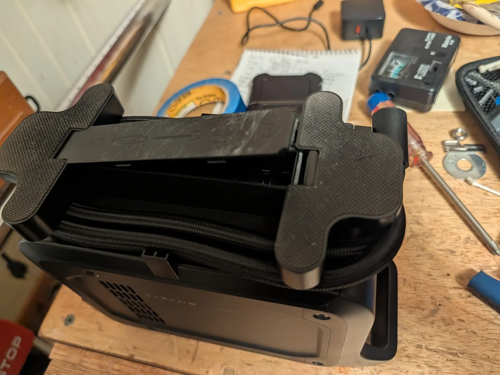

  • There is onboard storage for the included accessories on the bottom of the unit. This will fit the ball needle and pool toy inflator nozzle, but not the charging cords or wall wart. The door on this compartment is very thin and broke as I was trying to open the compartment.

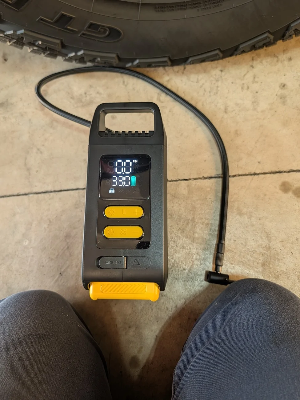

  • The screen on the unit is clear and fairly nice, showing the pressure setting and battery level. The battery level is only displayed as 3 colors, not a %.

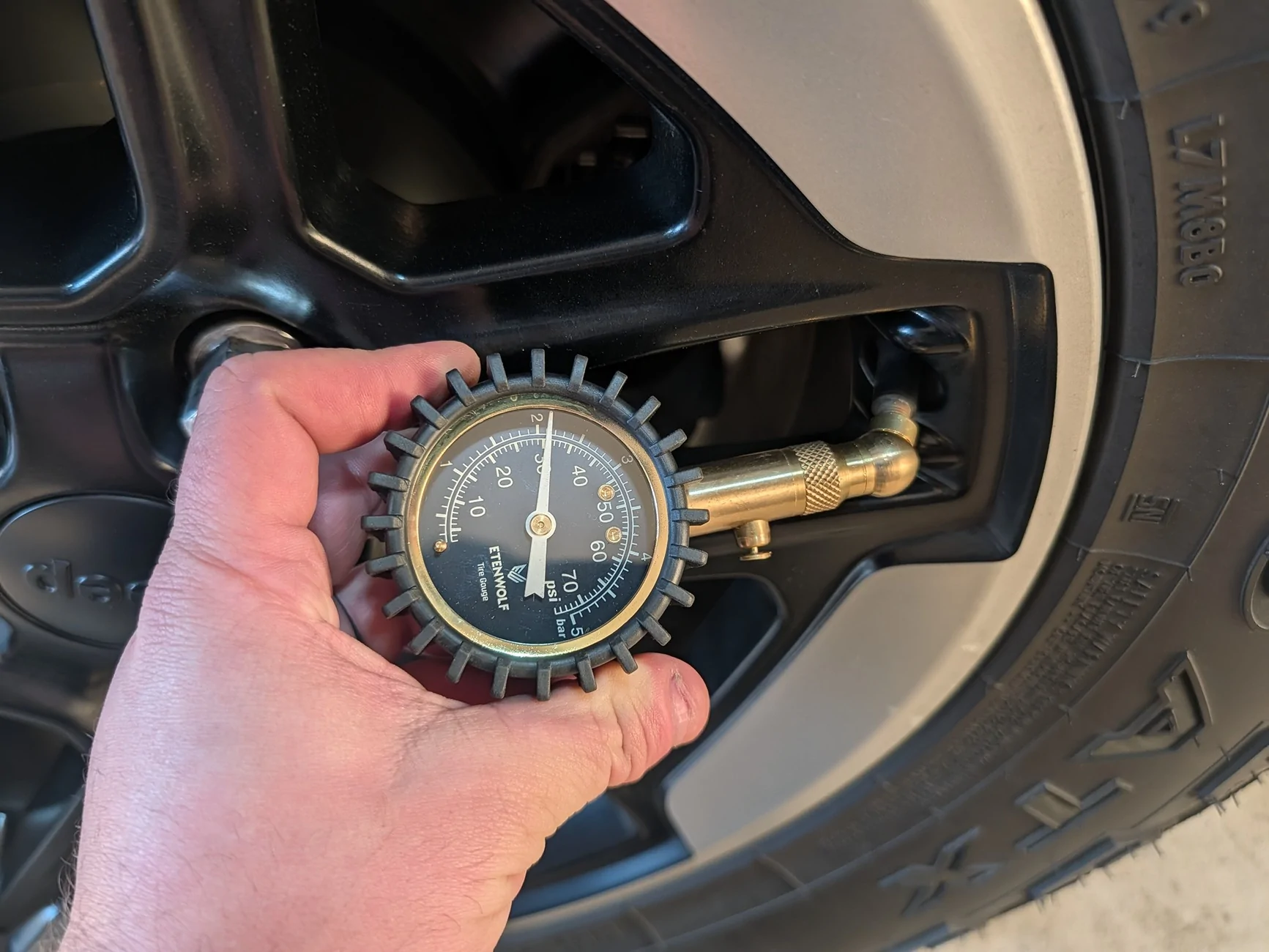

As stated above, this testing was done in comparison to a Milwaukee M18 with a 5.0AH battery as the this is the most comparable kit in price to the Auxito $199 kit. The Auxito offers a flashlight and the ability to charge other devices, which the Milwaukee cannot do.
Test parameters:

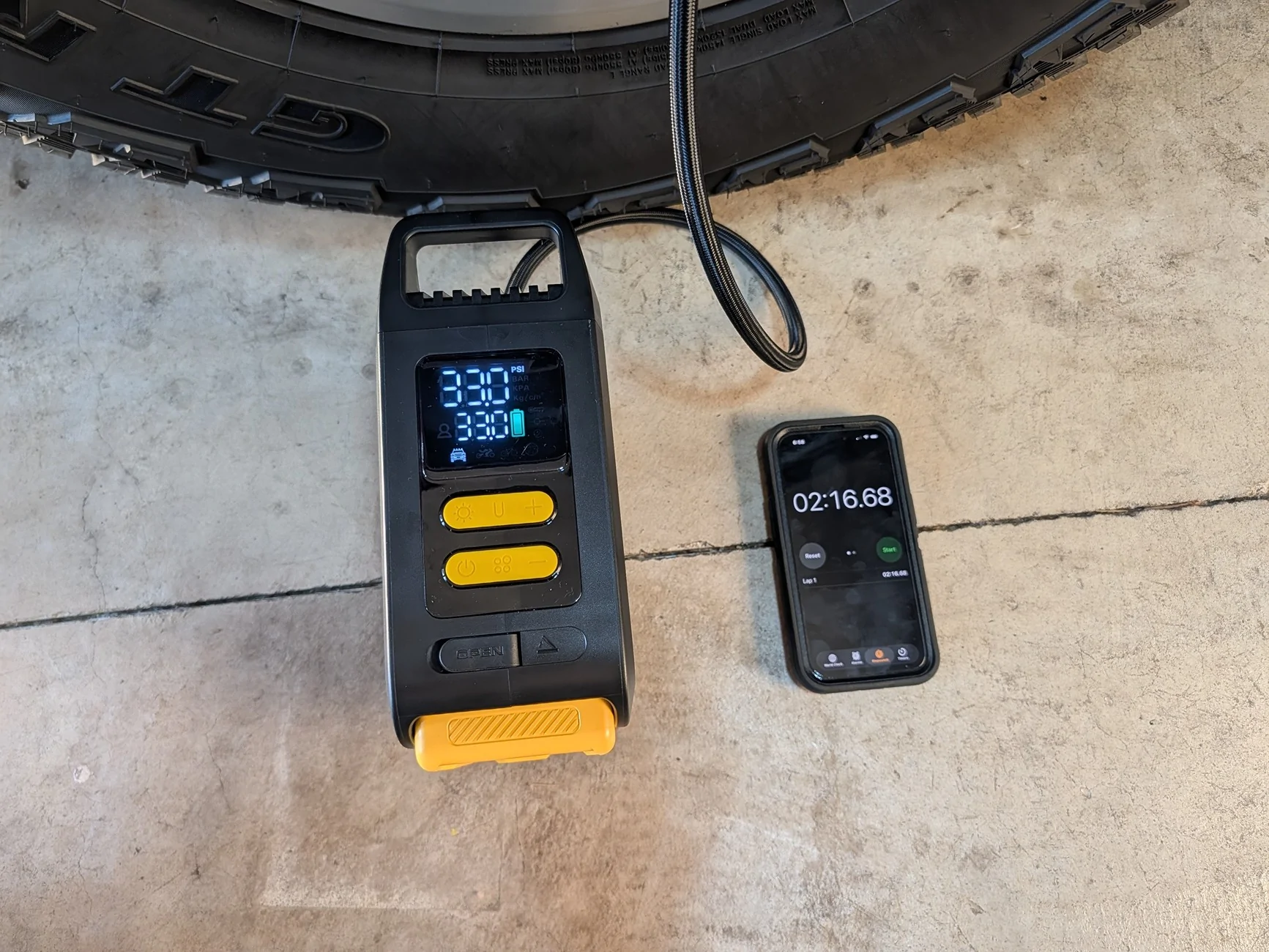

  • I used automatic deflators to deflate my 285/70R17 Tires to 15 psi (my standard off-road setting) and then inflated those tires to 33 psi (my standard on-road setting). My measured tire diameter is 32.25".
  • Before each test I confirmed the pressure with a manual gauge, then performed the inflation, and checked the final pressure.
  • If the tire was not up to 33psi, the inflator was re-connected, and time to get to the final inflation added in for the final time.
  • Multiple tires were used such that I could run the units as close to continuously as possible. The units were run until they shut off on their own.
    • Jeep Wrangler JL Auxito AT1 Inflator & Charger - Review PXL_20260409_225828274
      Jeep Wrangler JL Auxito AT1 Inflator & Charger - Review PXL_20260409_225914074

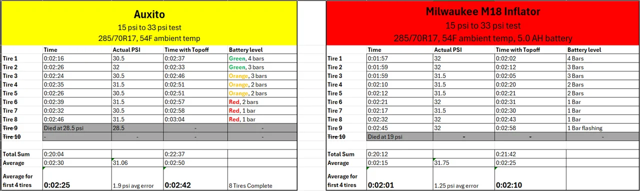

Results:
  • The average Auxito inflation time from 15psi to 33psi was 2 minutes 50 seconds. The Milwaukee average inflation time is 2 minutes 25 seconds.
  • The Auxito was able to inflate 8 tires from 15 psi to 33 psi. The Milwaukee with 5.0 AH was able to inflate 9 tires.
  • Both the Auxito and Milwaukee have a pause and recalibration step. The Auxito stops about half-way through the inflation, while the Milwaukee stops near the final pressure. The Auxito and Milwaukee both exhibited an error on the first inflation, needing to be removed and reconnected to do the final "top off" of pressure. The average error for the Auxito was 1.9 psi and the average error for the Milwaukee was 1.25 psi.
  • The sound level was measured 1 ft to the right of each unit. The Auxito was 81-83dB as compared to the Milwaukee which was 83-85 dB. The Milwaukee has a noticeably deeper and less harsh tone qualitatively.
  • After being completely dead, the Milwaukee and Auxito batteries took a similar time to recharge via 120V charging, though admittedly I forgot to time them.
  • Raw results are presented here:
Jeep Wrangler JL Auxito AT1 Inflator & Charger - Review Inflator results
Manufacturer Claims
  • "Inflate up to 20 tires on a single charge": This is a useless metric without specifics of tire size, psi, etc. In this real-world test airing up after offroading, it could handle 8 tires.
  • "built-in 26000mAh battery runs for 30 minutes continuously": In my testing, the sum of the run time was 22 minutes 37 seconds. The Milwaukee was 21 minutes 42 seconds, though the Milwaukee was able to inflate an extra tire in that time.

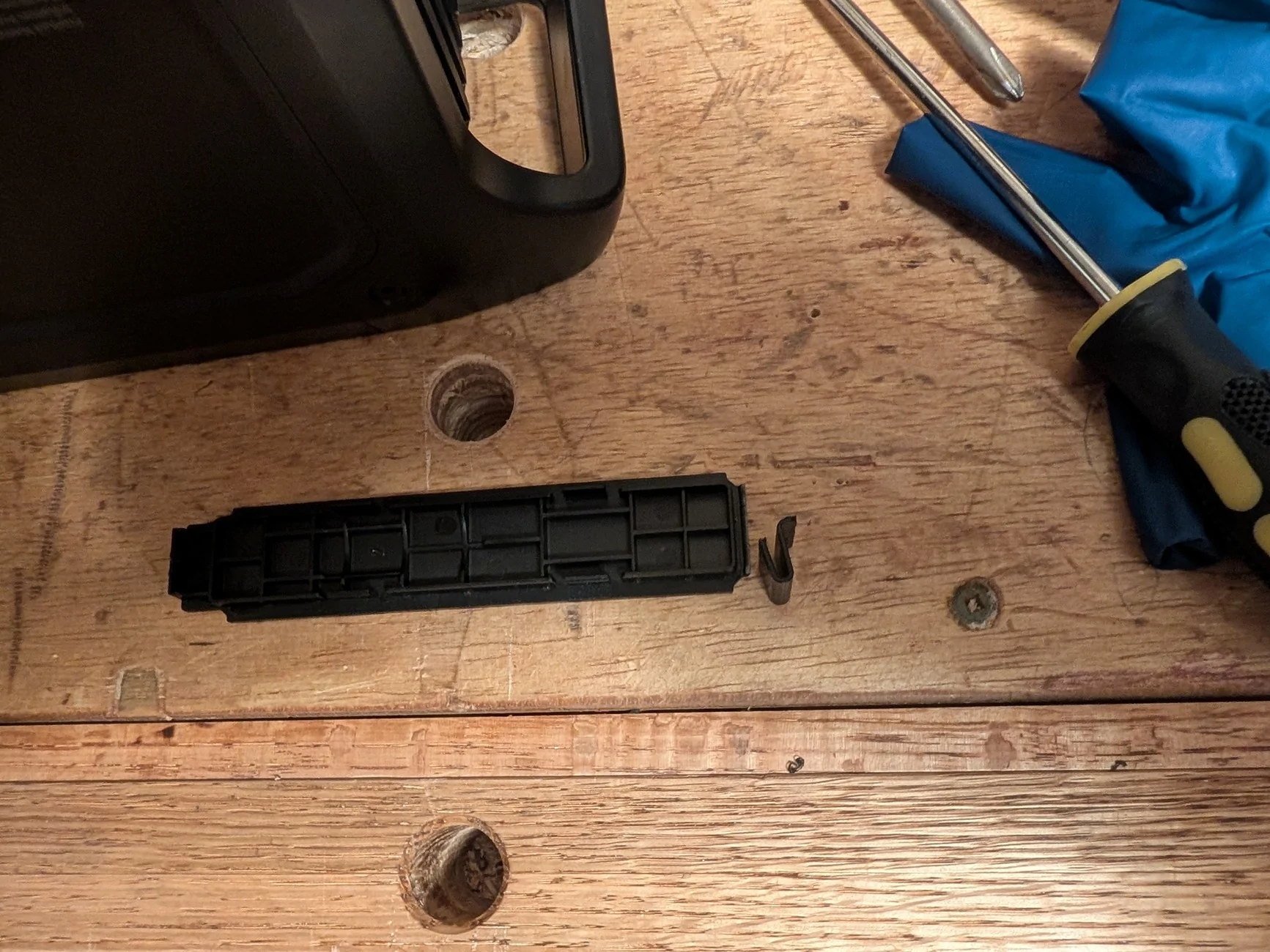

Regarding build quality, the unit is fairly cleanly built with some notable weaker points. I didn't do a drop test, but I would expect it would survive a drop from a Jeep trunk, but not significantly more. Some additional detail to qualify my statement:
  • The inflator head has brass threads only overmolded in plastic. So far this is fine, but I could see this cracking as the hose gets whipped around over time.
  • The battery retaining clip is plastic, and from my product design experience, the smaller plastic clip holding in the heavy battery will probably shear first in drop testing releasing the battery.
  • The housing door on the bottom that holds the ancillary inflation components (ball needle, pool toy inflator) is a poor living-hinge design as the material it is made from does not have a high enough yield point nor ultimate stress for the flexibility needed. It broke upon first use.
