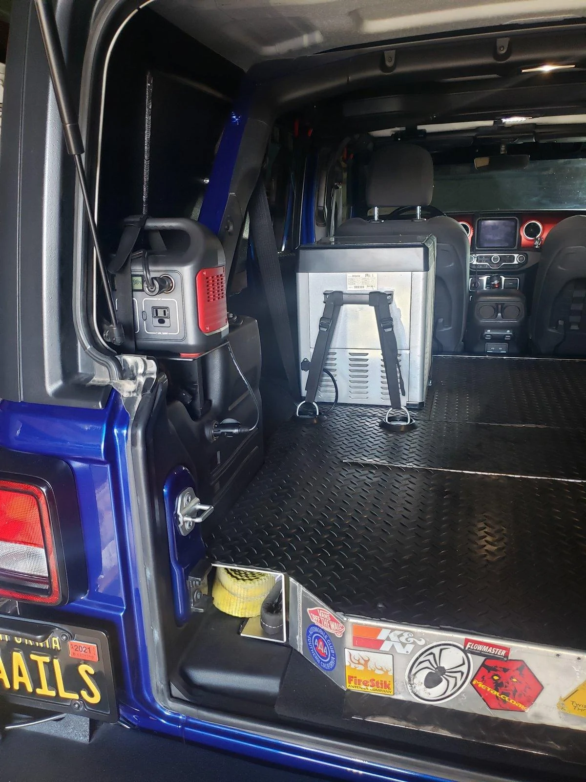

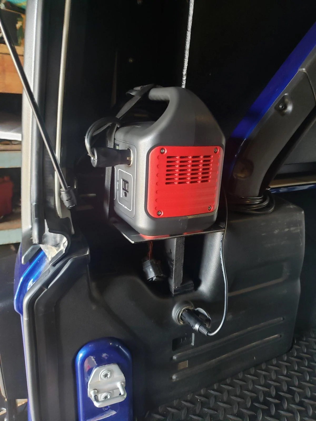

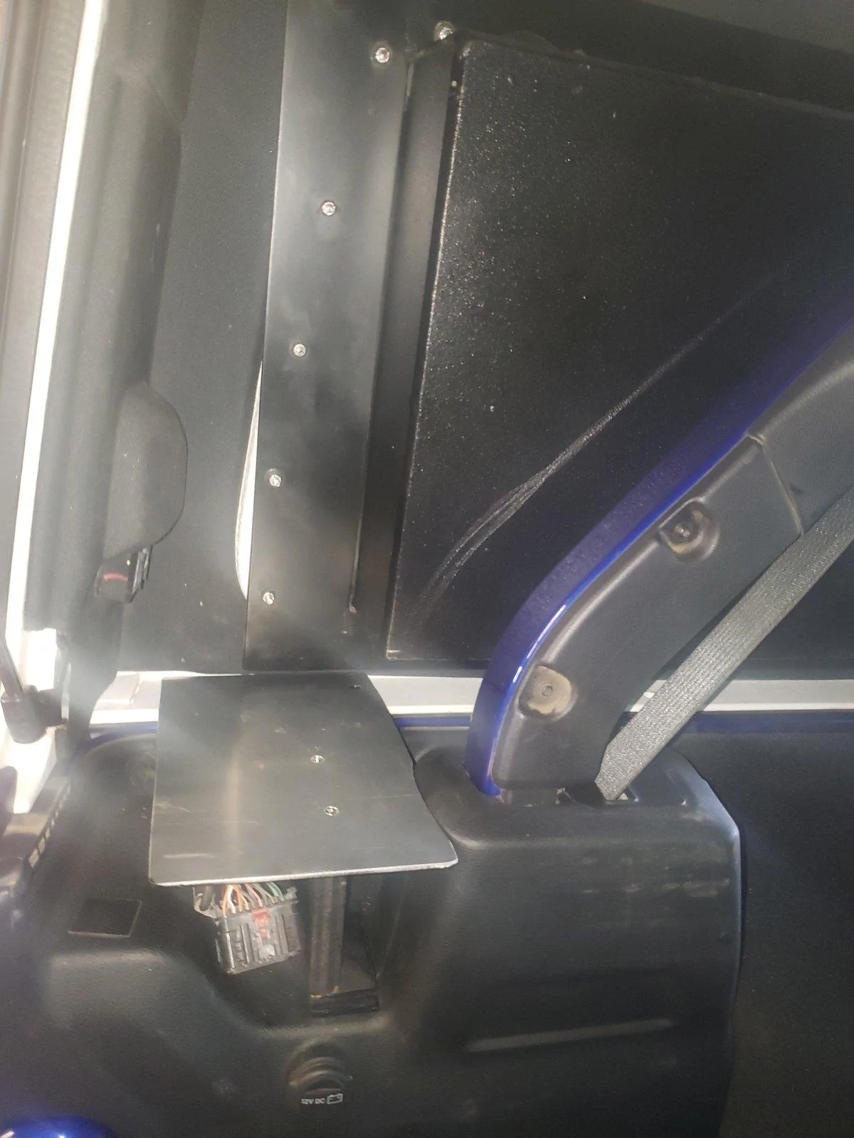

I simply made a rectangle out of aluminum with one hole for driver's side rear hardtop bolt. I supported with a block of wood with a rubber pad on it where it bottoms out to black factory trim. Painted black and bent the plate just a enough so when I tighten the bolt the block on bottom of plate snugs up to the trim above the power socket. You can barely make out the edge of plywood painted black.

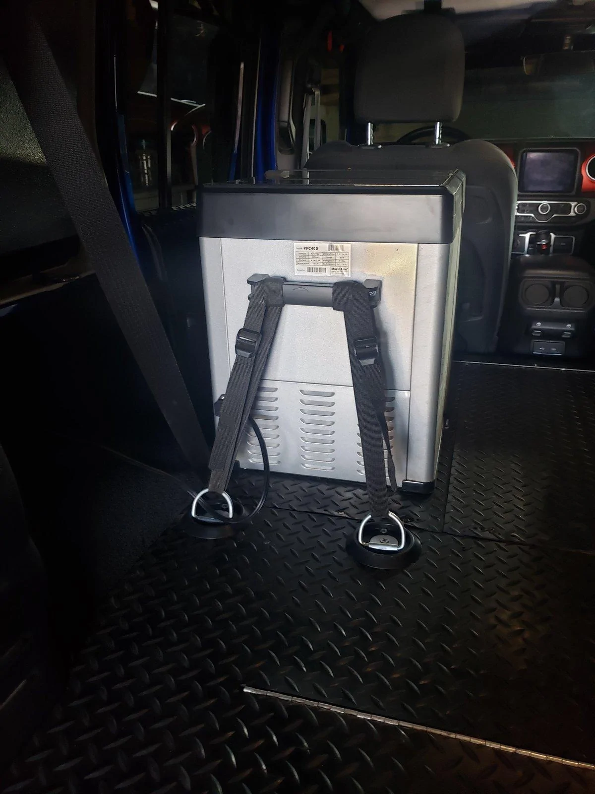

My rear cargo platform is all custom made as well. The back flips up to get to stow area in back of floor and the two panels remove from front section in 2 minutes if I want to fold either rear seat or both seats up. That way I can leave the fridge where I have it. Seems the best location for my uses. Allows full use of cargo area from back hatch or passenger door. Works for me, may not meet anyone elses needs but it's perfect for me.

Great! Thanks for sharing that. Definitely a good, clean solution.
