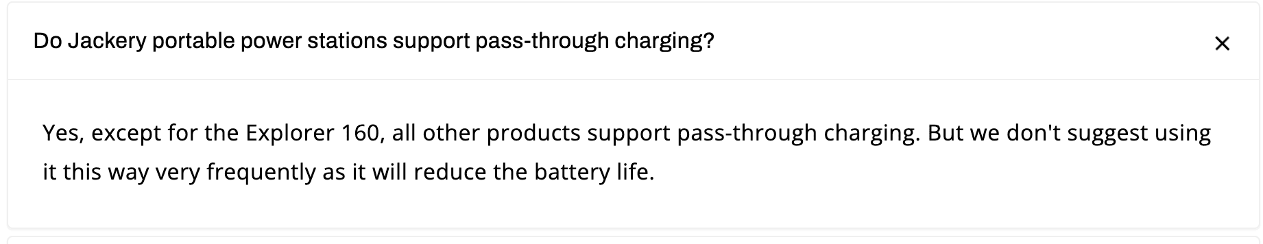

There are some conflicts between manuals and the website regarding this particular setup:
From the FAQ page of the Support section https://www.jackery.com/pages/faq:
I have a Jackery 300 I've used for pass-through charging after moving the relevant fuse to make the rear 12v outlet hot only when the engine is running. Seems to work fine with my Dometic and Iceco fridges. The Jackery is charged only when the engine is on, but the charging current likely also runs "some" of the fridge load. When the engine is off, of course the Jackery runs the fridge off of Jackery battery alone.
I'm not an electrical engineer, but I suspect that any reduction in Jackery battery life would be a function of charging current, simultaneous discharge current, temperature, etc. So it would be hard to come up with a definitive statement beyond what Jackery said above.
