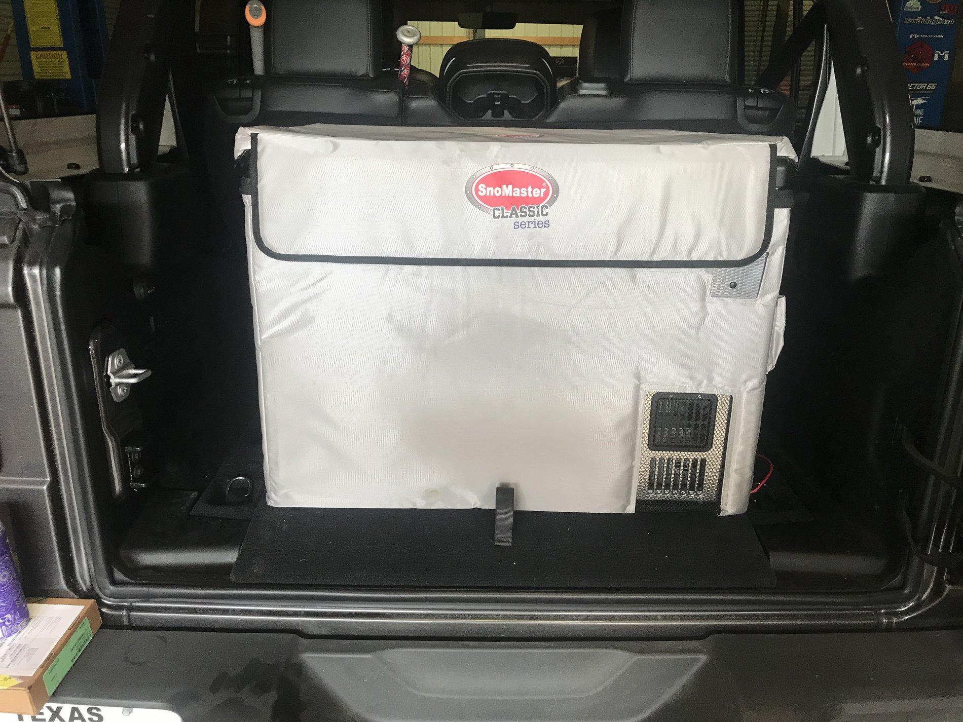

We couldn't be happier with the 12 volt refrigerator from Dometic. This unit has kept our food fresh and dry all the way to Gettysburg and back to the southwestern United States.

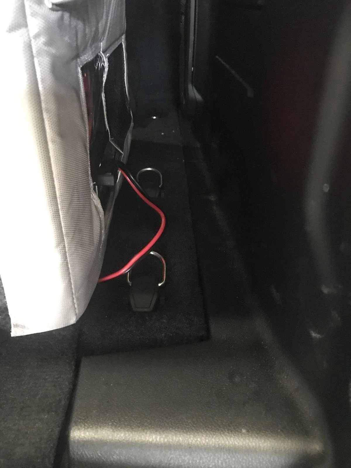

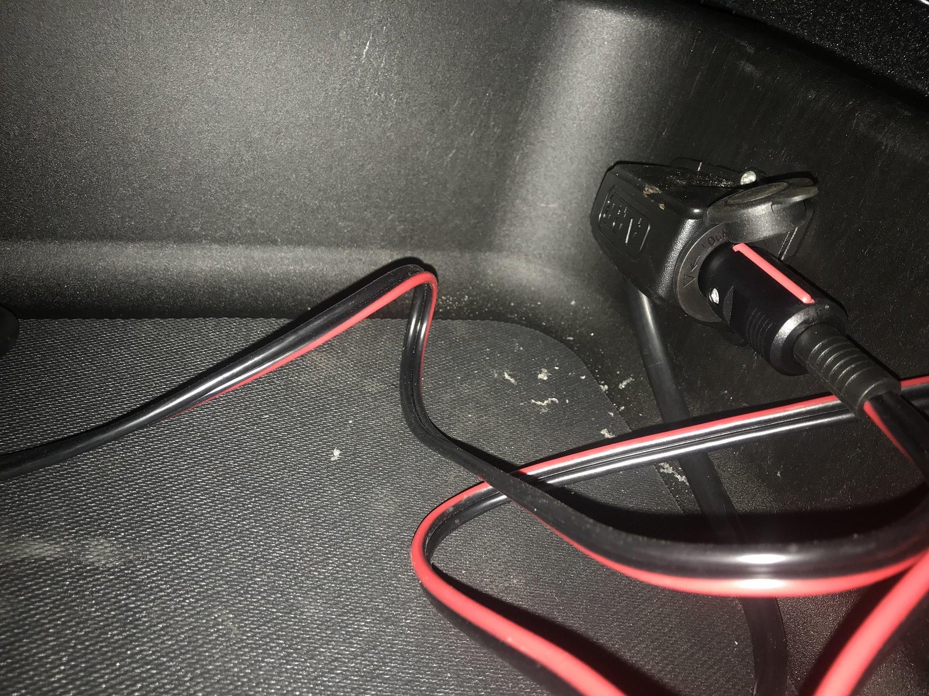

I need to do something like this! Did you run a new wire or just tap off the 12v socket already there.![]()
I know many of you have done this but moving your 12v plug/socket saves a few precious inches of cargo space.
run a wire, don’t tap in . You can run a wire for the fridge in the back in about 20 minutes that includes putting in the power outlet.I need to do something like this! Did you run a new wire or just tap off the 12v socket already there.
Thanks but I'm only plugging in a 500w Jackey. That plug just sticks out and I'm afraid to break it off moving stuff in and out. Like to move that socket out of the way.run a wire, don’t tap in . You can run a wire for the fridge in the back in about 20 minutes that includes putting in the power outlet.
Your fridge will be more efficient on its own line. We have been out almost 5 months with a 47qt ARB fridge in the back of the jeep with zero issues. We run an 800 amp single battery. We have been running the fridge this way for a couple years now.

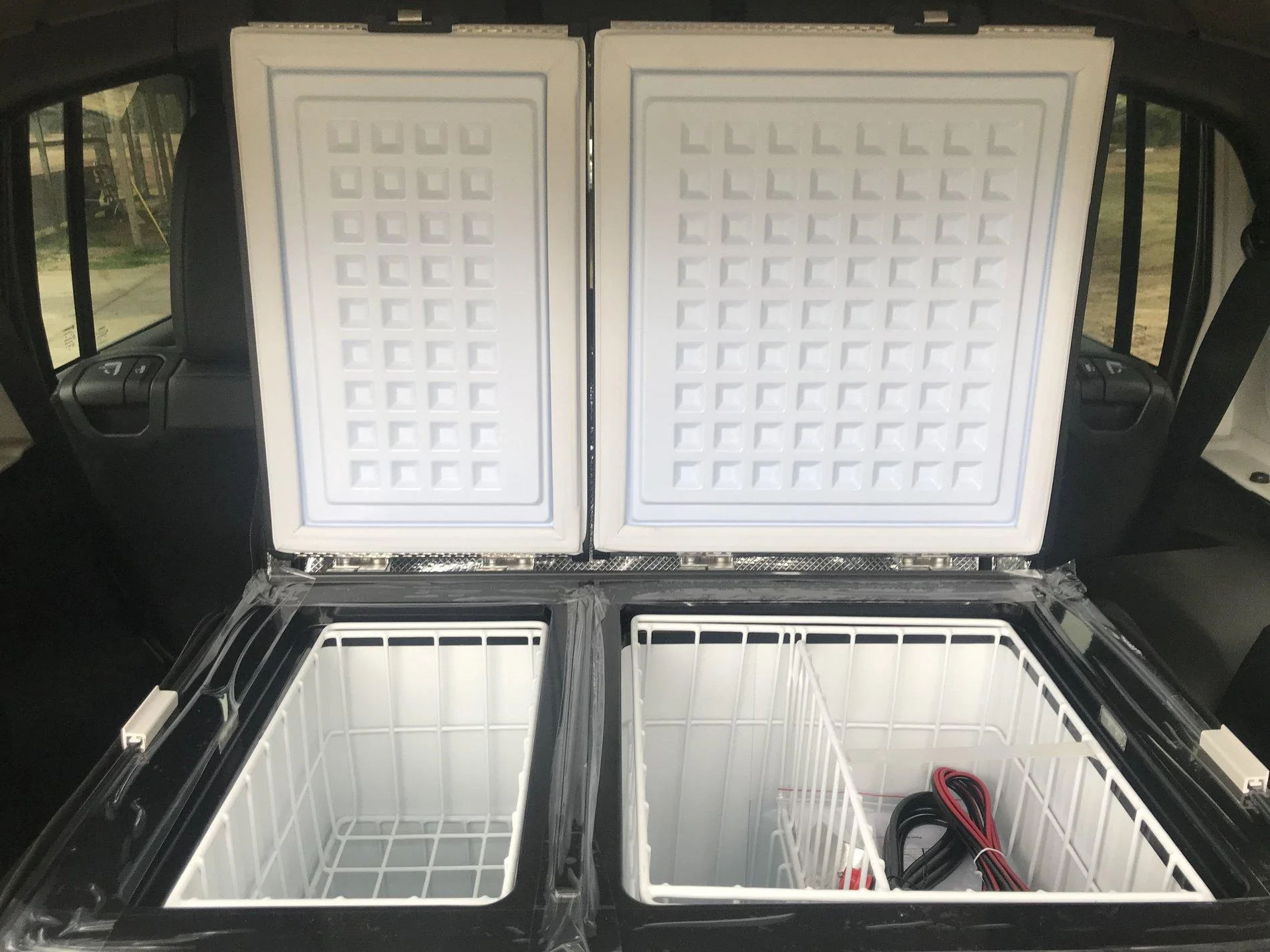

I will give you my personal experience with a number of 12v fridge/freezers. I currently own the Iceco JP 40, Iceco gogo 20, and Engel MRO40F-U1 40 QT. I currently use the Iceco JP 40 in the back of the JL. I have used it for over a year now with no problems. Plenty of room and light weight. Nice dimensions for my configuration. Has not shut down under steep angles and Iceco states it can be operated up to 40 degrees angles. One of my main concerns is power draw. On normal mode when compressor is on it uses 2.2 to 2.4 amps. Max mode it uses 4.2 amps. The Iceco gogo 20 is dual zone and it seems to draw a little more in dual zone. One zone being refrigerated and the other being freezer mode. If I remember it was about 4 amps when compressor running. I have had it shut off once because of steep angles. Since that time I have gone over the same angle and never have shut off again. The Engel is one of my favorites using 3.2 amps. I have not used it in the Jeep because of size and the way I have the cargo area set up. But I have had the Engel for over 5 years and not one problem with it. I have friends with both ARB and Dometic. What I have experienced is both of those brands use at least twice the power draw of the Iceco and the Engel. Could there be a difference in insulation? Might be but I have not seen in my experience any difference that would make me want to go with ARB and Dometic for that reason. Are they quality units? You bet! I would love to have a 40 qt. dual zone but have not found a quality unit in that size. Iceco has a new model VL45ProS that I have my eye on.Hi guys,
