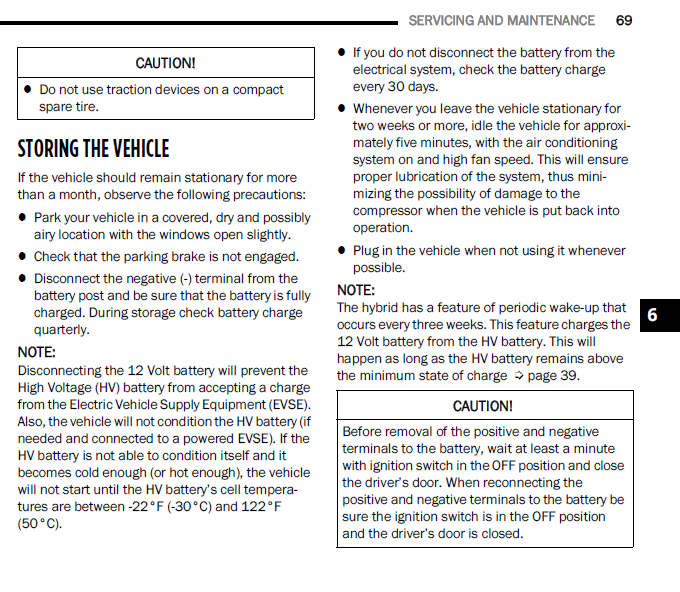

Yeah, Tyler's the 4xe battery charging expert ?
With a dead 12v battery, the systems won't power on enough to even charge or use your L1 or L2 charger, for safety reasons. Doesn't matter how much delicious power is in that big battery under the back seat, its useless without 12v to run the BMS (battery management system). This is the case for all EVs and hybrids I'm familiar with. Not dissimilar to any car starting, really. The great news it it takes hardly any juice to power on the computers, so a little pocket sized jumpstarter is great for it. Then leave it in the ACC or RUN position for a while and it'll charge the 12V battery faster than any other charger you have.
Tips for the future:
1. Keep a little lithium jump starter power pack in your jeep for just this case (and more likely for helping others out!) those things are almost cheaper than decent jumper cables anyway, and you don't need another running vehicle!
2. According to the manual, if plugged into a L1/L2 charger for many days, it's supposed to intermittently wake up and check the SOC and charge if necessary, but I don't think we've witnessed that behavior. It's also supposed to do this to check the battery temperature and heat/cool it if necessary. While this occurs it *should* also charge the 12V battery if it feels like it.
3. In case #2 doesn't work, you could also connect a small NOCO or Battery Tender charger/maintainer. These are great for stored vehicles - I've got one on my WJ right now. One of those little solar panels plugged into the rear 12V socket should also work (make sure the fuse is set so that it's always on as described in the manual)
The Jeep manual says to disconnect it, then it says if you don't disconnect it, very confusing.
