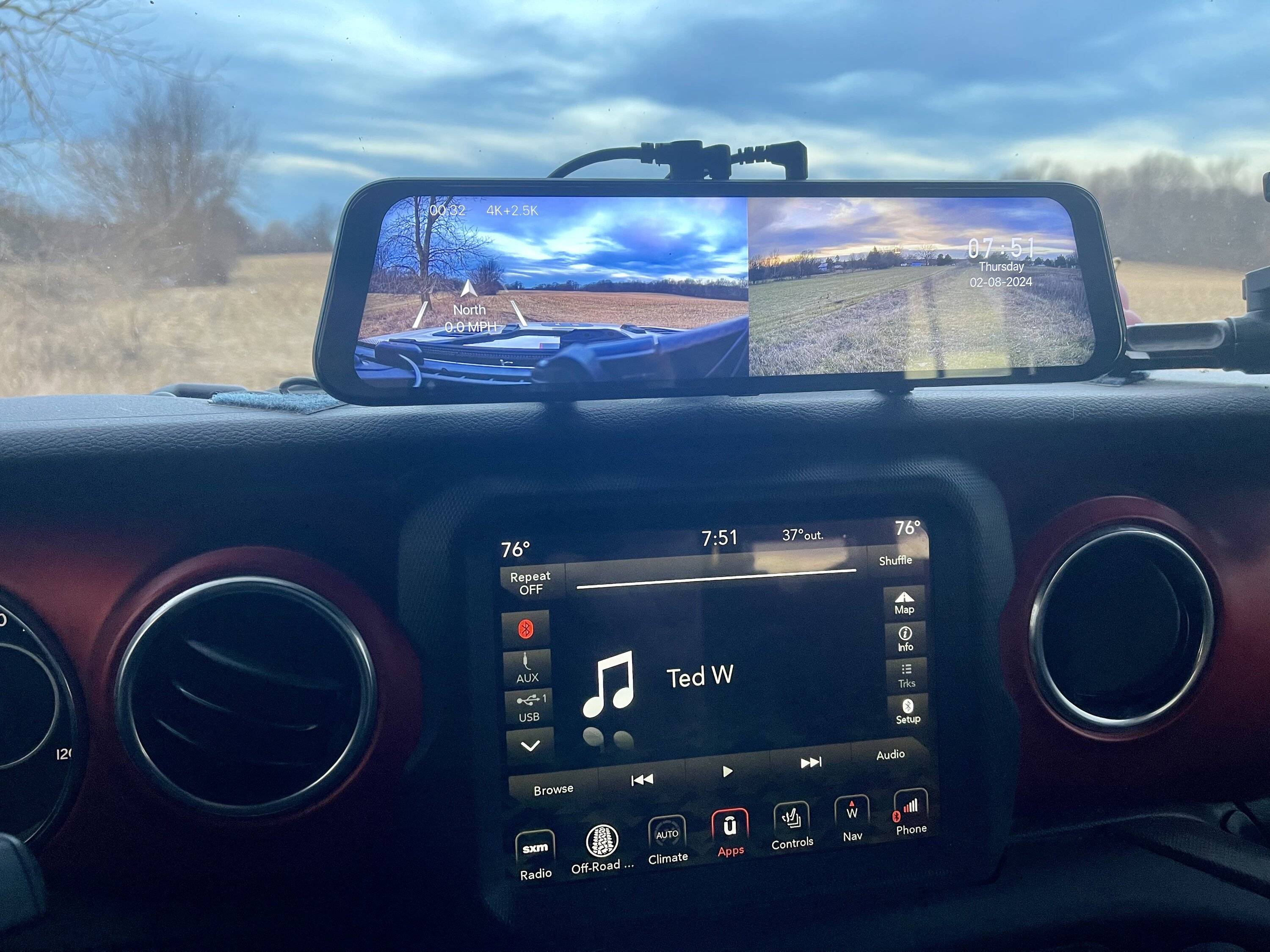

The display is a 12in touch screen that can display the full view of the front camera, the full view of the rear camera or do a split screen and display both camera views.
Jeep Wrangler JL The Wolfbox G900 4k Front Camera 2.5k rear camera Dash Cam System. My review of it The Pros and Cons IMG_0168
To change the view, you just swipe left or right to get the view you want . Super easy to use.

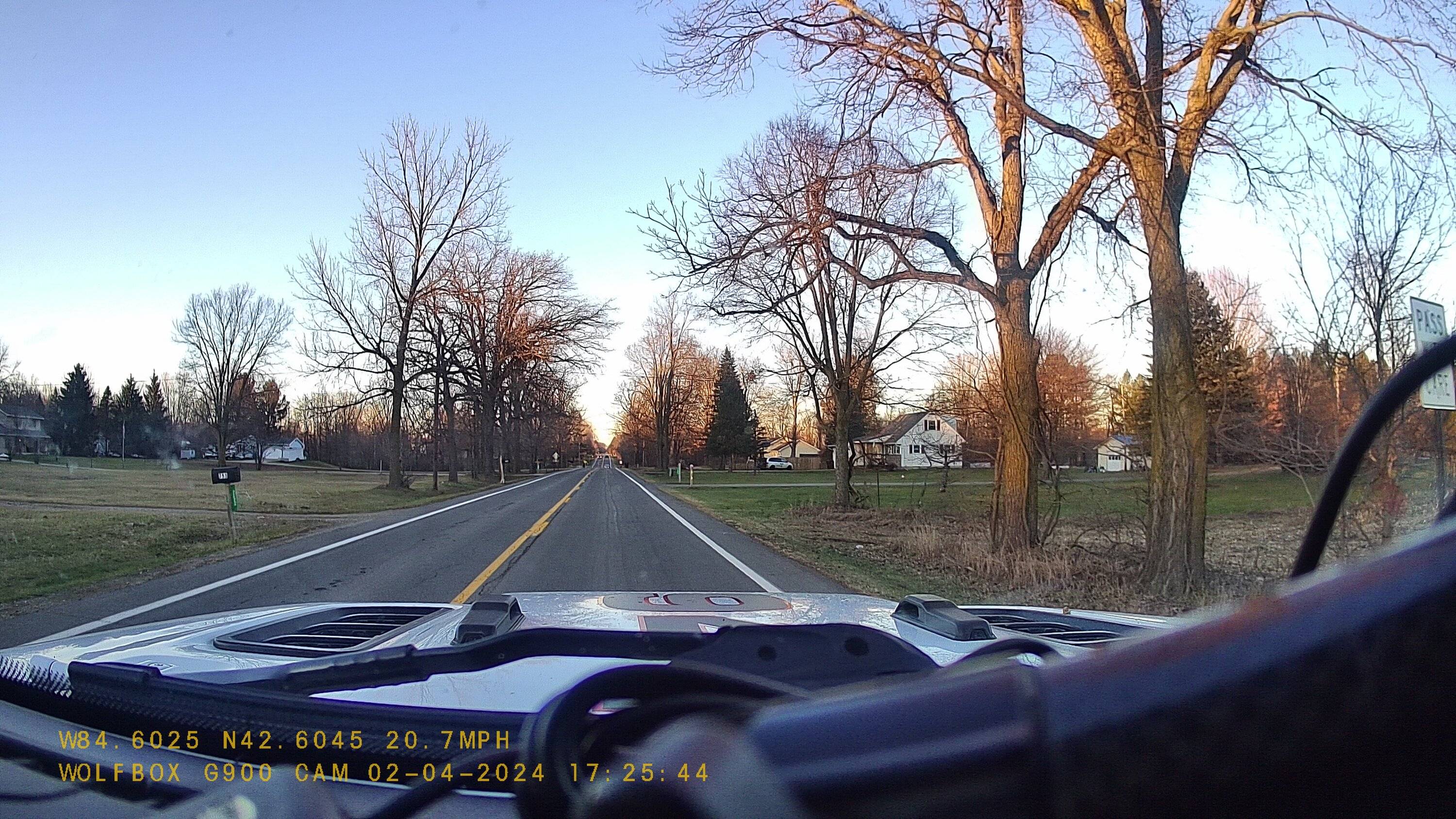

The front camera photos first.
Jeep Wrangler JL The Wolfbox G900 4k Front Camera 2.5k rear camera Dash Cam System. My review of it The Pros and Cons 2024_02_04_142931_00.JPG
Jeep Wrangler JL The Wolfbox G900 4k Front Camera 2.5k rear camera Dash Cam System. My review of it The Pros and Cons 2024_02_04_143023_00.JPG
I like this shot a lot.

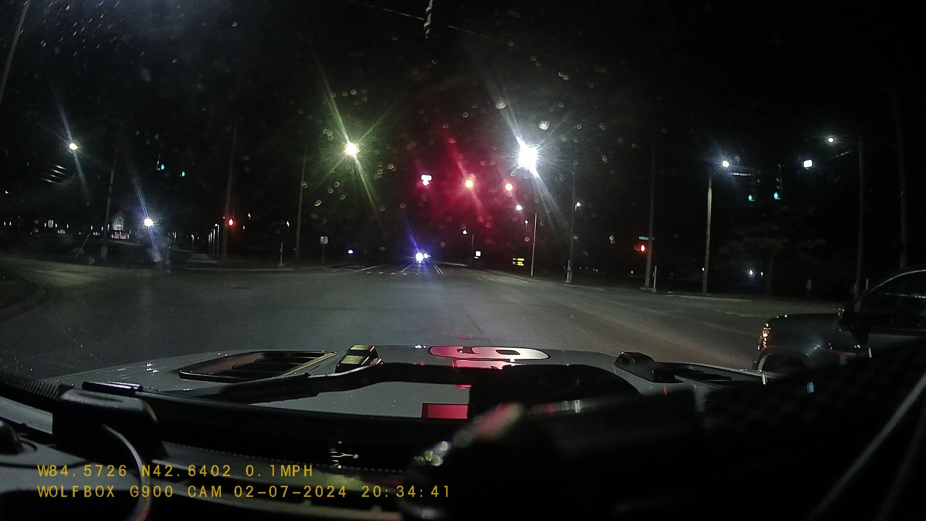

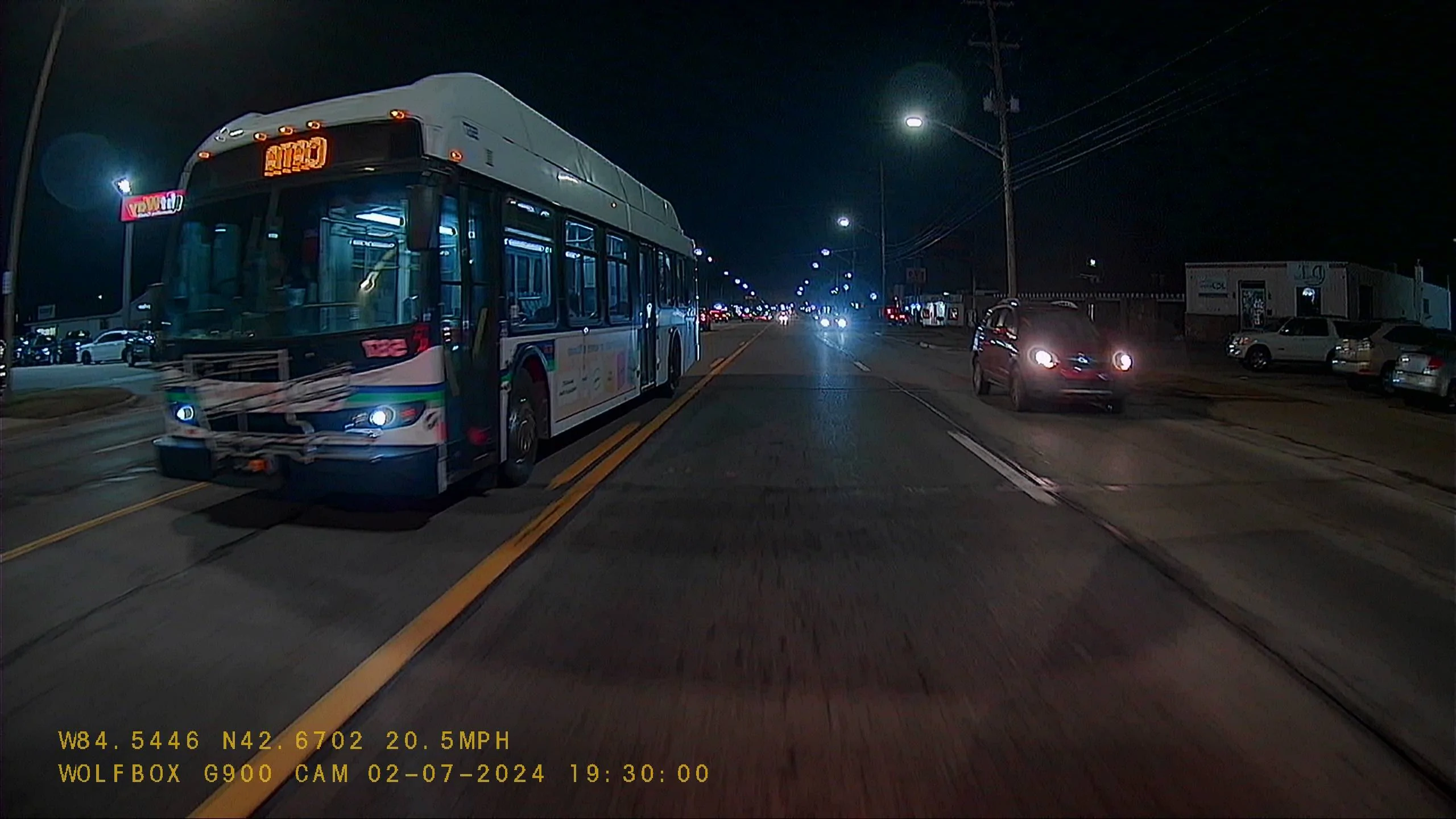

Later in the week, some evening driving and night driving gave me an opportunity to grab some more shots.
I like the hood refection in this shot. Yes, seeing this photo, I know I need to clean the windshield again. LOL.

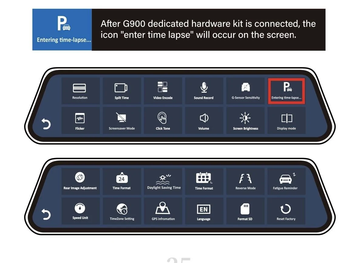

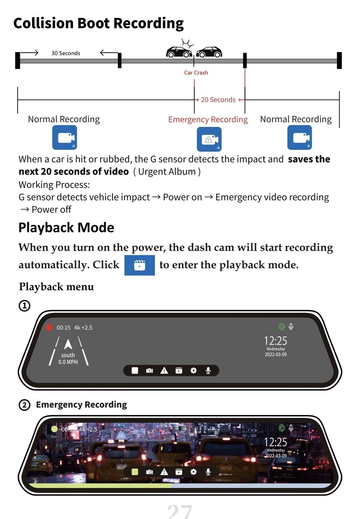

So to explain what the Timelapse mode does, I pulled these from the online manual.
Wolfbox G900 Instruction Manual

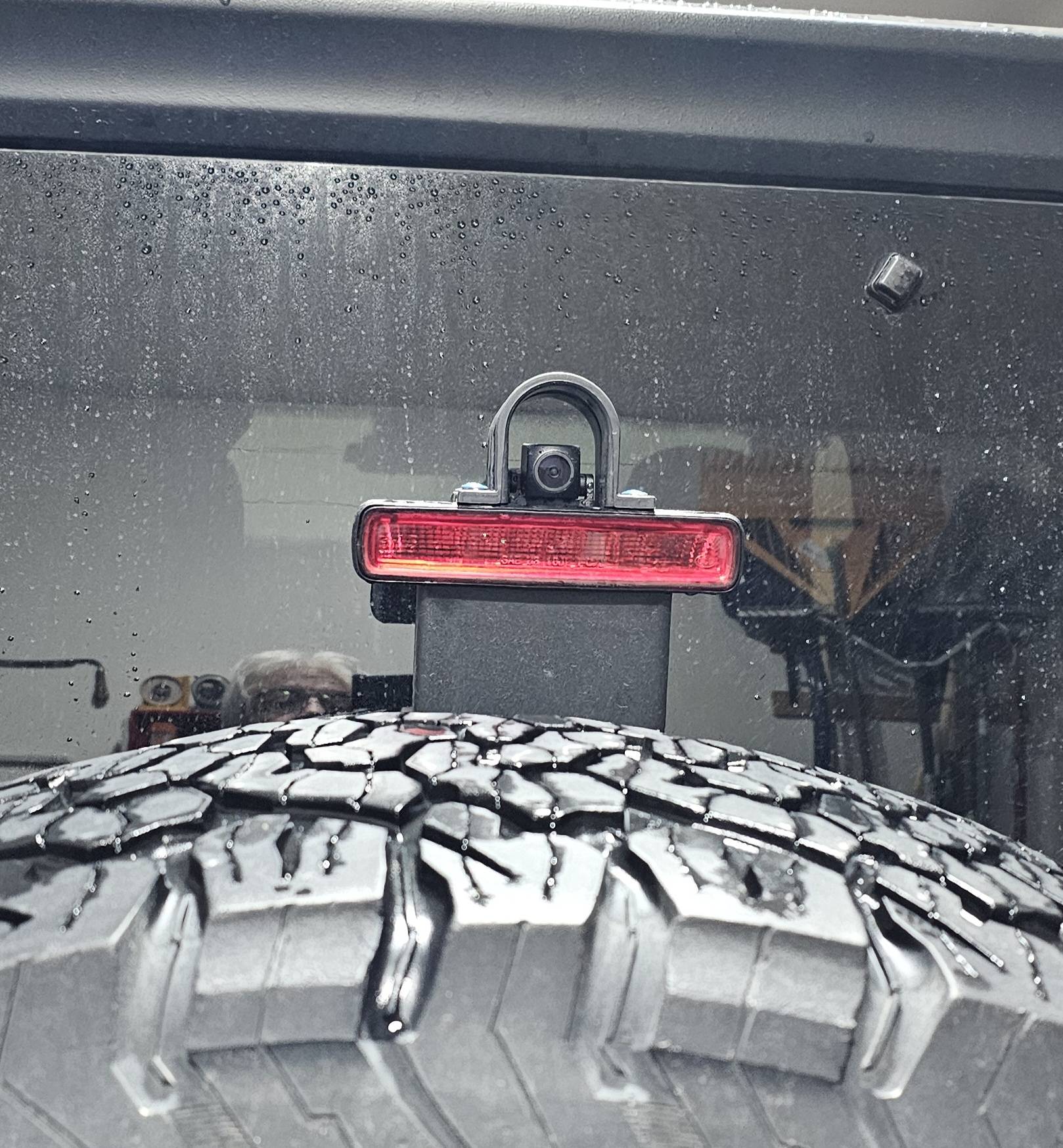

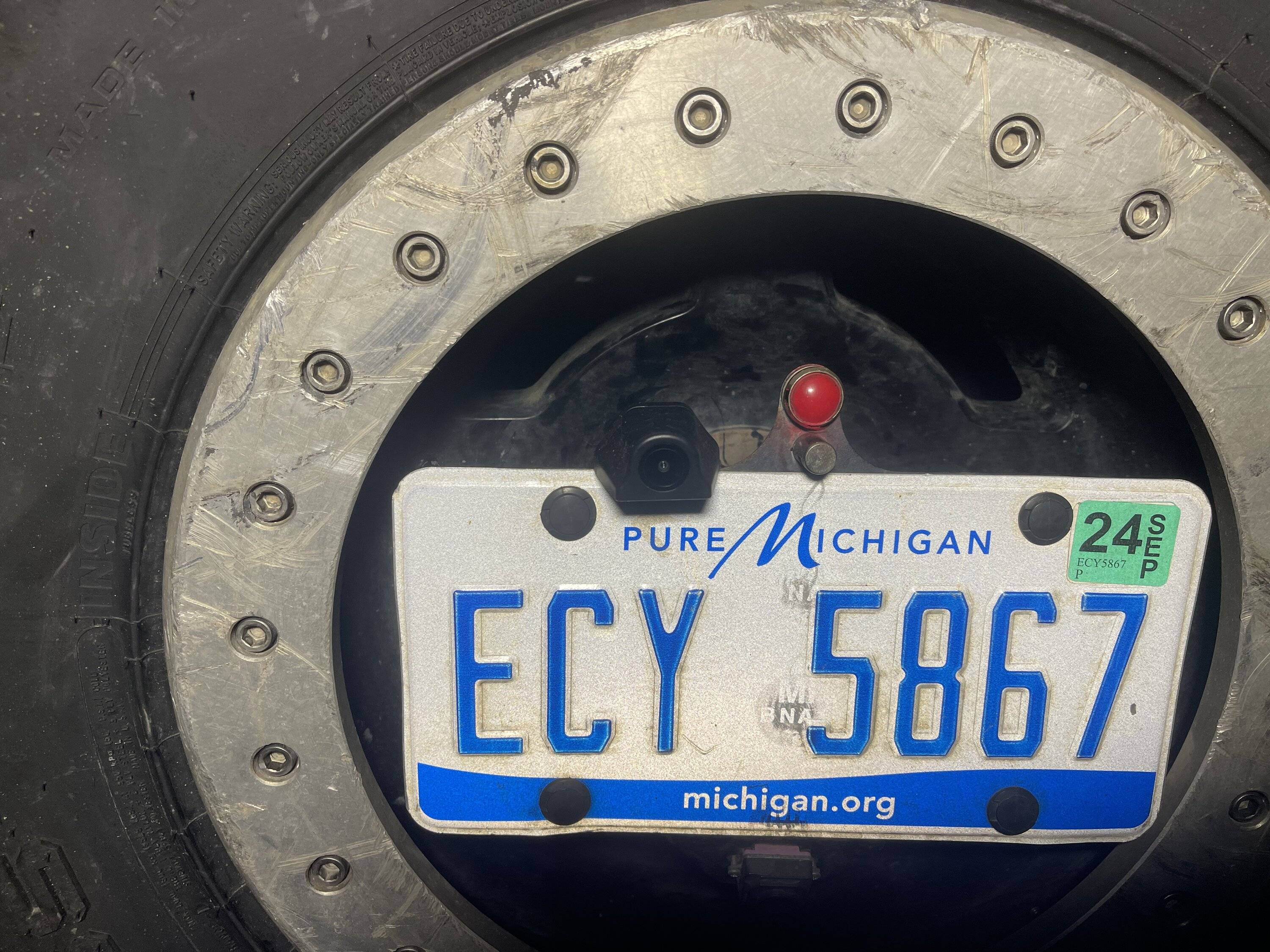

I have found so far that with the rear facing camera being mounted inside of the spare tire, that rain, drive through car washes and such has not caused a problem with the camera. The G900 came with a couple brackets to make it easy to mount to just about anything.

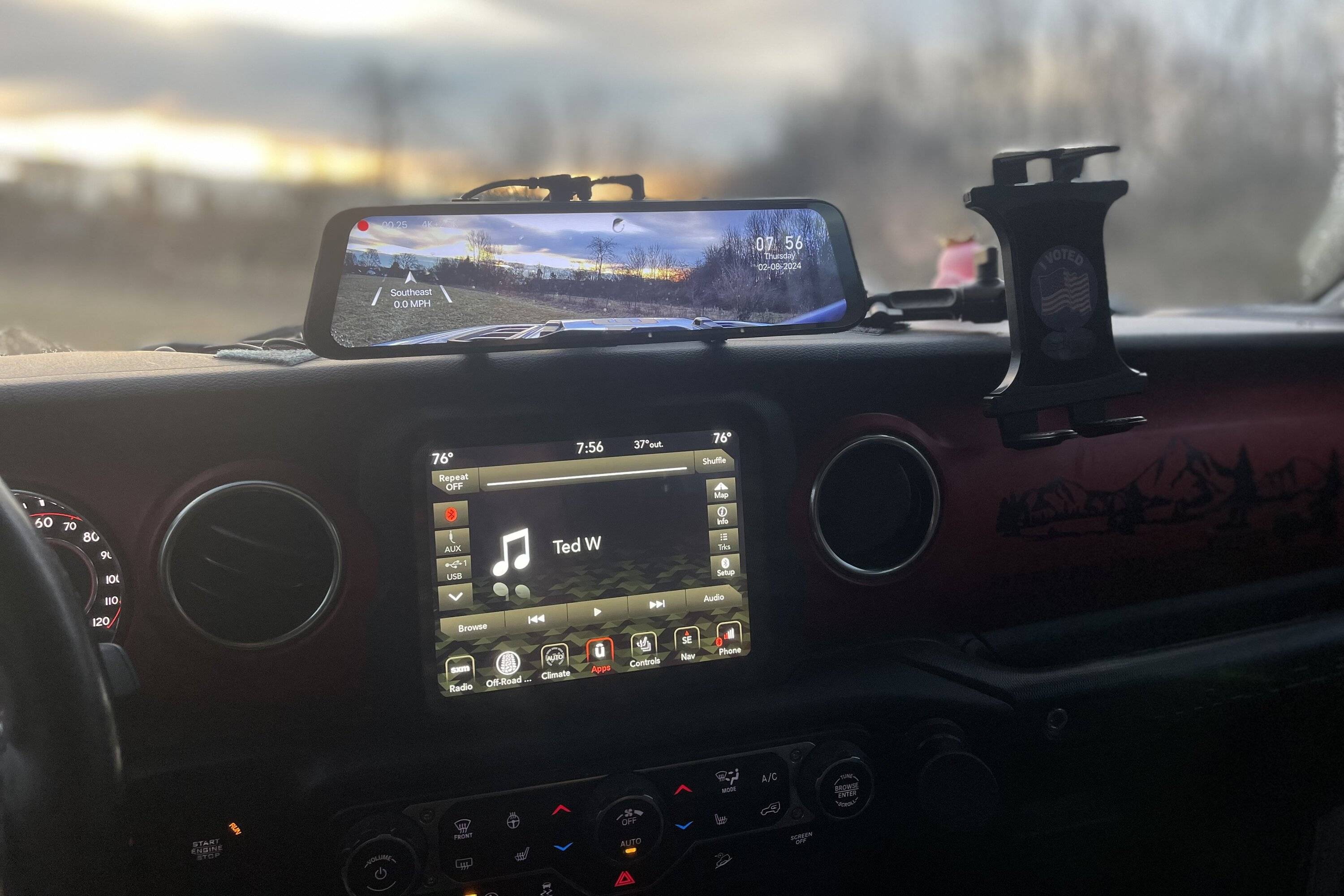

So with that said, some info on the G900 dash cam, The front facing camera is made to be attached to rear view mirror. I do not have a rear view mirror as I removed it about four years ago. It was worthless in my Jeep because my 37 inch spare tire takes up almost the entire rear window. So I mounted it on the dash with a ball to a 67 Design mount and arm. I ran all the wiring inside of the dash. I hard wired it to the fusebox and the battery under the hood for power. It requires one power wire that is hooked to acc power and one power wire that is constant power and a ground wire. The system also monitors battery levels so it does not drain the battery so the Jeep will not start. That's a big bonus. The camera does a Timelapse mode when the Jeep is off. Then fully powers up with the Jeep ignition is turned on. This is what the dash cam looks like mounted on the dash of my Jeep.

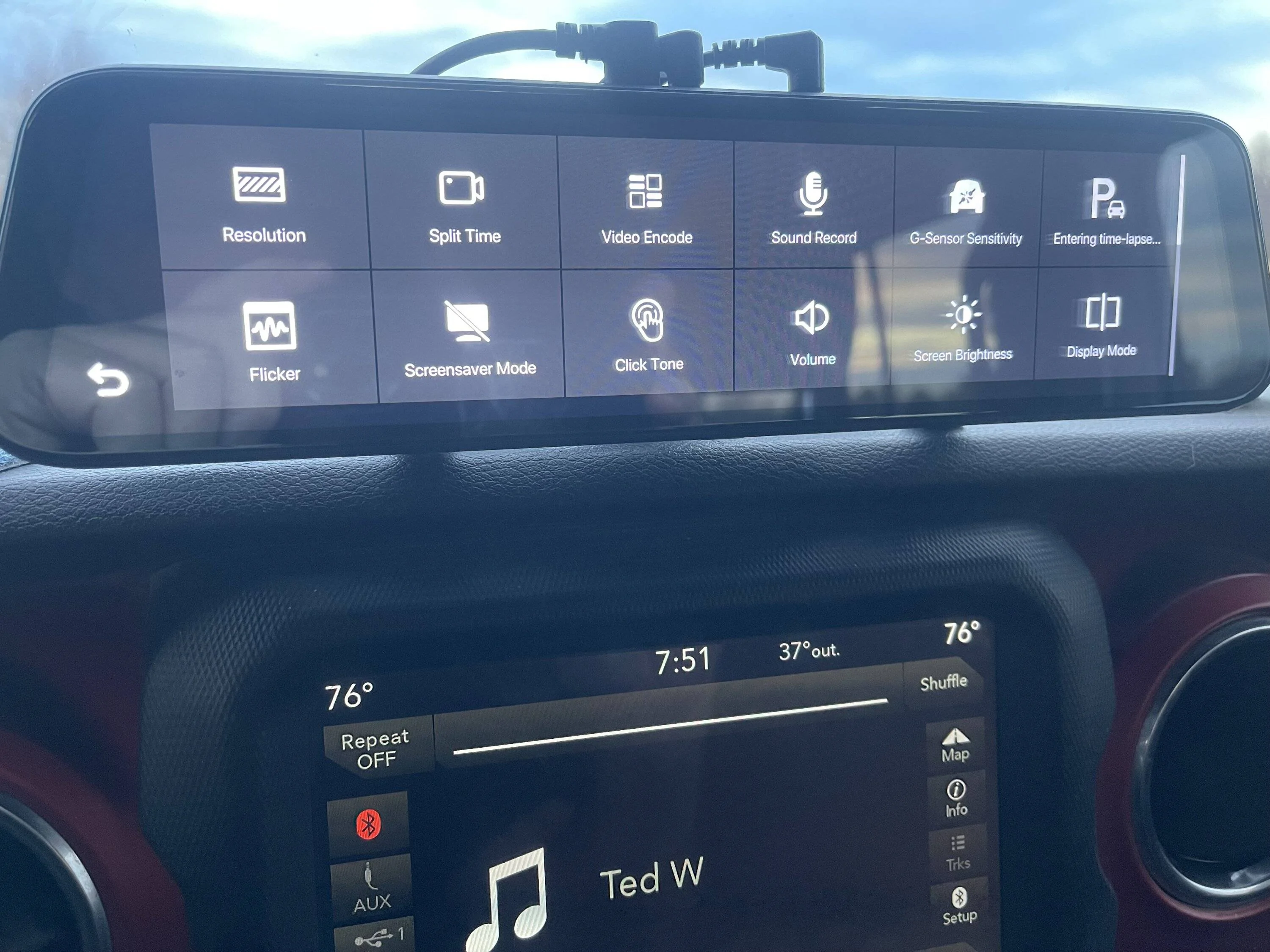

If you touch the screen it will pull up icons. The icons allow you to stop the current recording and start a new recording, if you click the camera icon it will take a still shot photo. The icons are pretty much self explanatory.
You can also playback footage through the touch screen.

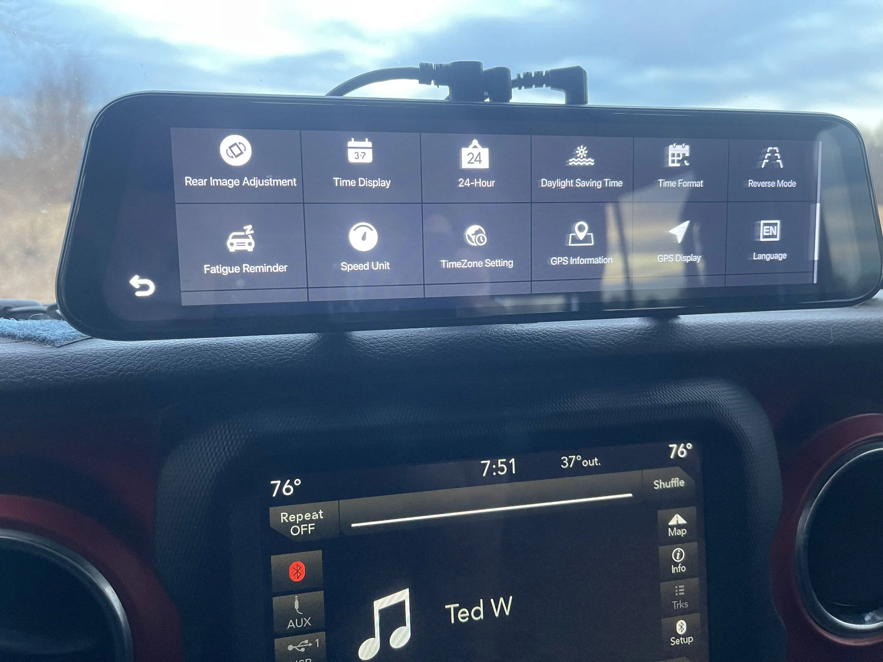

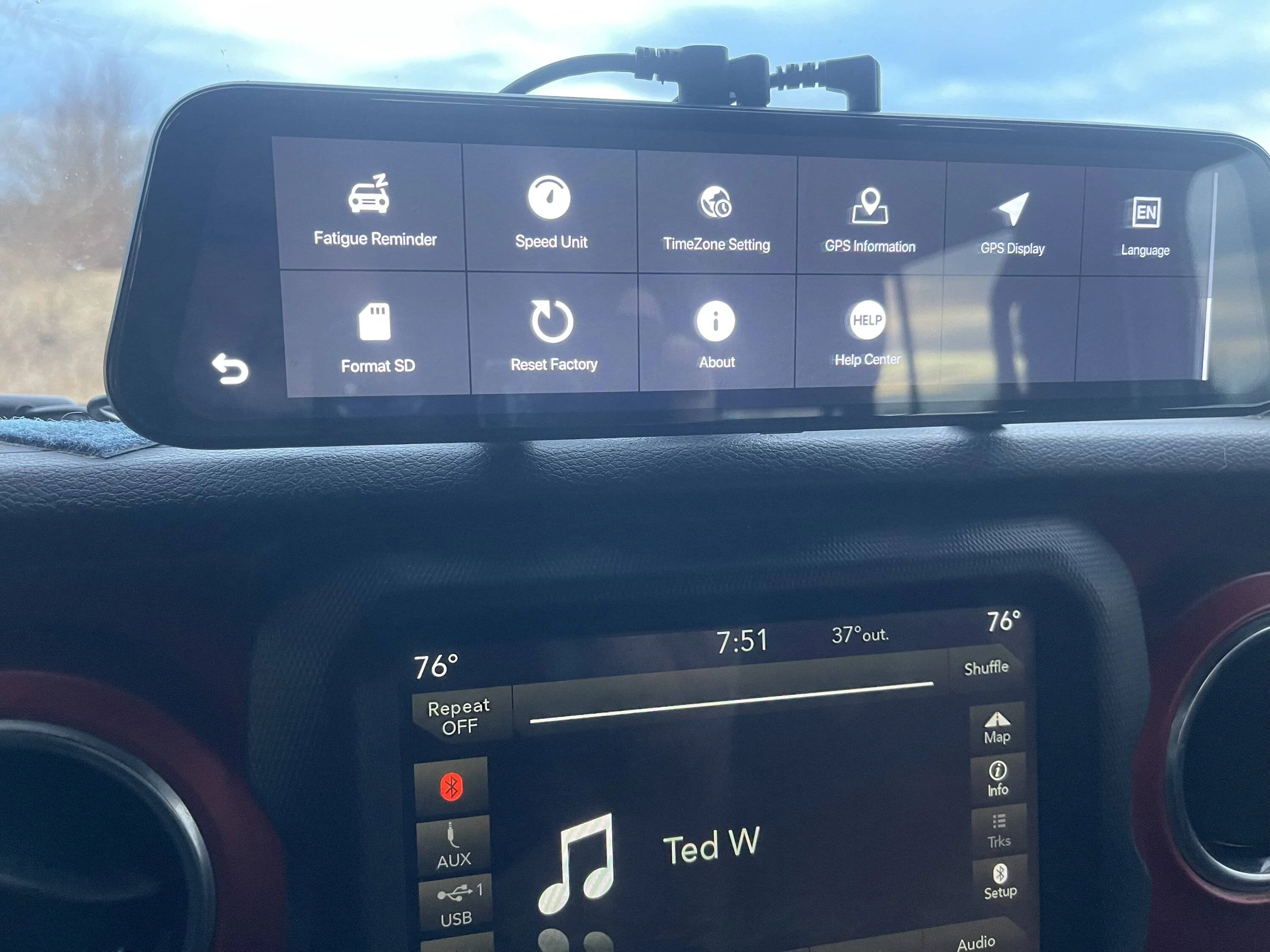

In the setting screen there are a bunch of icons to adjust the operations of the cameras.

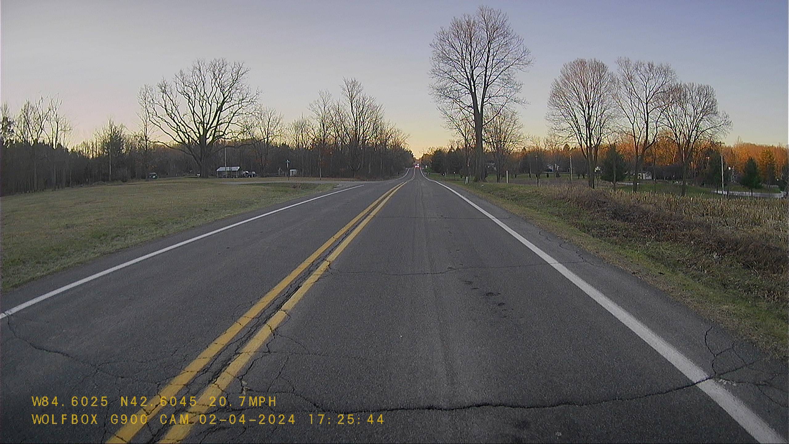

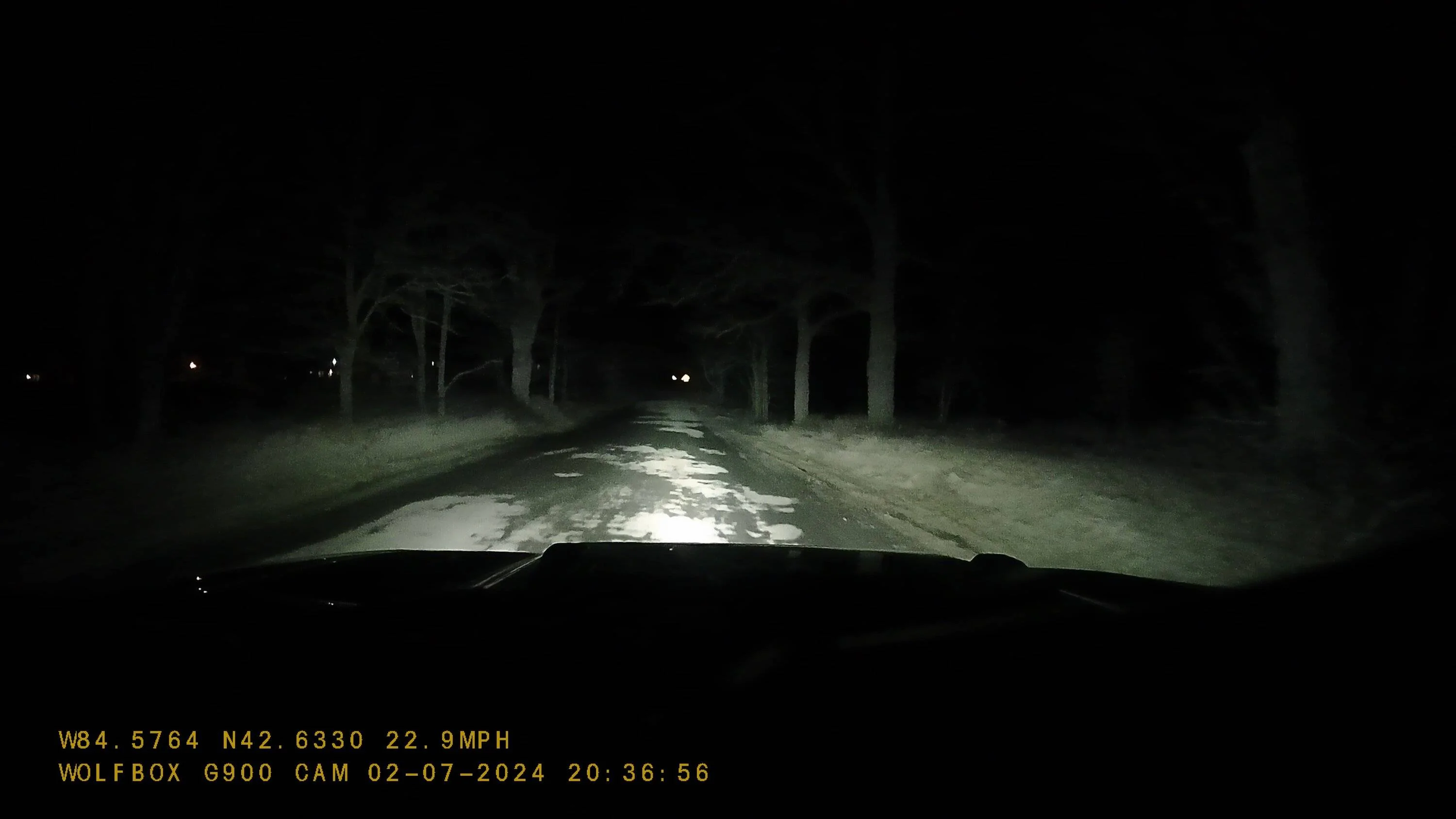

On to the rear camera. The rear camera is a 2.5k camera. With a Jeep it is very easy to hide the wire running to the back of the Jeep for the rear camera. I videoed the install process so you guys can refer to it if you purchase this camera.

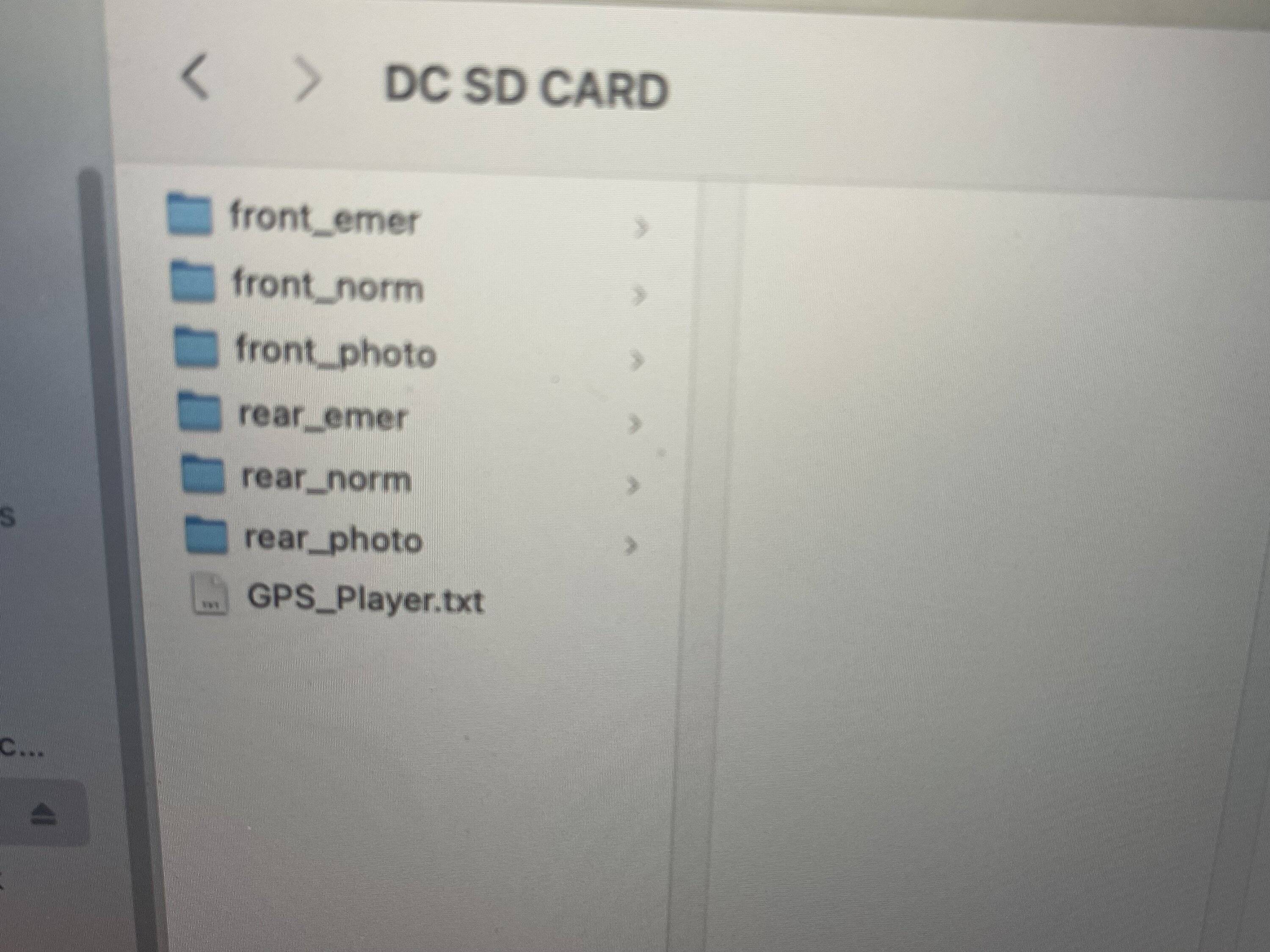

The G900 came with a SD card. The camera creates and easy file structure so videos and photos are easy to find and off load.

Pro the rear dash cam can be mounted just about anywhere. In the setting, you can flip the camera and mirror the camera so it displays correctly So you have lots of freedom on how and where you mount the camera. You could even mount it on the front of the Jeep for a front trail camera. I put my rear facing camera on the top of the license plate. I do not use it as back up camera. It has that option, but our Jeeps already has a nice back up camera. I find myself leaving the display set to the back facing camera often so now I have regained my rear facing mirror.
