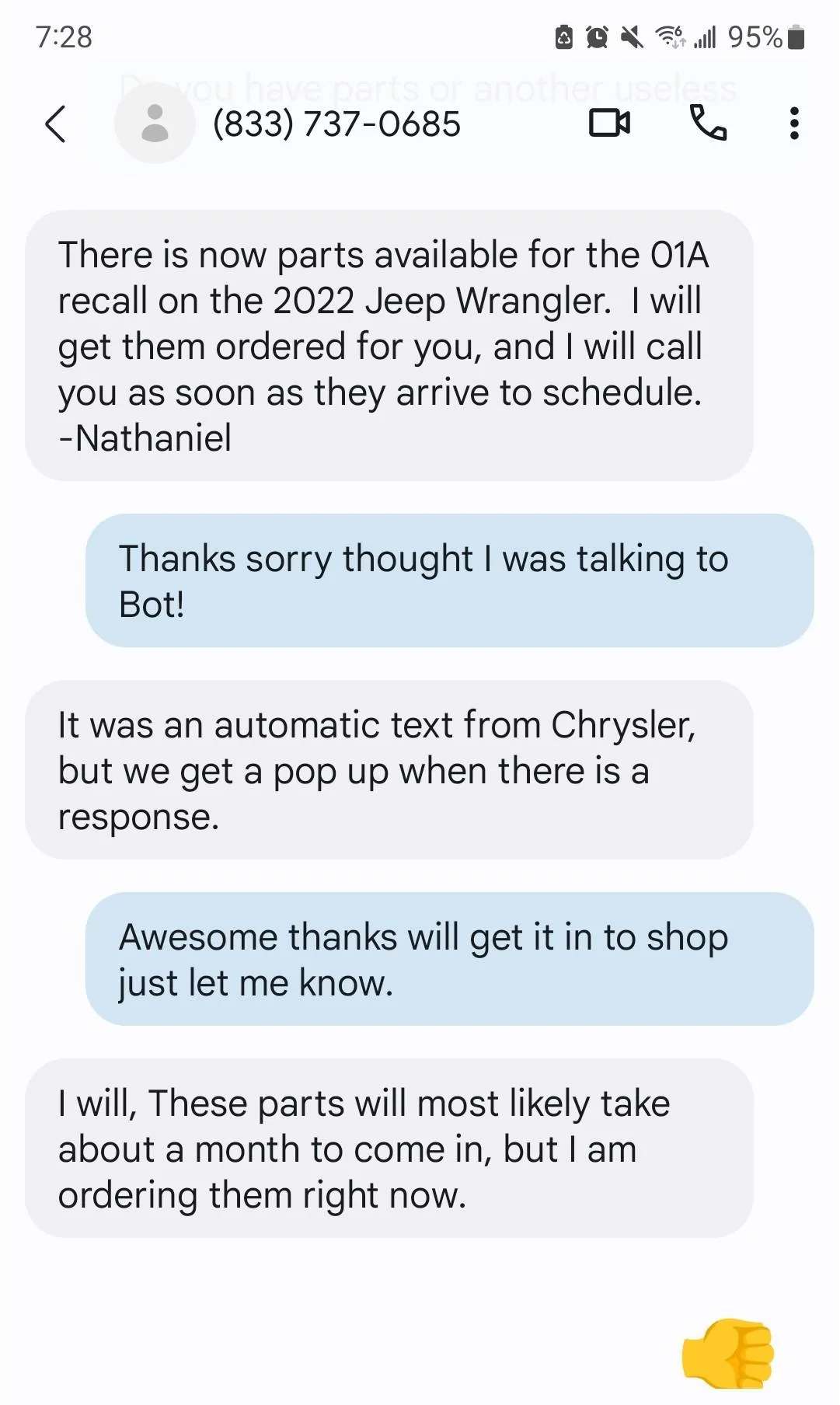

My dealer contacted me and this recall has so many different numbers. Called mine 01A and I was confused. They have contacted me for months about recall. But there was no real person answered. I think I said stop sending me these useless messages. Then a human came into it. LOL
