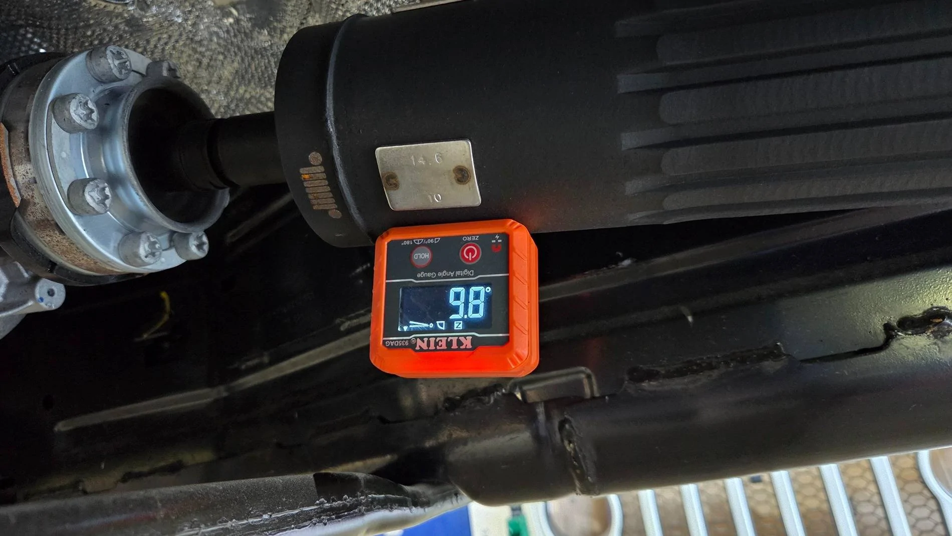

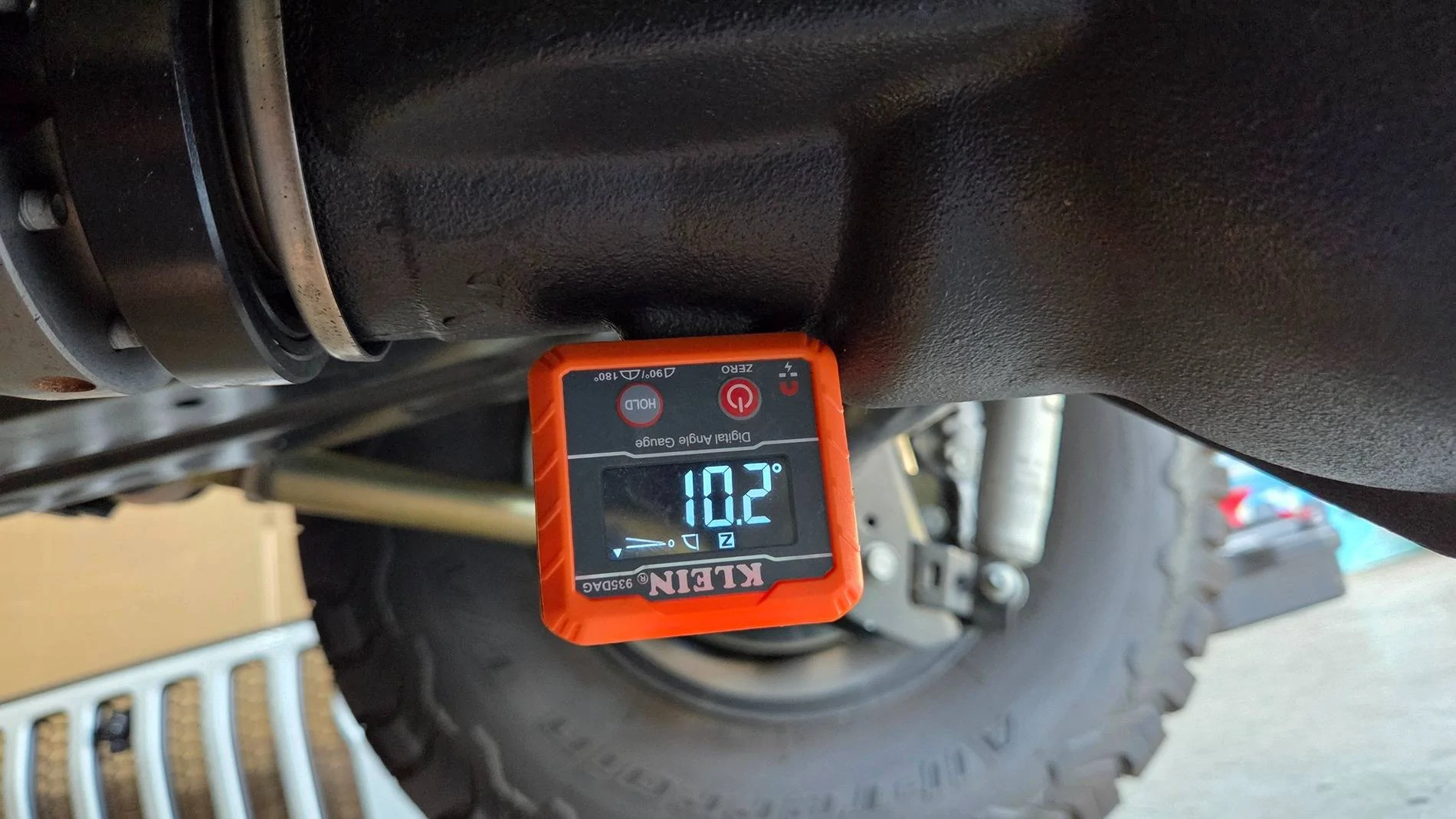

With the rear tires back on and off the jack stands I measured the drive shaft and pinion angles to see if I needed to adjust the contol arms. Thankfully they were within .4 degrees so I called it good, at least for now. All that was left in the rear was torquing everything down and insalling the the bump stops.
Jeep Wrangler JL Yoda? Build Thread 20250706_160758
Jeep Wrangler JL Yoda? Build Thread 20250706_160847

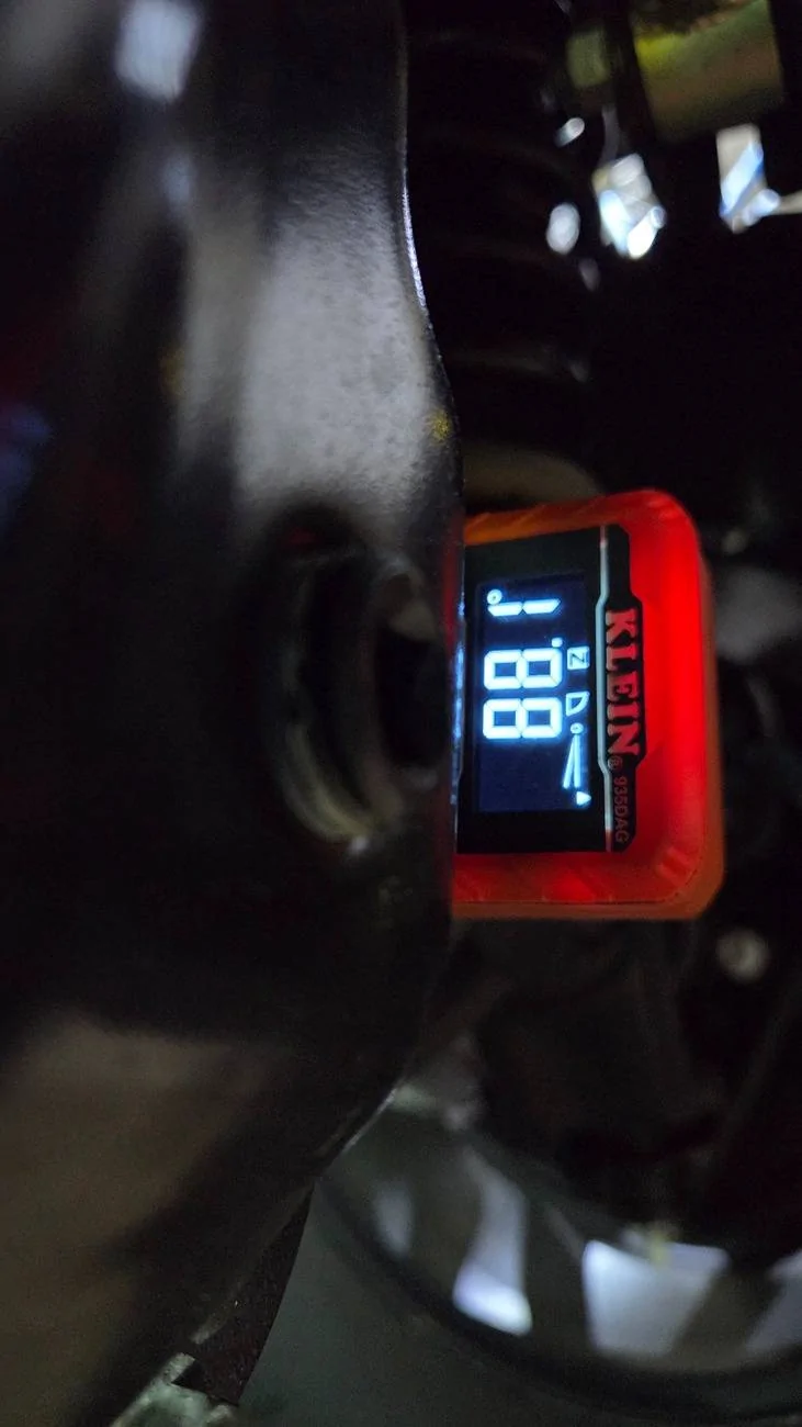

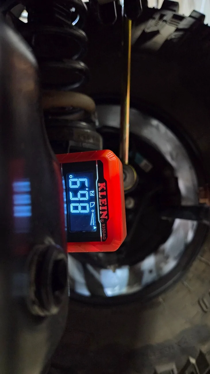

I then moved back to the front to check the castor. Unfortunately that wasn't so good. The MC instructions provide starting point lengths for the contol arms that target 6 degrees of caster. Since my lift is 3.5" and I have no FAD I wanted to get more in the 4 degree range for caster. So I thought I would be smart and come up with my own lengths. BIG mistake.
I didn't get a before picture, but when I measured the caster in front, my angle finder read 84.1 degrees, which equates to .1 degrees of caster. I wasn't even going test drive at that caster. I'm sure it would have been a shit show.
Normally you can make caster adjustments with the Jeep sitting on the ground. Mine was so out of wack I had to put it back on the jack stands to make the adjustment. I ended up setting all the front CAs at MCs recommended length. I figured that would get me close enough that I could then make final adjustments with the Jeep on all 4 wheels. When I got it back on the ground I meaured and got a reading of 88.1 degrees, or 4.1 degrees of caster, .1 degrees more than I was shooting for in the first place. I celebrated a bit when I saw that reading.

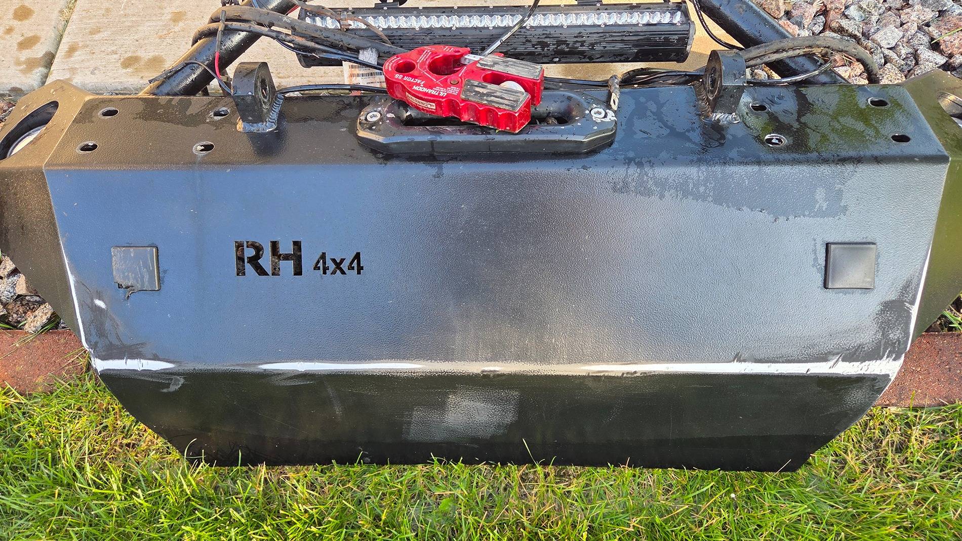

It was getting later in the day today, but with the bumper removed I wanted to see if I could get the drag link removed. When I originally installed the Steer Smarts Yeti DL the stock drag link was a B!tch to remove from the pitman arm. When I was in Lowes the other day buying some ratcheting wrenches they had a set of Craftsman pickle forks. It had three different forks for various tasks including a nice thick one for pitman arms. It did the trick, it only took 5 or 6 minutes of pounding to get the DL disconnected. Though as I thought I would I tore up the rubber boot so I have to replace that.
Next week the plan is to compelte the DL transfer and Install the bumpers on Yoda. If I can do that then Yoda will be complete. At least until the next upgrade.

It's been a busy couple weeks. In my last update I had just gotten the front bumper finally removed from the YETI. The following night I went to touching up all the rock rash. I started by sanding everything down. Then to try to match the powder coating as close as possible on the RH 4x4 I used Rustoleum Black Hammered spray paint. I got a picture of it sanded down but of course forgot to get a final shot after I painted it. I can say It turned out great. The Hammered paint is is a cross between satin and semi gloss finish with a smooth texture. Very similar to the powder coating on the RH. If you put direct bright light on it you can see a little difference, but at the angle of where it is you'll never notice it.

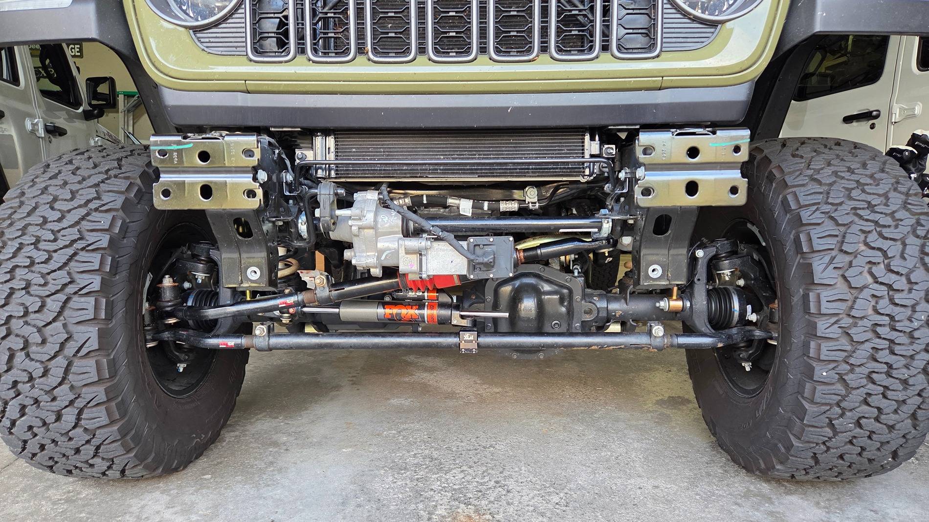

Here's a shot of the front end of Yoda with the Steer Smarts DL installed. Of course there's no need to remove the bumper to replace the DL, but since I was replacing the bumper anyway, I removed the OEM bumper first just to give me more room to work on the DL.

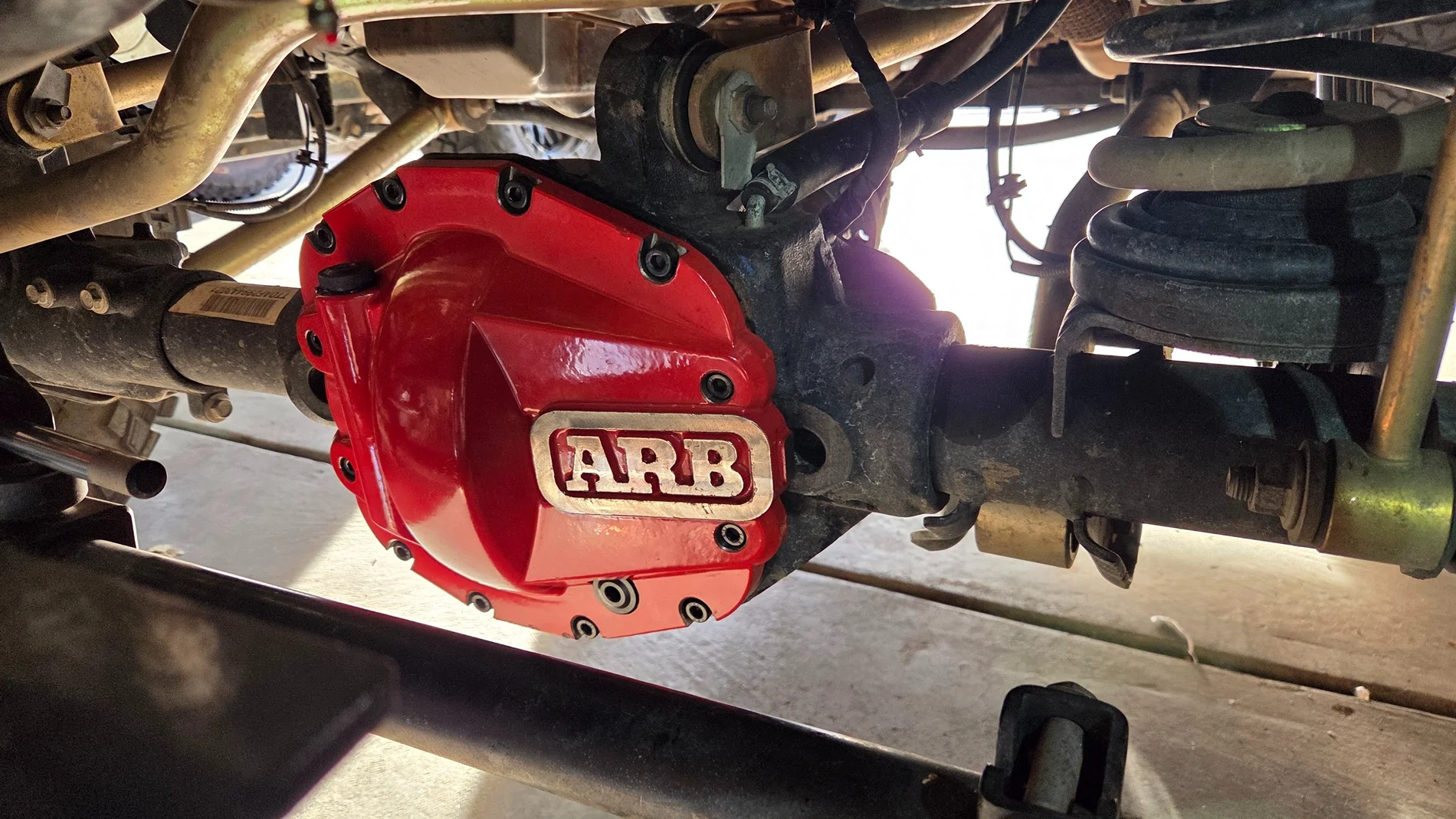

At the end of last weekend here is were I stand with my list of stuff to move to Yoda.
  • Soft Top
  • Full MC 3.5 GC lift
  • Fox 2.5 DSC Shocks - Shipped off to Accu Tune to get rebuilt and revalved.
  • Front Drive Shaft
  • Steer Smarts Yeti DL and TR
  • Fox 2.0 ATS Steering Stabilizer
  • Rock Hard 4x4 aluminum bumpers, front and rear
  • Superwinch 10k winch
  • Teraflex Alpha HD hinged tire carrier and mount
  • ARB Diff Covers
  • Mopar HD Rock Sliders w step assist
  • Mopar Trail Rail system
  • Mopar All Weather Floor Mats
  • Mopar Stainless Door sill Guards, or I may just buy new ones

I am all but finished. My FOX DSCs arrived yesterday but I was busy back working on the YETI; I installed the XR suspension I took off Yoda. I'll probaboy to the shocks next week end and will do the ARB diff covers the first time I change my oil, which may be next weekend as well.
It's amazing how much quicker things go when you done something once or twice already. This weekend I installed the full XR suspension on the YETI, as well as the OEM bumpers I took of Yoda. Once I finished everything I took the YETI out for a test drive and it drove great, no issues at all.

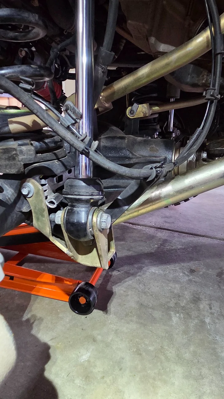

A couple small updates to Yoda today.

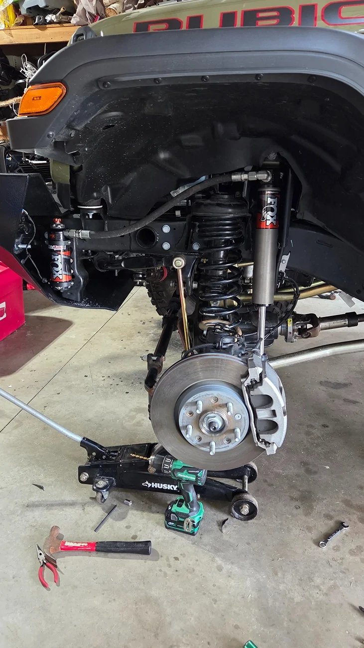

After a post from @Zandcwhite that had a great explanation on how to measure for appropriate bump stop I realized I needed to add a 1" puck to Yoda in front. When I initially installed the lift on Yoda I didn't add any bump stop pucks because it is an XR with the crazy tall bump stop towers. But my shocks are longer than normal.
When I bought them I double checked with MetalCloak on the max compressed and extended lengths they recommended for the 3.5" GC. For the front I ended up going with the longest Fox 2.5 DSCs for 4.5-6" lifts. They were right at the max length recommended by MC. After taking measurements and verifying the compressed length of my shocks I determined I needed to add one puck. The one part of the job I was dreading was drilling out the hole in the center of the spring pad to a 1/2". Thankfully I had a step bit, which made super easy work of it. Each one only took about 30 seconds.
Jeep Wrangler JL Yoda? Build Thread 20251108_132723
Jeep Wrangler JL Yoda? Build Thread 20251108_134420

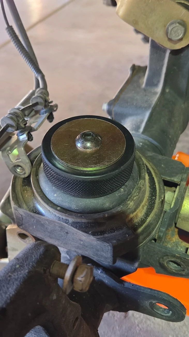

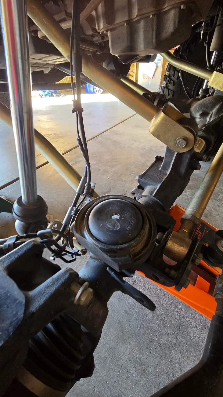

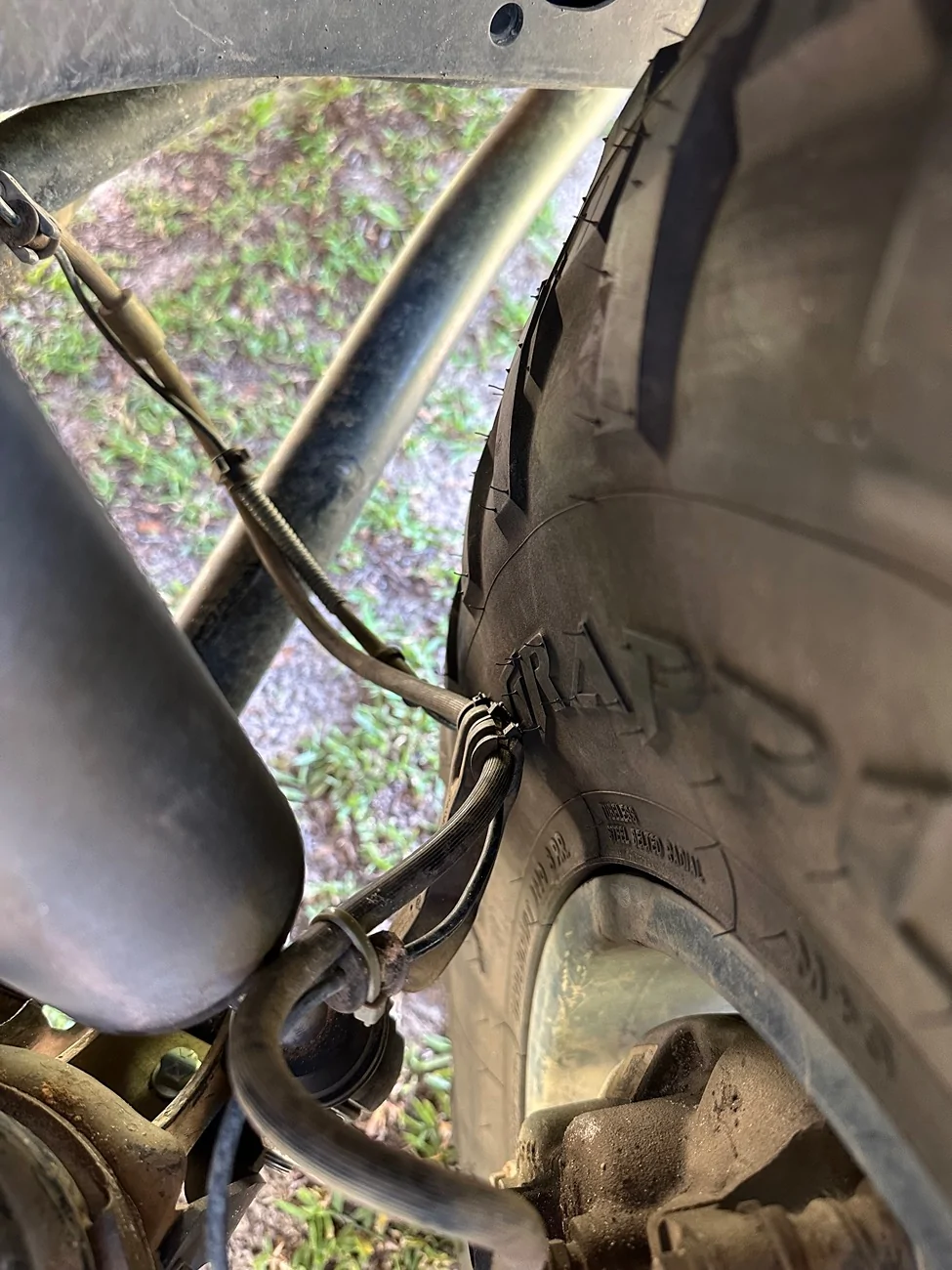

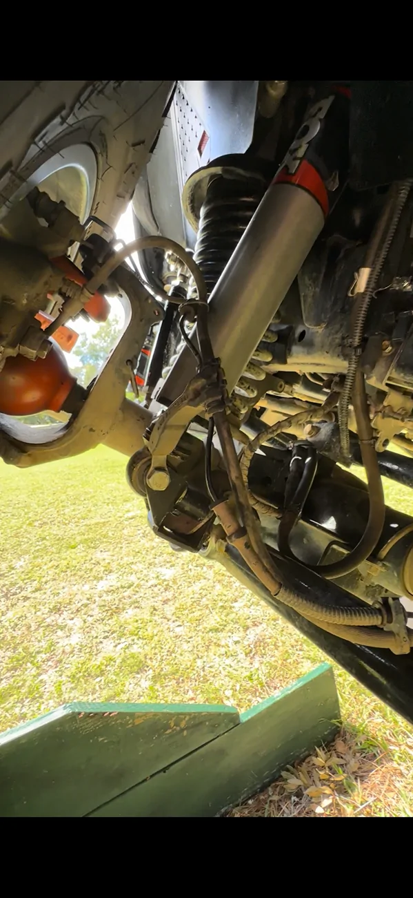

While I had the front end torn apart I figured it would be a good time to rerout the brake and ABS sensor lines with the Teraflex front brakeline anchor. I had intended to install these when I did the lift but I forgot to order them so I just left the brake lines in their OEM position. I knew they would be ok in that spot because they were fine on my 2021 with the same lift. But they did get pretty taut at full droop so I did want rerout them.
Istallation of the Teraflex anchors should be pretty simple, but the MC outboard shock mount complicated things a bit. I ended up installing them on the inside edge of the outside shock mount right next to the OEM shock mount spacer. On the passenger side I had to grind the spacer down a little to get the anchor to fit, but thankfully on the driver side there was enough clearance without the need to grind. Overall I'm happy with out it turned out. Now I don't have to worry about the brake and ABS sensor lines stretching or breaking while out on the trail.
Jeep Wrangler JL Yoda? Build Thread 20251108_163652

Have you checked clearance with the tire turned and stuffed with the brake lines outside the shocks like that? Not saying it will be a problem but I've never seen them routed like that and I wouldn't want a tire lug trying to grab the brake lines. Probably not an issue but it looks different so it fit me thinking.
I don't think it should be a problem, but I'll take a look at that. Will play with my new floor jack this weekend and check it out.
Here’s mine full lock driver, and it’s not a good angle but there’s about 3/8” between the line and tire, I’ll try and get better pic when I get home…..
Jeep Wrangler JL Yoda? Build Thread IMG_0829
I have it hooked here…so far no issues….
Jeep Wrangler JL Yoda? Build Thread IMG_1018

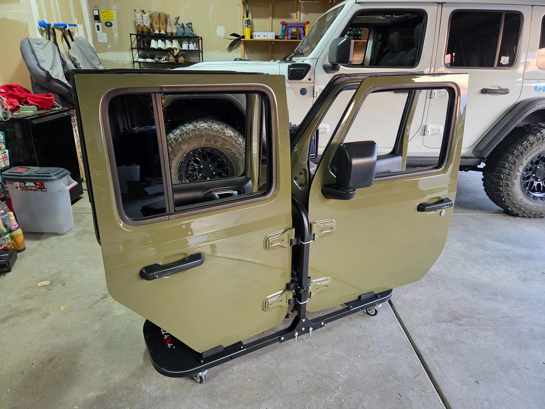

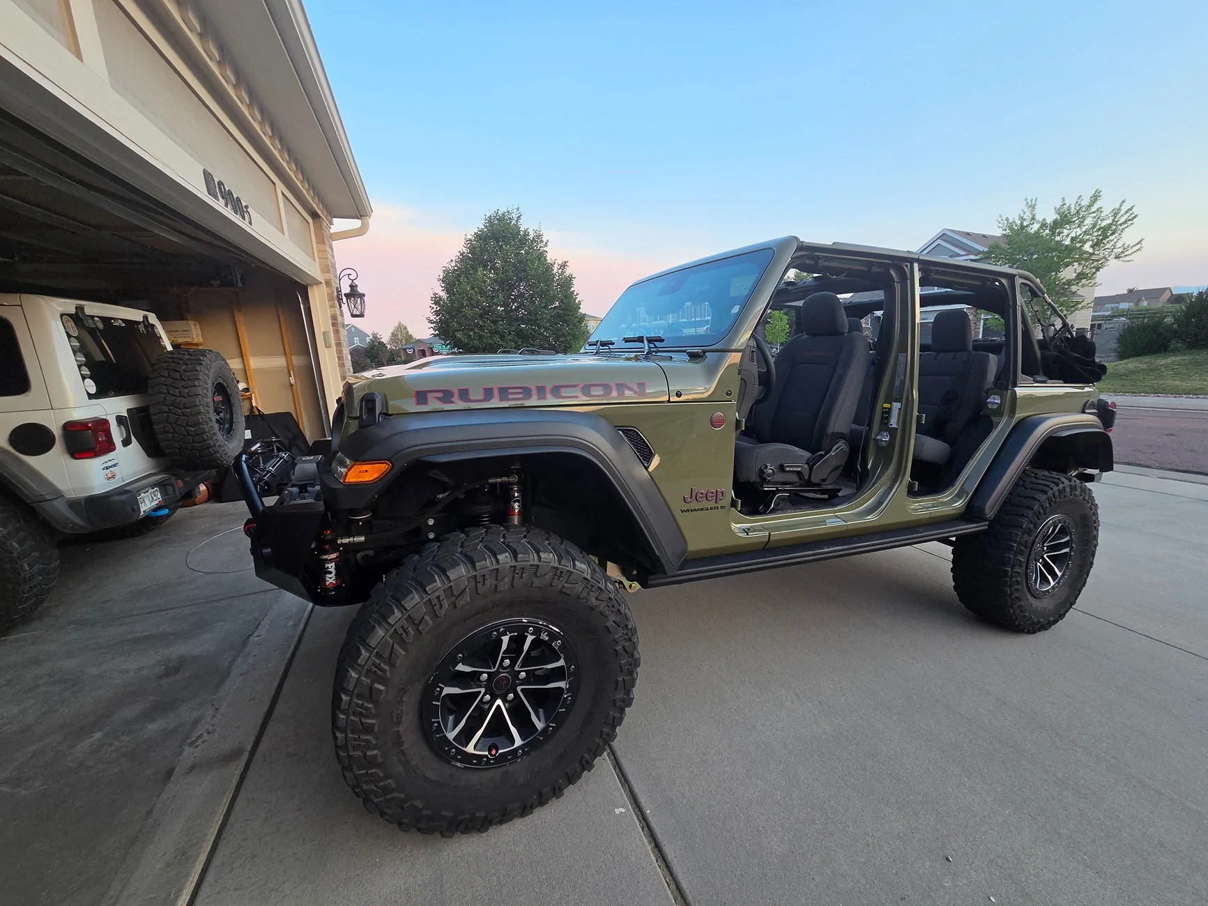

Took the doors off of Yoda for the first time. In our old house I had brackets to hang the doors on the wall. The new house is lacking bare wall space in the garage so I got a little cart to hang the doors on. Works pretty slick!
Will see how long I can go with the doors off. With as little rain as we get in the Springs and working with home so no commute, it might be a while.
