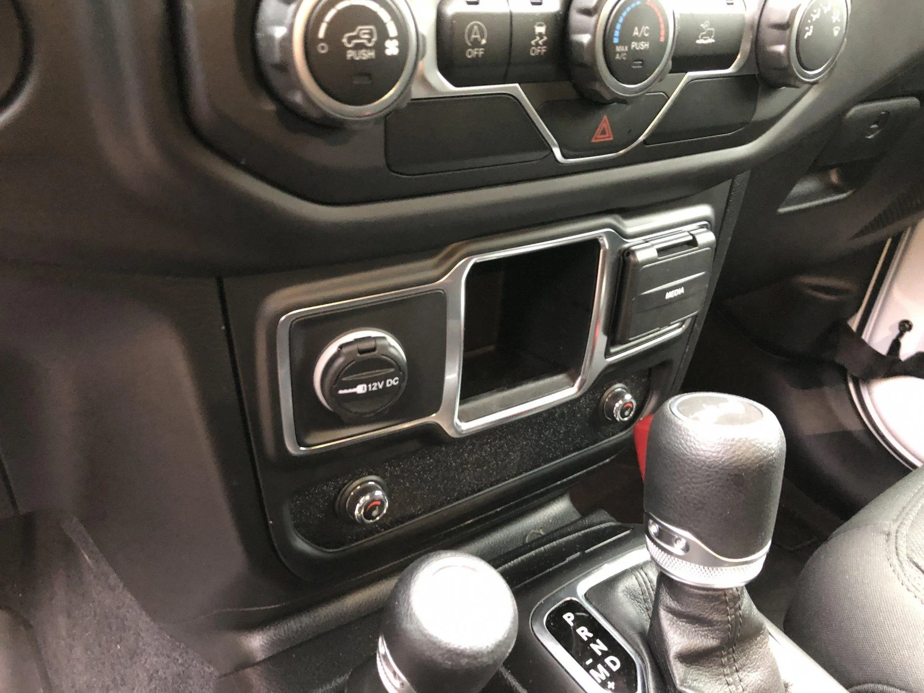

After running the wires up the side trim to behind the dash I used the cig lighter adapter harness to get 12v “key on” for it’s power supply. And since it’s a sport there is nothing in the lower cubby and that cubby is pretty much useless to me, I remove it and put an ABS panel over the front. Then after trimming the rear half of the cubby off, I had a clean, factory looking place to put the heater switch (and any other switch I will need but more on that later). The biggest difference between aftermarket seat heater brands is the switch. I went with round chrome edge ones to make it consistent with the rest of the factory knobs & switches.
So one of the cheapest (<$100 seat heater on eBay), easiest to perform (took 2 hours total), and most appreciated add-ons you can do. Especially since we hit 37 degrees right after…And that’s in Florida, which just isn’t right!

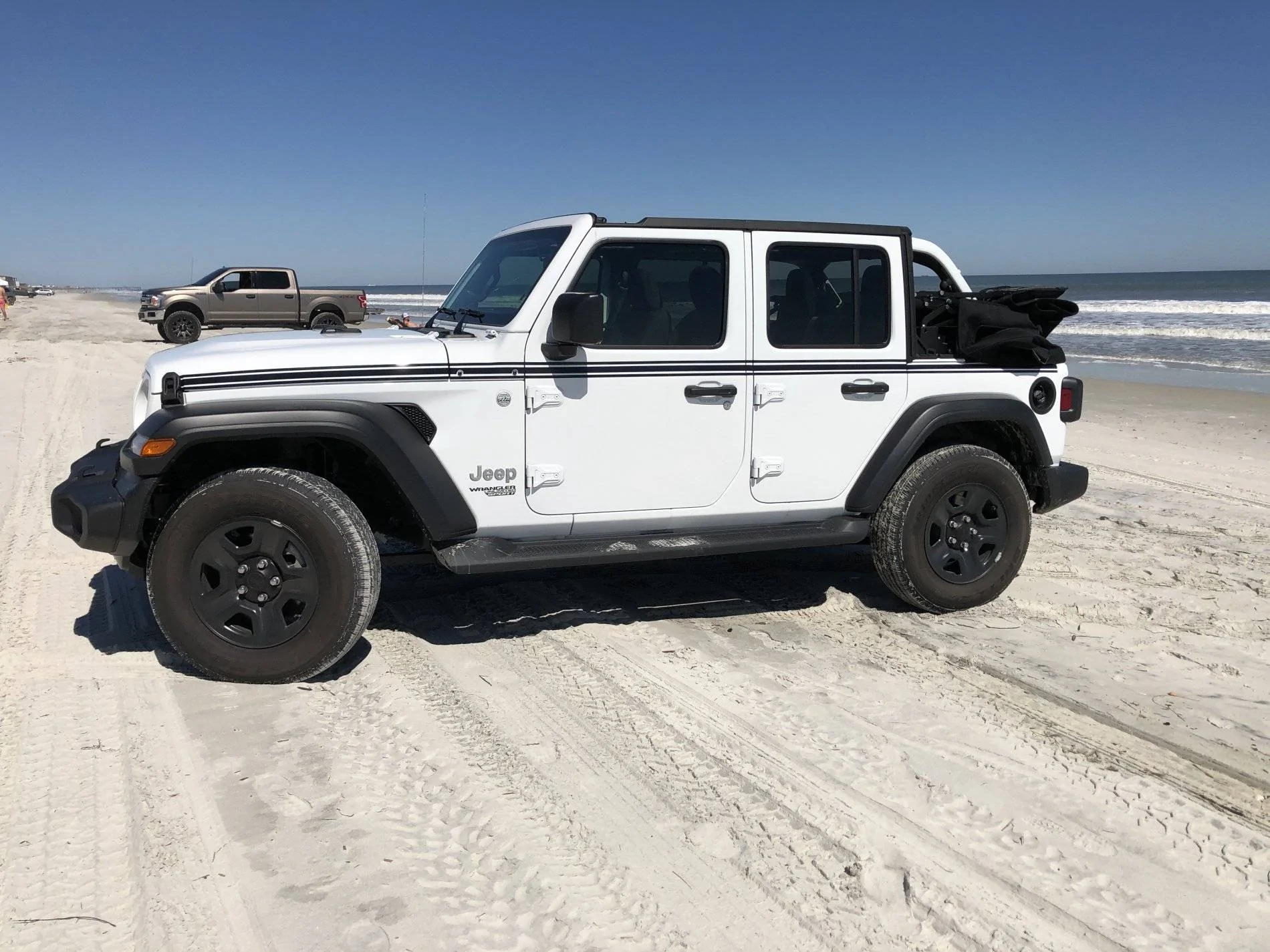

A simple mod came next, stripes! We don't like looking like a rental and my wife saw a tan one with a white chief strip and she really liked the look.
I tried to find aftermarket chief stripes but could not find any for the JLU, just the JKU. So I bought some 1" & 1/2" black pin striping and made my own "tribute" stripe to the chief look...I think it came out nice and better yet, my wife likes it!

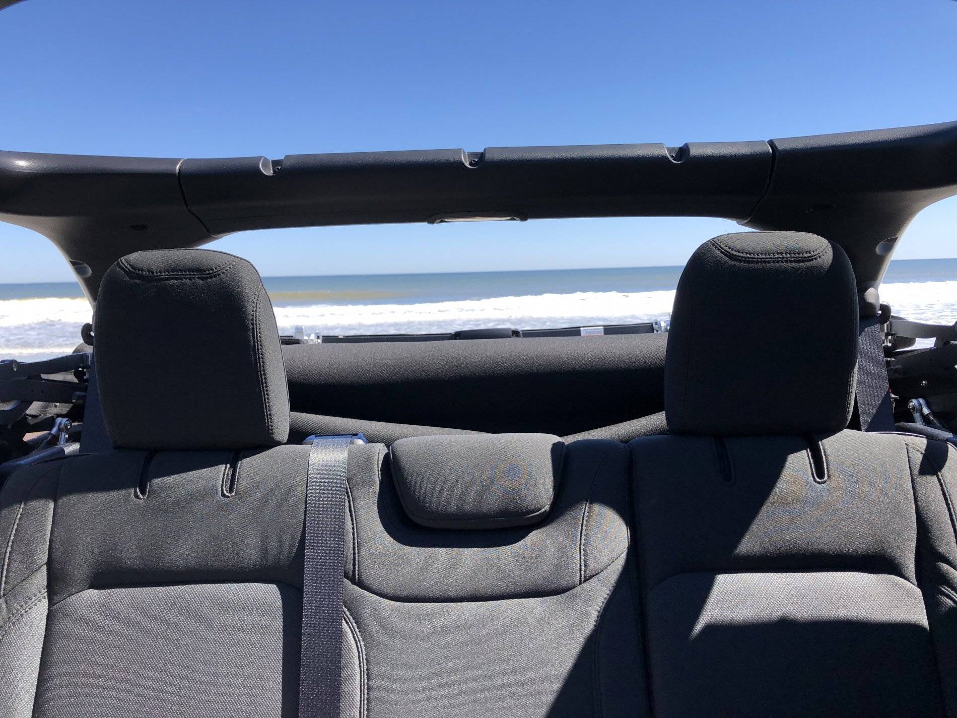

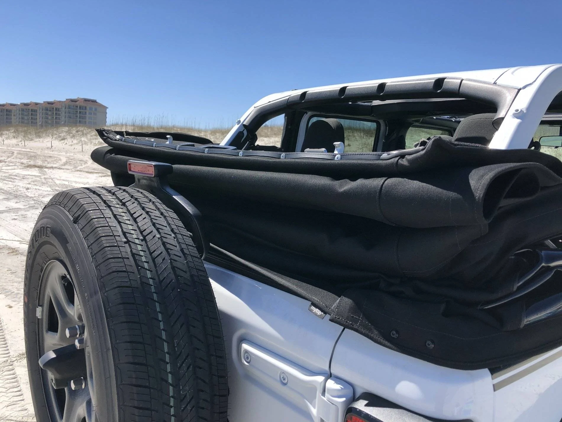

The next mod is the best one so far (though a bit pricey), a power convertible top called MyTop (There are several threads about it already). Mine went on a couple of weeks ago.
A couple of observations.
After the initial install, the top is stiff so it doesn't come as close to the header to latch as I would like. Since I am trying to convince my wife to get rid of her current power top convertible car, this has to be easy for her to use. After a couple of weeks with limited use, it has already gotten much better so I am sure it will work out for her.
It also has a headliner. This make the top MUCH quieter than the factory soft top.

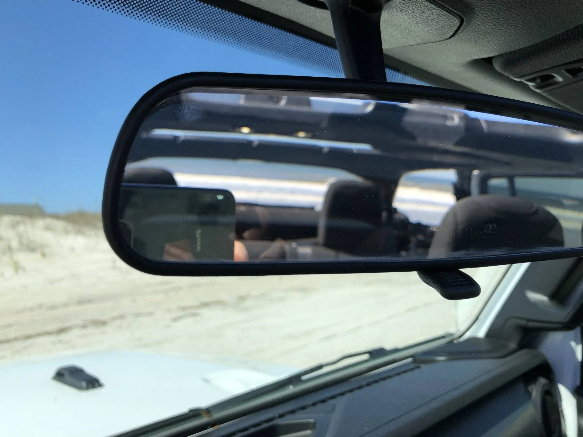

The rear visibility with the top down is not bad. It's a little less than when the top is up but really not bad at all.
The "trunk" is still very accessible with the top up or down.
They provide some mechanism covers but I wish there were a couple more as I don't like seeing as much of the mechanism with the top down. I have been trying to figure out how to do that but haven't yet so maybe it can't be done. Not a real issue anyways....
I'll be curious to see how well the side windows hold up over the years of usage. We plan on keeping this jeep until they make me stop driving so I have lots of time to test that out. The plastic is very heavy and I expect it to do well.
I really love my new top and it make lowering the Jeep top as easy any other power top convertible. I expect we will use the top daily even for the short grocery runs as the weather is just starting to get really nice here. That's just hard to do with the factory soft top so to me its well worth it.
