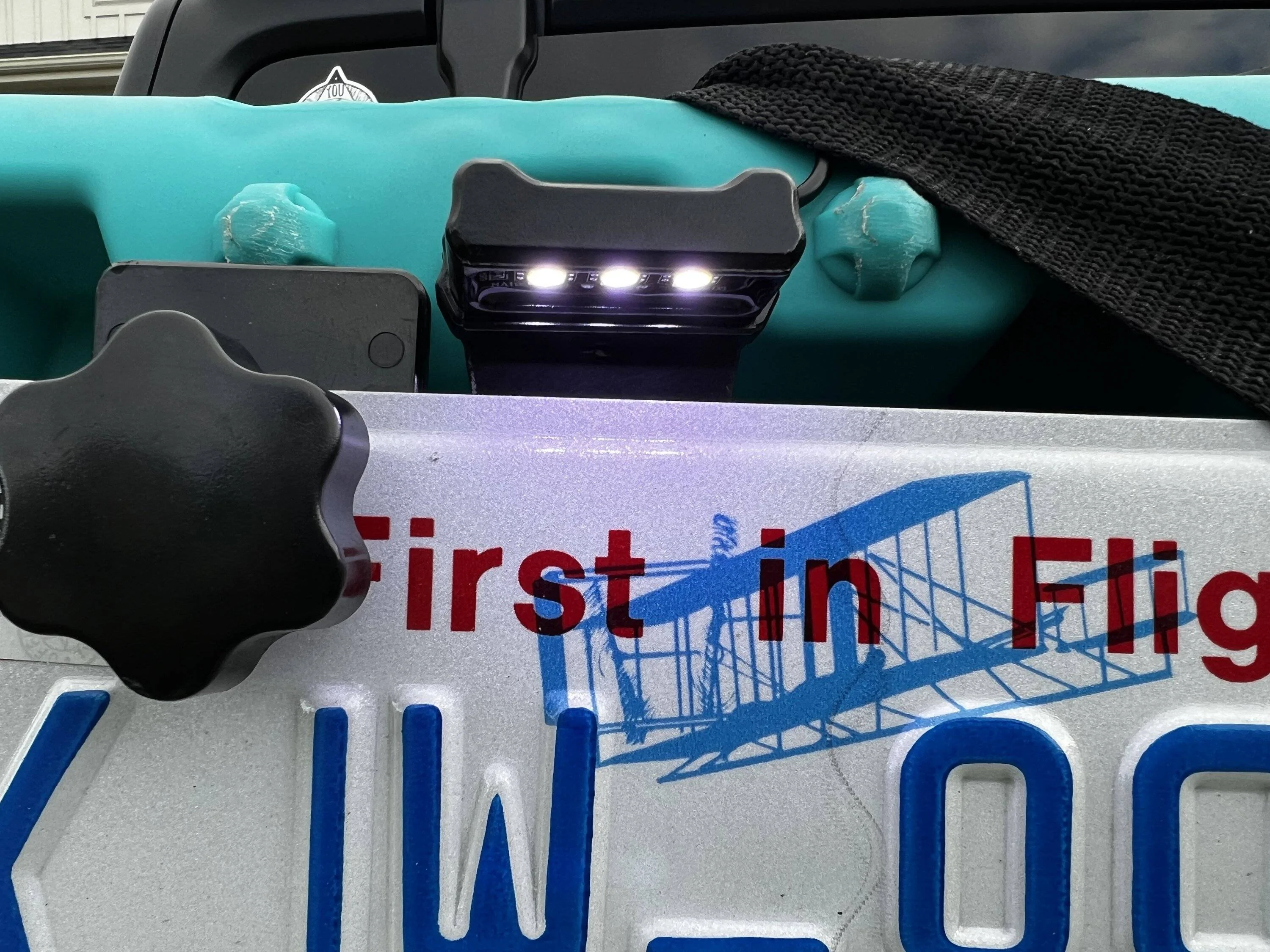

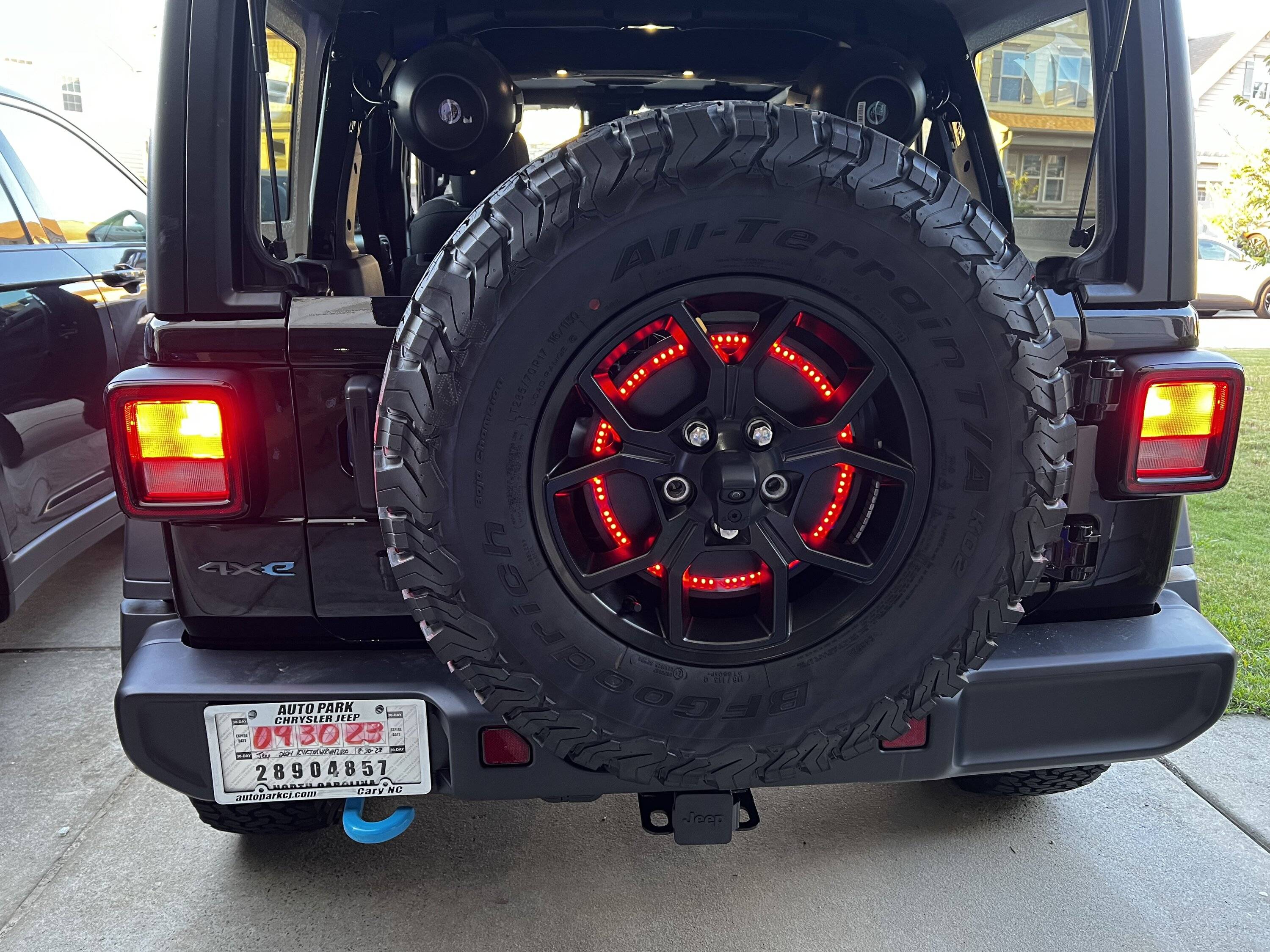

Day1: 3rd brake light removed in preparation for 37’s, also installed speaker pods and amp

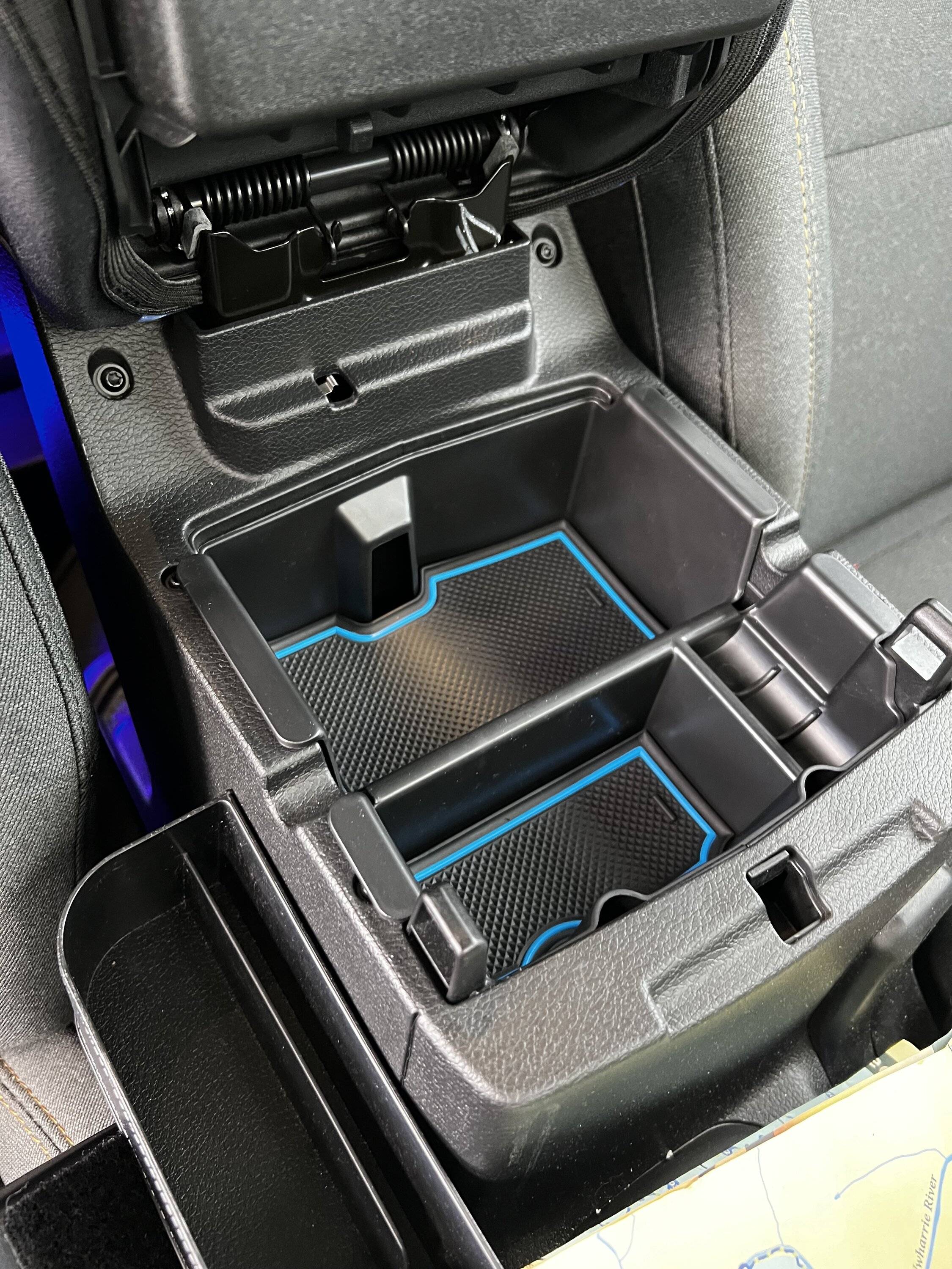

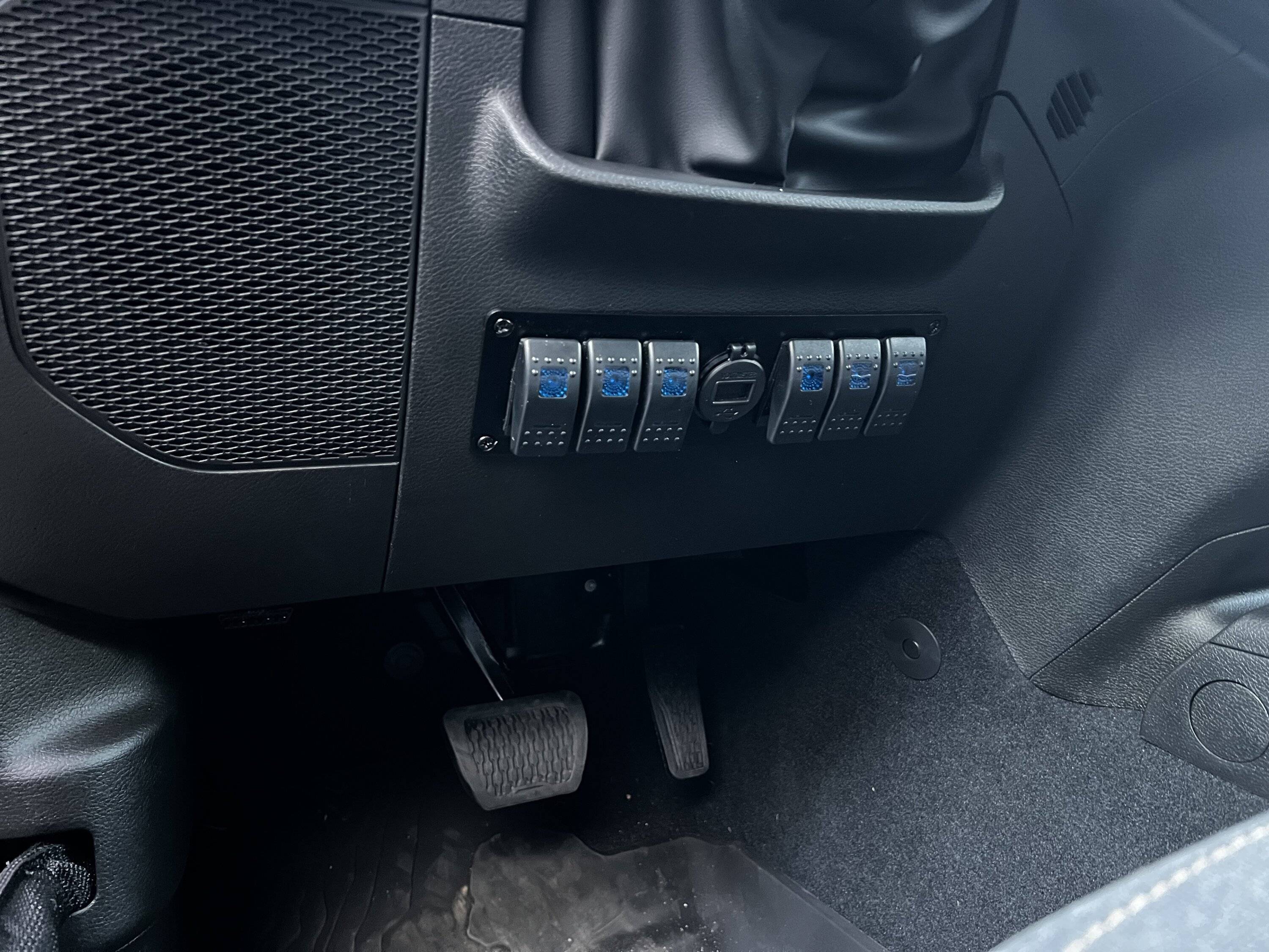

Day2:switches installed in preparation for lighting install, tapped to lighter in center console, negotiated new 24 dash configuration. Under seat courtesy lights upgraded

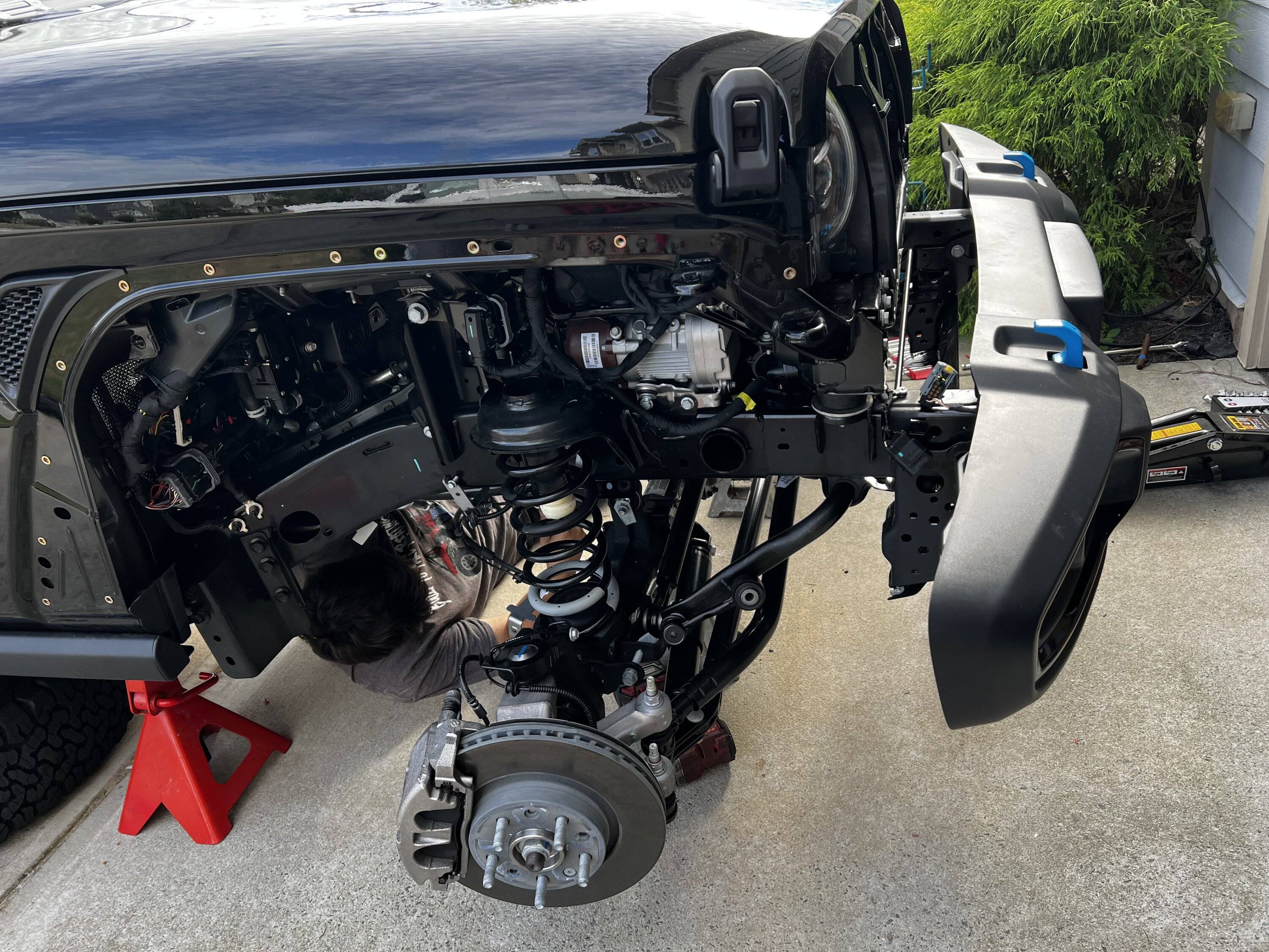

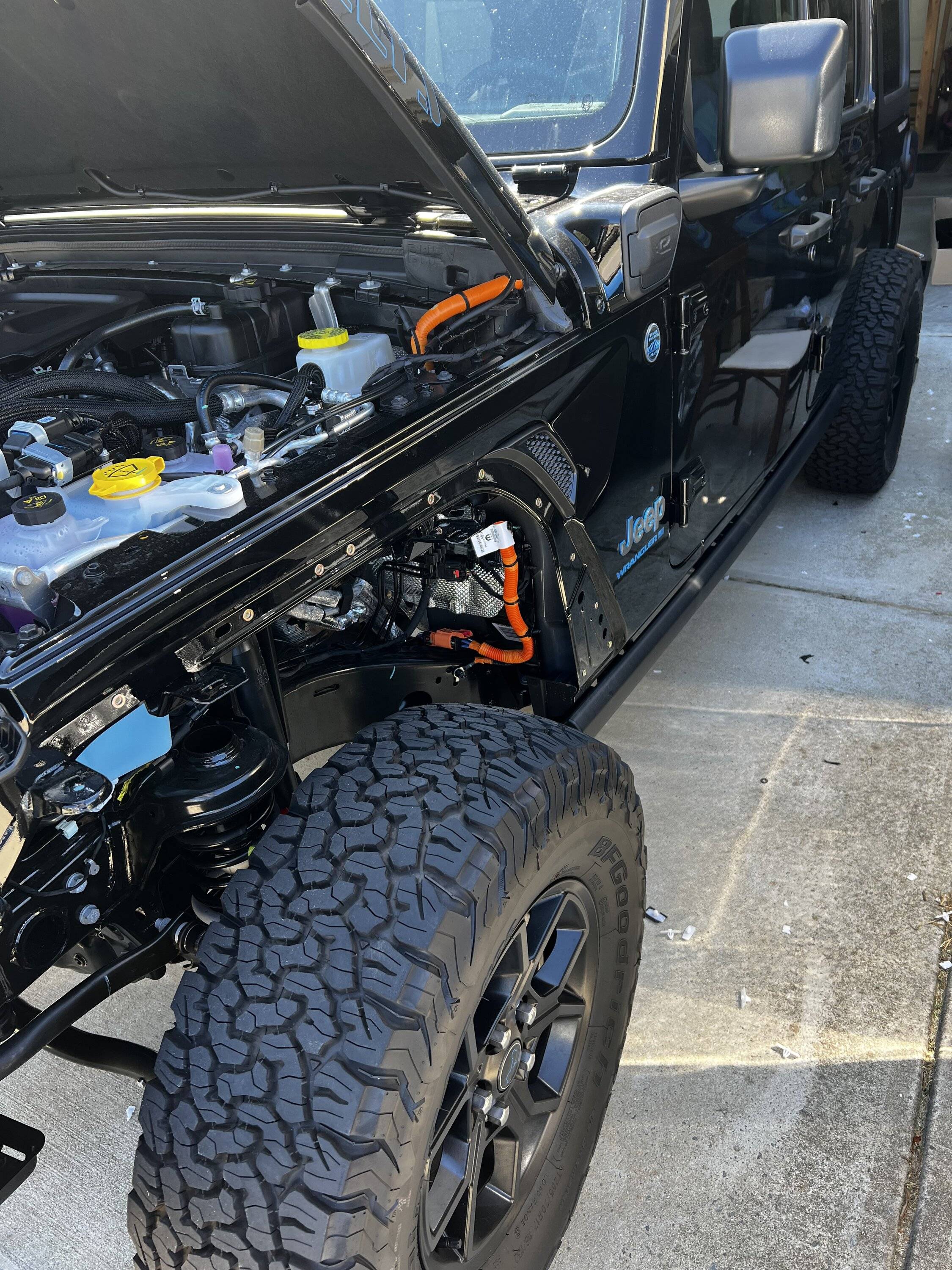

Day3: fenders off, nutserts installed. painted new fenders to go on after lift

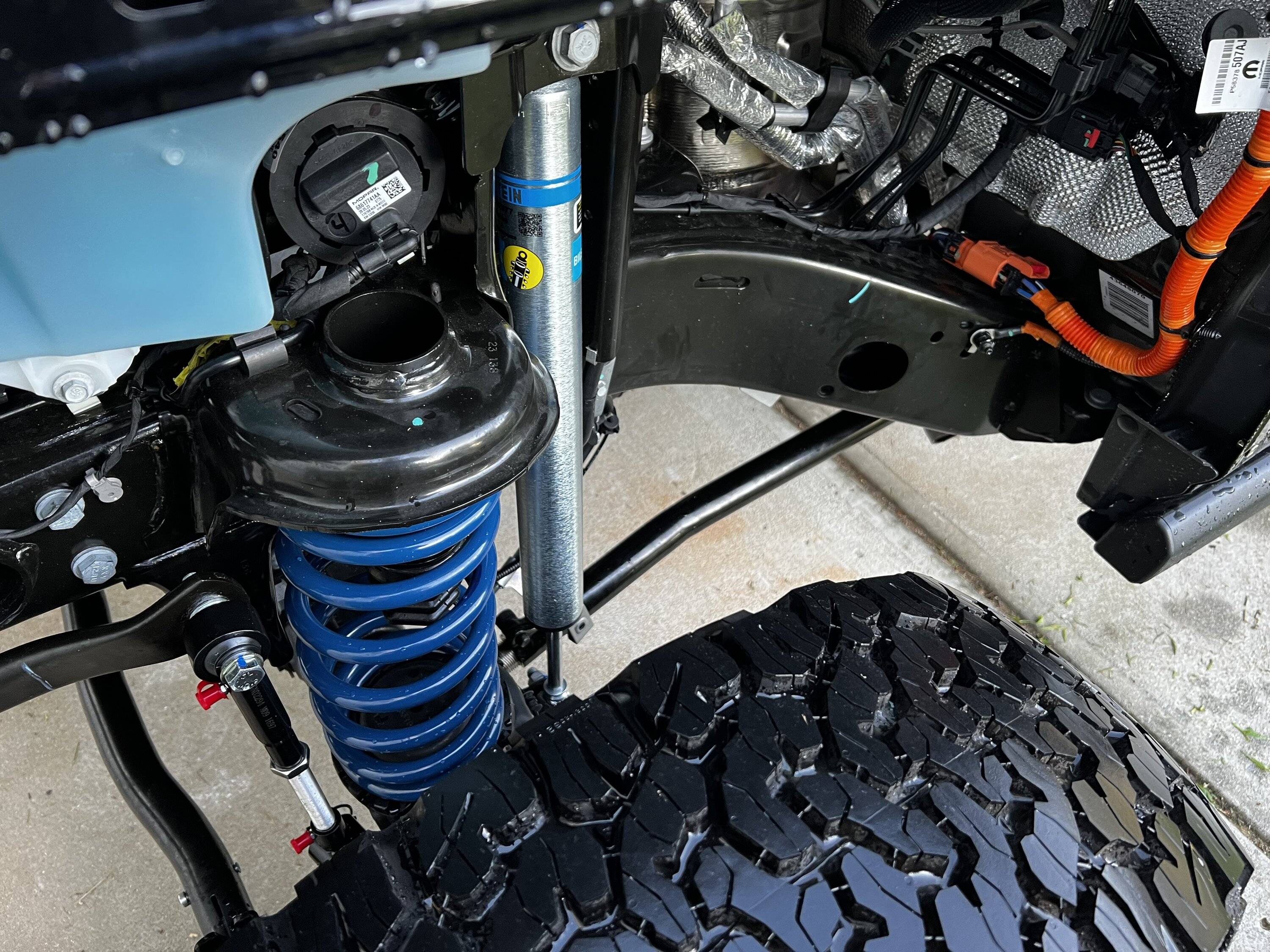

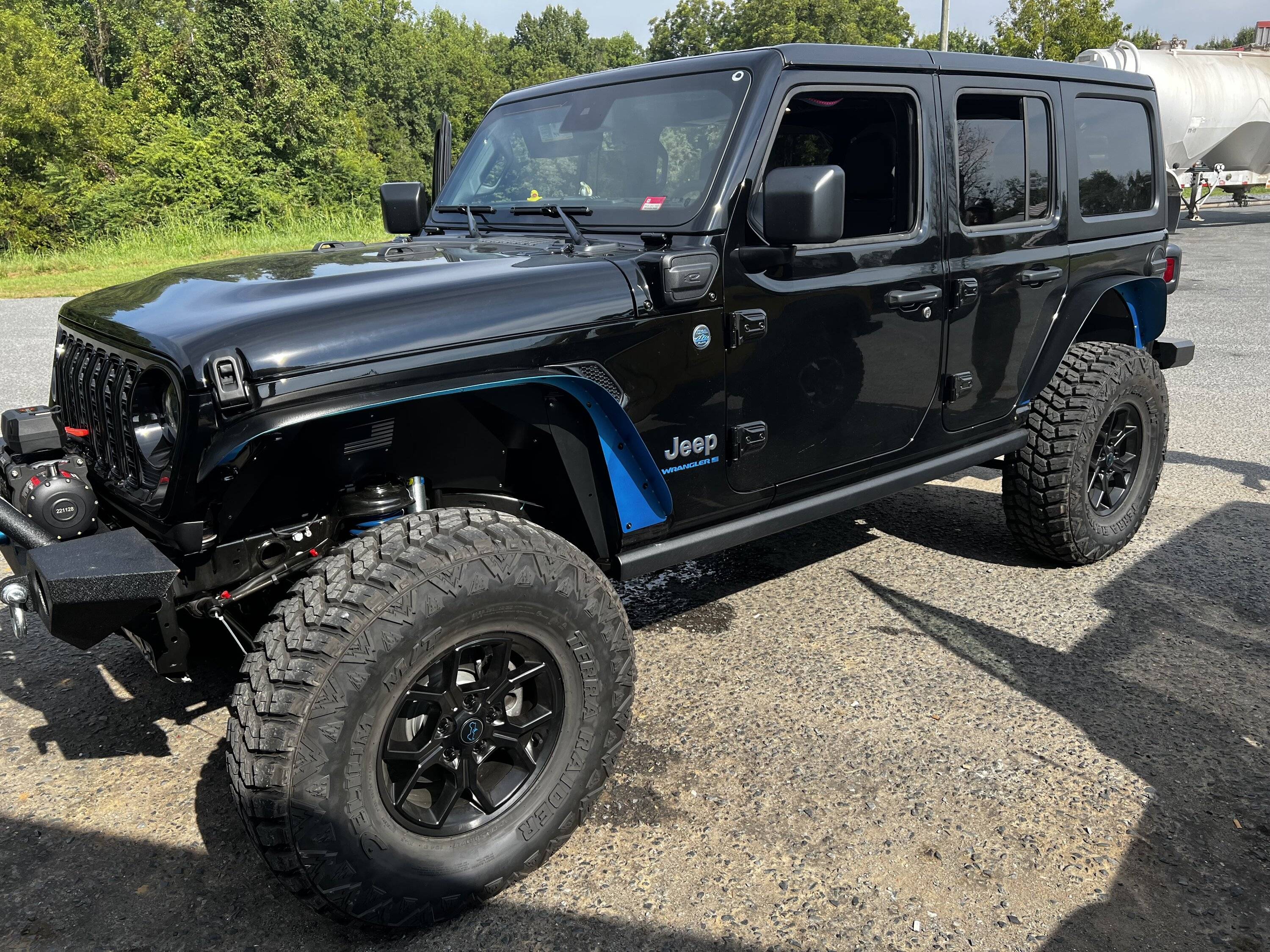

Frankenlift: after much trial and error half measures on the last one this was where we wanted to be…
Aev dual rate 3” hd springs
Bilstien 5100
Rough country full set control arms

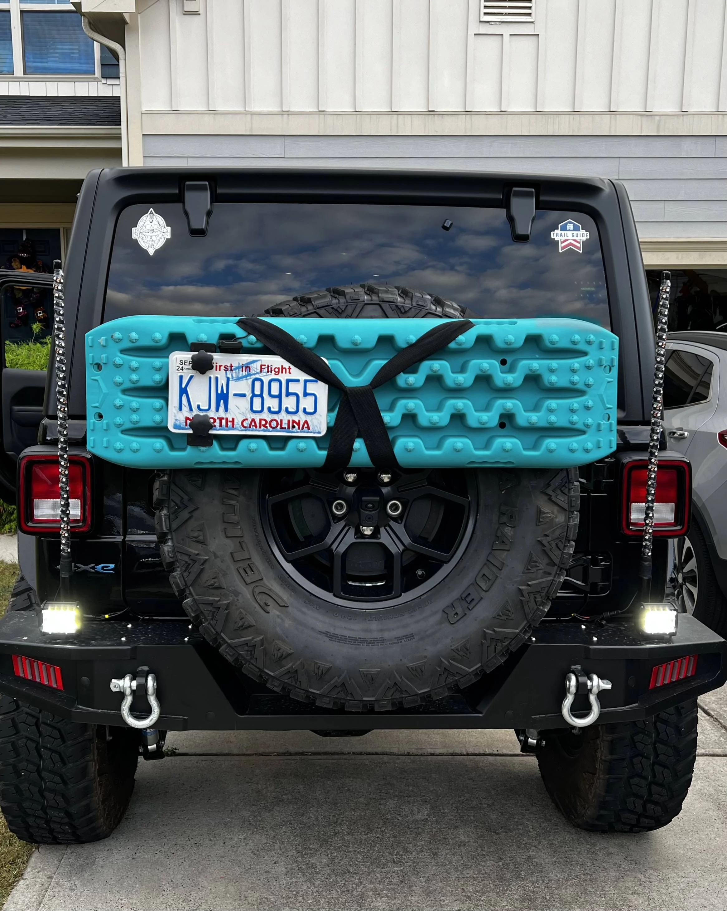

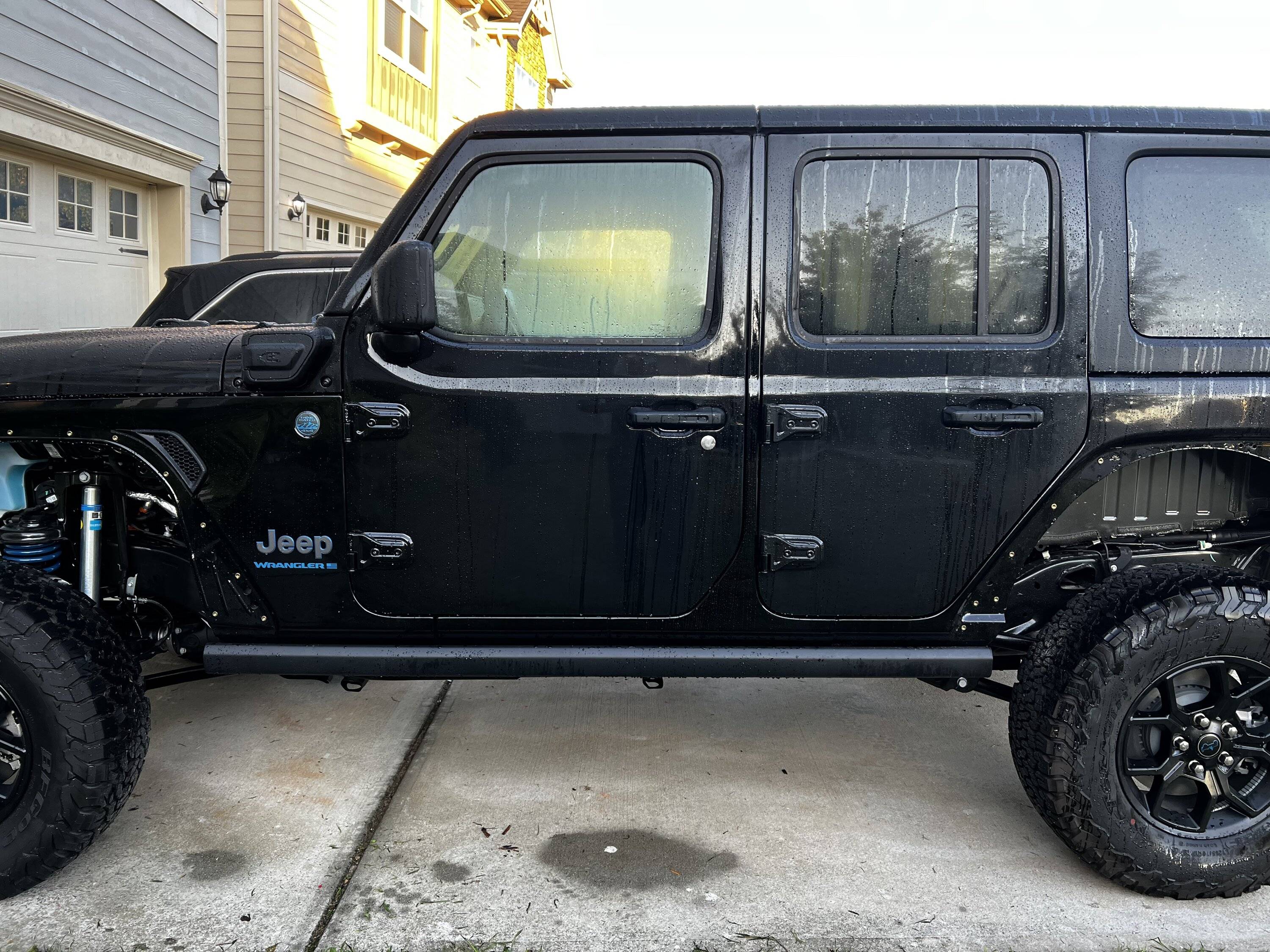

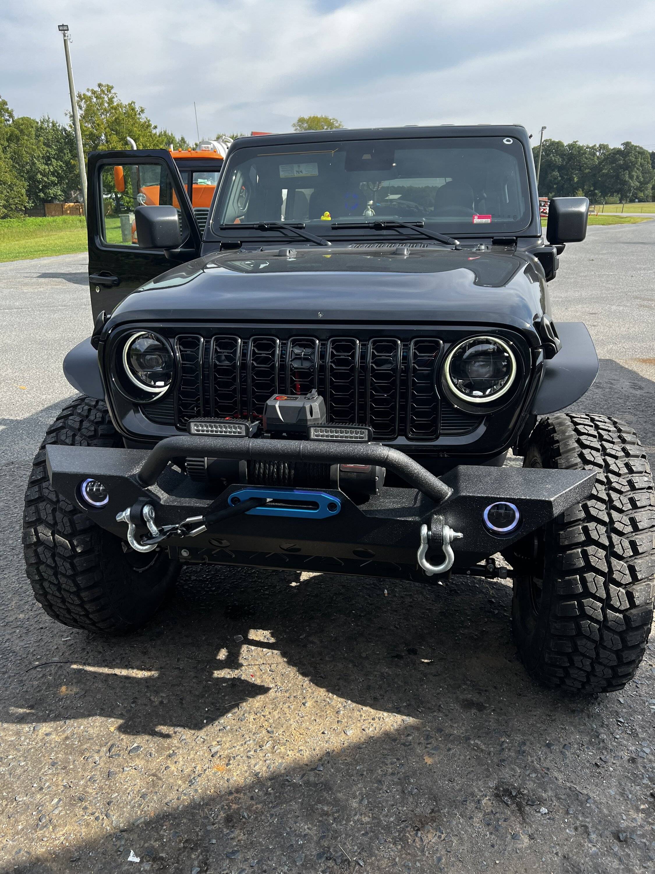

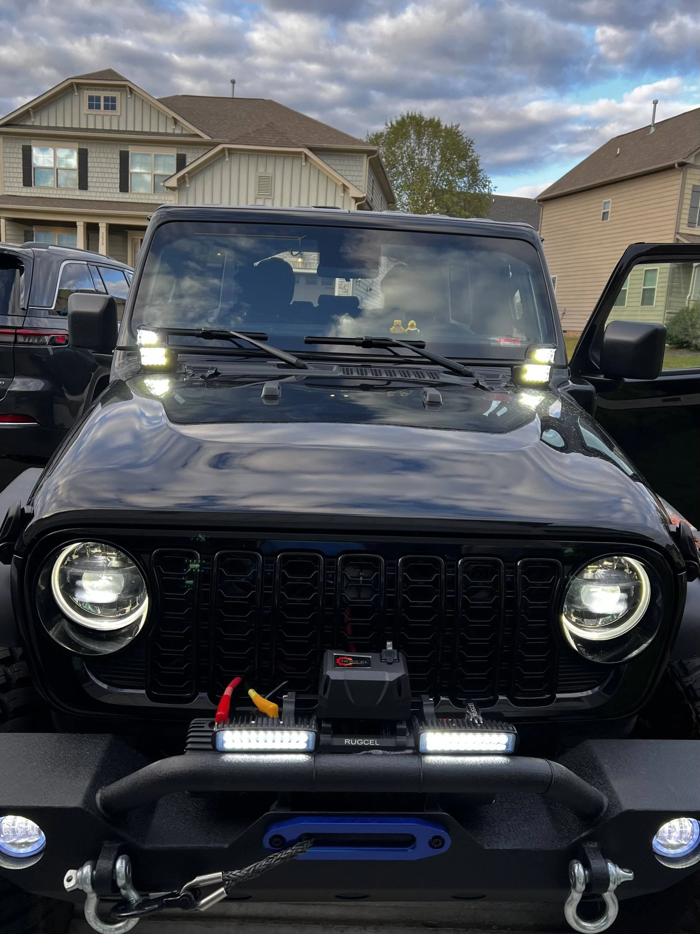

Here is the final product, late night finish. Made it to Jeep jamboree Thursday. Will still be adding a few final touches, but after a full week build and late nights a relaxing weekend at uhwarrie and a little down time.

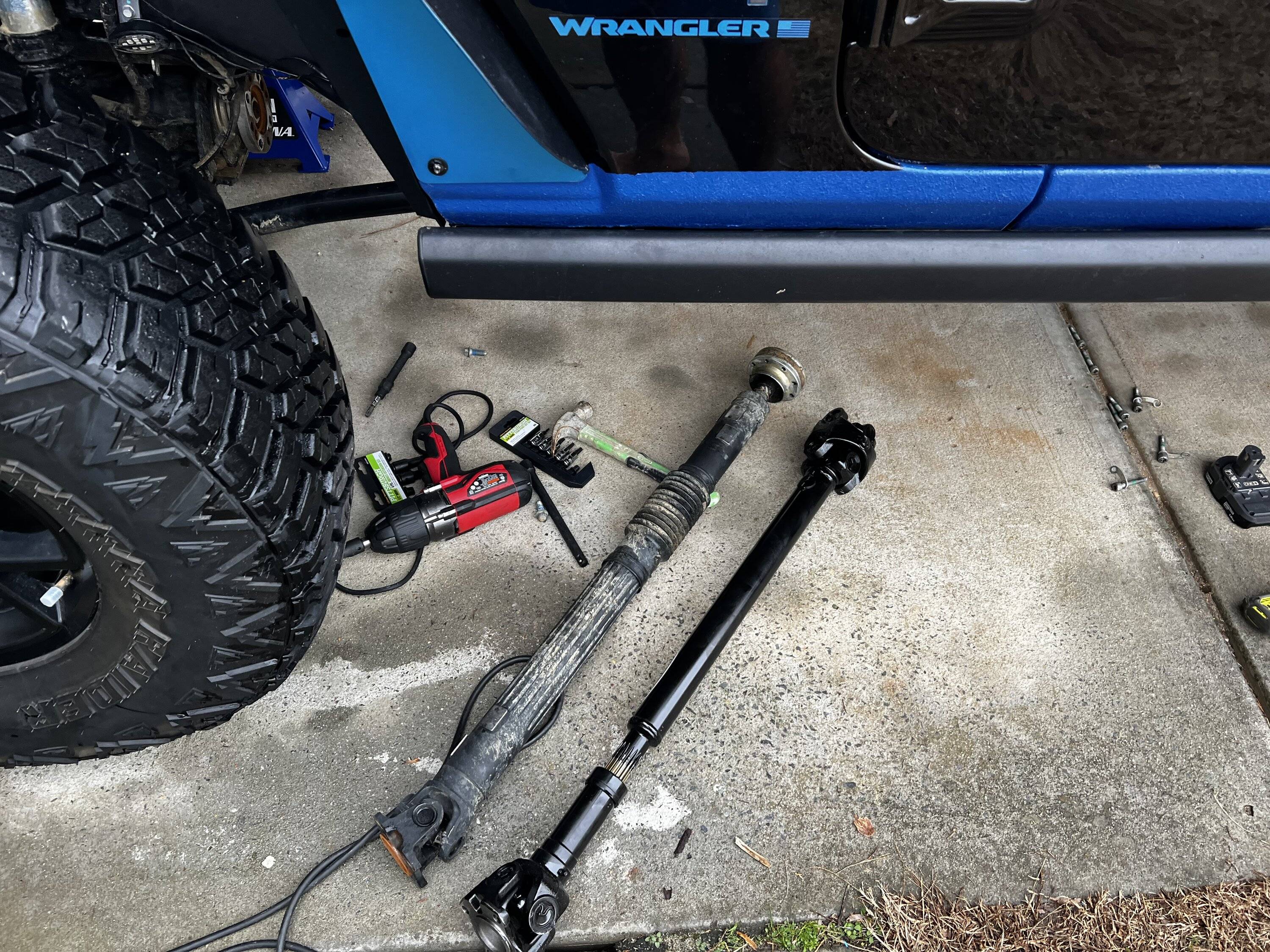

Driveshaft day, for those that have never attempted before be prepared for none of your tools to fit. T50, sure with a 12” extension…how about a 12point 8m, but the socket won’t fit so doing it with a 12pt combination wrench 1/8turn at a time…wait the 32m socket I actually had thx harbor freight Black Friday, had to go back for the gear puller though.
