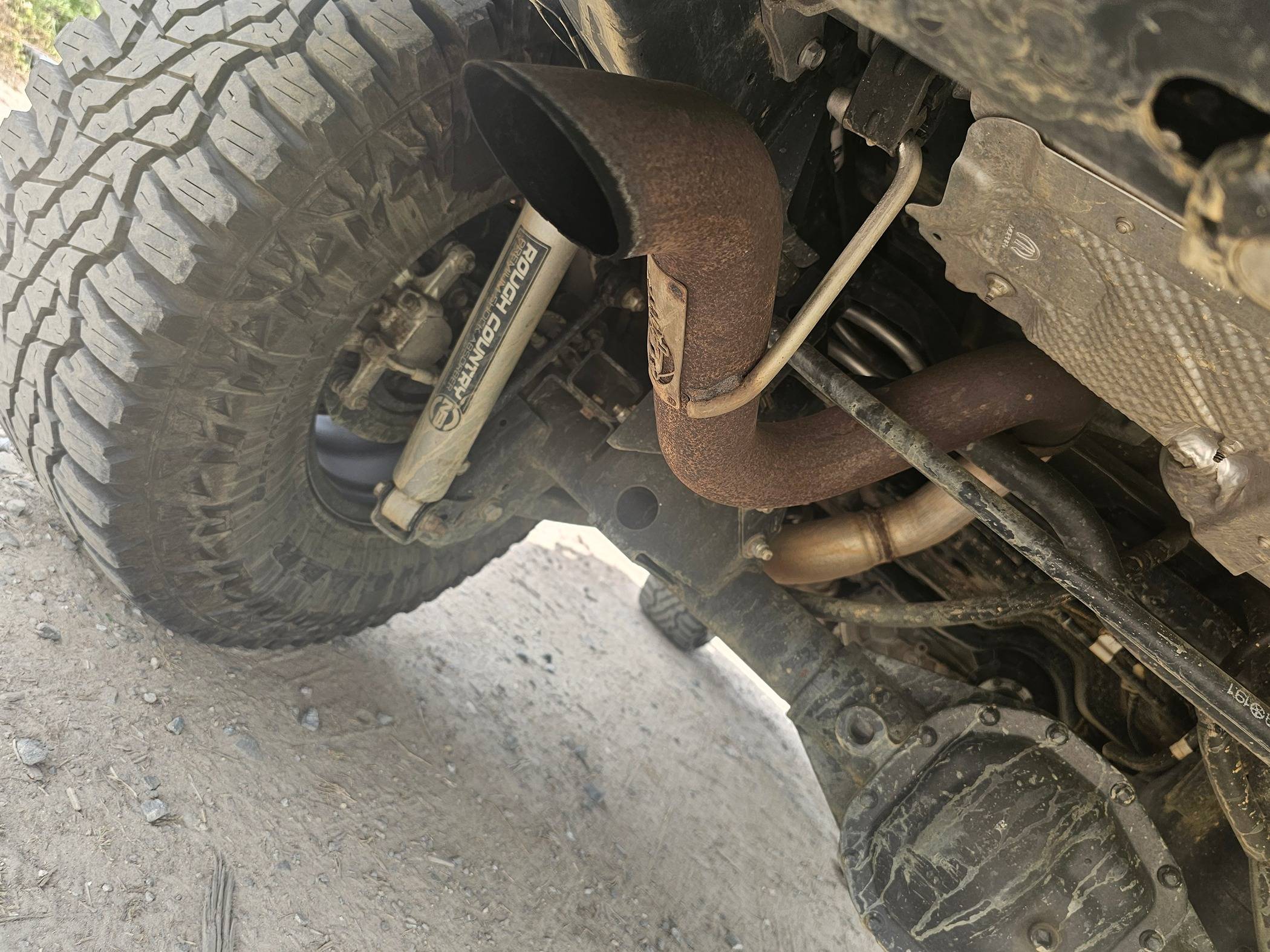

SayNoToTheJeepDigger
Aug 5, 2021
38
24
2020 Jeep Wrangler JL 2 Door
And did you disconnect the aux negative cable?
I'd say your exhaust is the issue.
You've got rock lights that you state cause starting issues. You also state you have an after market exhaust that has rusted, which sounds like it is of cheap quality. A quality stainless steel exhaust should not rust. It is possible you have holes in the exhaust or some of the hangers have rusted to the point they are not doing their job.
I'd bet money that your rock lights and exhaust are where all of your issues come from.
Yes. The battery had issues before with starting. I upgraded the battery to a 94. I've had issues getting the positive terminal fully mounted on to the battery so there's a loose connection there as well.
Frequently my jeep will not start, but after tapping the push to start a second or third time, the jeep will start up. Sometimes I'll need to get out and toggle with the positive end of the battery terminal, but I haven't had to jump it.
Next time I have an issue I'll record a video showing what I'm experiencing. I'm attaching a photo of my exhaust.
As far as disconnecting the aux negative cable, i have not done that-nor am I sure of how to do that
