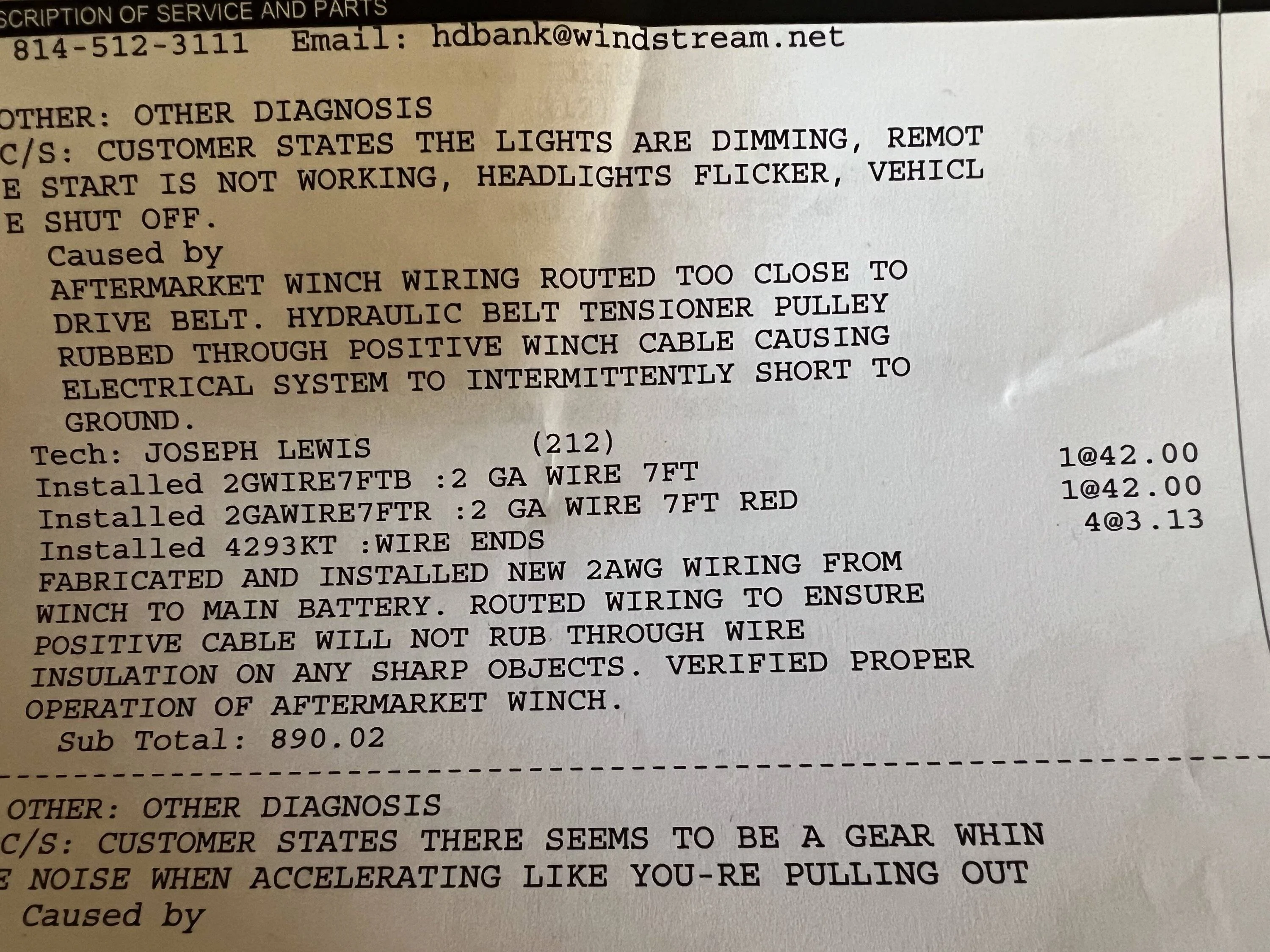

Here's what they did
Looks like they spent a bit of time redoing the wiring, the connectors, and re-routing the wires. Still, if they spent 6.5 hours, that’d be a bit much.
If you get to speak to the Service Manager, I’d stay away from discussing the amount of time it took them; you’d never win that argument. I’d focus on the fact that they are charging you for the rewiring as much as the price of a new winch!

Let's just say the mechanic was paid $25 an hour. Let's say the shop doubles that. So, they're telling you it might have taken 16 hours to do that job? I could easily be wrong about the hourly rate and markup, but even if it turned out to be $100/hr. that is still an outrageous amount of time for that job, unless they pulled the engine for the routing.
Dealer rates around here are about $150/ hrs. Still, they're saying it took over 4 hours to route 2 wires and tighten 2 nuts. They didn't even wire a battery cutoff.
True. But sounds like they gave those new wires a gorgeous new route through the engine bay... ?
Must have taken them on the scenic route.

Electrician
Diagnostics = $
Diagnostics on an unknown intermittent electrical problem = $$$$!!
Diagnostics on an unknown intermittent electrical problem at a dealership = $$$$$$$!!!!
Short answer; no you didn't get screwed.
Long answer; you kinda screwed yourself by ........... but that's a common problem with us humans.
