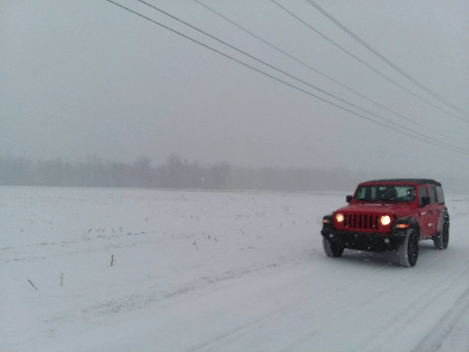

So I've never had a vehicle with 'nannies' like what come on the JL. I took my JL today (ice, snow, etc.) on factory Michelin tires - and the biggest complaint I have is the stability and traction control! I turned off the traction control and I had a much better experience (starting off in 2nd gear) overall, but stability kept engaging and really throwing me off.
Other than turning them off with JSCAN, is there anyway to permanently turn these off (without having a bunch of dash lights and voiding warranty)? I know I can temporarily turn both off in 4wd - but I never use 4wd on the street. As I mentioned before, I've never had a vehicle with these things - and I really don't want to get used to them during the worst time to do so.

The biggest concern was that it would seem to behave randomly. I would try to turn (and would slide a little - as expected) to which I would correct it - however, ESC would engage the brakes, and cause me to turn sharper than I wanted to (on occasion).

Hmmm...your ESC’s behavior sounds odd.
I’ve been driving Wranglers for fourteen years and found the ESC to come on in very rare occasions. I can probably count with one hand the times I had ESC intervene in all those years. And it was a life saver in each one of them.
Unlike say Toyota, who likes to set its ESC parameters very aggressively, Jeep is very lenient in its ESC programming.
My guess is you have a sensor somewhere that is sending the ESC a signal that the Jeep is losing control and needs a correction, when it doesn’t need to.

Your biggest complaint should be your completely inappropriate tires for the conditions. Of course ESC is going to activate constantly, those tires are constantly unstable in those conditions. You're riding on hockey pucks. FYI, All-Season is an inappropriate name. It doesn't include winter.
Put some winter tires on that JL so ESC isn't trying to do the impossible task of keeping those tires glued to the pavement.

So I took it out again after work - it seems to be working more 'appropriately.' I don't know if maybe I was giving it too much throttle, or if it needed to 'adjust,' but it definitely seems a LOT better - neither the TCS or ESC engaged near as much as earlier. I did try going through a bit of snow (about 1.5 feet) and it did okay in 4wd with TCS and ESC on, however, in 2wd it sucked until I turned off TCS.
