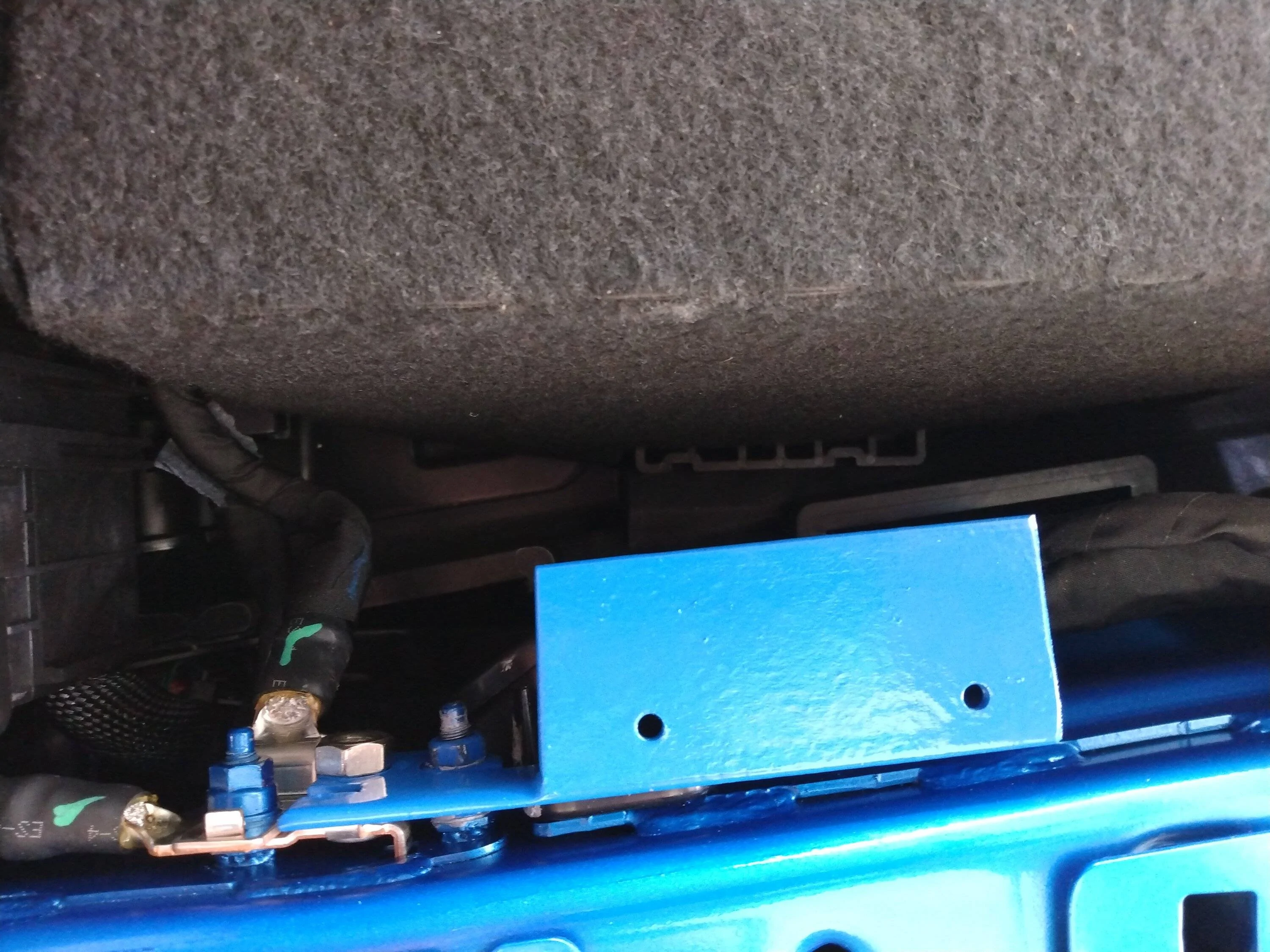

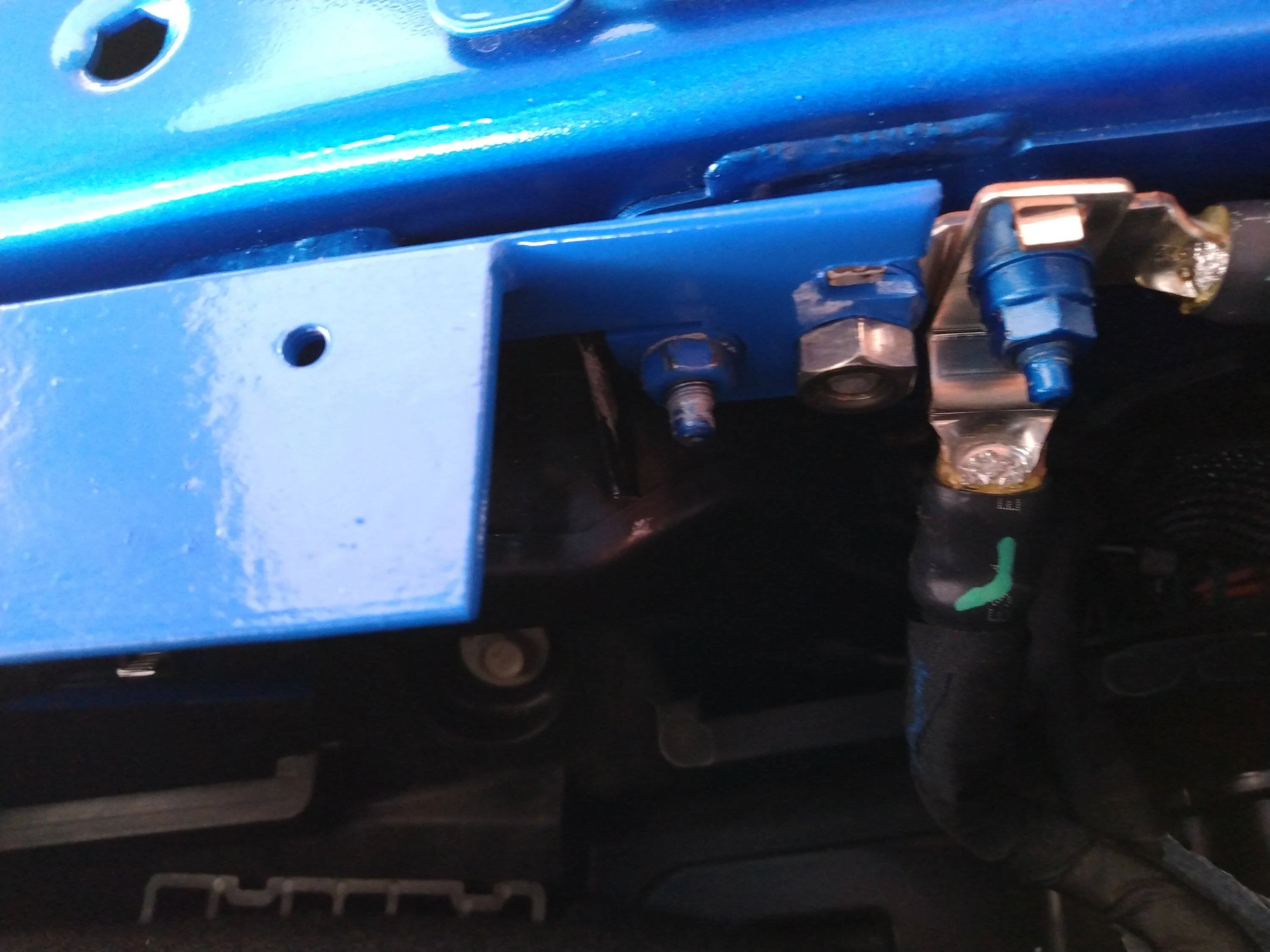

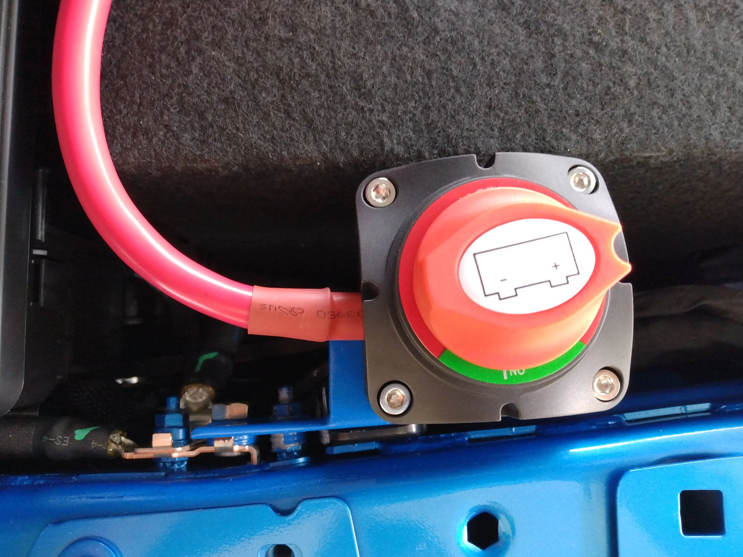

My winch came with a on/off switch, this was new to me. I made a bracket and mounted the switch. I figured why not.

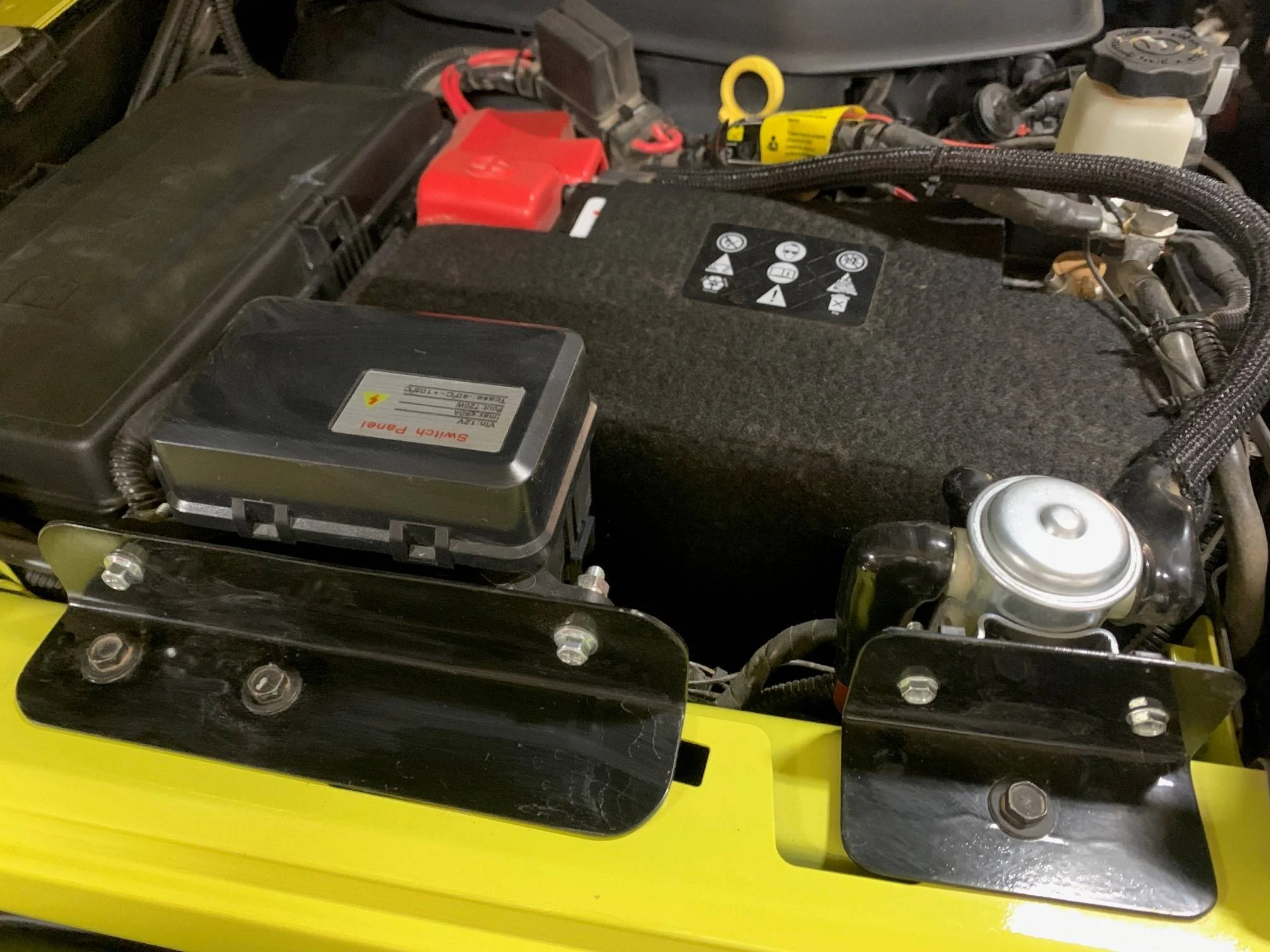

I installed a warn relay on a bracket I made as well and a fuse relay box for my lights, I have the winch turned on by Aux switch 4, I don't like to lift my hood unless really necessary.
