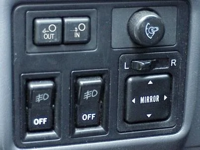

You still need a remote to control the winch, the aux switch at most would control whether the winch has power or not.
Similar to these switches in a land cruiser

There is no such animal in a JL. The question was around the Aux switches.
Correct. Wire two of the auxiliary switches in the JL to perform like the switches in this land cruiser. One for line in, one for line out.
I am not sure they can function that way, but could be wrong.

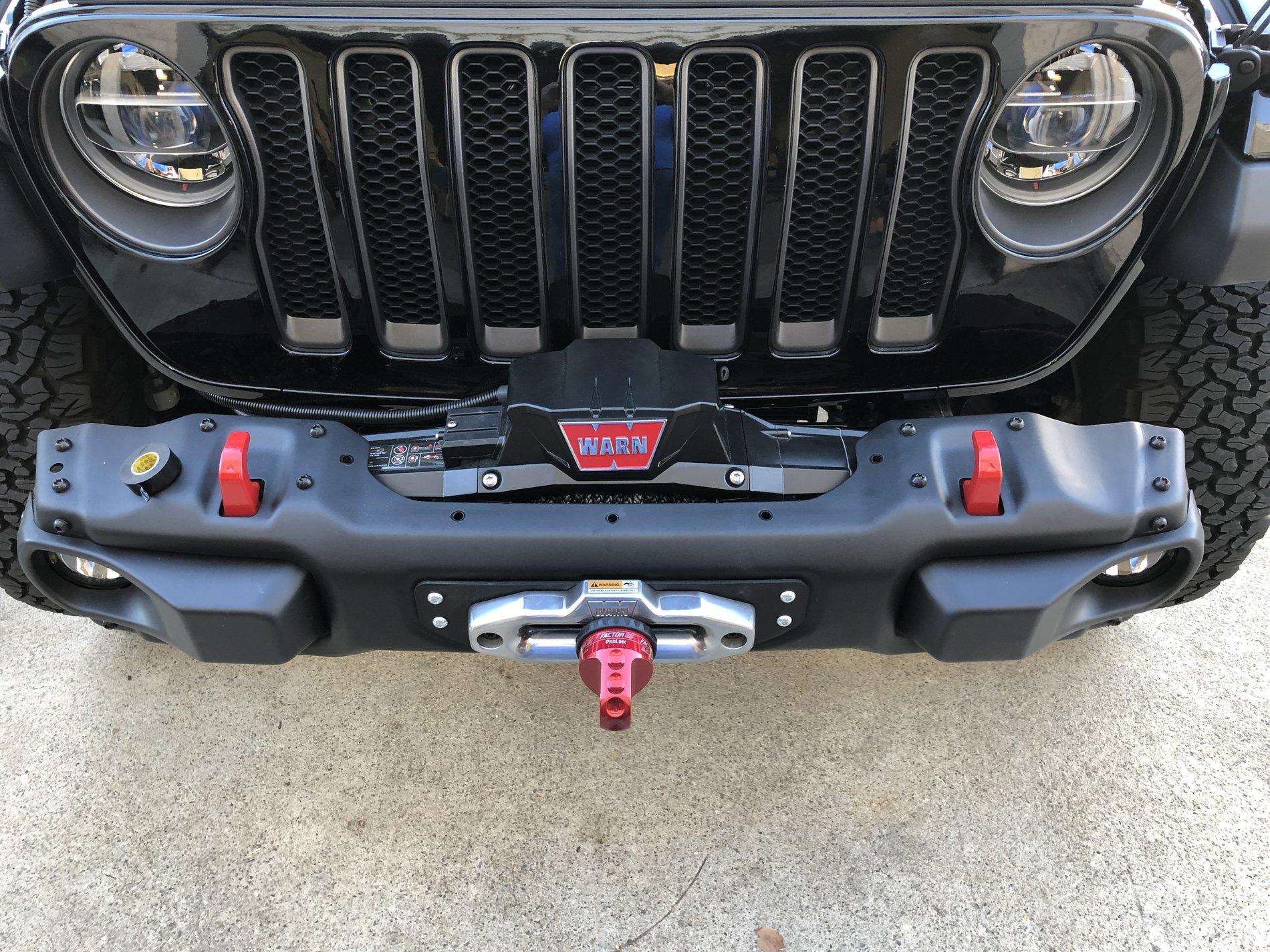

anyway, if i can get this puppy quickly, i can hang it on before i go to utah this weekend.....
it showed up today at 3:15 pm.
it was done at 6pm.
a 4" grinder with a cutting blade works well.
ABS pipe glue on the cut surfaces stops any rust,
and dries fast on hot steel.
christ, it's tight. 1/16" on each side, and 1/8" between it and the grill.
packing a marshmallow in a piggy bank tight. but it fits.
off to utah for four days.
