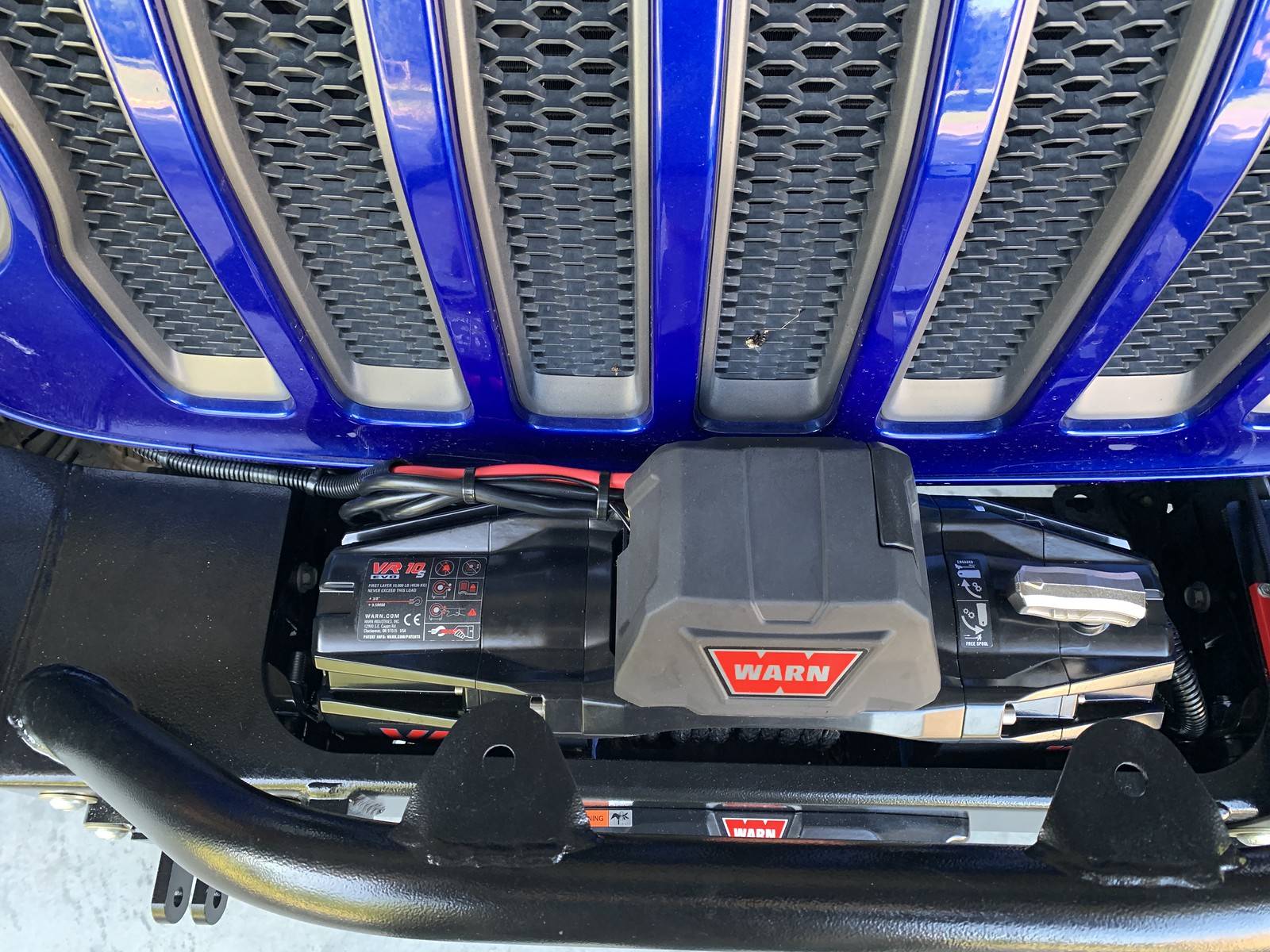

I put a Badland 12,000# winch on my gladiator using a Rockhard bumper. The only issues I had was grill to winch clearance. The Rockhard bumper comes with to spacer sets to give more clearance from the grill. I used both sets. Also, the power cables for the winch come out of the back of the housing. I moved the cables to the side.

I used another Rockhard bumper for my Wrangler. I bought a Warn 10,000 pound winch for the Wrangler. The winch was on sale plus there were significant rebates. Throw in the smaller footprint of the Warn winch and it was a good fit (pun intended) for my Wrangler.

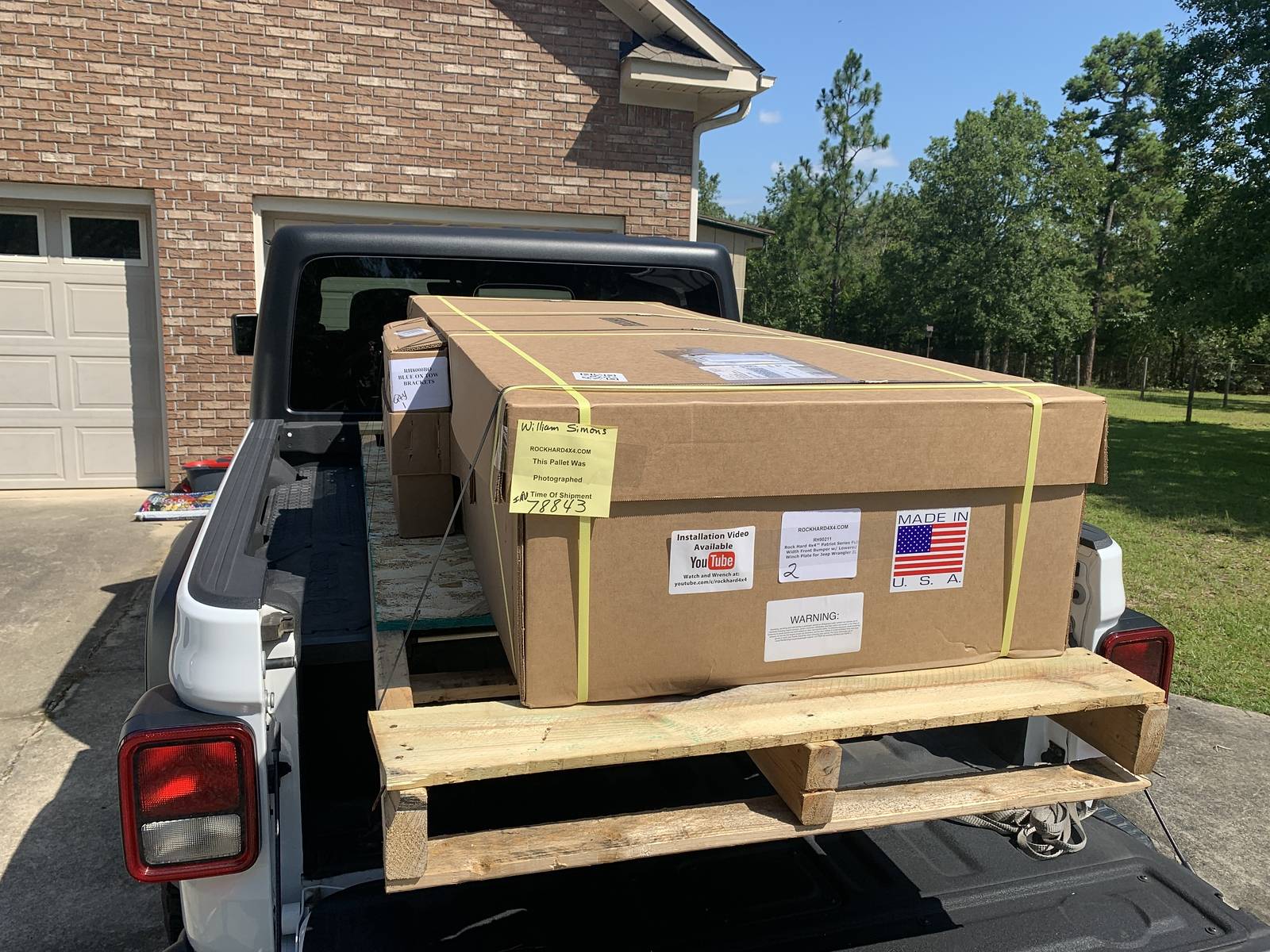

I bought my 2nd Rockhjard bumper form Quardatech. Rockhard bumpers are not cheap, but you get a first class bumper, a good winchplate, and a good skid plate out of the deal. Throw in the ability to add towing brackets to the Rockhard bumper and it is a great fit for my needs. I picked up my bumper at the nearby FEDEX delivery center.

Easy install. The Warn VR 10-S EVO had a significantly smaller footpring than the Badlands Apex winch I put on the Gladiator.
Jeep Wrangler JL Winch bumper i-nGWCsBx-X3
I moved the cables on the Warn winch to the side just like the Badlands winch. I couldn't bear the thought of the cables rubbing off that beautiful blue paint. :)
