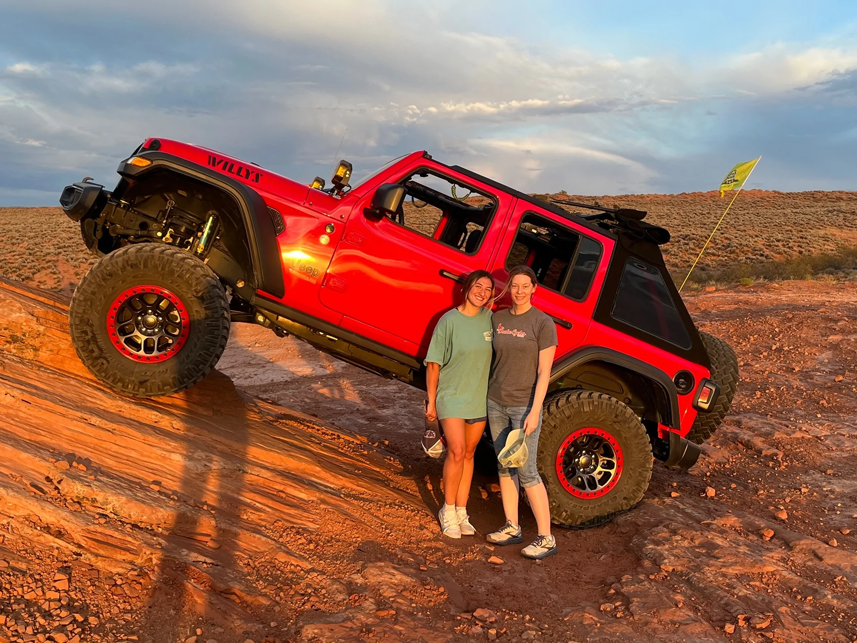

2.5 spacer, swaybar disconnect, and less than 500 dollars for 4 bilstein shocks in the appropriately longer length and the wheel travel is insane. Plus if you add a one inch bump stop you can fit 40s

Are you running any lockers? I can see this is the pre 2024 refresh so no rear locker from factory. Looks great!

Just factory limited slip and i let the brake force system do its magic. So far its done every trail i have put it on out here in sand hollow. Landslide is a 7 and it did it with a little wheelspin here and there but no problems. I led faultline for winter jamboree this year in it before the lift and tires, scrubbed a bit

Nice! I’m thinking about picking up a new Willys XR but am torn between this and a base Rubicon. Imo the Willys XR looks like a beast compared to the Rubi. Do you think it’s capable enough with the rear locker and not worth going to a base Rubi on smaller 33s?

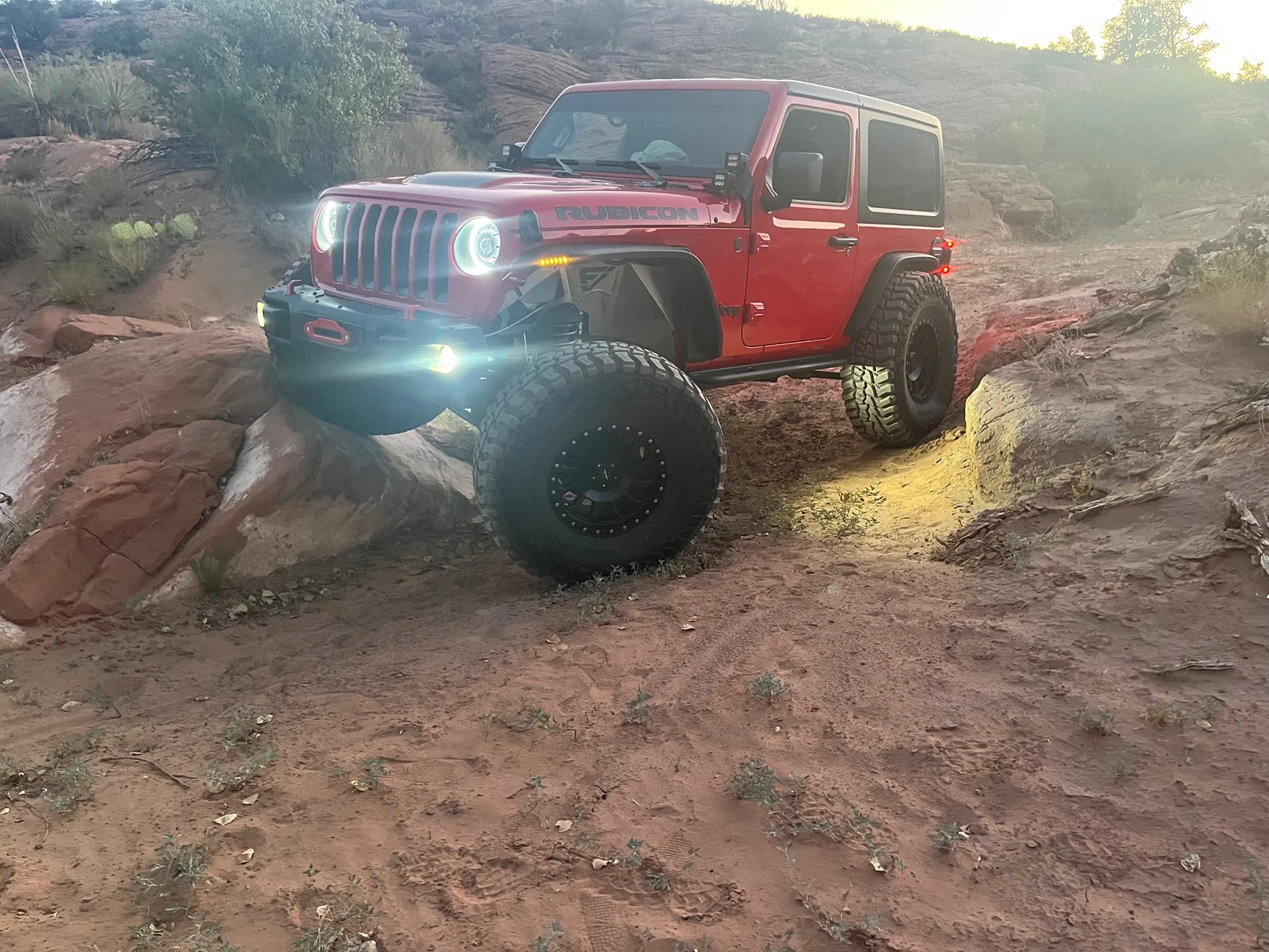

Jeep Wrangler JL Willys XR 37s IMG_3897
this is my other jeep. 2 door on 40s. I am actually thinking of selling it after trail hero and picking up another willys xr. Since my current willys is my son’s daily. I would miss the push button swaybar disconnect but nothing else

I love 2drs!
