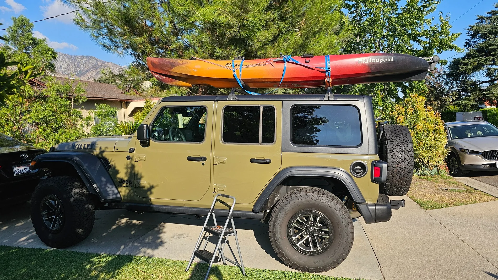

After wheeling for about 6 years and understanding what I enjoy and how difficult of trails I am willing to do. John bull is probably the hardest I would ever do. The Willys XR is going to serve me better than a base Rubicon. The 35inch tire package and the small lift are more practical upgrades than the 4:1 transfer case and front locker. A base Rubicon on 33s will get high centered everywhere. The front locker and 4:1 transfer case shine on some really hard stuff, when you truly need to push the Jeep to a point most of us never will.
Awesome choice OP.

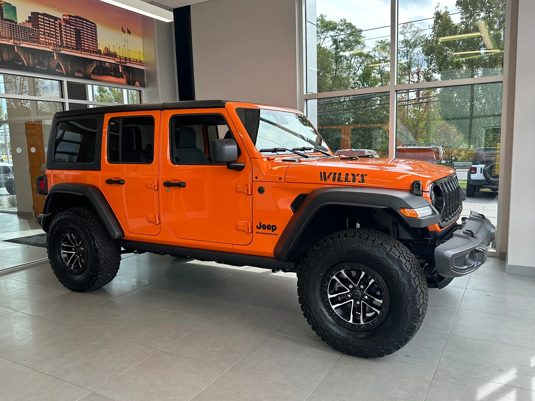

Just picked it up yesterday!
Looks nice. Too bad Jeep doesn’t offer the steel bumper package on a Willys. A factory bumper from a Rubicon should fit; just expensive unless you can find a takeoff bumper. I picked one up for my Jeep JK a few years ago from AEV which does conversions about 60 miles from my home in Michigan. It was about half price. I also have a 2 door Willys in addition to my 4 door Rubicon. Personally I prefer a color keyed grill in the Willys as opposed to black so I picked up a take off from Facebook Marketplace.

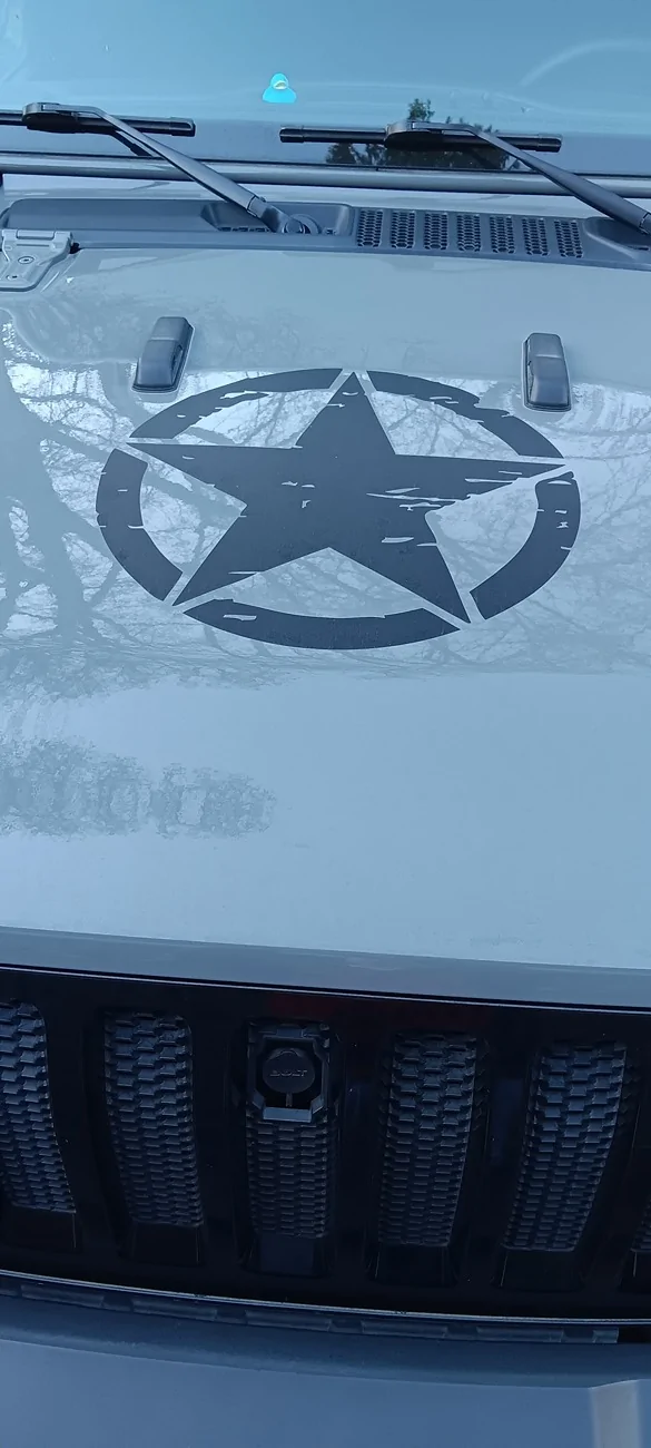

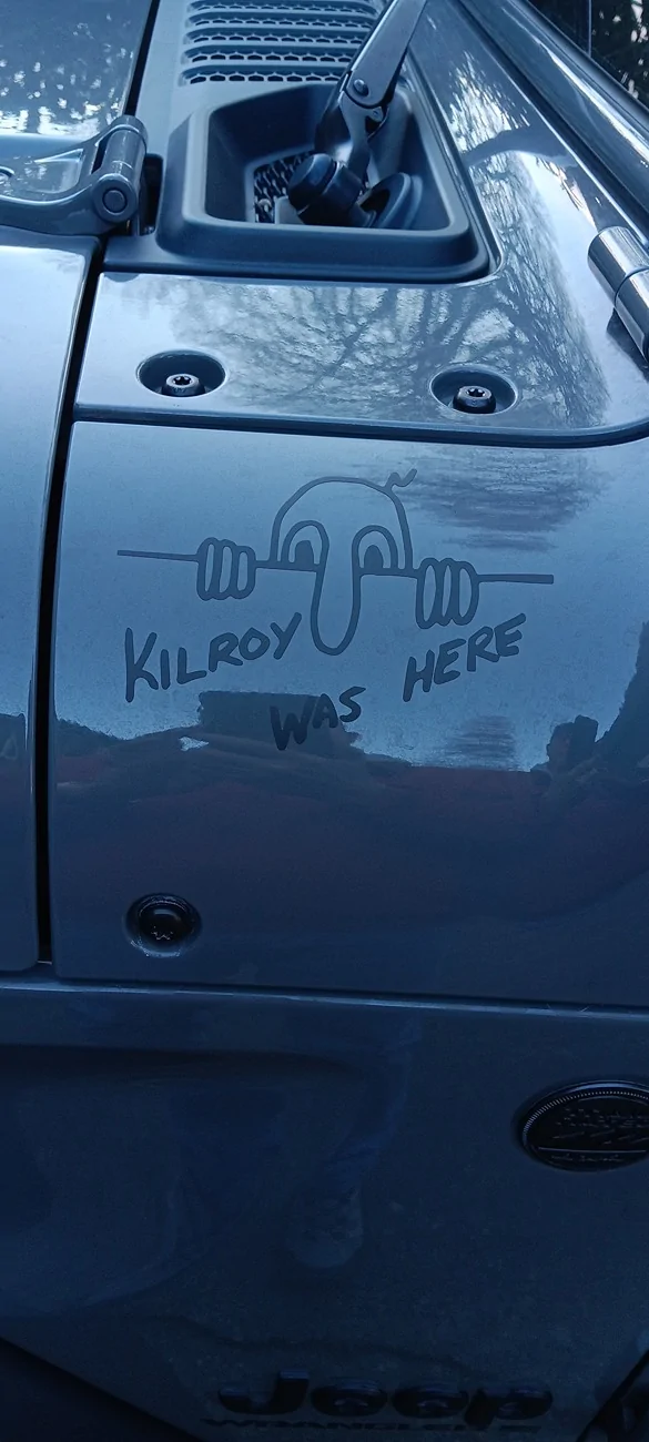

23 JLU Willys XR 2.0T Sting Grey. Love it. Mild factory lift, 4.56 gearing, 35" tires, nice rims, wider axles, etc.
I could have got a Rubi, but didn't. Didn't think I'd need the 4:1 transfer case (I feel it's really only useful in hard-core rock crawling). Also didn't want the "All or nothing" lockers.
Basically added 0.5" spacers front and rear, Mopar front LCAs, Fox 2.0 IFP shocks, and TrueTracs front and rear. Mopar FAD delete plate and a Tazer to make the Jeep think there never was a FAD up front.
