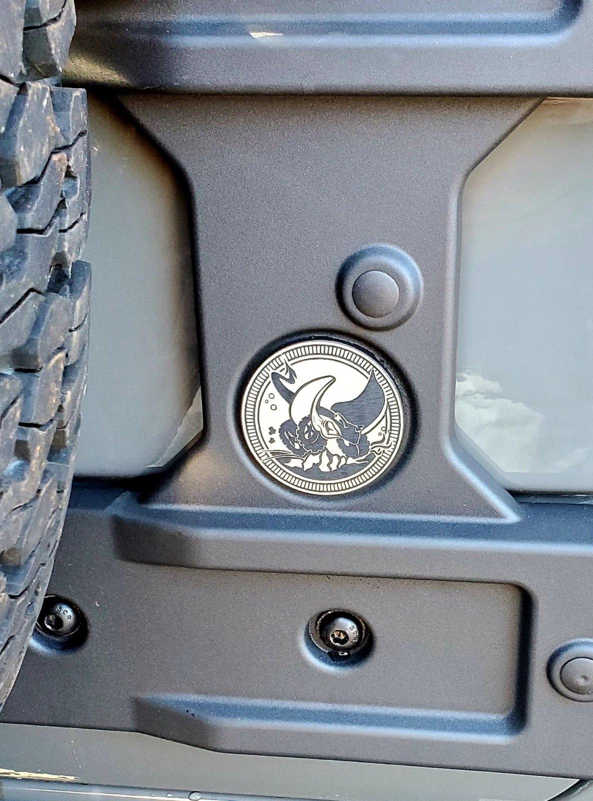

One important thing, you do not get the trail rated badge or the spot to mount it :LOL: Happy Holidays. Must say it looks like the OEM I just installed which I just paid under $500.
My Chinese Knockoff had a spot for a Badge. Just no Badge. I put my Sting Gray Badge there.
Nice, another plus for the knock off. Funny I am waiting for my Sting Gray badge also just for that spot. The USPS has it delayed.
