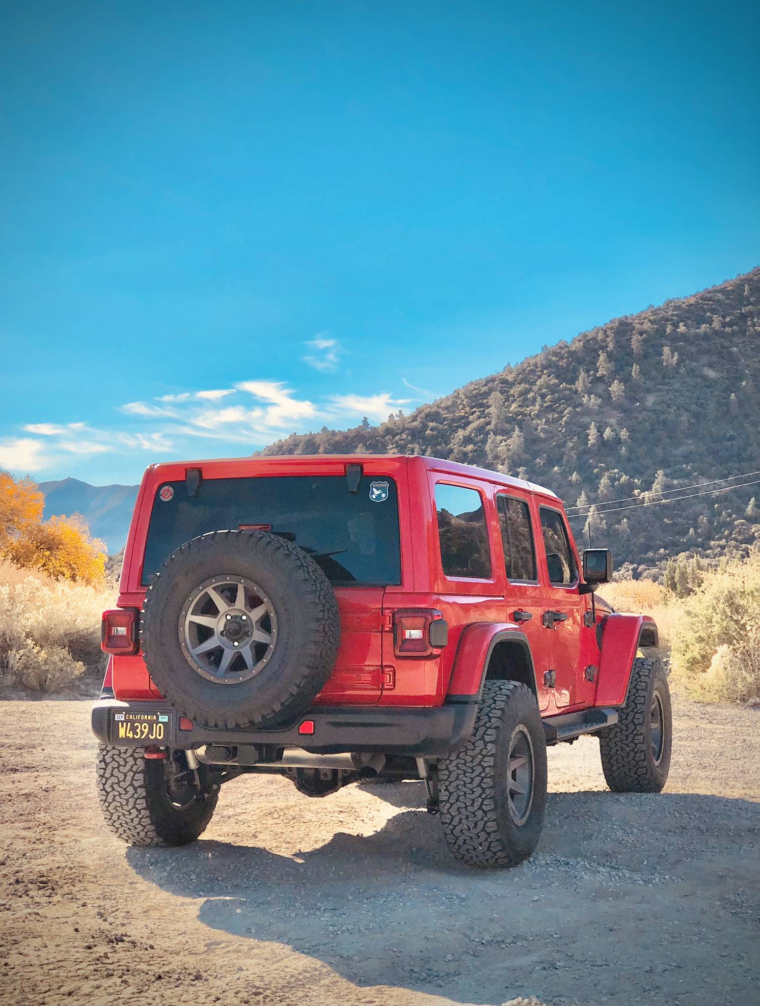

Great to hear you do not have any issues. I will definitely be sure to lengthen the bump stocks. However, the tires I purchased are 285/75 not 70. They are pretty much a 34in tire and weigh 60lbs (E load). That extra 8lbs pushed me over the limit just slightly.
Yeah I noticed that I had misread the size and I removed that part. Thank you!
