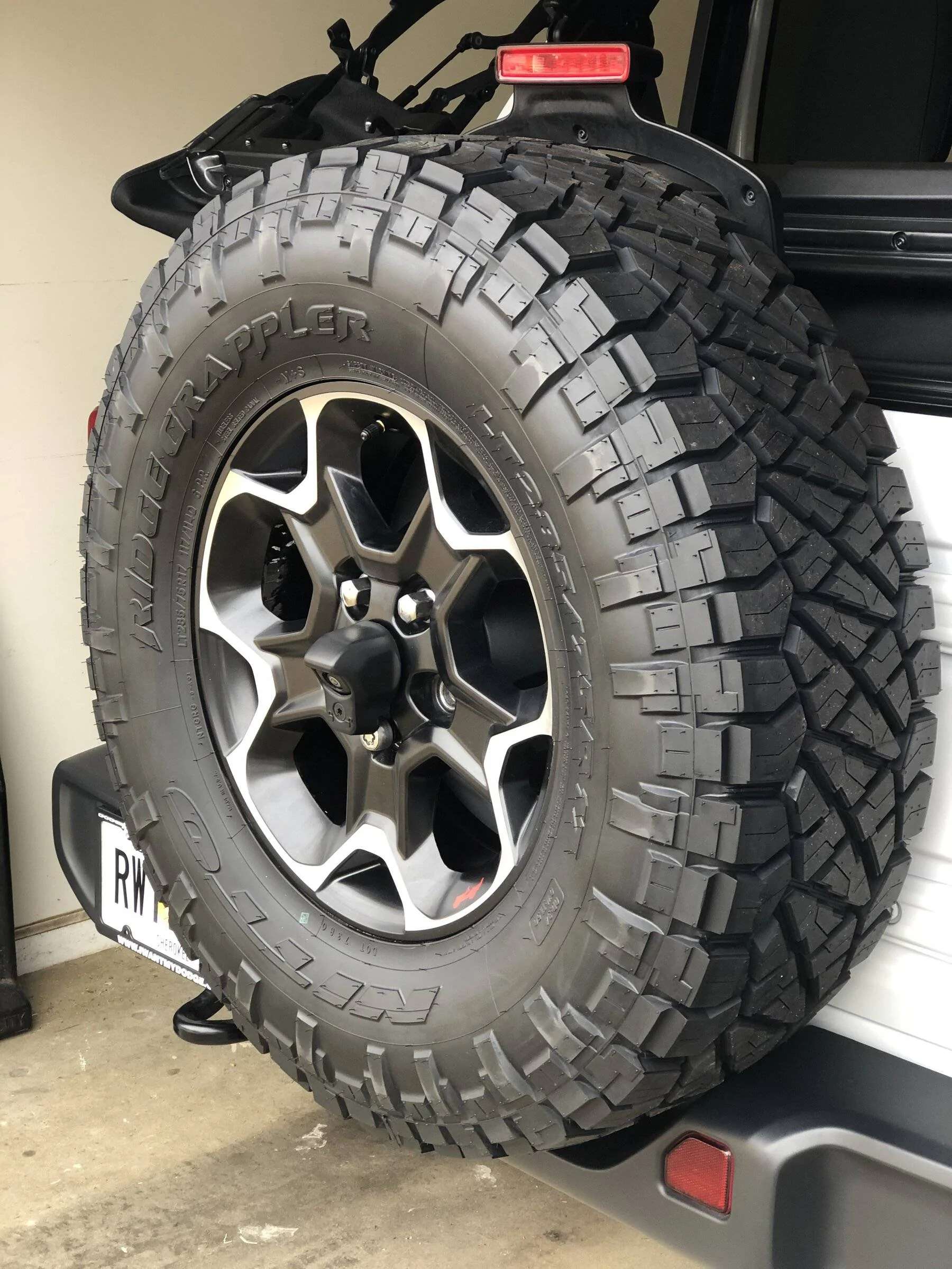

I know this has been discussed a lot and the max tailgate weight is 85lbs. Just seeing if anyone has ran a 90lb wheel and tire setup on the tailgate without reinforcement. If so was there any issues?
The setup in question:
285/75r17 BFG K02 - 60lbs
Icon Rebound 17x8.5 - 30lbs

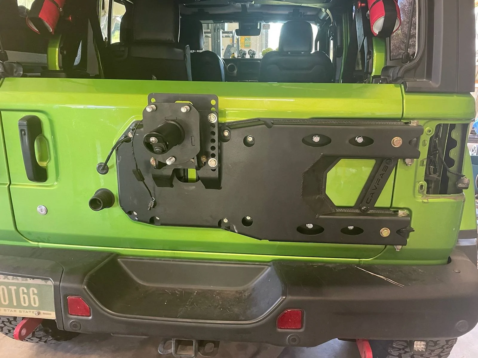

While you can get by without...over time it will fatigue the hinges / tailgate and could lead to some alignment problems down the road.
We have had folks upgrade to our carrier for a 285/75 just for the peace of mind and for the fact that when they go larger down the road they already have the necessary components to do it right.
Fully agree. I tried to make the Mopar reinforcement kit work, but the hinges do not reach out far enough on the door and even with the Mopar kit, the tailgate is still load bearing.
Very happy with my CavFab!

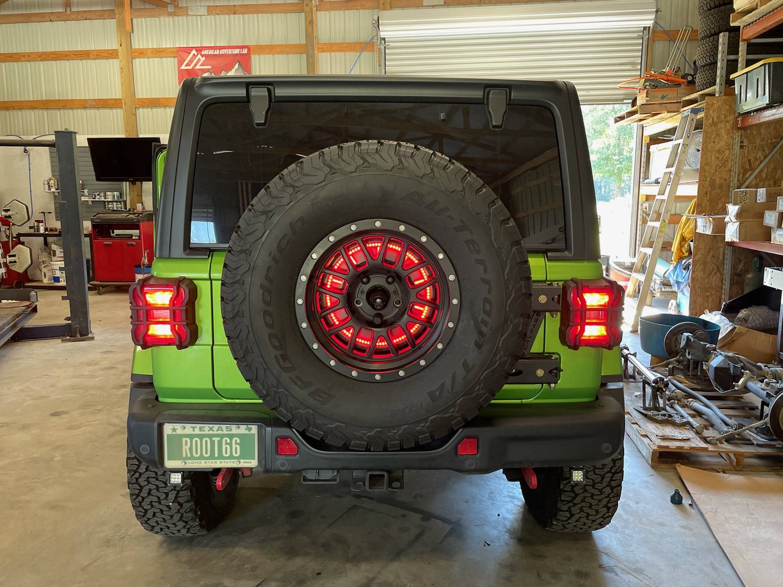

Not to open a can of worms here...but there is a reason a lot of the top dogs in the carrier world chose against a bumper mounted solution. That single pivot point on the bumper tends to become a weak spot and we have seen (and have photo evidence) of these failing (which tends to take out the tailgate with it). A properly designed tub mounted carrier is typically superior in every aspect.
Total noob to carriers so forgive my ignorance...here to learn.
Are you saying that the bumper itself can become weak and fails where the the carrier is mounted?
I haven't even looked at the OEM hinges, but doesn't the aftermarket carriers just mount to the OEM hinges?

Most completely replace the hinges.
The swing out ones that mount to the bumper can and have failed as well. In saying that, some companies make some seriously solid carrier/bumper combos. Hauk and Genright come to mind.

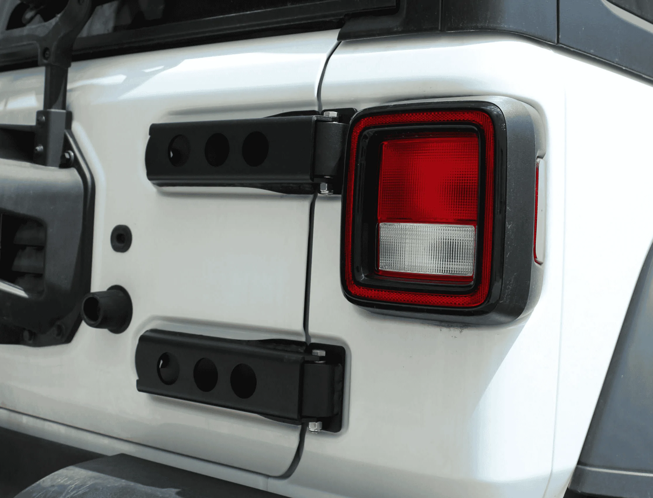

I did a bunch of research and screwed up by purchasing a rugged ridge reinforcement set up….two months and rusting. I’m moving to this:
https://genright.com/products/jeep-jl-swing-out-rear-tire-carrier-aluminum.html
local shop will powerboat to match my ROCKHARD bumpers. I feel this will give me a lot more flexibility in storing items, third brake light issues and ease of use. I wish I would have just done it right the first time and not spent cash on that rugged ridge crap….
I have the Rugged Ridge Spartacus hinge replacement/tailgate reinforcement going on nearly two years now. I don’t see any rust. It’s made of an aluminum casting. What product were you referring to? Was it the pins or other hardware that is rusting?
