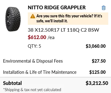

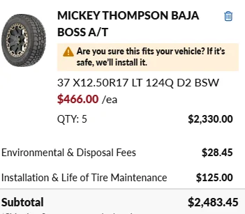

What’s wrong with nitto trail grappler 38’s? That what i was planning to buy.
You can get a BBAT in a 37 for far cheaper. That extra .5 of clearance isnt worth $730.

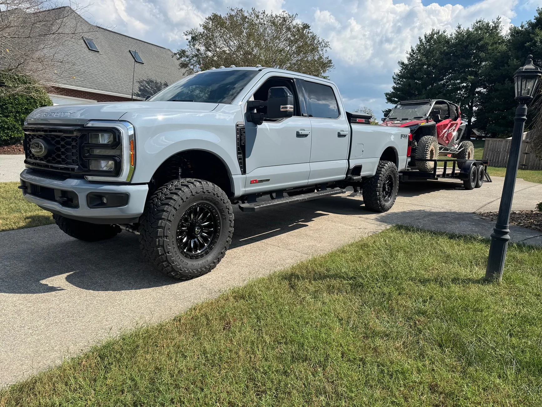

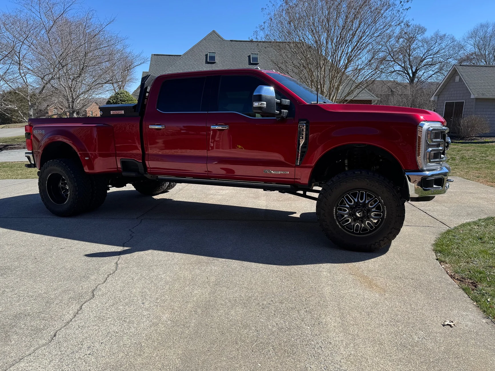

I have not heard anything good about the Baja boss at’s.
I don’t care for ridge grapplers, I alway run either toyo MT or nitto trail grappler mt.
ahhh you just like wasting money .... get the 38s for sure then

Run a spare and bring some side wall patches with you. It will still be cheaper to get the BBAT and the Discount life time replacements than 38s for .5" at most extra clearance. If you want a bigger tire just go to 40s.
