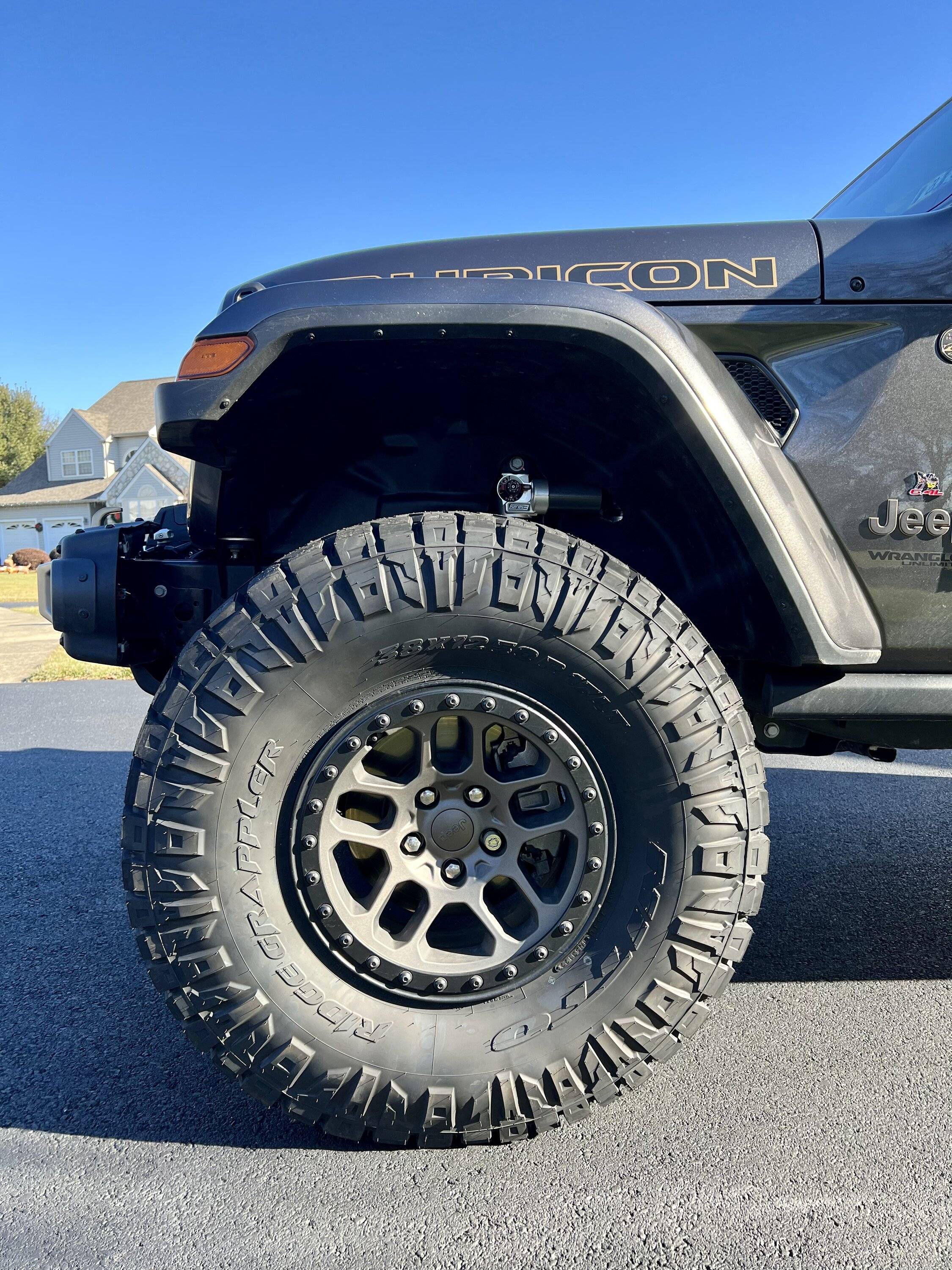

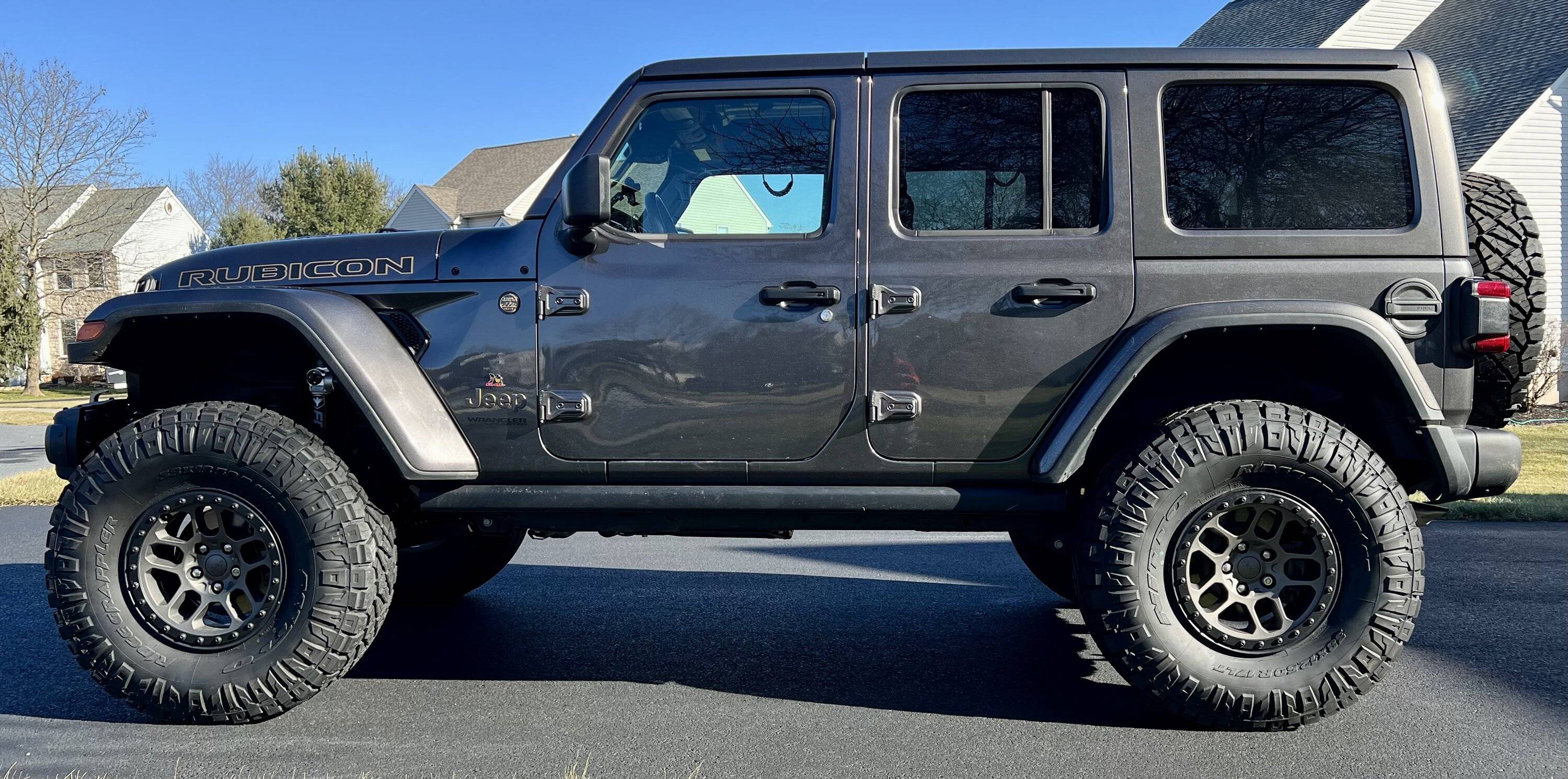

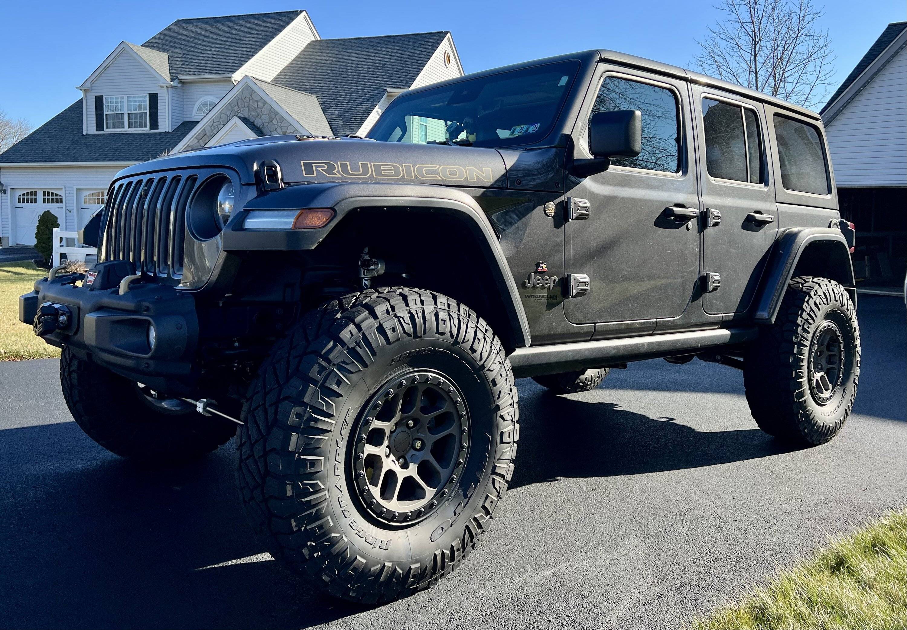

38x12.5r17 Nittos on Mopar beadlock wheels, no spacers, 3.5” Clayton lift. No rub on road but I have a feeling it’s going to rub when I hit the trails and start flexing. Whether you will rub is highly dependent on the offset of your wheel.
Mines an XR so has 4.56 gears but is the 392 so not comparable to the 2.0 or 3.6 from a gearing perspective. That said for what it’s worth you can definitely feel a loss of feeling of power with the 38s over the stock XR 35” KO2s, even with the hemi, so you’ll probably want to regear with the 2.0 or 3.6.
