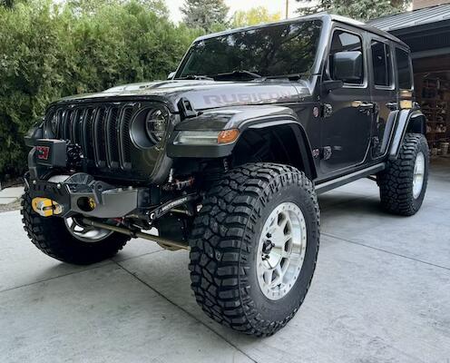

Ran 38x15.50R20 Patagonia's until they were around 50% tread and then I was loosing traction even on dry pavement. They balanced out perfectly and no blow outs. Switched to 38x13.50R20 Cooper STT Pros and Battle Born beadlocks and love them! 2.0T/e-Torque, 4.88 gears, 3.5" MC GameChanger with 2.5" Fox tuned by Accutune. The steering wore out quickly but since replacing haven't had any other issues. Driving amazing on and off-road. Had some rubbing on the inner fenders in the rear but trimming fixed it.
Edit: Brakes were a major issue for me; upgraded to 16" rotors and 4 piston calipers. Definitely a must have with this much rolling mass
