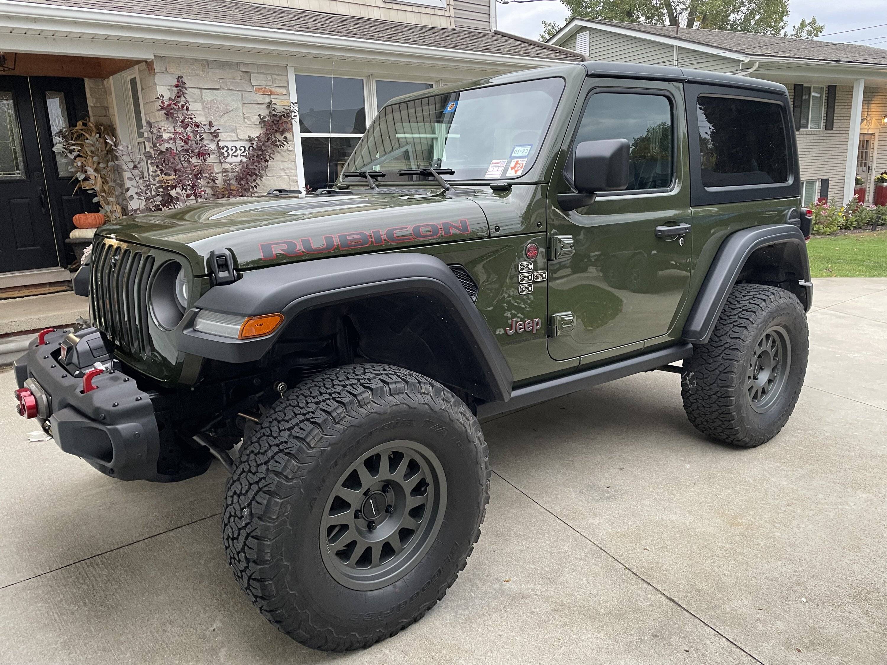

Well, depending on if you plan to run a lift or flex it a lot might also matter to you. Most lift manufacturers recommend 4.5” backspacing or less to clear all components, but I know on Metalcloak lifts with rubicon axles you can get away with 4.75” because that’s what I run.
Personally, I like to keep as much tire under the fender flare as possible so I would lean towards the 0 offset wheels unless it’s going to interfere with future suspension components. I have 0 offset on an 8.5” wide wheel and there’s still some poke. I have the same size tire (315/70r17) so yours would stick out a half inch further.
Sorry it’s hard to accurately capture stance on camera, but these should give you an idea.

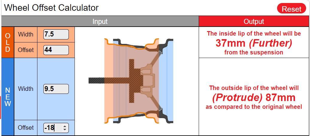

Here is a screen shot of a wheel calculator showing you where the new wheel will sit in relation to the stock wheel. The Blue is the new wheel which will push the front lip of the wheel outward 3.43 inches compared to the stock wheel. Wider tires will make it wider as well.
