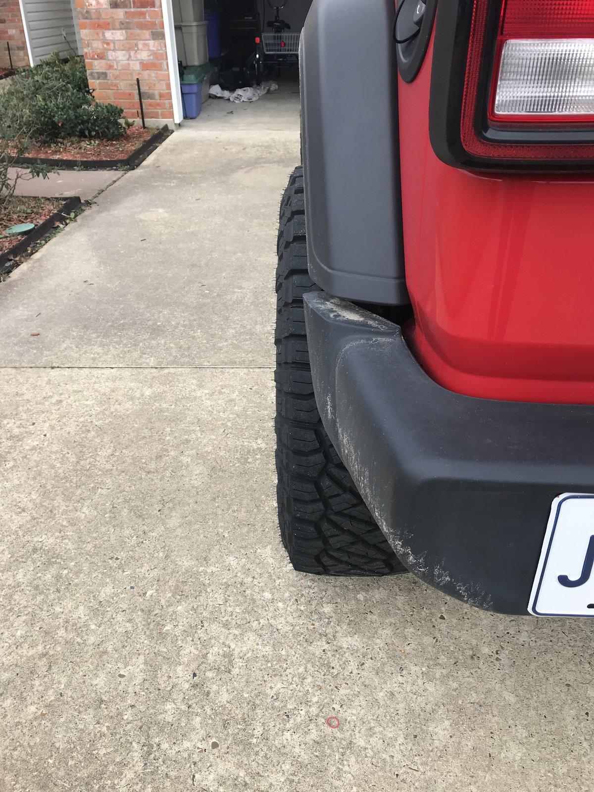

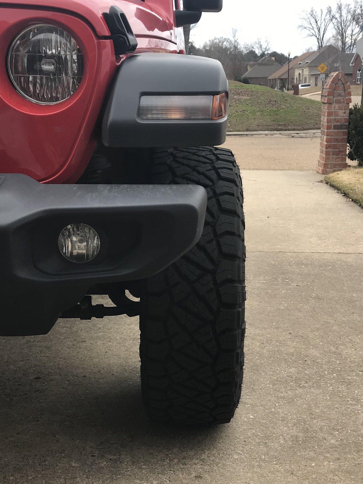

Spidertrax is the right answer. Only spacers I have ever run on my Jeeps. Don’t go to ebay or cheap out on spacers you will regret it. 285/75/17 Ridge Grapplers
That looks good as well
