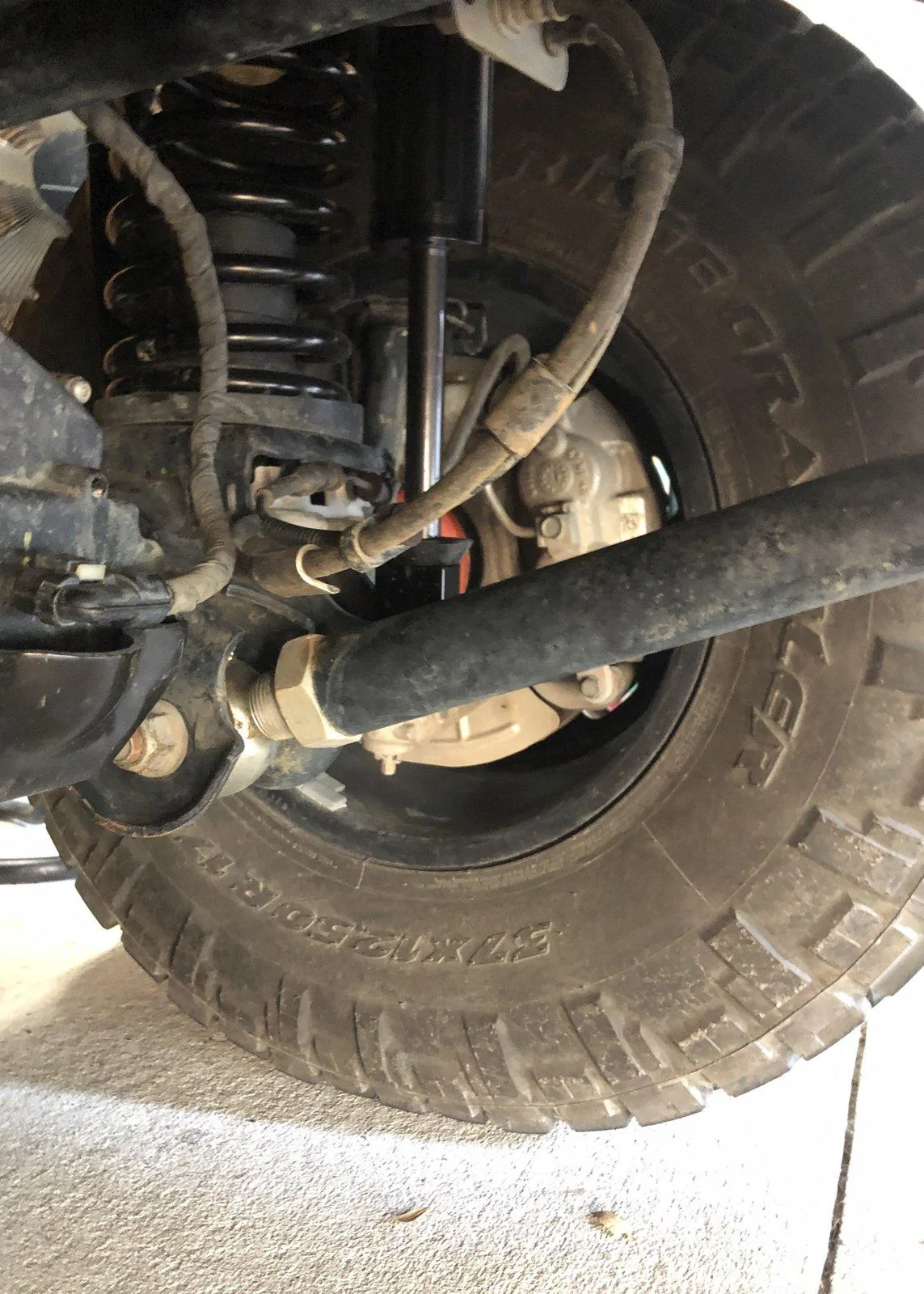

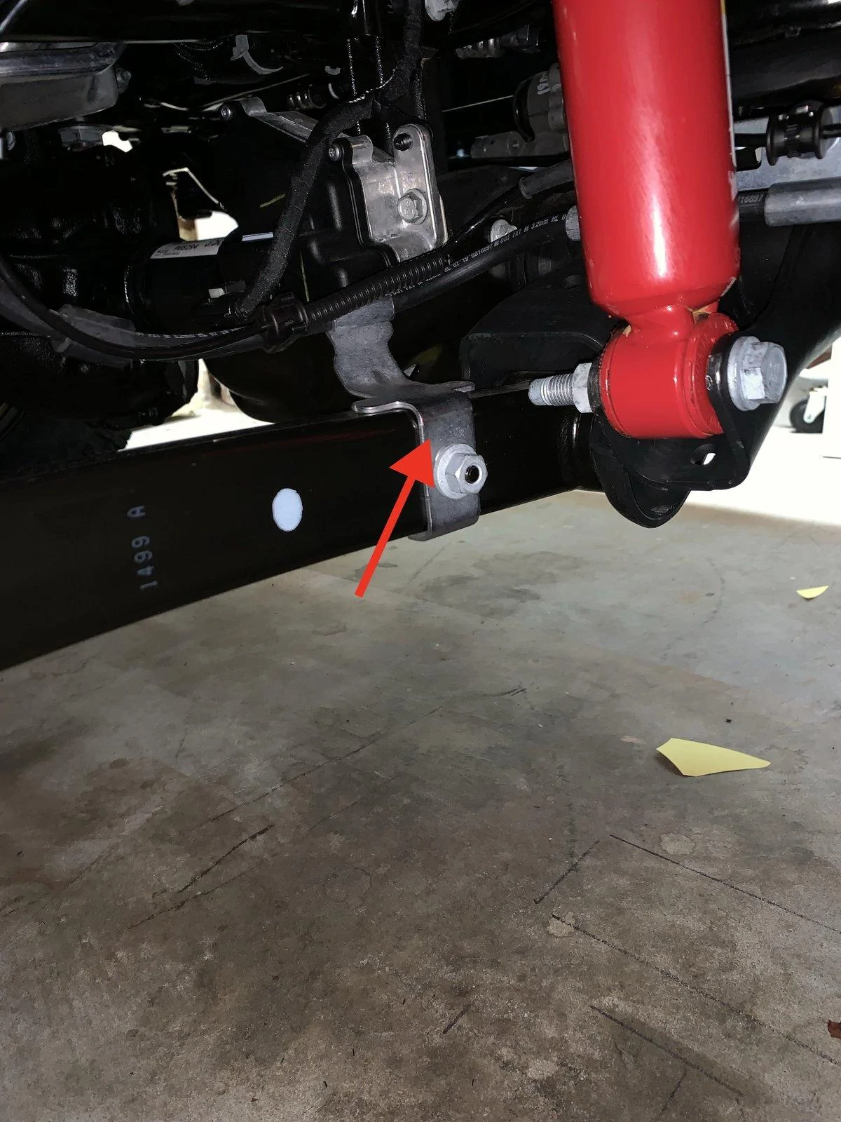

Hi guys,
So I ordered the Teraflex Alpine IR LCA's which arrive in a week along with the Teraflex Alpine IR track bar. I noticed on the OEM LCA's that there are brackets bolted to them that support a couple of hoses that I believe are for the brakes.
Where are these brackets relocated/reattached when the Teraflex LCA's get installed?
Thanks a ton.

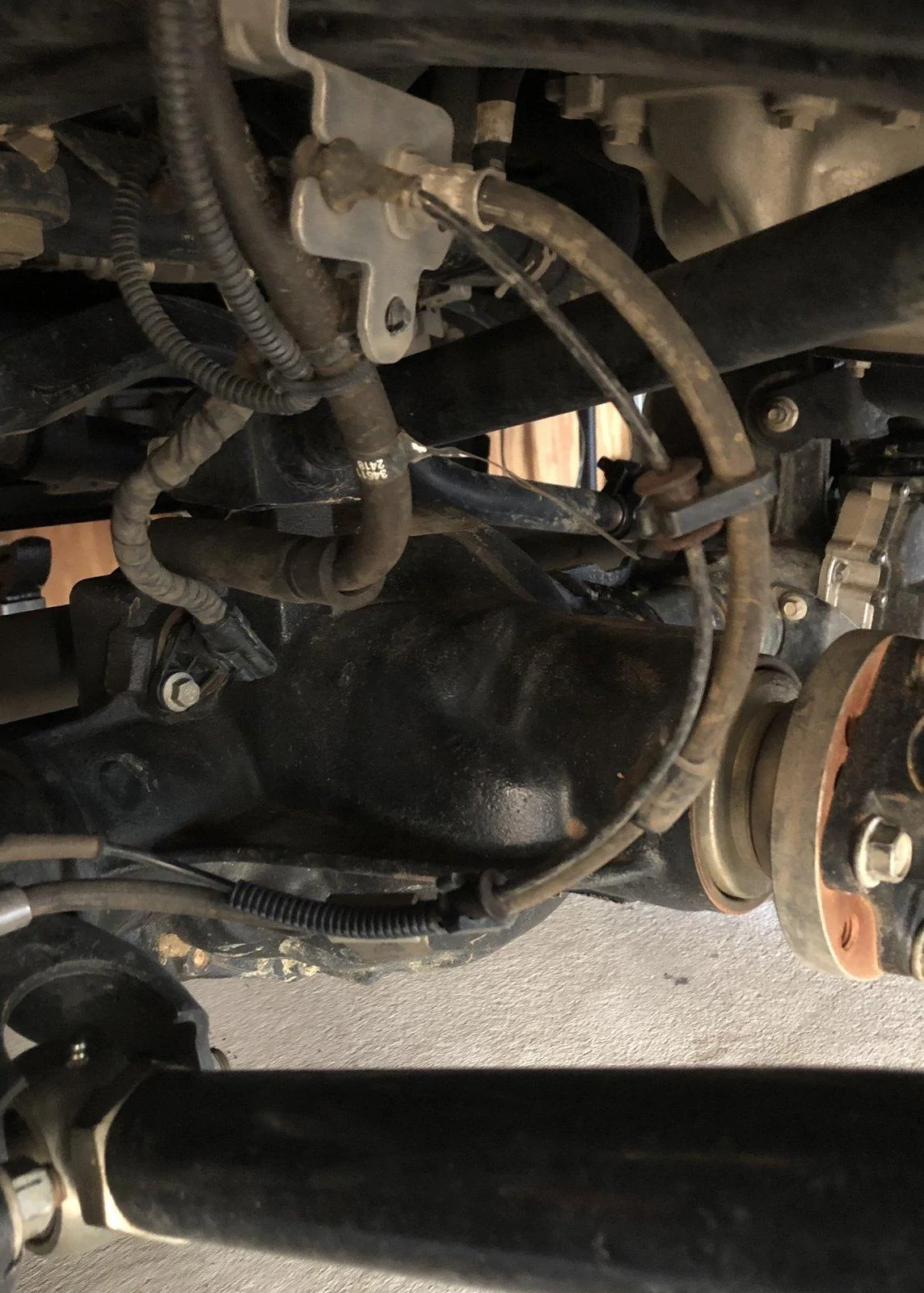

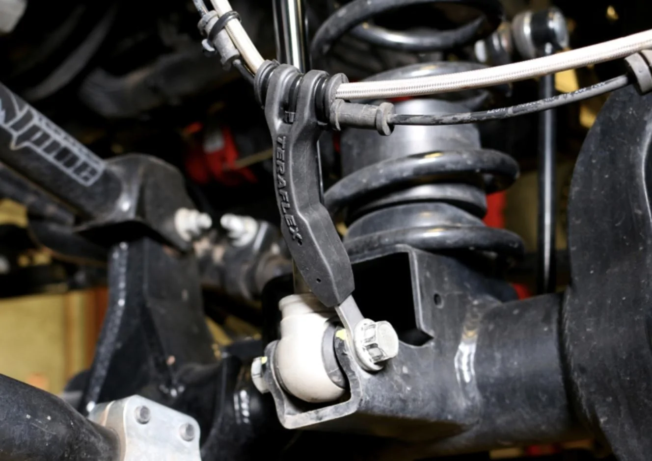

OME and Clayton Off Road provide for reconnecting them. Synergy shows you how to cut them off and not use them. Perhaps on lifted rigs it is not possible to reuse them anyway. Mine is stock lift so I went with being able to remount them to keep sagebrush from maybe catching the loose lines.

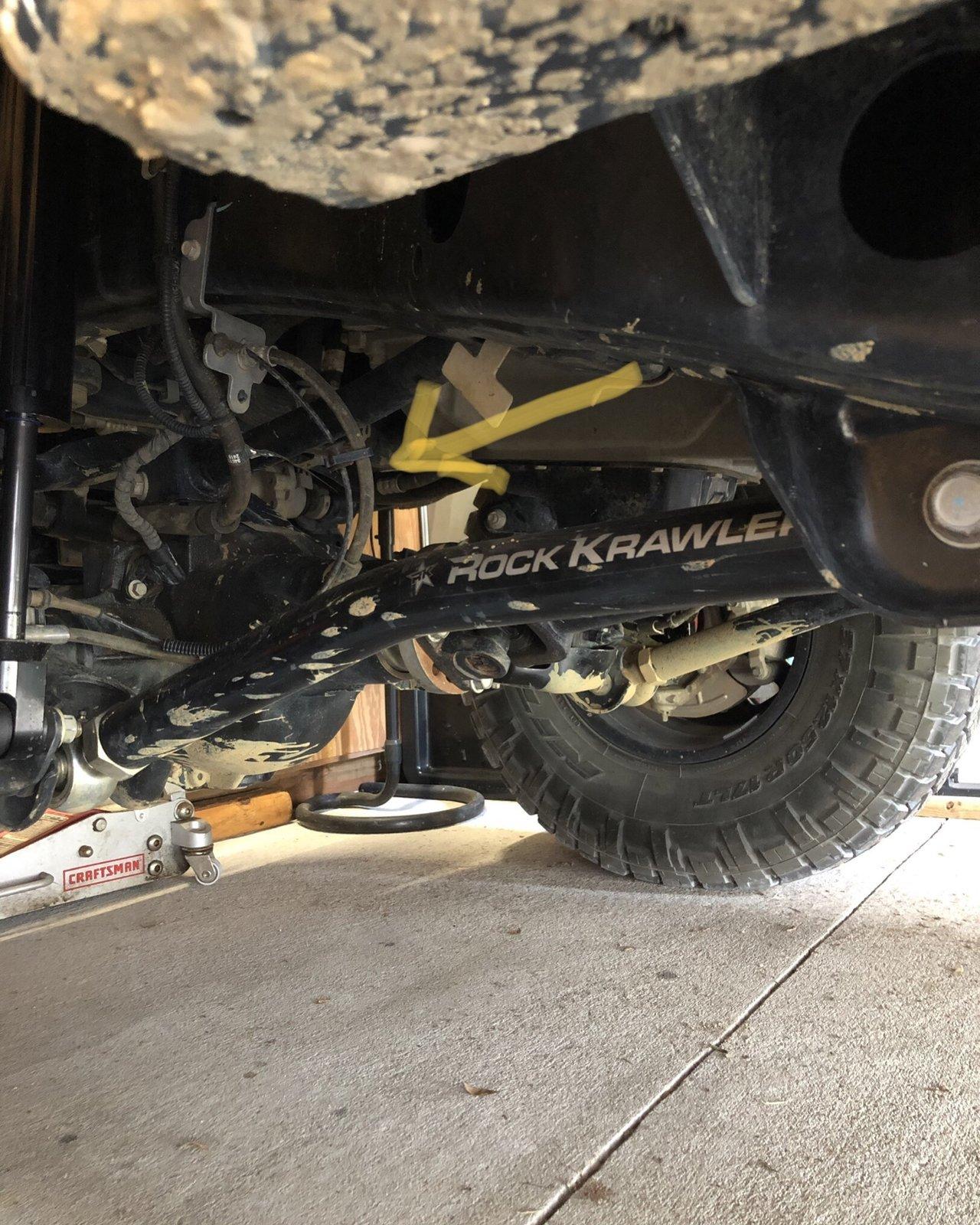

you don’t need them, I cut mine off, I’ve got 3.5” lift and to much shock travel to use them.

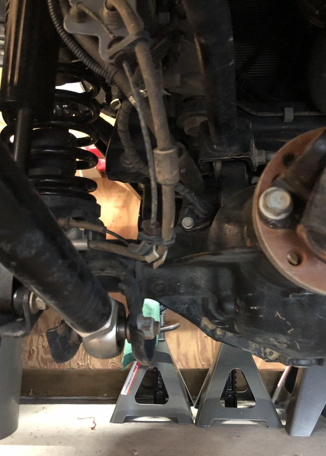

yes, they are loose nothing on them, they’re pretty stiff and stay in a semi circle. Here’s better pics. I cut mine off with grinder, and left that piece of bracket on the hose, didn’t trust myself trying to pry it off the hose and chance puncturing it... lol.

I haven't done mine yet, but what Roky did is exactly what I will be doing, only using an air cutoff tool. I was thinking about using some of my stainless steel zip ties to attach them to the new arms if necessary. I'll take pictures when I do it.
