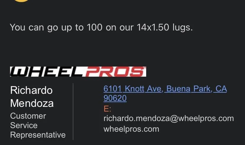

This may be a noob question….. but would aftermarket wheels and then needing to use spline lugs to fit said wheels lug holes ..so does a different rim and more importantly a totally different type of lug nut change the torque spec???
Fyi I went with the gorilla spline lug nuts which are much skinnier than the factory acorn lugs.
Thanks
Just some food for thought here…the same day I asked the question (above) …I had also emailed gorilla automotive.
He just got back to me this morning with this replay
Wow, that's not great news :(
I assume they are aware of the manufacturers specs, and if so, how can they continue selling them for our vehicles?
FWIW, there are several Gorilla sets w/ that 14x1.50 thread, some are quite a bit less "substantial" than other sets, I wonder if it's one of the smaller lug nuts w/ that max 100 torque rating???

Yea I’m not exactly sure. I asked him afterwards why would it be 100 when their website states to first use vehicle manufacturer specs, than if not available to use aftermarket wheel specs…and then if both aren’t available to go by theirs..
He seemed to shy away from that question and proceeded to ask me which exact lugs I used. And as I posted here a few posts ago I showed him what I have. (This was all through email)
FWIW he came back and said he double checked with his QC department and that the ones I have can actually go between 100-120.
so take that for what you will. I just thought I’d share what their rep said
btw…nice avatar ?
Edit.. I didn’t finish the convo by telling him that they really should clarify things on their website if this is accurate information he is sharing…as many who purchase these including a lot of shops who sell their product, are under the impression to torque these to factory specs (130ft/lbs)
he said they will…but whether they do is a different story. Again I’m not stating what’s correct or not on either side….Im just relaying the info he relayed to me.
btw…nice avatar ?
