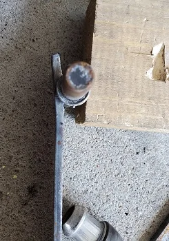

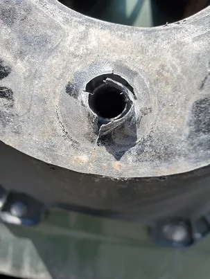

late to the party, never torque any wheel nuts at 130, alway do 110 who is 20+ from the recommended 90. As for the spare I just make sure it is tight, got one grease monkey one day torqueing the shit out of the spare and I ended up getting the stud out of the tire carrier

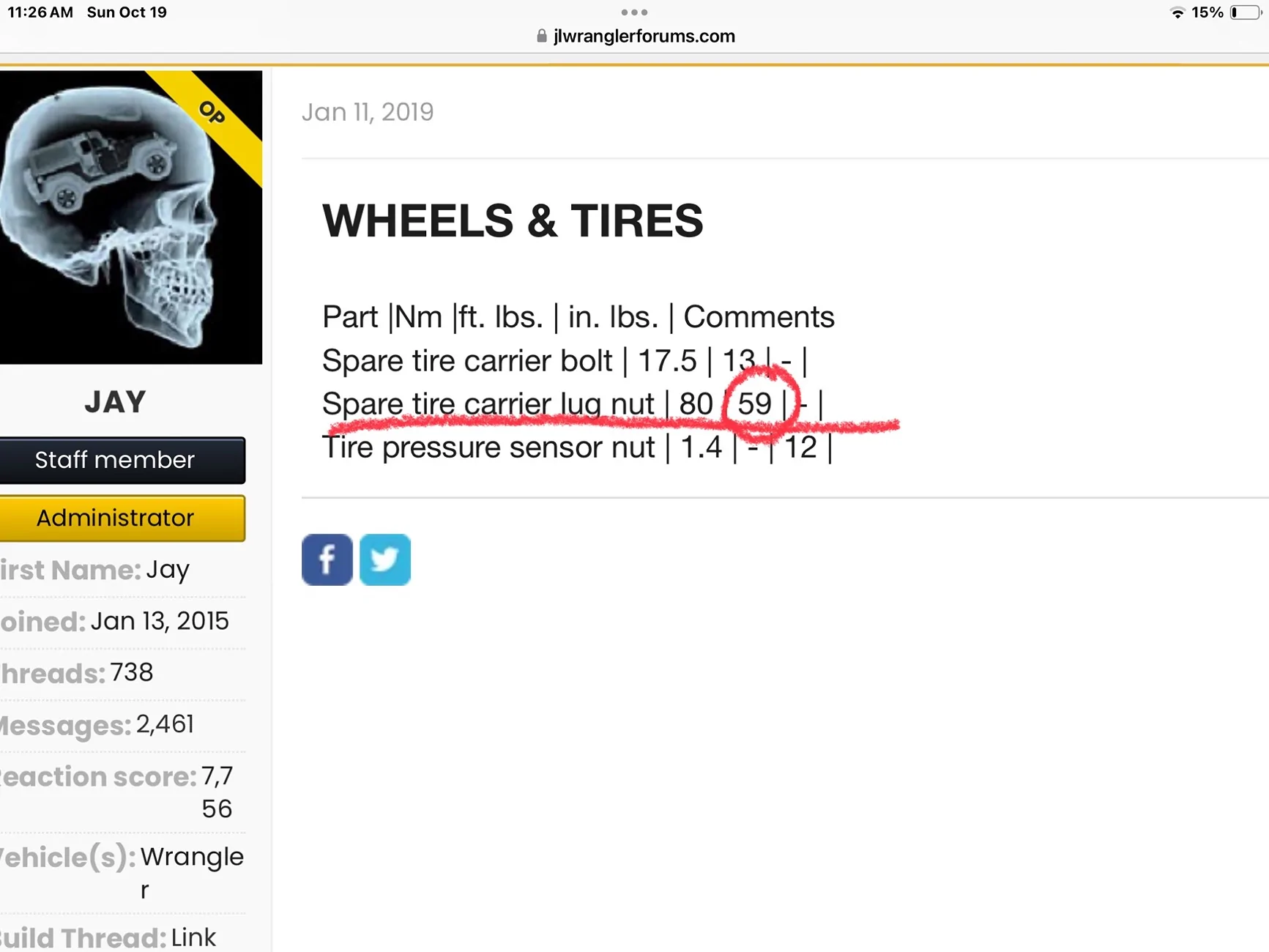

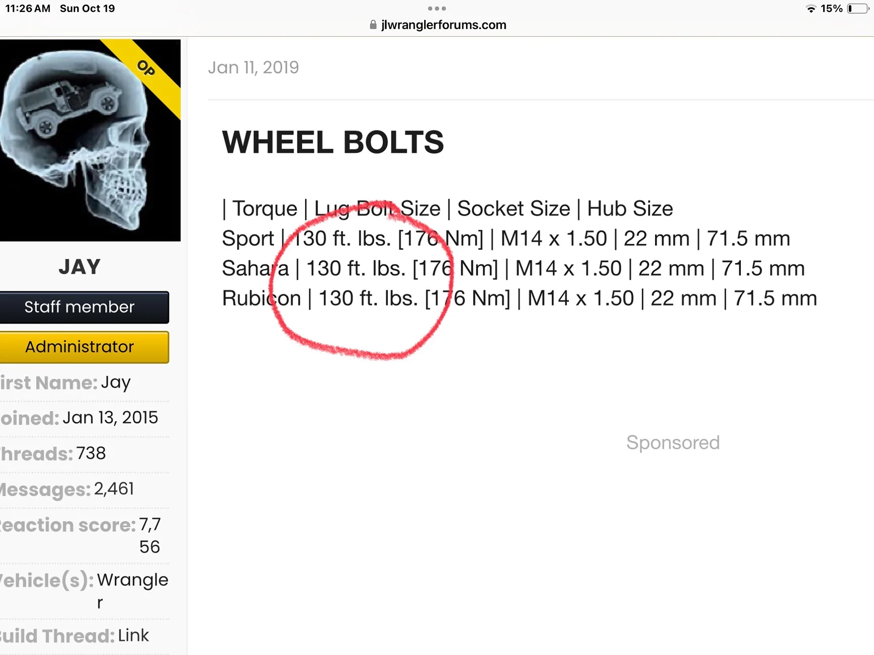

Since the thread is back. Maybe I’m misunderstanding. Regarding the Jeep Jl/JLU where are you seeing 90 or 110 foot pounds as the recommended torque spec rather than 130 foot pounds?

Why would Jeep state 130 ft/lbs if they didn’t mean it? The number doesn’t come from nowhere. Using anything less makes you a test pilot.
