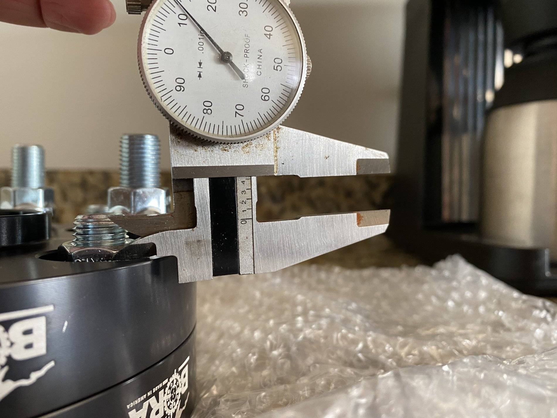

I just ordered Bora 1” wheel spacers. According to the tech, the threads of my studs only protrude out 3/8” past the 1” spacer. My stock wheel pockets are approximately .750” deep.
We’ll see...

@DadJokes
How did these fit?
Pics?
They’re not going on until I get tires but you can see in the pic how much the stock studs will protrude when they are on as they said they use stock dimension studs in the spacers.
