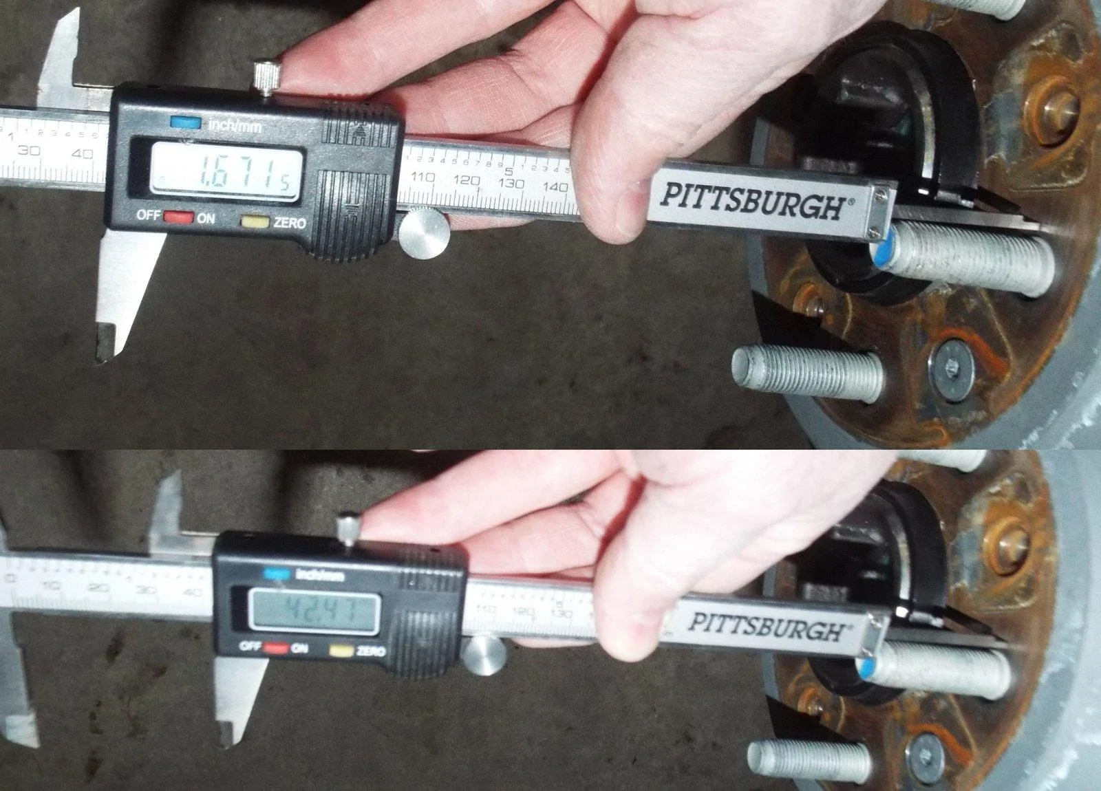

Don't know if this will be useful to anyone, but thought I'd post some info on the lug stud length.
I recently ordered a set of A/R wheels and I'm not fond of the long, skinny, splined, zinc coated lug nuts that many suppliers are going to.
I wanted to get regular, 6 sided, chrome lug nuts, and a set of locking nuts that would look better than the trailer hitch ball size Mopar set. Wanting them a little shorter than the 2.1" splined nuts, I wanted to double check the length of the lug studs to be sure I don't bottom out the new lug nuts just in case my new wheels were thinner than the stock wheels.
Anyways...Our lug studs are 1.67", or 42.5mm in length (past the brake rotor.)
