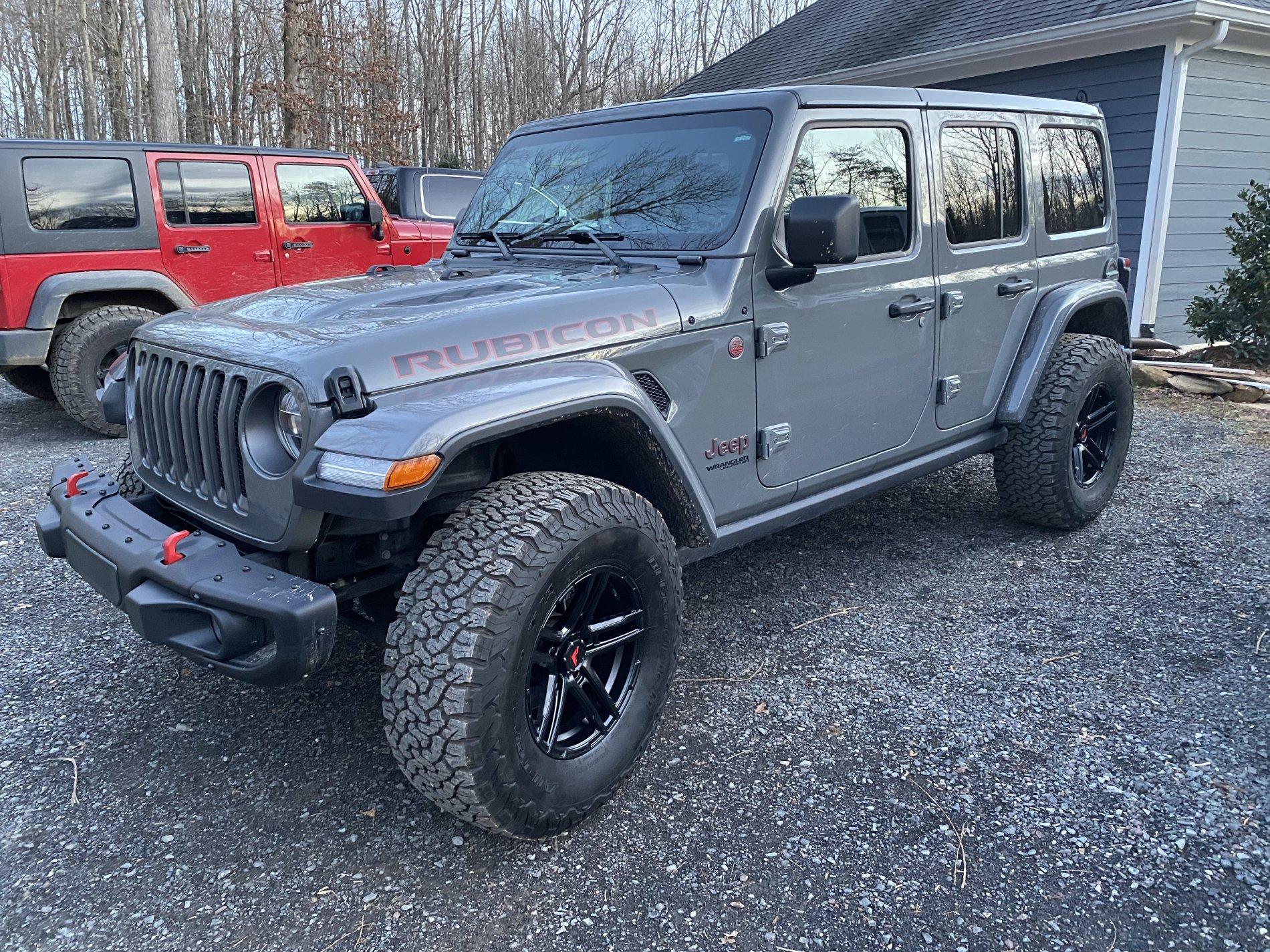

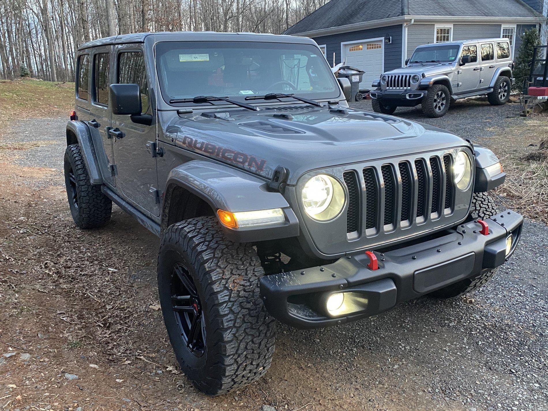

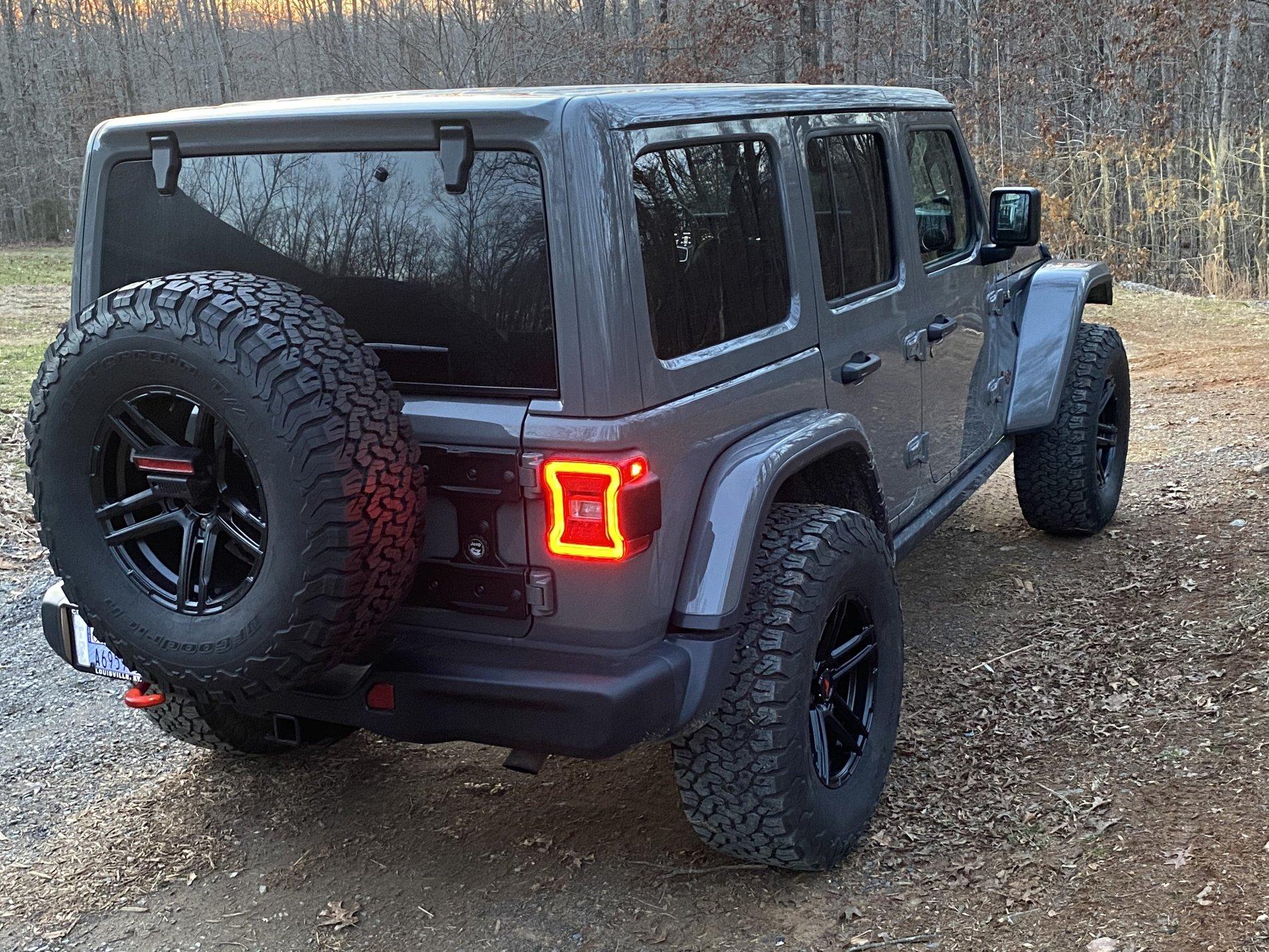

I opted not to go down the spacer road and swapped out my stock Rubicon wheels for a set of Venomrex VR501’s that I had already bought. The offset gives it the slightly wider stance I was hoping for. Here are some pics.

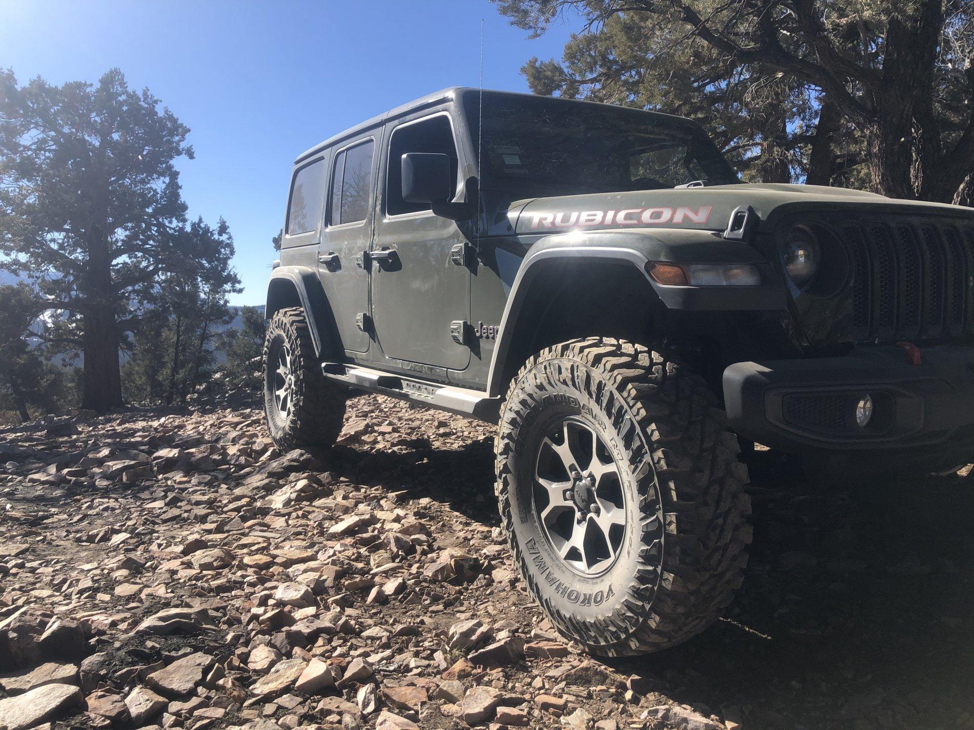

1.5" spacers on our jlur with 37's have been great so far. No more tire rub, steering is fine, ball joints are fine. They've been on for 6 months and about 10k miles. We've run holcomb creek and John Bull with them. I've had 2" spacers on my 2017 rebel on 35's for ~3 years and 60k miles. The truck has towed as heavy as 8k lbs, hauled a 2500lb pallet over 100 miles, been bombed across the mojave desert at 100 mph, and has ~93k total miles on it. Still running the factory ball joints and unit bearing. Good thing I didn't read that there's no way my set up would work and would be a maintenance nightmare on the internet before doing it I guess? A quality hub centric wheel spacer is no worse than running a wheel of the same backspacing. The factory rubicon wheels have a 6" backspacing, the same guys who tell you that the 1.5" wheels spacer will eat ball joints and unit bearings have no problem running wheels with 4.5" backspacing or even less sometimes. It's the same thing.

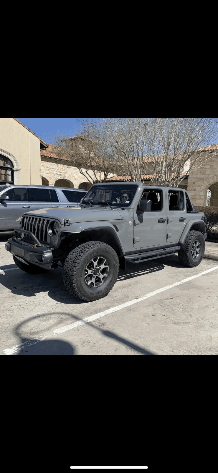

I ran 1.75 spacers on 35’s on my sahara for about a year with no issues before I got new wheels.
