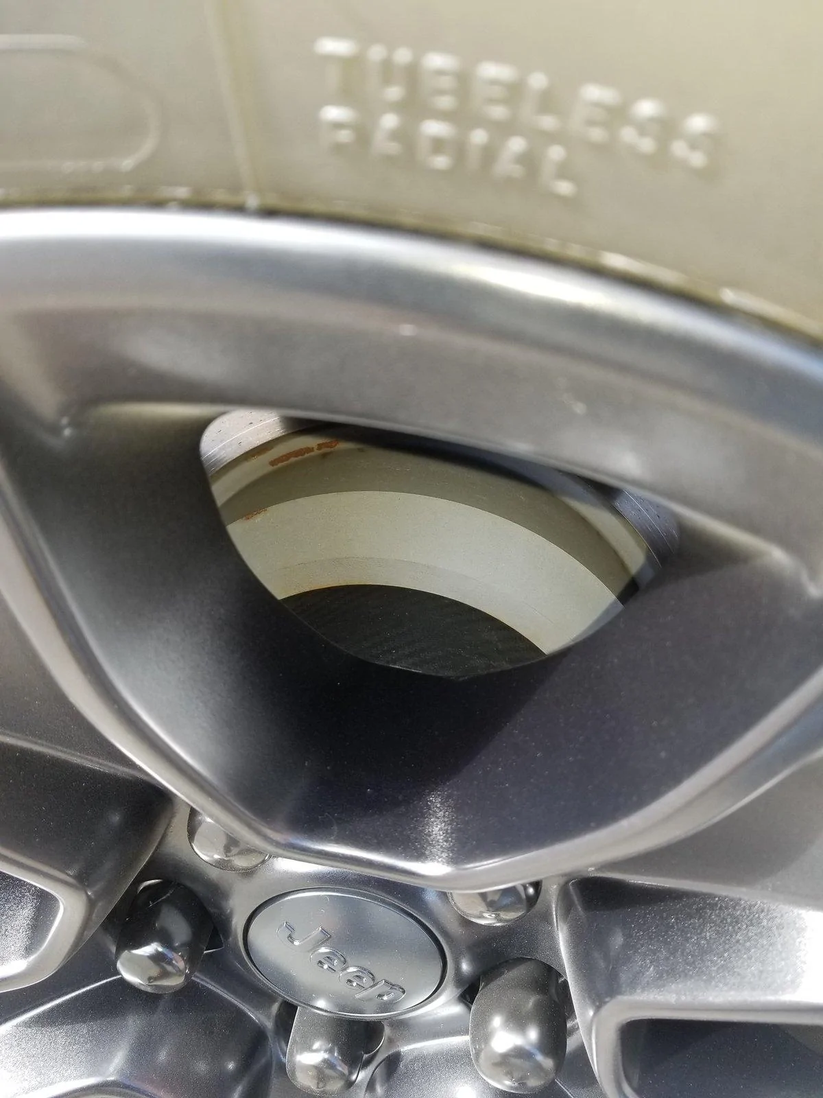

DadJokes, that looks fantastic! Any issues with the OE wheel studs being too long for the OE wheel pockets using those 1" wheel spacers from Bora?
The factory studs only protrude .410” past the 1” spacer. There’s up to .750 pocket depth on my Rubicon Upgrade wheels (not installed) and these Sahara upgrade wheels appear just as deep so there’s no interference fitment issue with a 1” spacer.
In effect, since the Rubicon axles are .750” longer per side, this sticks out only .250” further than the same tire fitted on a Rubicon. These are Rubicon fenders in the pictures.
And if you don’t like the commonly brightly colored spacers, these Bora spacers are black.:like:
