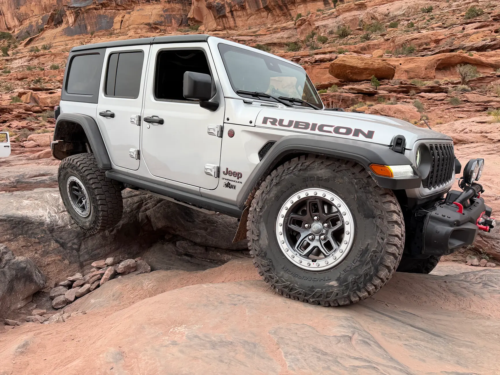

slap some 1" BORA wheel adapters on and go with 37x12.5-17....I run two sets of tires/wheels...OEM wheels with 255/85-17 (35x10) and 1" BORA adapters for just running around and 37x12.5-17 on AEV wheels for offroading.....no rubbing on either and both are about even with the fender flares....I have had both sets to Moab and both do great but the 37's are game changers.

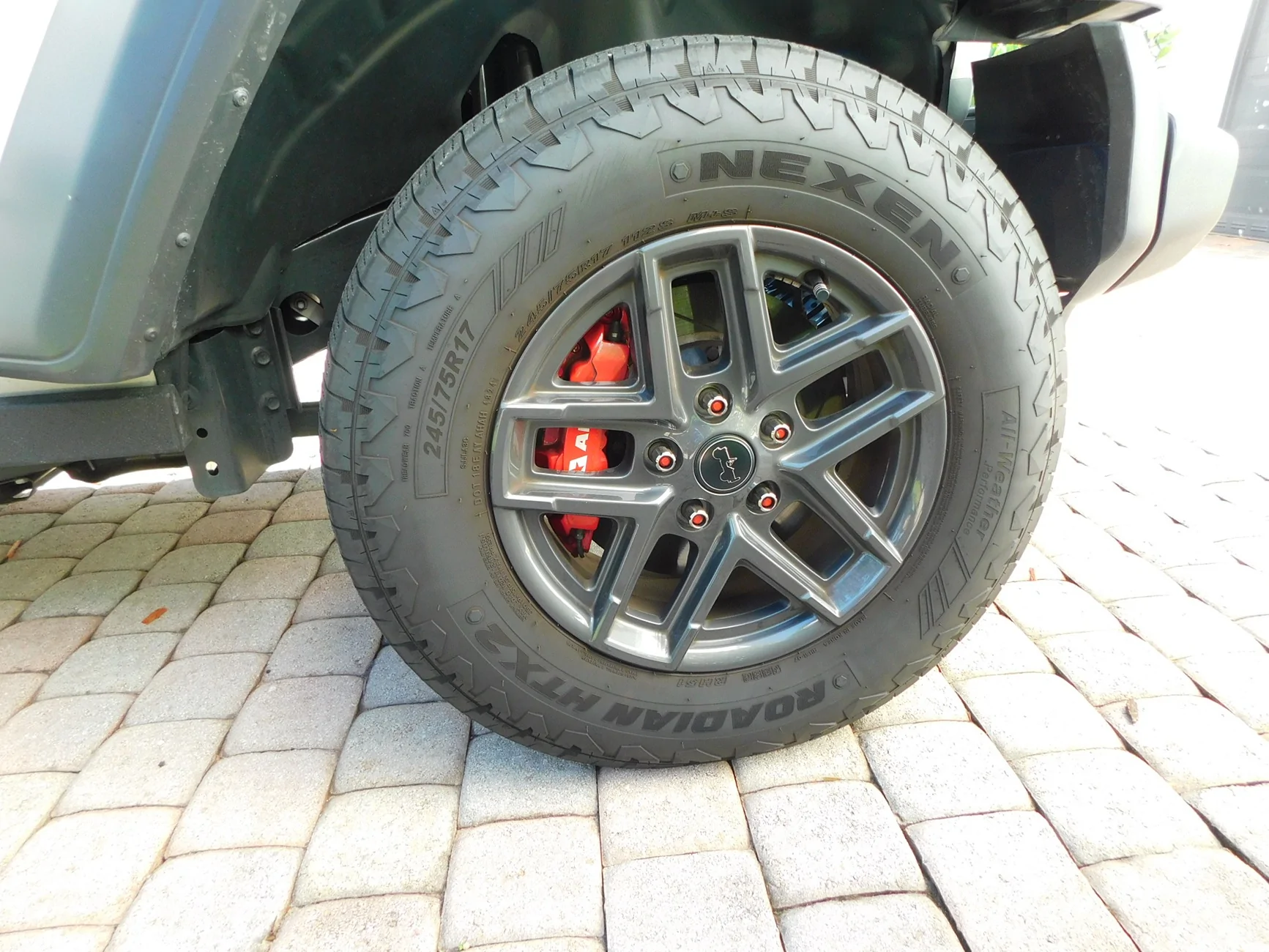

Clearing big brake calipers. Note splined, open-end, titanium lug bolts. Got these for the Corvette, but was a little nervous to try them, used steel lugs instead. Been on the Jeep for 6 months...no problems & look sharp. Trimmed the ARP wheel studs down a little, dabbed some paint to keep 'em from rusting...
