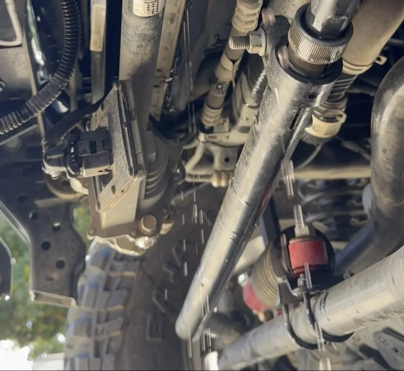

Just made it into the driveway after a long trip and wheeling and discovered this:
Jeep Wrangler JL What trail side repairs have you attempted? 1769425565335-xy
Jeep Wrangler JL What trail side repairs have you attempted? 1769425743487-i7
Fixed her right up!

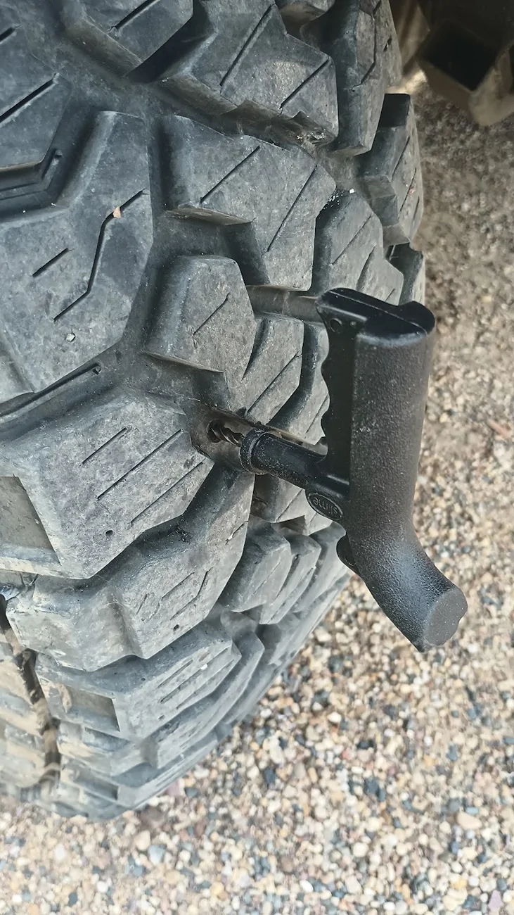

This was on the trail just after the WALL on Poughkeepsie Gulch. A mate's tire - sidewall. Plug(s) got us off the trail and to a safe area.
