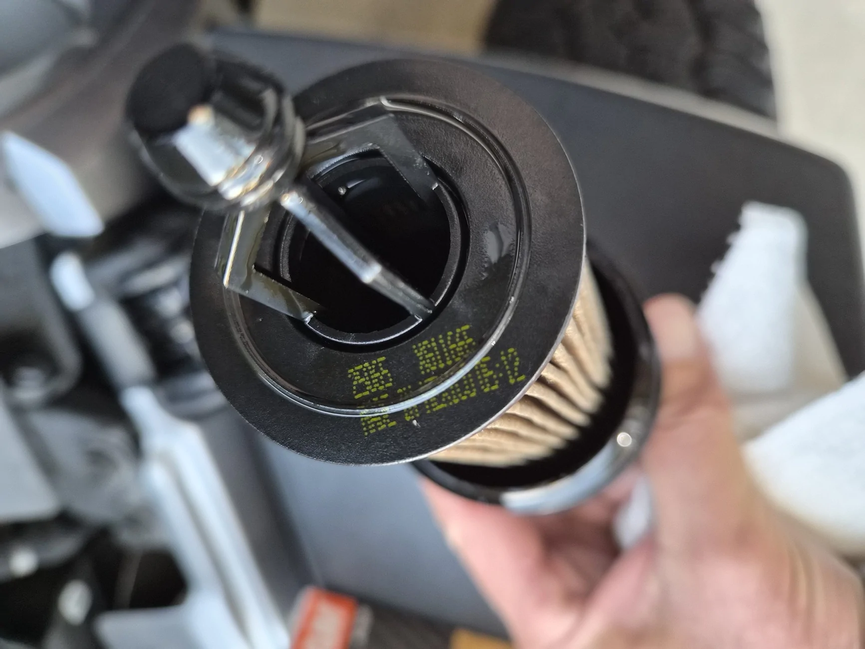

So, this discussion prompted me to go out and pull the filter I have in my jeep right now. It's a Fram Ultra XG11665 as you can see in the laser marking on the end. There is no twist. In fact, of all the brands (3 or 4) I've used in 2 engines and 3 oil filter housings, and at least 4 filter caps, I've never had a filter twist to any notable degree.
If you have the filter cap with the filter installed over the spring guide in the cap, and push on the filter, you can get about 1/8" of spring travel. This can easily accommodate small variations in filter length.
When I install the filter, I push it on the spud at the back of the cap until it clicks and sets straight in the cap. Then I lube the Oring at the tip and the cap Oring, then turn it by hand as far as I can, with the last thread or two needing a wrench to overcome the big Oring on the cap. I just tighten until the cap flange meets the face of the housing, with maybe 5 lbs/ft of torque. I don't use a torque wrench for this, nor tighten to the 18 lbs/ft spec.

Now I must say... there are two differing OEM oil filter caps released between 2015 and 2022. My original 2019 cap was used until my 5th oil change with OEM filter. No issues with twist on either cap. Though I did post noticeable difference with tension on the oil pressure bypass. When installing the new cap it was firmer and seemed to lock into fit. Meaning easy to spin on more difficult to spin off. As if the spring tension acted like a lock washer. Perhaps 2022 on up oil filter caps are more prone to twist certain oil filters?

The cap shown is off of my 2024 engine with a new 68596318AB oil filter housing/cap. When I bought the 2024 engine from AMW 4x4, it came with a filter housing that had the updated seals between the cooler and housing body, which eliminated the "figure 8" seals, but the p/n was not what one I could discern if it had the updated seals. So, I replaced it with a new, from a local dealership, oil filter housing 68596318AB .
On the previous (2018) engine, I replaced the cap once, for some reason. Maybe I dropped it.
On this new engine, I have used a Mopar cap made as a "tool" for dealership mechanics, so they can install a mechanical pressure gauge. It has the usual bypass system, but also has a hole with a 1/4" NPT thread for the gauge. I left that gauge on there up until I wanted to use it for the start up of SadRobot's replacement engine .

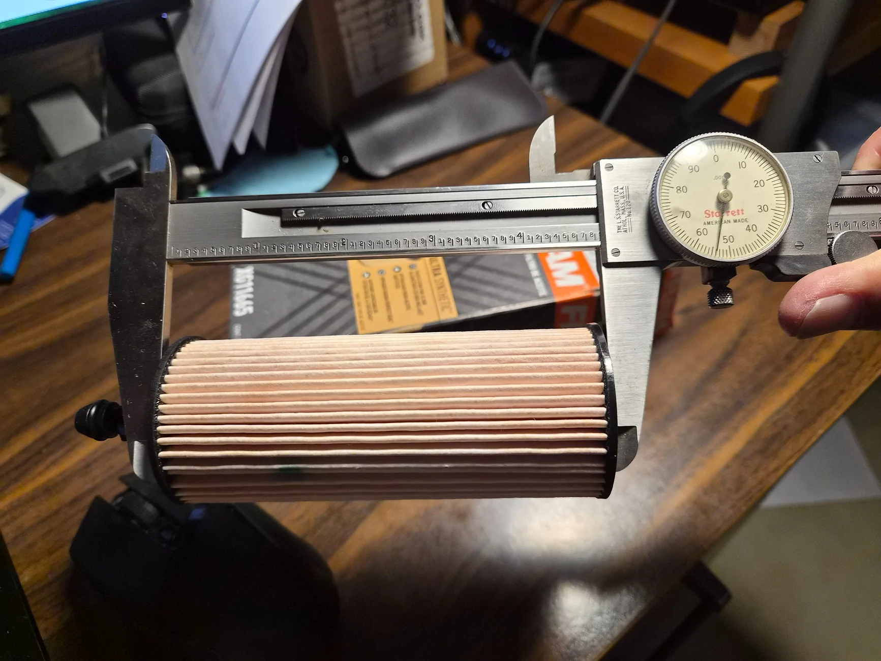

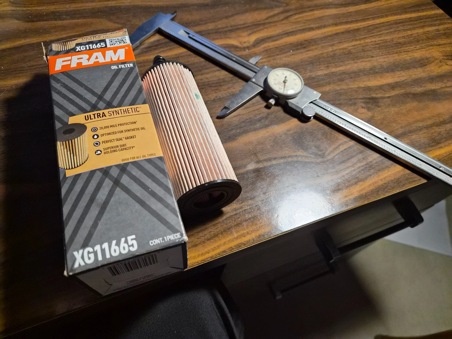

Those measurements are interesting. As you can see in the picture below, the Fram XG11665 (Ultra) measures 4.853, which is over 1/8" shorter than measured 5 1/2 years ago by @CarbonSteel . I know CarbonSteel well enough that I believe he took care to get his measurements right. They must have had a change of the length since then. Possibly, Fram ( or some of these companies) have been getting feedback from the OEM or have been doing their own testing. I know Fram jumped in on BITOG about their filters being poorly constructed, and they took that information and created their higher quality lines and stated that they made corrections to their bottom line filters as well. They seemed to be more open to feedback than most large companies.

It intrigues me that there are ao many variances with filter lengths with most brands. In my area of few Pentastars compared to the college town I work in, has a stock of various brand oil filters but where there is an abundance of pentastars, few top tier options. Go figure? Dunno if the FRAM was old stock here in my town or what. I guess I can go through various oil filters with my micrometer and measure them. Not sure if sales people and managers will be happy about it. Sort of like opening a packages of briefs and measuring each waist band to verify size is correct HA!

I couldn't stand it. I pulled my jeep's filter again and measured it. 4.815" That's shorter yet, than the one I had in the box and about 3/16" shorter than CarbonSteel measured 5 years ago.
Looks like I'm headed to the men's underwear department with my calipers.

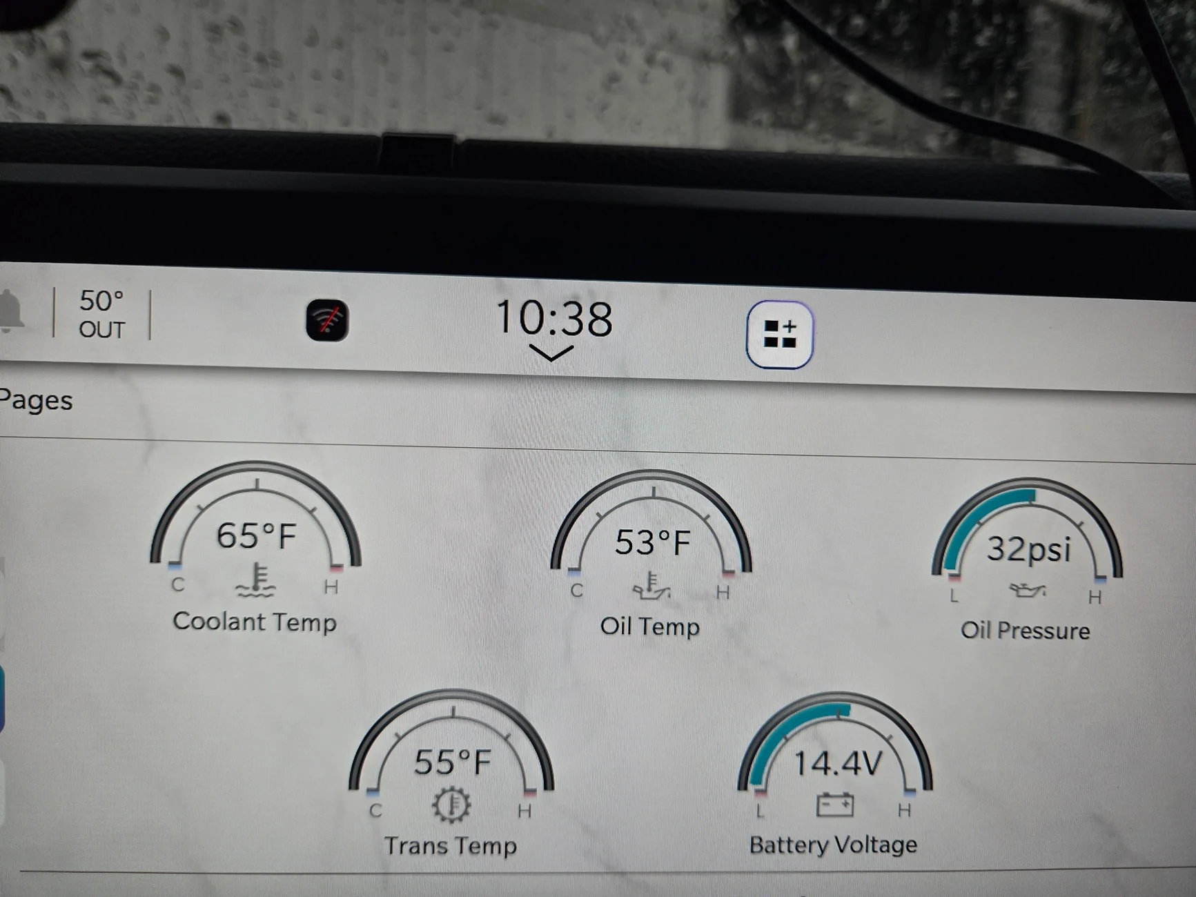

Guys, it is 51 in Seattle right now. Jeep has been off for the last 15 hours. So I am about to go and drive and see if I get to 200 degrees

Wish me luck guys
You live in Seattle? Drive at least 20 miles. My jeep will be in the 195°F ranges on gauges between 25°F and 45°F If in 55°F and above 215°F on up to 245°F driving 70MPH in mountains.
