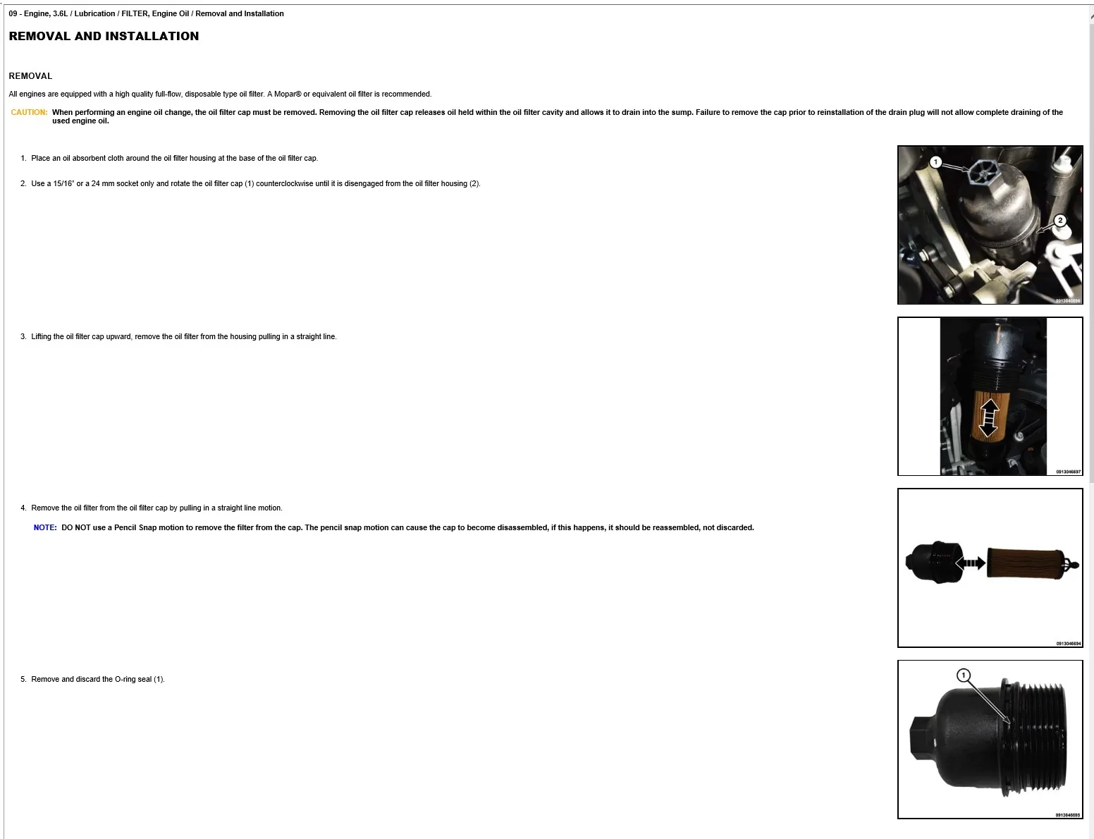

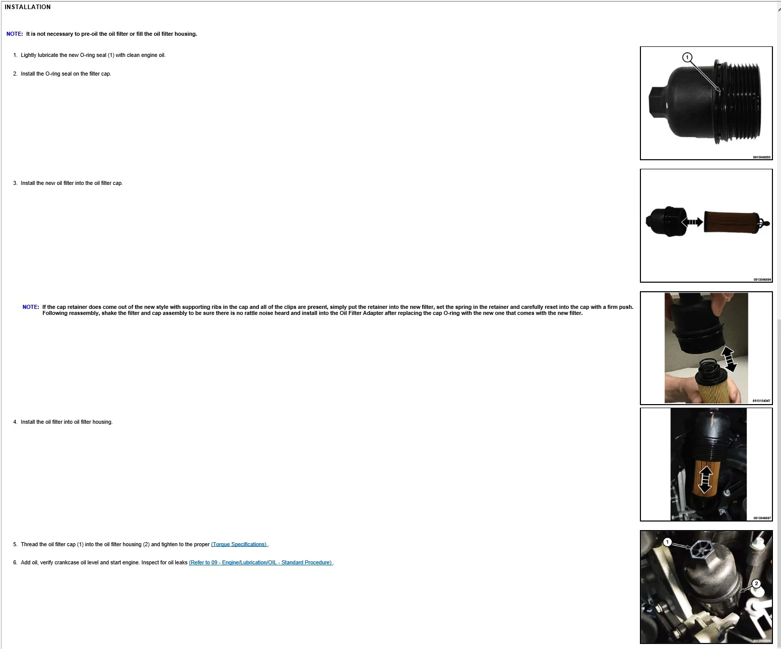

117k on odo and nearing my 8th oil change in 1-1/2 years since getting it used with 83k... cracks are a myth when installing a cap right IMO. What will crack your cap is simple 3rd party oil filters. Not all are the same size as OEM. Fram is on of the tallest and most difficult to turn your cap. Look up filter twist. It is scarry how many plug for FRAM. Mobil 1 or OEM are all I will use.
This doesn't pass the smell test. They're all "third party filters". OEM is Purolator/Wix/Mann standard grade.
I've used OEM, Wix, Purolator, Fram Ultra and I think the first filter I used was a K&N which was Champion Labs at the time. Currently, the maker of Mobil 1 filters is Mann Hummel who owns the Wix, Purolator, Filtron lines. So, it's all kind of a circle. One guy on BITOG stated that he personally saw Mopar filters being produced and boxed in the Purolator/Wix plant in the southern U.S.
I started using Fram Ultra filters recently, after having used Wix XP filters for quite a while. I'll pull it out and take a look. I think I'm on the second Fram. I didn't recall seeing the twist. But then, I've never seen it with any filters in my Jeep to the extent I've seen pictures posted of the extreme twist.
The oil cap has a spring in it to seat the filter to accommodate variations in length. So, this should keep the filter from binding.

I meant to post this from the factory service manual as well.
Jeep Wrangler JL What temperature is considered operating temperature? Oil filter chg 1
Jeep Wrangler JL What temperature is considered operating temperature? Oil filter chg 2
