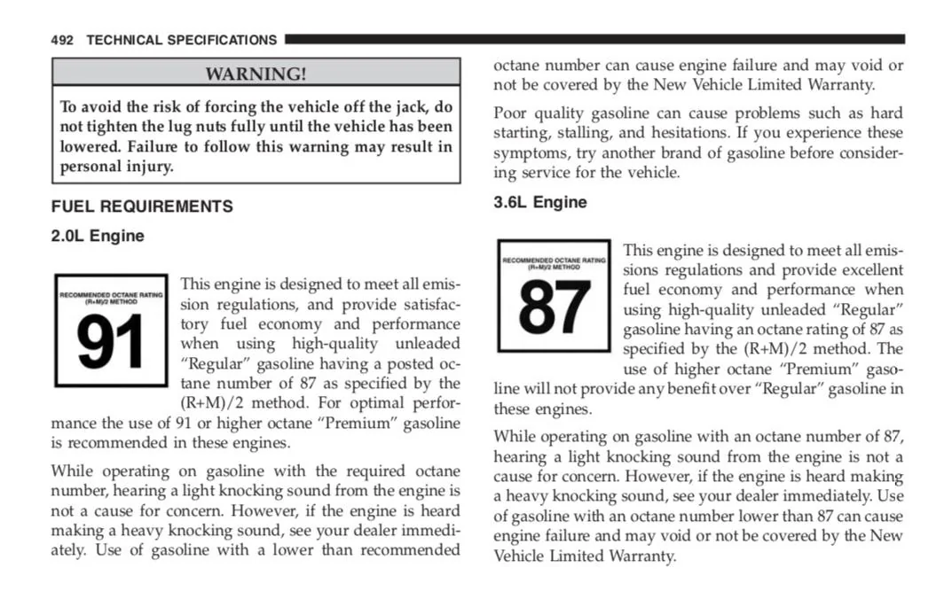

I’m going to be that nerd who quotes the user guide ;) but I’m only doing it to maybe help you save some money...
The user guide recommends 87 for the 3.6L and explicitly states: “use of higher octane “Premium” gasoline will not provide any benefit over “Regular” gasoline in these engines” (Pg. 492).
I hope this helps!
So to sum up:
- 2.0L owners could run 87 without damaging anything, but 91 or higher is strongly recommended for the engine to run optimally;
- 3.6L owners can/should run 87, and won’t see any improvement by using premium instead of regular.
Jeep Wrangler JL What octane is everyone running? upload_2018-9-23_10-42-30
I knew what I was getting into when purchasing a Turbo, and while I did get sticker shock the first time I paid for a full tank of premium, I still feel like I get good value if I measure in fpg (fun per gallon)...:like:
