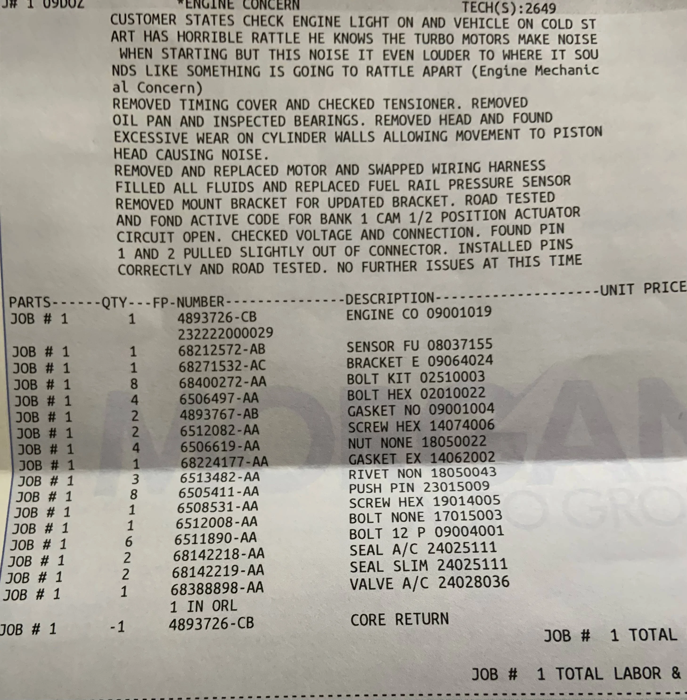

Jeepaddict76
Brandon
Sep 10, 2018
70
95
2021 JLUR
The 2.0 is a loud engine, especially on cold start but if you notice it getting louder please take it in because it’s not always normal. My 21 JLUR 2.0 has just under 30k miles and recently it’s been getting significantly louder for the first 5 minutes after cold start. I took it into the dealer this week and just found out they’re replacing the engine. Sort of bummed but at least they’re replacing it so I get to reset the clock for engine warranty. This Jeep has been perfectly maintained, oil changes every 5k miles, because I plan on keeping this one for a long time. Guessing I just got a bad one.

Heimkehr
James
Sep 3, 2020
11,097
22,481
Pennsylvania
2021 JLU 2.0T
What was the source of the increased sound that compelled warranty replacement of the engine?
Genuinely curious. I had the short block replaced in my YJ, which I purchased new, due to cylinder bores that were out of spec.
I’ll be sure to update thread when I have the specifics. Have a nice weekend.

Jeepaddict76
Brandon
Sep 10, 2018
70
95
2021 JLUR
Picked up my Jeep today. They found excessive wear on cylinder walls. 1 new engine later and she’s good as new. Hopefully it was just bad luck and this new power plant has a long and happy life.
