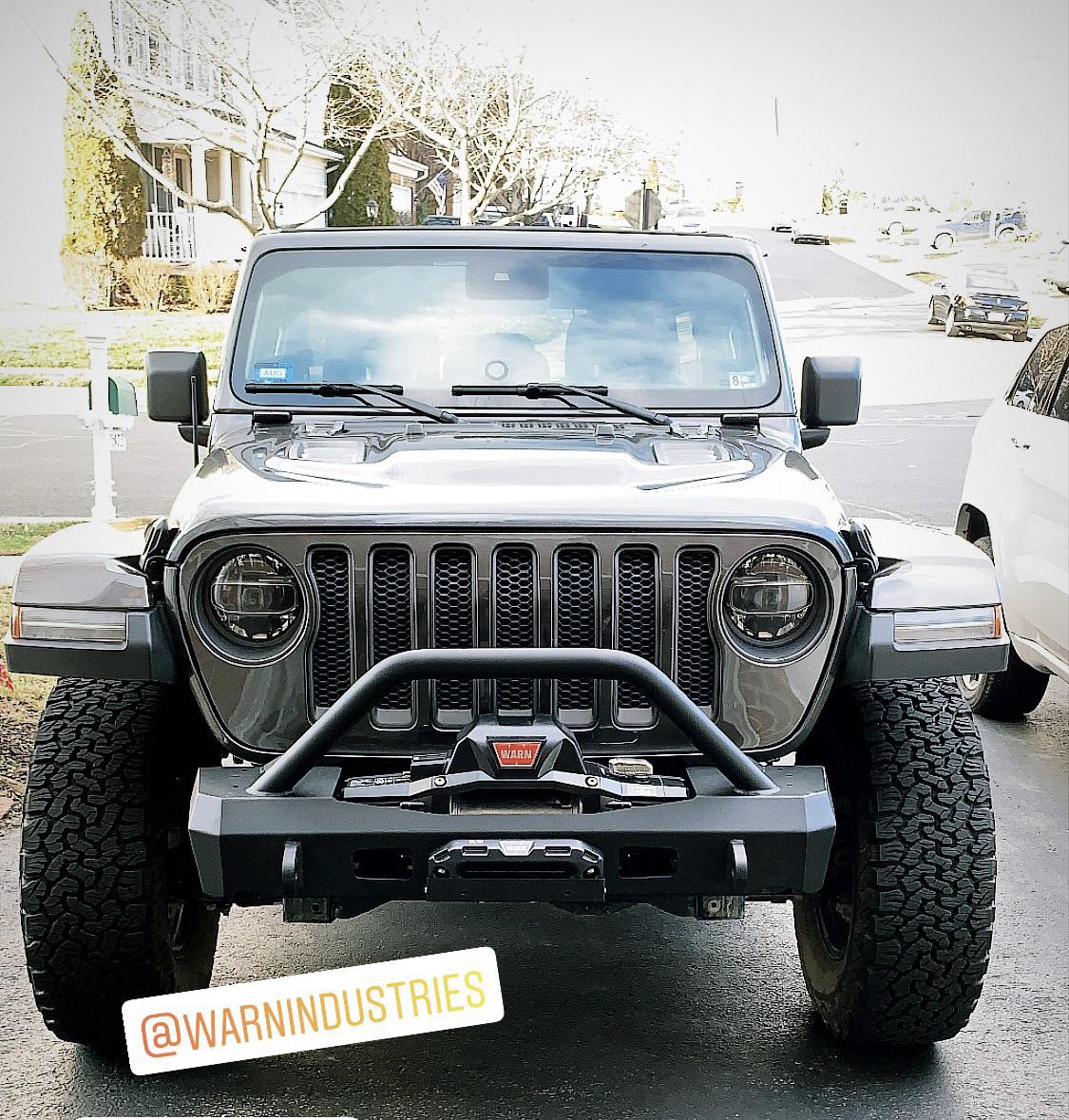

Kikaluka
Mar 16, 2019
Charlottesville VA
2019 JLUR
I found the skid plate can only be mounted once the winch is in place. The plate makes it impossible to reach the two rear bolts that secure the winch. The other tips were very helpful, thanks.

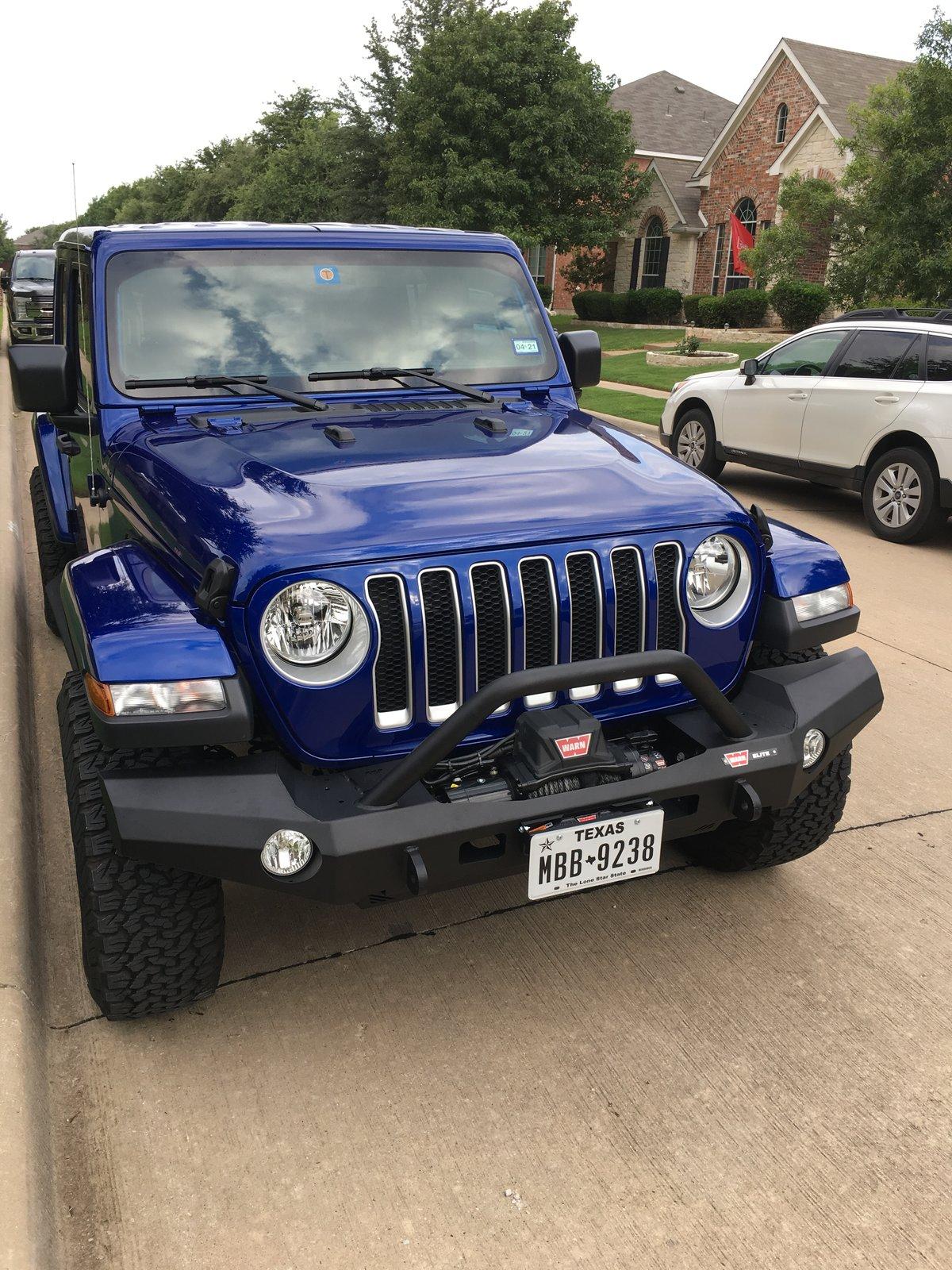

Mine was a bear to install. Directions were not very clear and had me installing parts only to have to take them back off to allow continuation of the install. I am very pleased with the quality of this bumper and winch. Took me and my son about six hours to install everything.
how are you mounting the license plate?

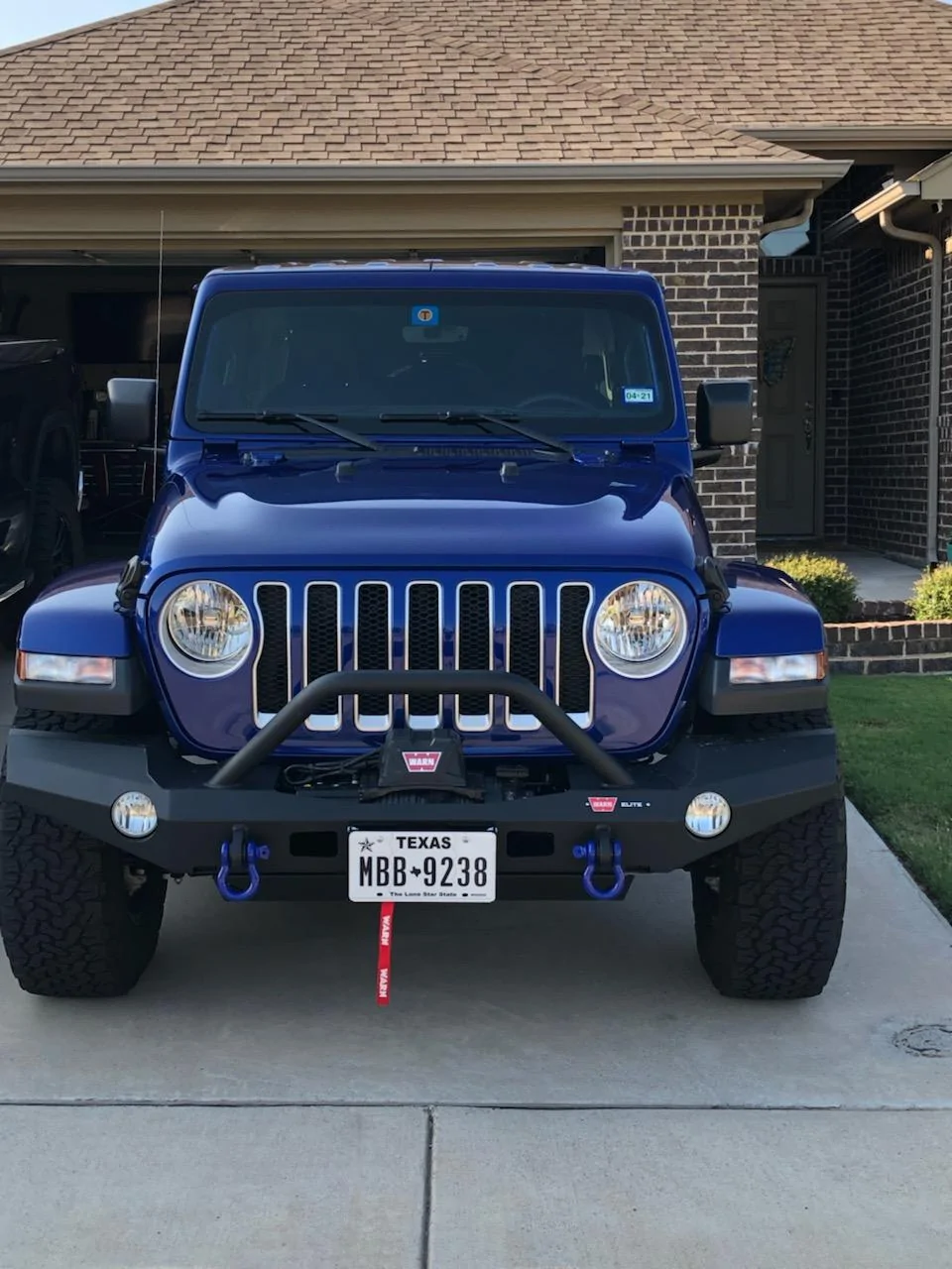

Here is the second one I have installed on my daughters Sahara. We used a flip license plate bracket over the fairline. I have installed two fronts on JLU’s, on rear on my JLUR and full set on a JK I had. The rear JL is the worst of all of them. The backup camera setup is bad. The front fog light bracket is “cheesy”. The new elite powder coating is not up to par. The are rust spots at the weld joints starting to appear. I was missing and got the wrong hardware from Warn. Their quality control sucks! But, there bumpers look awesome. I wanted a the tire carrier to swing with the tailgate instead of separate.
The new ones have a little silver badge with Elite and Warn. They could loose that. The old ones did not have it. Would I buy again, yes but check hardware package before accepting

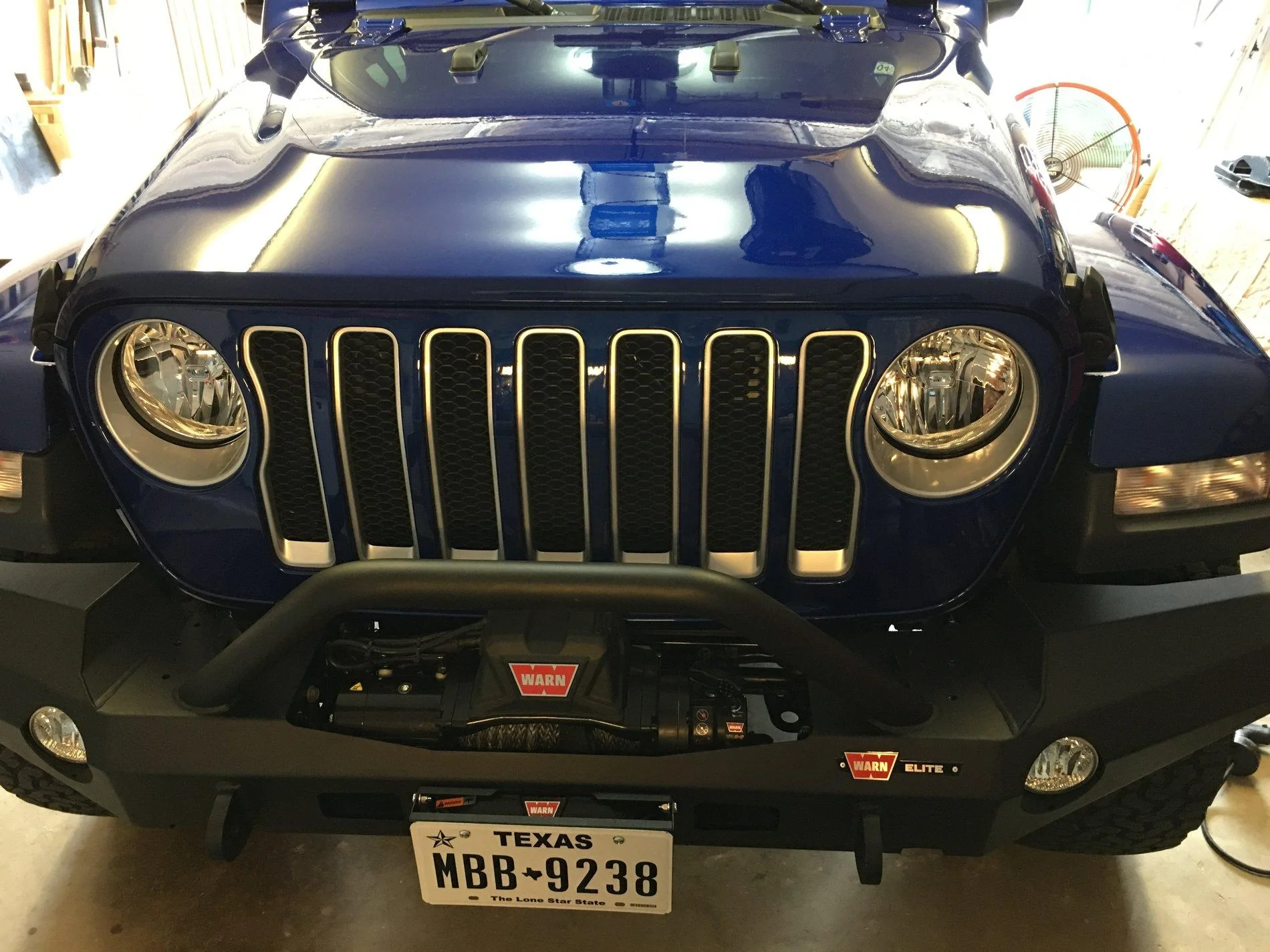

Finished my install, about to wire to the battery and install the rope....my was ordered from Amazon but didn’t come with the logo....hopefully when I order a rear one I get no logo so they match
