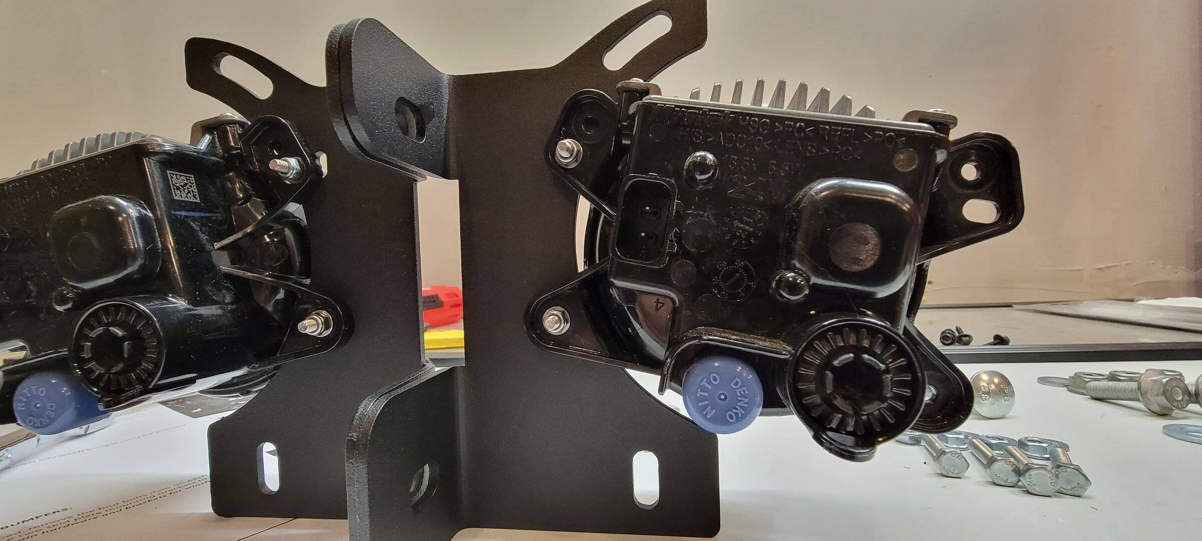

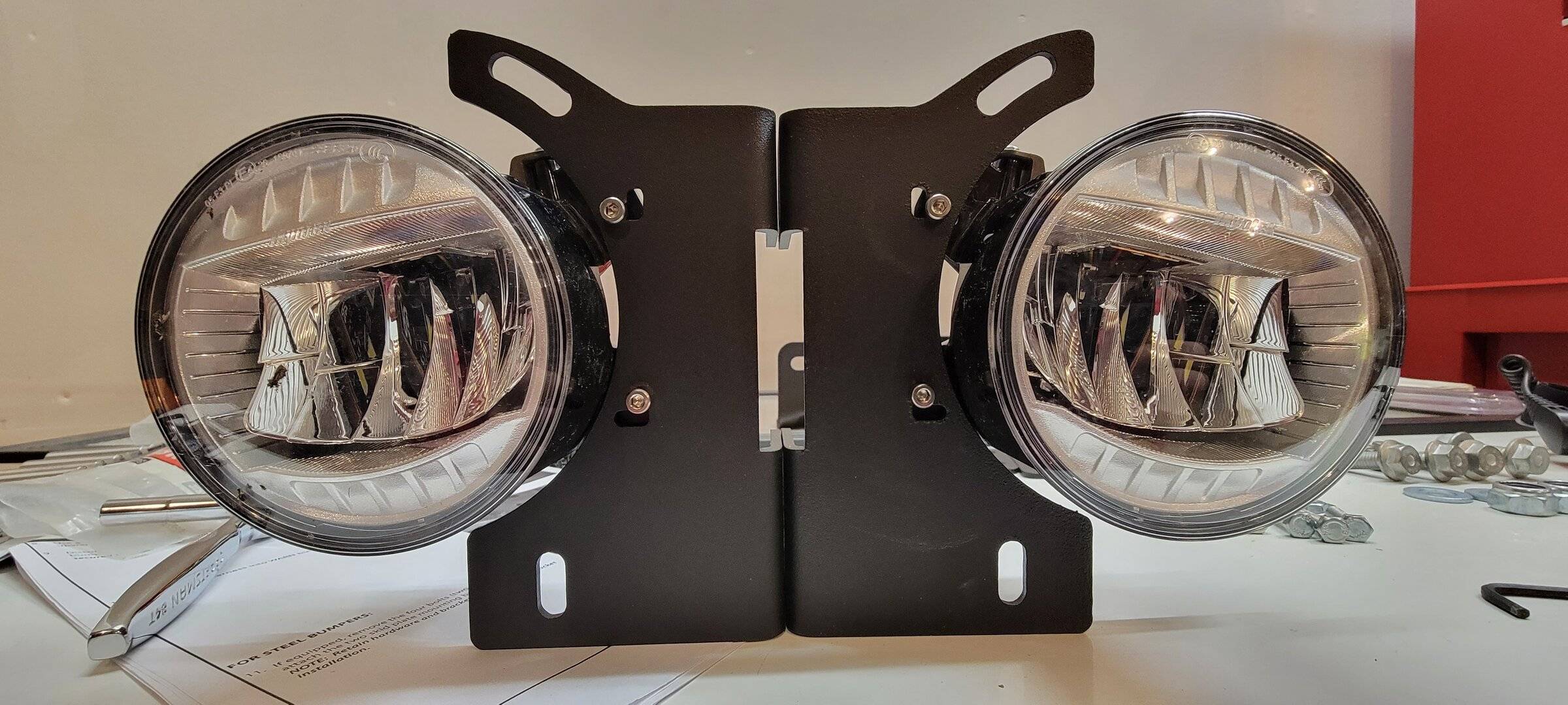

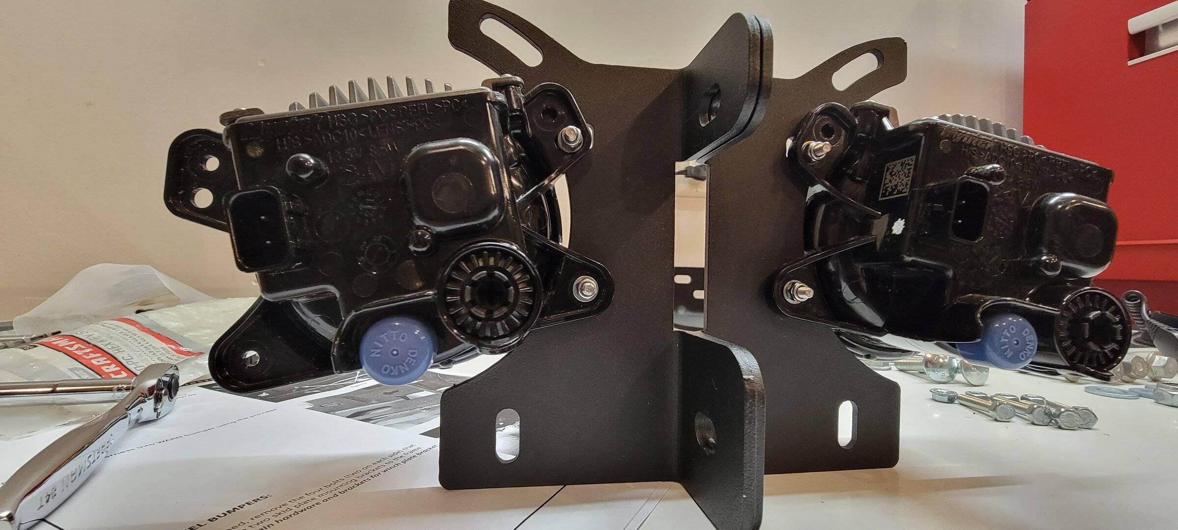

Any able to chime in on what I might be doing wrong with these brackets for my 2022 JLURD w/ factory plastic bumper. The LED fogs are going into the full width elite warn and I can't get the lights to be level with the provided holes. Am I missing something, or are the brackets wrong?
Jeep Wrangler JL Install Warn Elite front bumper 20220513_213514
Jeep Wrangler JL Install Warn Elite front bumper 20220513_213549
Jeep Wrangler JL Install Warn Elite front bumper 20220513_213612
