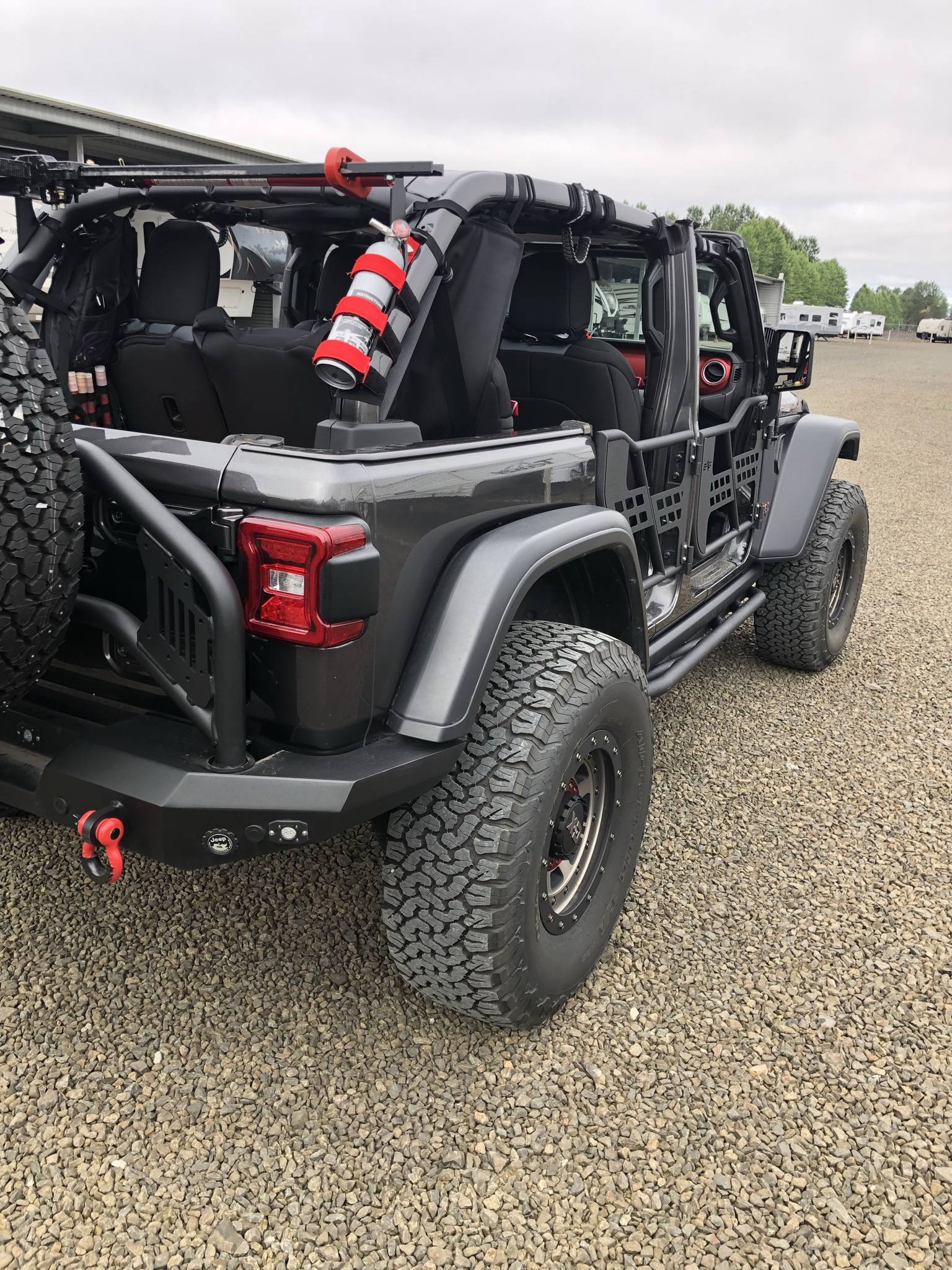

Mine are the Rigid "Ignite" series.
Rigid backup lights
There isn't much room inside the bumper, particularly when you are competing for space with the backup sensors. (The sensors aren't mounted in perfectly symmetrical disks; the disks are like little wedges with a particular orientation. Before removing the factory bumper, I recommend you note their orientation on a simple diagram, with an arrow showing where the sensors are pointed relative to the back of the jeep. When you move the sensors into the new bumper you can duplicate that orientation, so they'll work properly.)
Some guys will wire the backup lights into the reverse light wire. Others will buy or build a plug-n-play harness that allows the lights to activate automatically when in reverse, OR turn on when switched. (That's what I did on my Raptor, and I think it's the best solution. I got a plug-n-play harness from Offroad Alliance, as it was idiot-proof and clean.) When I wired the lights up on the Jeep I just grounded them and used one of the existing switches. (When I run out of other things to do I'll probably rewire them the way the Raptor is wired.)
I taped the bumper before drilling and made sure it was secure on saw horses and center-punched to avoid any wander or wobble. Remember to allow for wiring and sensor space in your light placement and, because the tire carrier post mounts on the passenger side, there's more room on the driver's side. In fact, there's room for two of these lights on the driver's side (with the second one mounted about where the Jeep emblem in the photo above), but you can't fit a second light on the passenger side. A total of two of these lights is plenty anyway, as they are very bright.

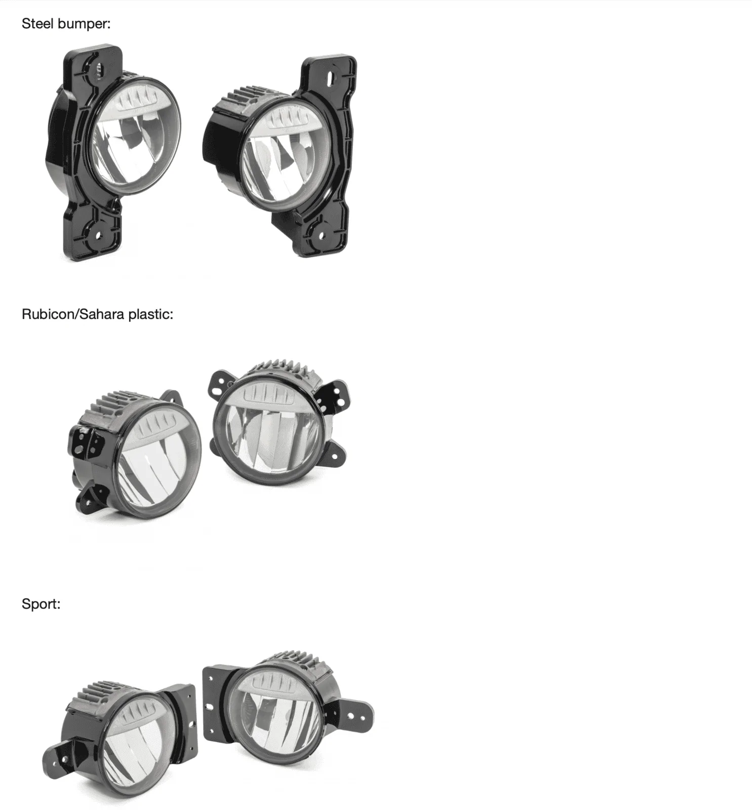

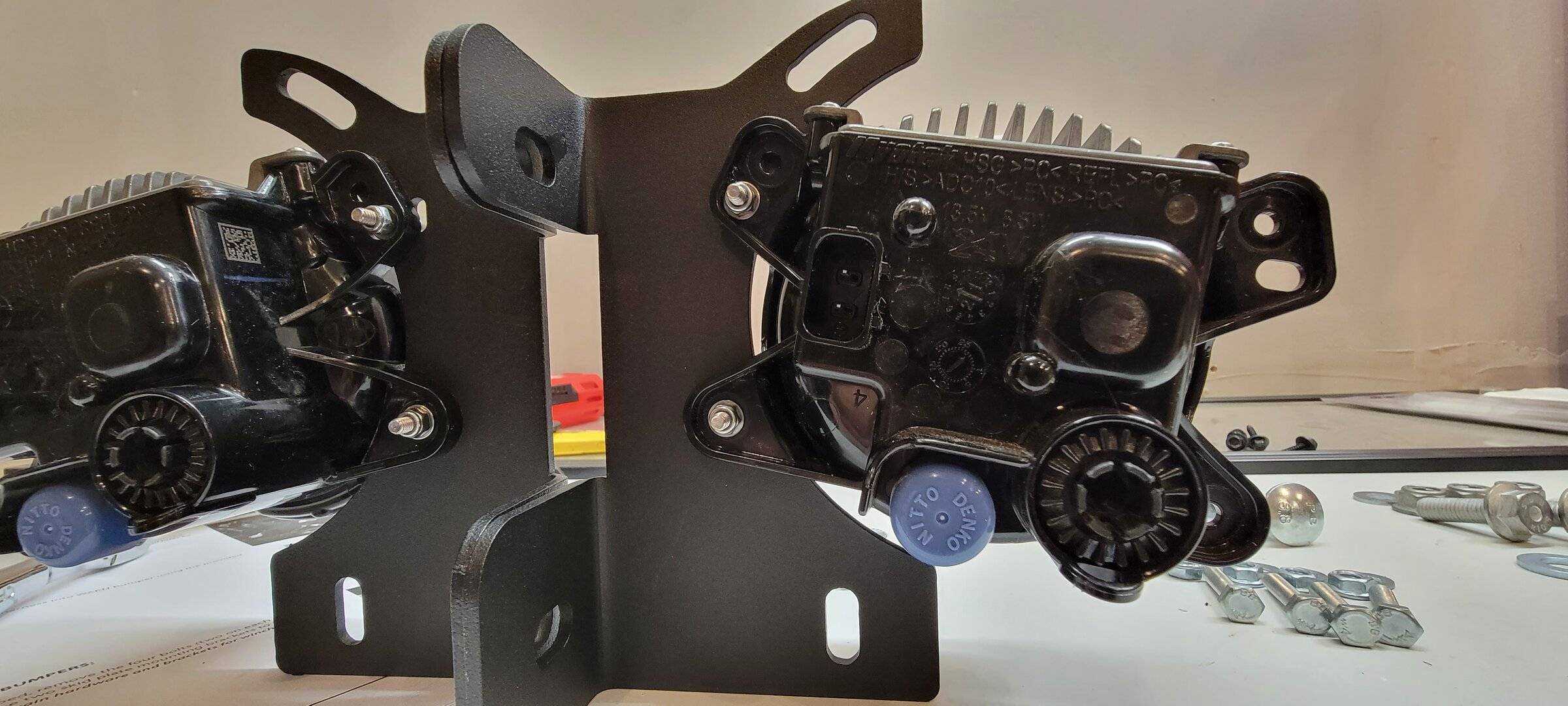

Apparently something has changed on the LED fog lights for 2022. I can't get them to sit level, unless I just need to go sit down and stop working at 10pm (which I do).
Guess I put emails into to Northridge and Warn. I'm trying to not get mad and enjoy the process. It's awesome to be able to do this to such a cool vehicle - it's a shame to make it into a chore like everything else.

you need steel bumper fog lights and a Dremel :
Jeep Wrangler JL Warn JL Elite Full Width Bumper Install Time Wrangler JL fog light types
