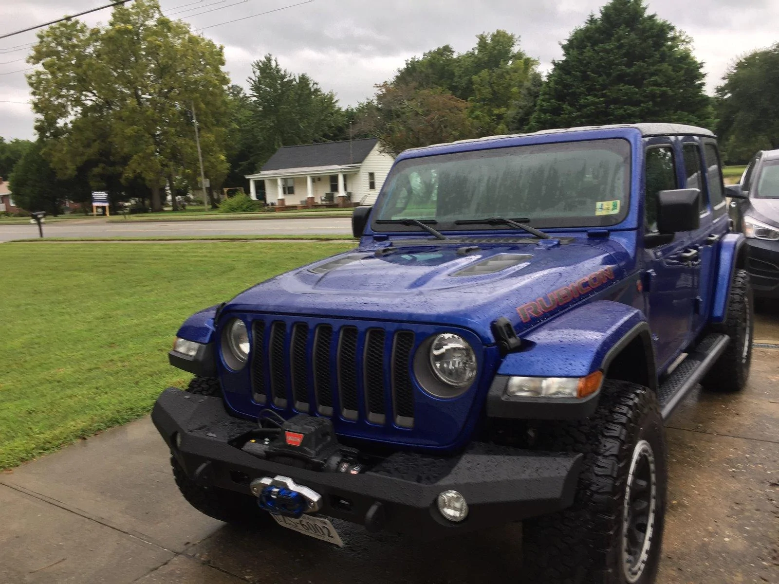

Mine was a bear to install. Directions were not very clear and had me installing parts only to have to take them back off to allow continuation of the install. I am very pleased with the quality of this bumper and winch. Took me and my son about six hours to install everything.
Was it the fog lights? They should definitely be installed after the 6 carriages bolts are installed with the the retaining clips. The directions should be revised, IMO.
Looks great by the way! My dad and I installed mine in about the same time, with several breaks for short periods of rain throughout the day.

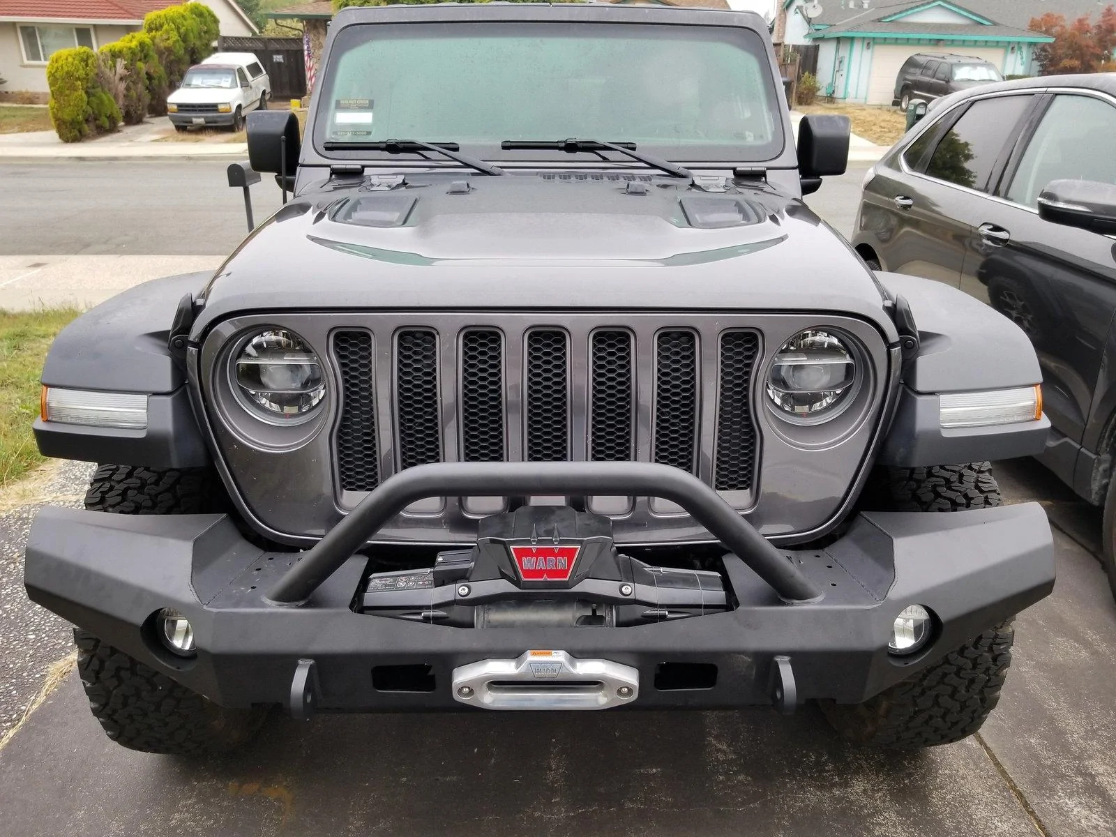

Thanks for all the help guys. Finally got mine installed but now I'm stuck trying to install my synthetic rope on the winch. The dang puck won't seat properly no matter how hard I pull on the rope. Other than that, it looks great.
Man, the ZEON series really are enormous. Any idea what those square holes in the front end of the bumper are for?
achaffee86
Adam
Jun 24, 2018
San Francisco
They are huge, but if they can't get you out of trouble, no winch can. I went out and looked at my bumper. I have no idea what those holes are for. Their isn't much space behind them so I don't think you'd fit a light in there. You could throw some mesh on it for some extra design but other than that I have no idea. There are a few holes on the top side of the bumper for mounting LEDs though.
