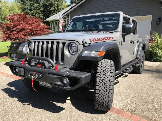

Keep in mind a full width Steel bumper and winch will drop your front end .75-1". I went to an Aluminum 3/4 bumper and winch still had some drop but not as much as full width Steel. I have the Barricade Alloy Series. Winch is 1/2 exposed but also room under the bar for a 16"LED bar as well. Only 54lbs

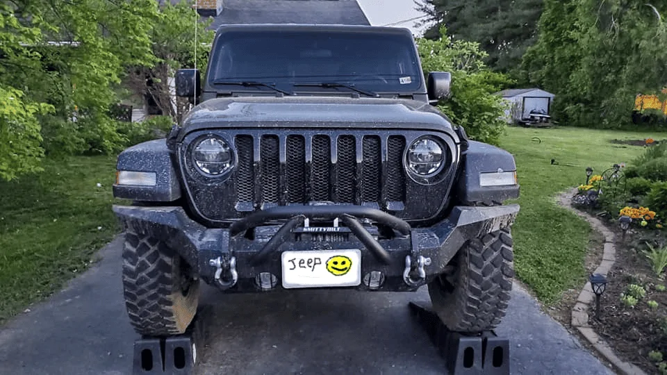

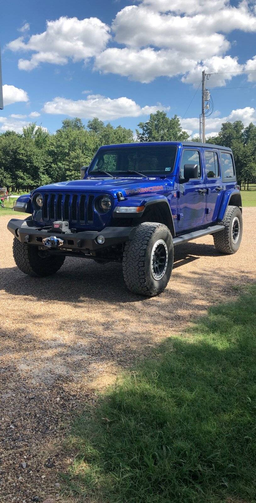

I went with the Rugged Ridge HD with the X striker bar and the skid plate. I think it looks awesome, but it does come with the caveat that it may not work with larger tires.
Adding all that extra weight and aerodynamic weirdness only dropped my average fuel economy by ~1 mpg. I was pleased. Plus I have the stupid Virginia front license plate doodad that probably makes the aerodynamics even worse.

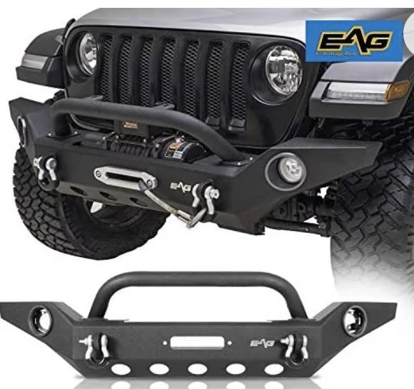

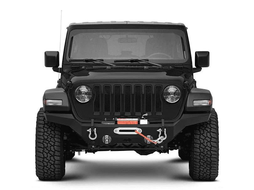

I actually made a thread listing all the full width sunken winch bumpers I could find a while back. Just updated it for you https://www.jlwranglerforums.com/forum/threads/cheapest-full-width-hidden-winch-bumpers.59256/
Requirements:
Full Width (fender to fender, and not that tube crap)
Sunken Winch mount
One Piece (not modular)
This is what I've found so far. Please let me know if you have found cheaper ones.
Paramount Automotive $417
https://amzn.to/3w8W8A4
EAG $479
https://amzn.to/3opbRsh
Rugged Ridge HD $503
https://amzn.to/2S3Wo4V
Barricade Extreme HD $600
https://amzn.to/2S3hK22
DV8 Offroad Modular $700
https://amzn.to/3eX3FfI
Westin 59-80105 $692
https://amzn.to/3v2azG8
Rusty's Offroad RJB9900 $700
https://amzn.to/3tWD0UL
There's a handful more, but the prices get pretty ridiculous. I do like the factory steel, but that's $1000 and I'm not a fan of end caps being held on by little bolts.

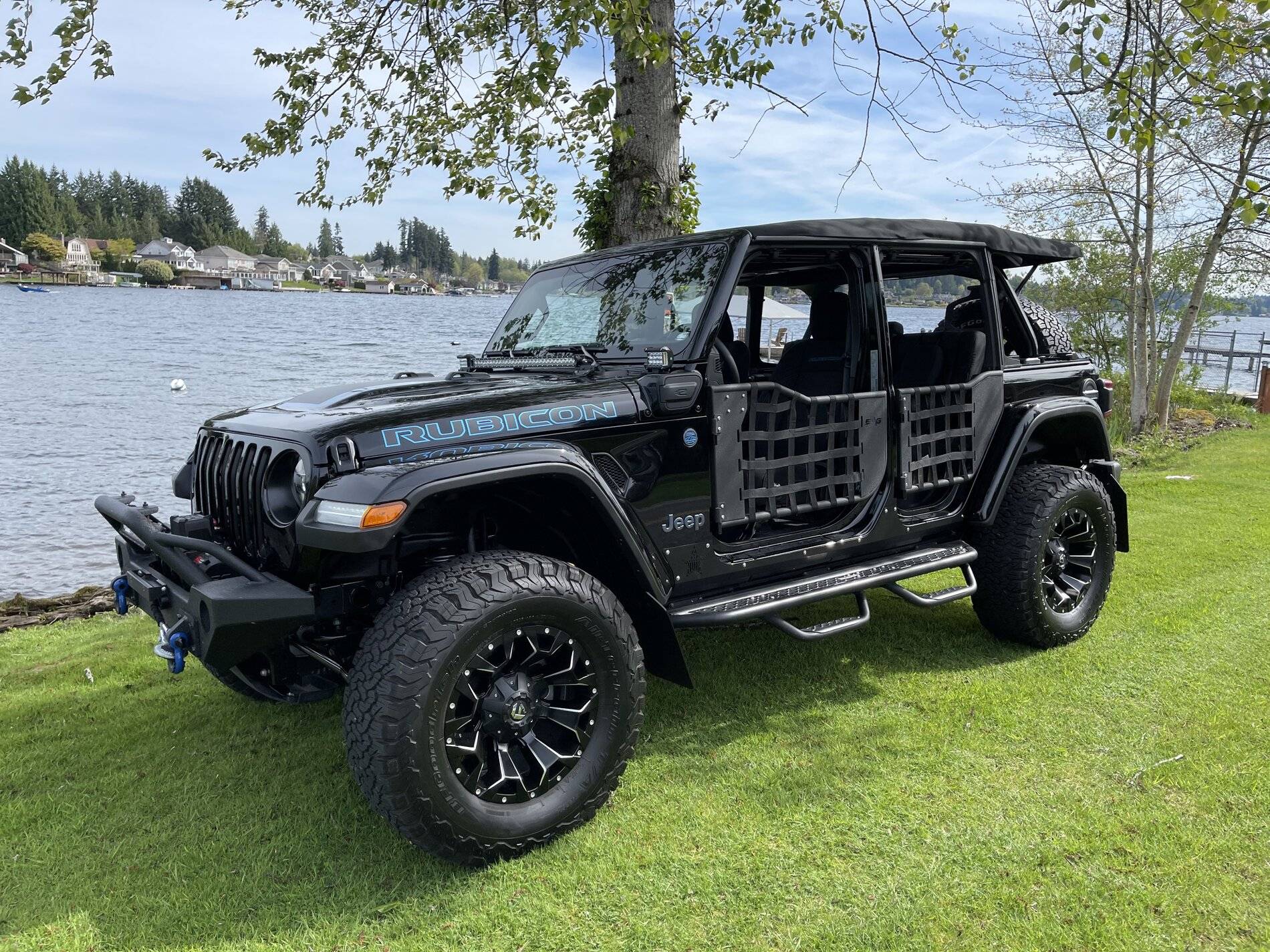

Here another picture of the Barricade Allow series, (this is a 3/4 bumper) all lit up . Lighting is easy to add. Note: avoid those bumpers with built in lighting cut outs most of those require proprietary lighting so then (not if but when) they fail you may be SOL replacing them.

This is the exact bumper I'm planning to order in April (front and rear, plus the bull bar). How has it held up for you? Any installation notes I should be aware of?
omnitonic
Michael
Apr 20, 2021
998
1,758
Southwest Virginia
2021 JLU Willys in Sarge Green
truck driver
The powder coat has flaked off in places from the constant action of the shackles rotating in their holes, and thumping into the bumper. One of these days, I'm going to have to address this with some wire brushing and a coat of paint. It should look fine. I know from the experience of installing the skid plate that Rustoleum Farm and Implement paint in in low gloss black blends in pretty well with the factory powder coat.
Which brings up the biggest installation note. If you're going to install the skid plate that mates to this bumper, install it before you install the bumper. Surely that would have to be easier. It might even be completely easy. Installing the skid plate when the bumper is already installed requires making significant clearance cuts around the fog light buckets in order to get the thing positioned so the hardware lines up for attachment. It was enough of a pain in the ass to swallow an entire weekend with grinding and test fitting and more grinding and more test fitting.
The only other thing that came up was these extra bolt-on parts that were on my frame horns, but not depicted in the instructions. Keep them or ditch them? What's up with these things? So I ended up keeping them, and I had to bend them a little to get all the holes to line up. My rationale for keeping them was that they seemed to add some extra rigidity to the overall system. Sorry, no pictures.
The bumper has held up well apart from a little flaking powder coat. I hit a recap that came off an 18-wheeler, and I hit a deer, both with no apparent damage to the bumper. I tried to use my winch to uproot a small tree that was anchored better than I thought, and I did manage to shift my winch slightly as the cable tried to compress my suspension into the ground tugging on this damn tree. Even for all the stress involved, it's not far enough off to justify the effort of loosening everything up and tweaking it straight. That was a very abusive scenario, so I'd say it has all held up really well.

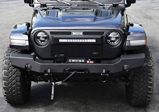

Jeep Wrangler JL Full Width Front Bumpers recommendations? 9001760A-3EC7-4CCB-B326-515D8F88AA06
Westin has held up great over 2 years
