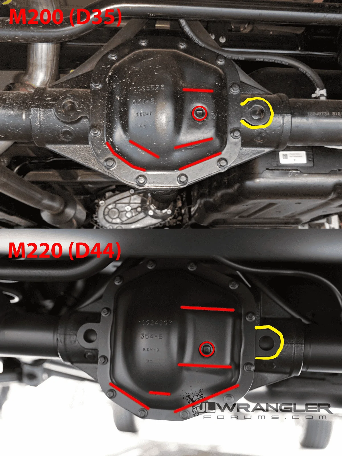

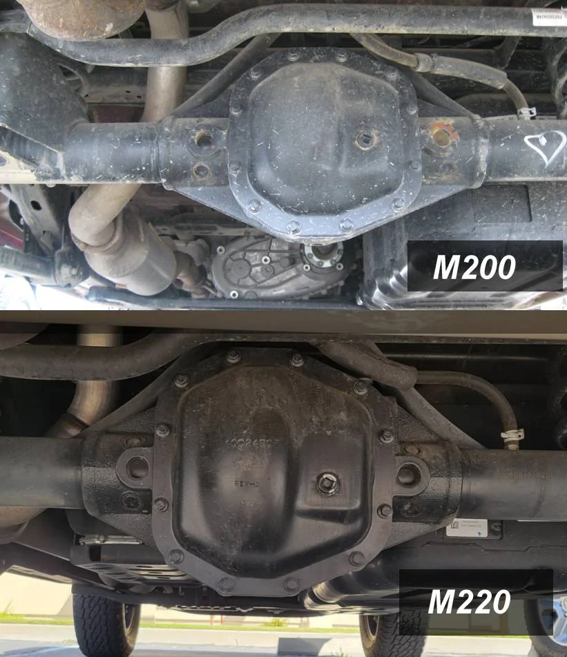

Been starting to hear more and more about Sport owners who were bait-and-switched on their rear diff, being told that they were getting the M220 (LSD), only to find out later that they have the M200. This is very troubling (but not surprising), especially when sales documents and even build sheets state that the M220 is installed. I'd prefer not to remove the rear diff cover just to confirm this, but is there a way to distinguish between the two just by looking at the exterior? Any difference in shape, alphanumeric stamps, something else? Appreciate any recommendations and happy Jeepin'!

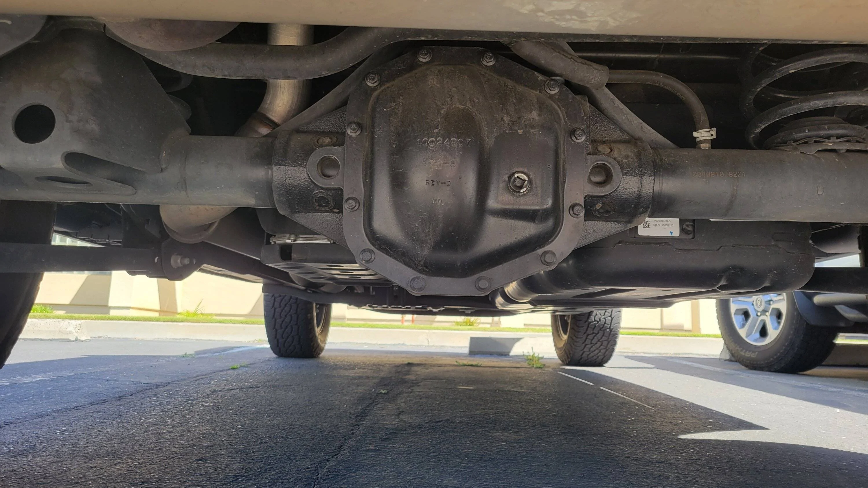

The easiest way to tell is the location of the plug. For m200 the plug is in the middle of the flat, rectangular obtrusion on the differential cover. For the m220 is slightly lower and to the left, like the picture below.

Perfect...that's pretty much all I needed. Thanks so much and appreciate your help!

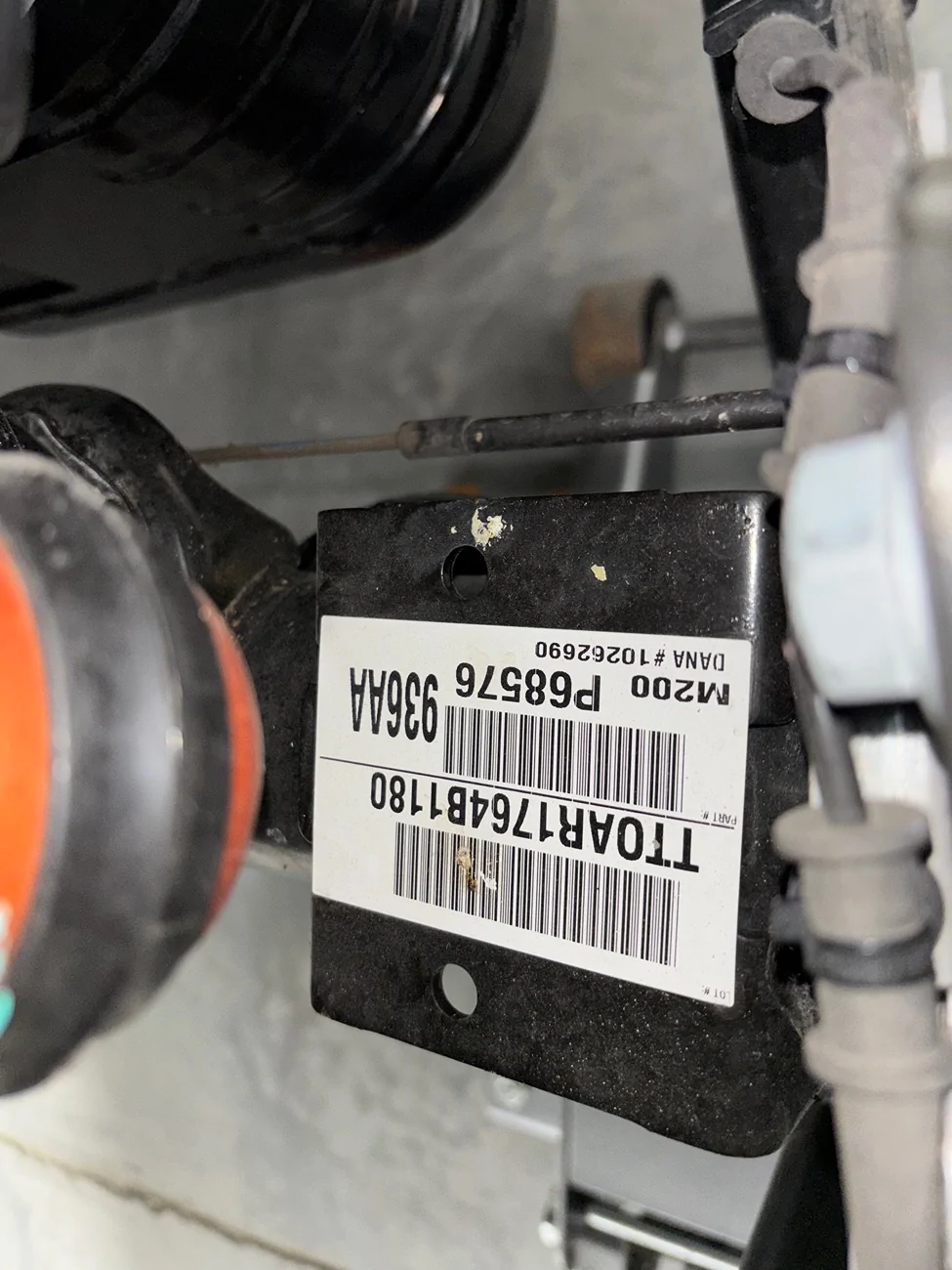

Top of rear axle directly below bump stop on passenger side. Pic is looking in passenger rear wheel well with wheel removed.
