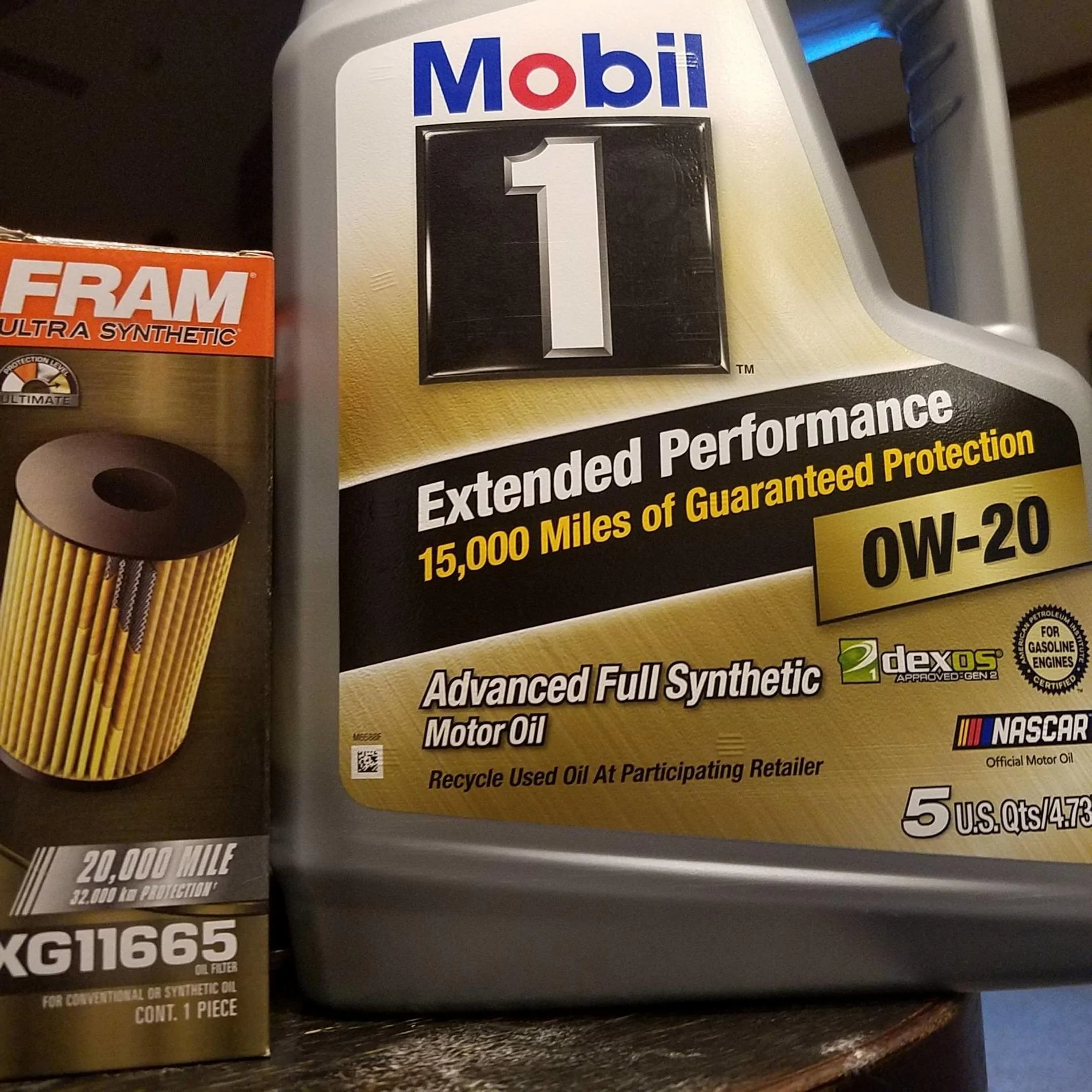

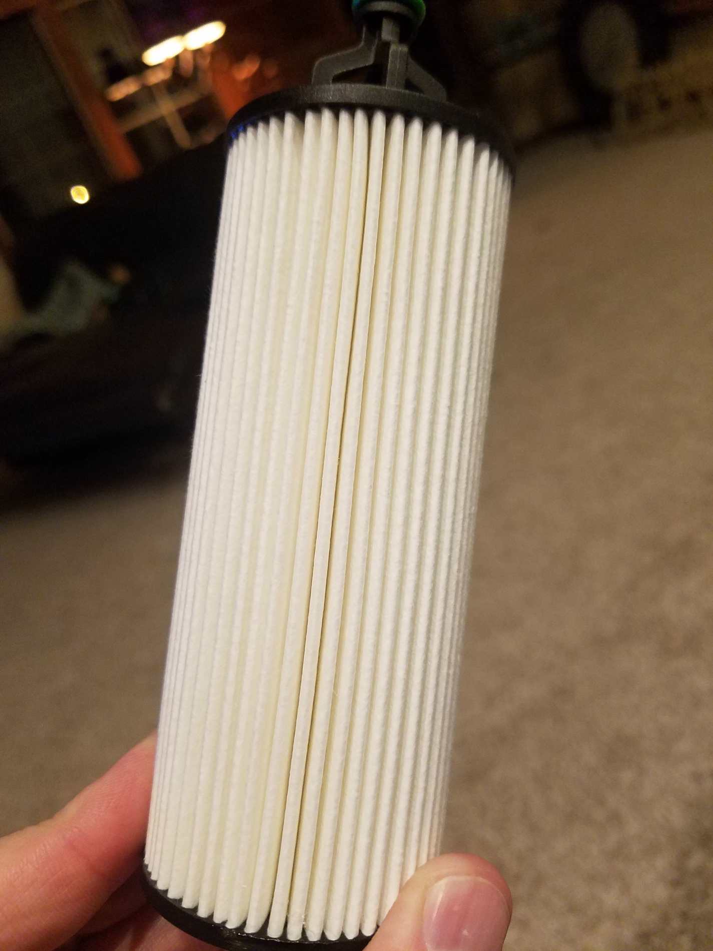

Here is what's going in on Saturday, February 24, (unless my wife drafts me for other work that day!)
Check out the filter...synthetic filter media with nice, even pleats, backed by metal mesh. Can you find the seam? It is very difficult, even on close inspection.
I'm not judging any oil or filter anybody puts in their engine. Heck, the 3.6 would probably do just fine on Dollar General's cheapest oil and the cheapest filter out there. I'm just OCD about my engines and their oil/filters. It's part of the fun.
thanks for the pics and #'s. i think i want to go this way too. others have pointed out that m1 isn't chrsler certified which is true. what are your thoughts on that? p.s. could you let us know what size metric sockets for the drain plug and filter when you change?
I'm not worried at all about that certification. I am highly confident that any Mobil 1 product will exceed the MS-6395 standard, by a healthy margin. Exxon Mobil's Mobil Super Syn 0w20 has the MS-6395 approval, and it is a lower tier product than the Mobil 1 brands. I'll run any Mobil 1 in this engine with confidence. Its performance will be major-league overkill for the needs or requirements of this engine, even in the toughest conditions. Besides, many Chrysler/Jeep dealerships will use Mobil 1 for their premium oil changes.
