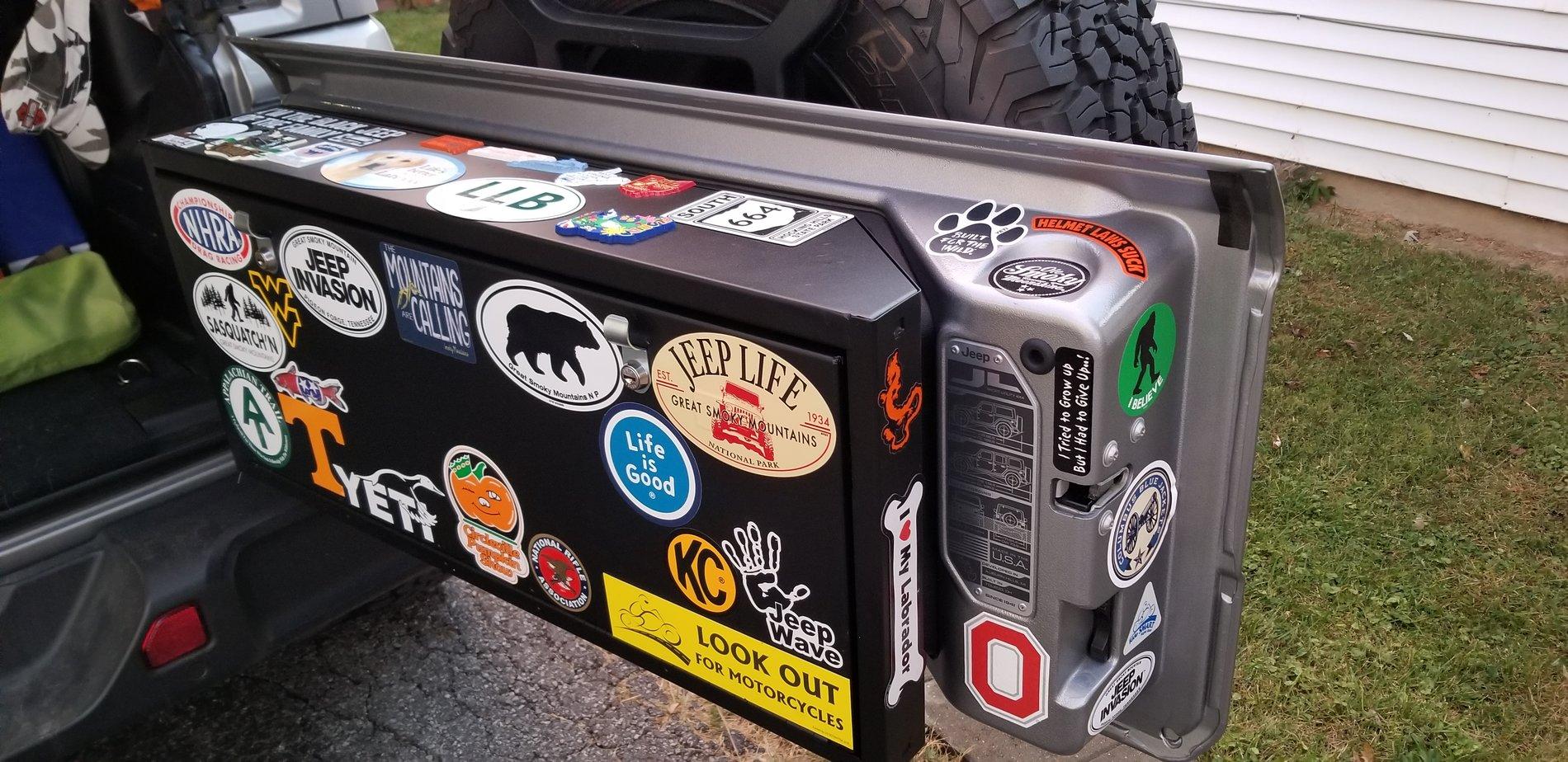

The box itself doesn't rattle or squeak. I added two long powerful strip magnets to the inside of the box from Harbor Freight. They hold metallic stuff in place. Also from Harbor Freight I wrapped the stuff that rattled in bubble wrap. I added a U clamp to the inside of the box for running my ccw lock box cable through. It can also be used as a table. Probably best unexpected use is that it's a great place to apply your stickers.

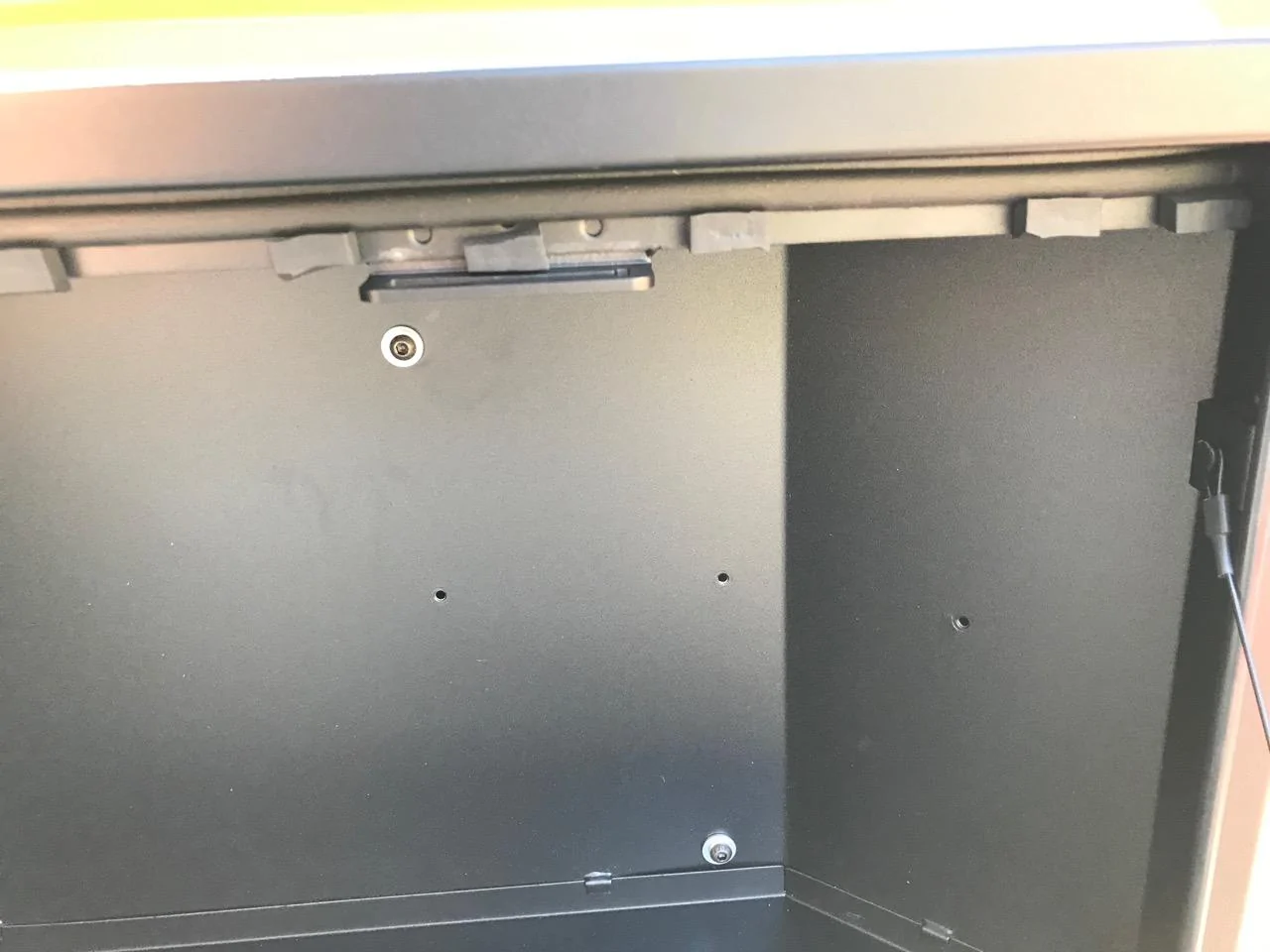

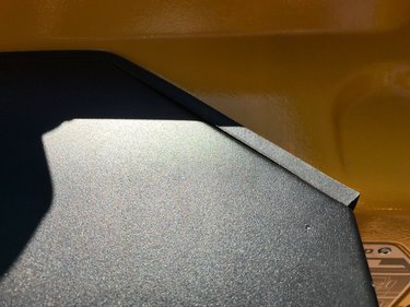

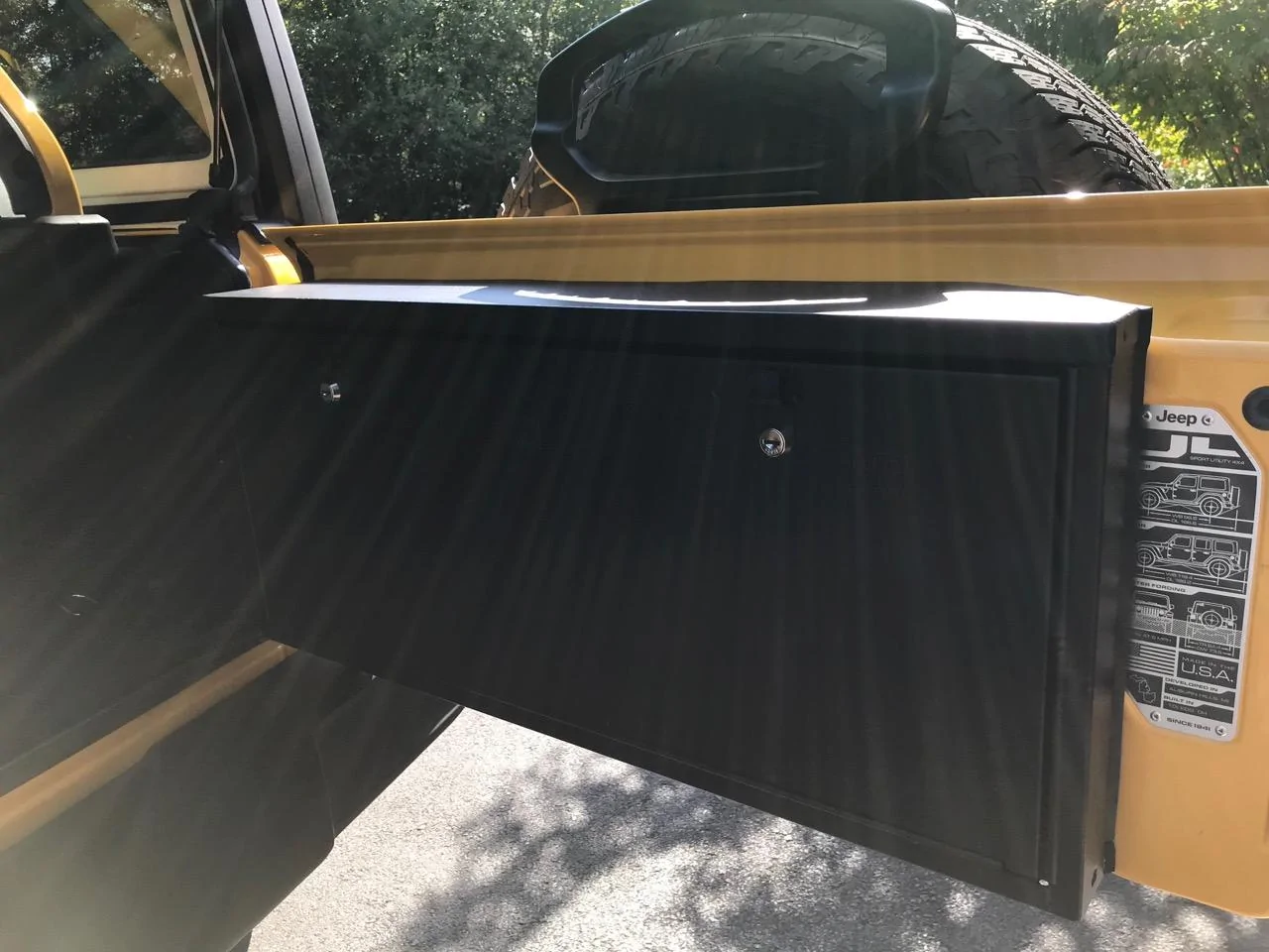

I wanted to share a few pics of my install. Following everyone's advice it was super simple.
Jeep Wrangler JL Tuffy tailgate lockbox anyone installed on yet? 235360-7edc691dad674d23d09e301e45ae6b79
The box is mounted directly to the tailgate, and I used AmeriSeal Square Multipurpose Weatherstrip from Advance Auto Parts ($14).
Jeep Wrangler JL Tuffy tailgate lockbox anyone installed on yet? 235361-05707e72a48f36b7ae85bd4410b685a0
Although Tuffy puts a small amount of weatherstrip between the door and the frame it still rattles. I just added some of the square weatherstripping to the inside channel and it eliminated the play causing the noise. You can see the blocks in the picture below. Also, I decided to not used the interior shelving.

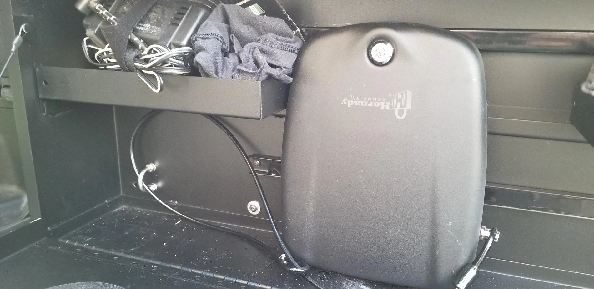

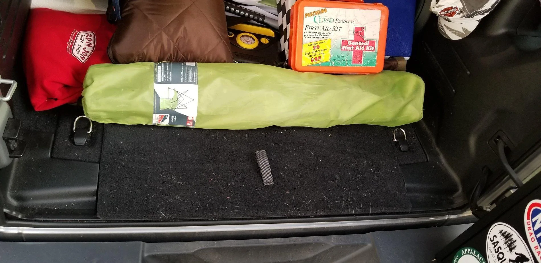

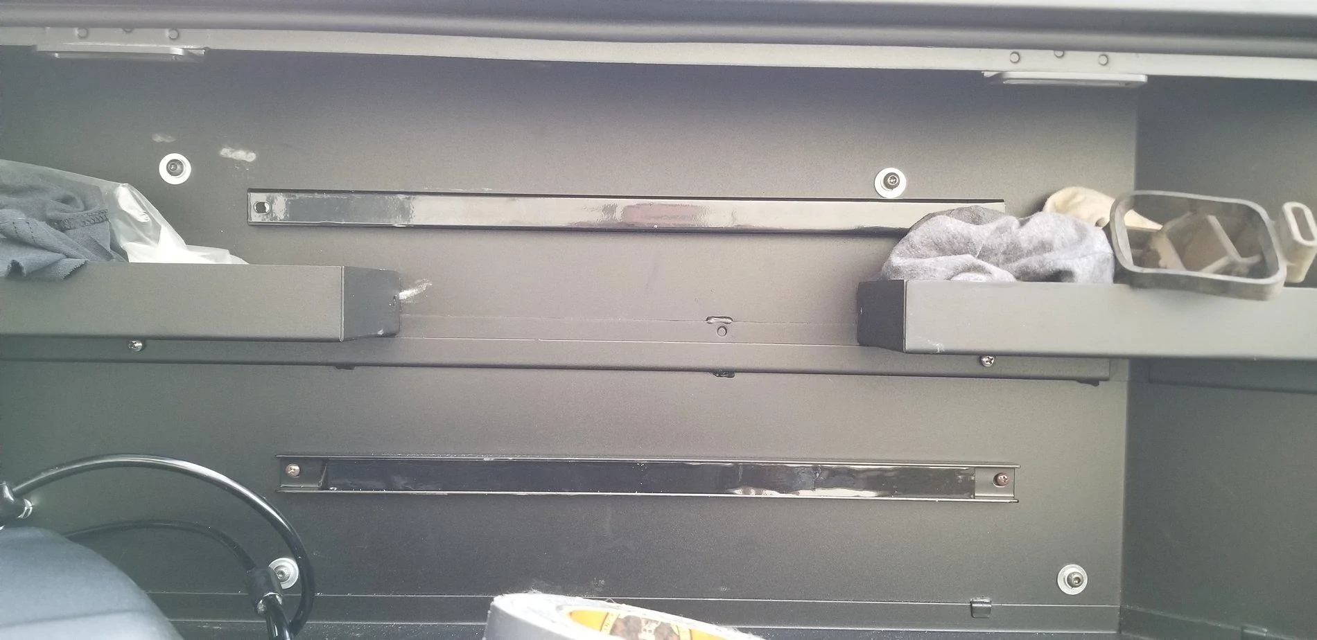

I unloaded it for pictures. You can see the magnetic strips that I added. Super strong. Also shown is the U-bolt that I added for the CCW lock box. I used nylon lock nuts and lock washers on the back side of the U-bolt. Also shown is the amount of floor space that it takes, which I gladly gave up for the box.

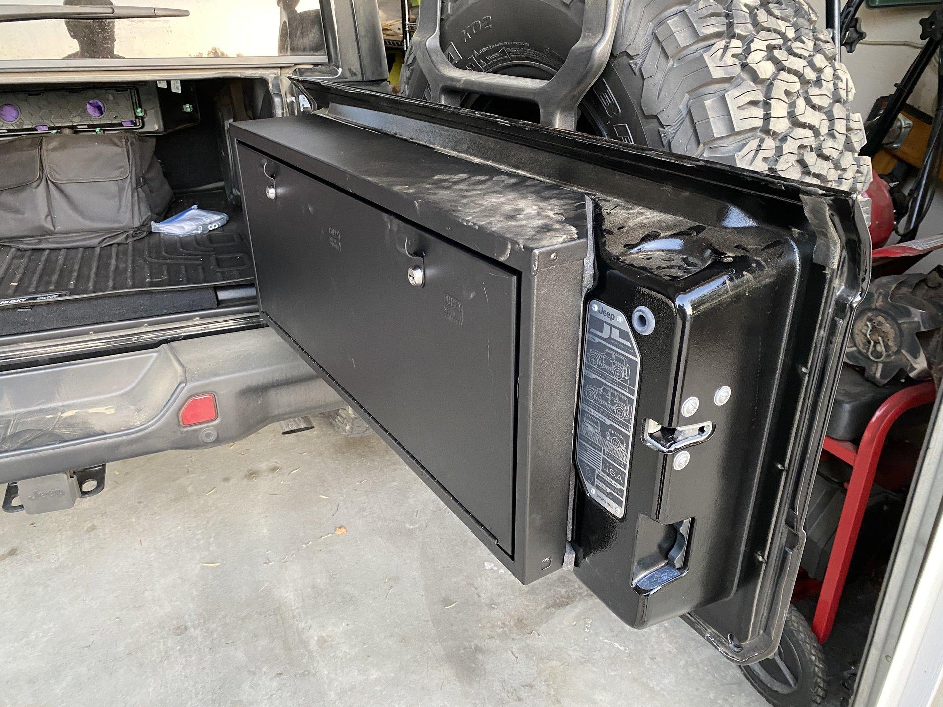

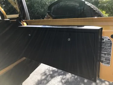

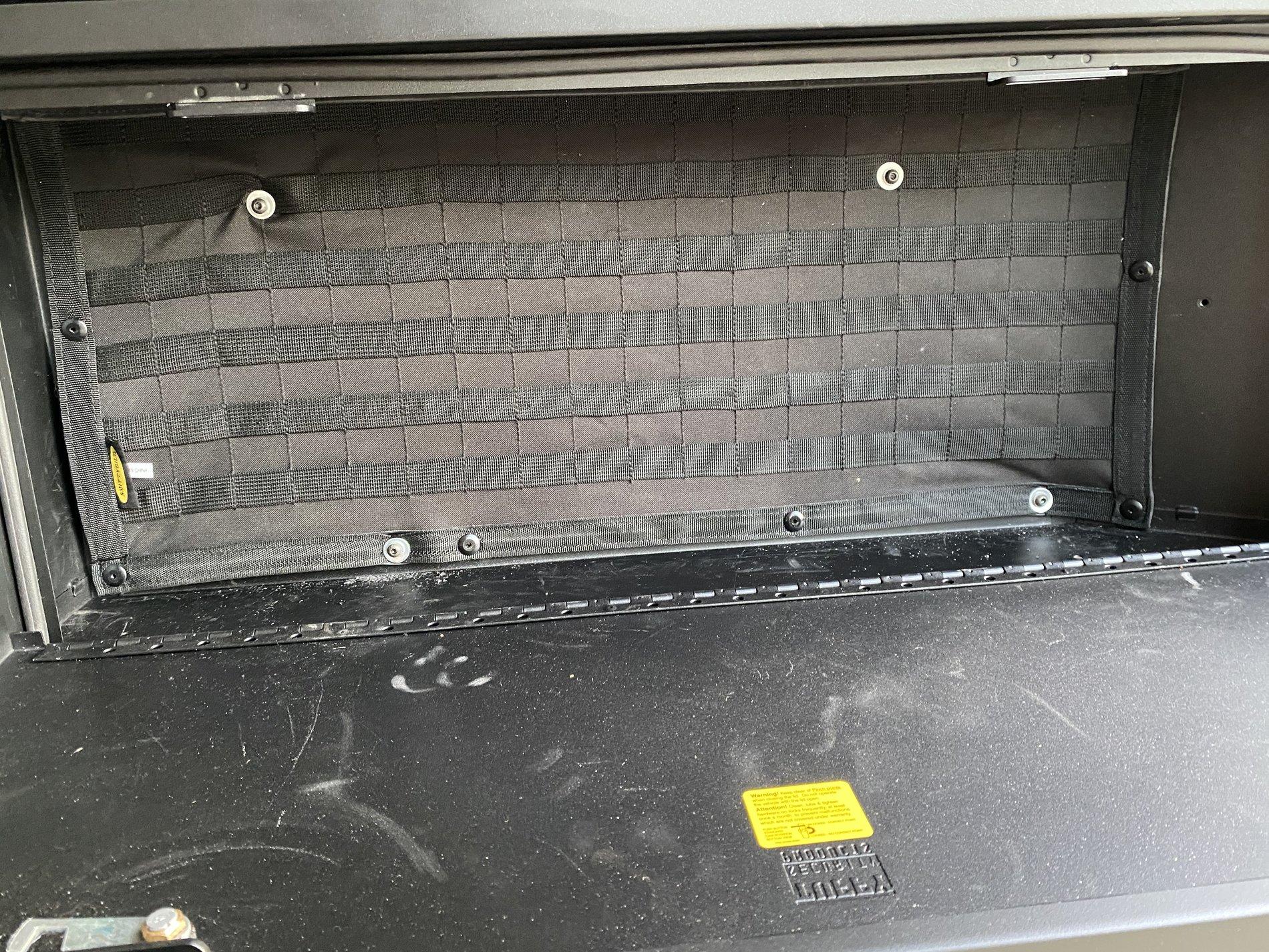

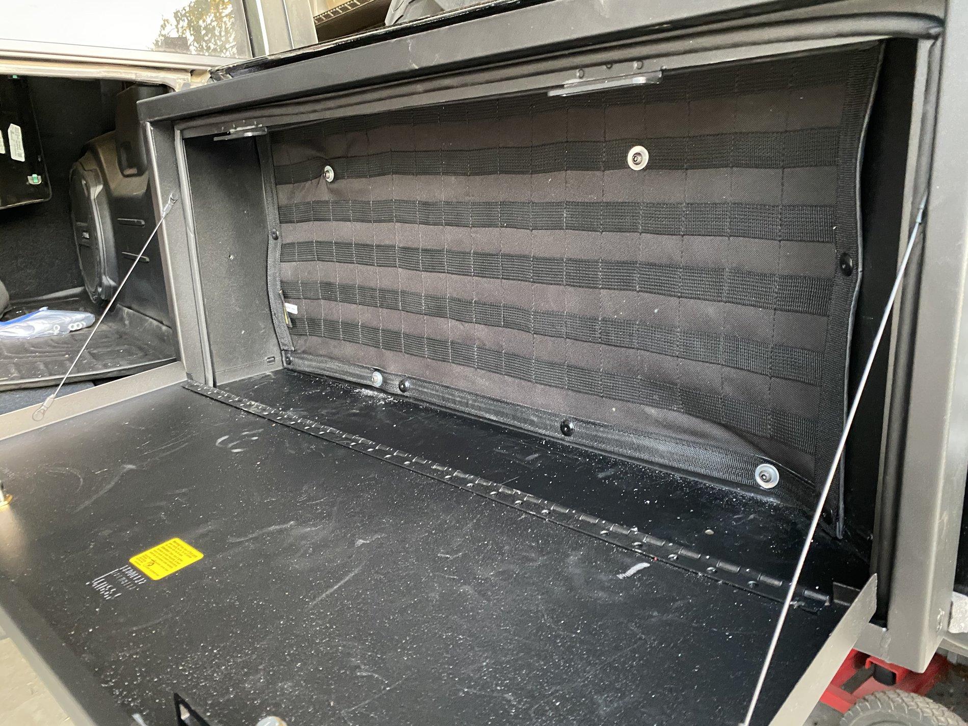

I love what you guys did. Mounted mine up today. A couple of variations: I pop riveted a molle panel in to it for mounting items. Mounted it directly to the tailgate with some weather stripping. Used just a fender washer up too for a spacer and cut the bottom spacers down to 5/8 inch. Saved a bunch of space. Stuffed a foam air filter panel in behind to help with any noise / dust from the tailgate vents and did not put weather stripping on the inside of the box (where you can’t see it) to facilitate air movement if needed. Pretty happy with how it came out. Just need some stickers now!
